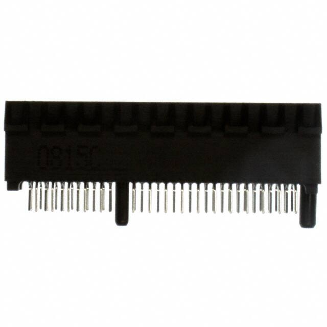

    CONN PCI EXP FEMALE 98POS 0.039
NWE49DHHN-T921 数据手册
8 7 4 5 6 1 2 3 REVISIONS F 1.78 .070 11.65 .459 A PIN# 1 REV. ECO. NO DESCRIPTION DATE BY A 1595 INITIAL RELEASE 11/31/07 VJ B 1707 UPDATE P/N CODING CHART, PLATING 05/30/08 ASK C 1933 UPDATE DRAWING VIEWS, NOTES & DIM. 3/09/2009 JH F B A 10.00 .394 E E +0.20 +.008 1.77 .070 - 0.10 - .004 B PIN# 1 CL KEY 1.50 .059 5.10±0.15 .201±.006 1.50 .059 14.50 .571 3.75 .148 MAX. C 0.95 .037 D 8.80 .346 A 7.40 .291 D 3.55 .140 4.40 .173 7.60 .299 1.00 .039 0.35±0.05 .014±.002 TYP. 2X1.25 .049 2X3.25 .128 1.35 .053 C A TAIL LENGTH (SEE PART NUMBER CODING) 1.65 .065 D SECTION A-A 0.80±0.15 .031±.006 4.40±0.15 .173±.006 1.00 .039 TYP. C B 1.00 .039 0.25±0.05 .010±.002 TYP. 2.20±0.08 .087±.003 NOTES: 1. INSULATOR MATERIAL: NYLON46, UL 94V-0. 2. CONTACT MATERIAL: PHOSPHOR BRONZE. 3. CONTACT PLATING: SEE PART NUMBER CODING. 4. CURRENT RATING: 1.1 AMP. 5. INSULATOR RESISTANCE: 1000 MEGOHMS MIN. 6. CONTACT RESISTANCE: 30 MILLI OHMS MAX. 7. DIELECTRIC WITHSTANDING: 300V AC. 8. INSEERTION FORCE: 117gf (1.15 N) MAX PER CONTACT PAIR USING A 1.70 mm (.067") STEEL CARD. 9. WITHDRAWAL FORCE: 15.3gf (0.15 N) MIN PER CONTACT PAIR USING A 1.44 mm (.057") STEEL CARD. 10. OPERATING TEMPERATURE: -55° C TO +85° C. 11. PROCESSING TEMP.: 260° C FOR 10 SECS MAX. (INDICATED TEMPERATURE AND TIME IS FOR COMPONENT INSULATOR. HIGHER PROCESSING TEMPERATURES MAY BE USED, PROVIDED HEAT IS APPLIED FROM BACK SIDE OF PCB, AND INSULATOR DOES NOT EXCEED INDICATED TEMPERATURE AND TIME.) B 2.05±0.08 .081±.003 UNLESS OTHERWISE SPECIFIED: Pb A DIMENSIONS ARE IN MM[INCHES] TOLERANCES: ANGULAR: 5 .X= .30 [.012] .XX= .20 [.008] .XXX= .10 [.004] SURFACE FINISH: 63 Ra REMOVE ALL BURRS AND SHARP EDGES .010 MAX RoHS COMPLIANT 8 7 6 11.25 .443 MAX. 5 4 DRAWN NAME 3/09/09 JH THE INFORMATION HEREIN CONTAINS PROPIETARY INFORMATION OF SULLINS ELECTRONICS AND IS NOT DESCRIPTION TO BE REPRODUCED, USED OR DISCLOSED TO OTHERS FOR ANY PURPOSE EXCEPT AS SPECIFICALLY PART NUMBER AUTHORIZED IN WRITING BY AN OFFICER OF SULLINS ELECTRONICS. PCI EXPRESS, 1mm CC, DIP SOLDER N_E_ _DHHN-T9_ _ SIZE DWG. NO. C INTERPRET DIMENSIONS AND GEOMETRIC TOLERANCING PER: ANSI Y14.5M-1994 3 DATE REV 11045 SCALE: 5:1 2 C SHEET 1 OF 2 1 FILE NAME: Z:\COMPONENTS\Taiwan\ECO PENDING TAIWAN\1912\11045, N_E_ _DHHN-T9_ _ PRINT: 3/19/2009 A 8 7 4 5 6 1 2 3 F F 1.50 .059 1.90±0.05 .075±.002 1.50 .059 0.70 .028 B PIN #1 1.00 .039 TYP. E E 6.00 .236 MIN. 3.60 .142 10.00 .394 5.00 .197 A 12.15 .478 F ADD-IN CARD EDGE-FINGER DIMENSIONS (TOLERANCE: 0.05[.002]) D D D 10.00 .394 1.65 .065 A PIN #1 C A 1.35 .053 1.25 .049 C 3.25 .128 1.00 .039 TYP B PIN #1 RECOMMENDED PCB LAYOUT (TOLERANCE: 0.05[.002]) B 2X 2.35±0.05 .093±.002 0.70±0.08 .028±.003 B Pb A DESCRIPTION PCI EXPRESS, 1mm CC, DIP SOLDER PART NUMBER N_E_ _DHHN-T9_ _ SIZE DWG. NO. RoHS COMPLIANT C REV 11045 SCALE: NTS 8 7 6 5 4 3 2 C SHEET 2 OF 2 1 FILE NAME: Z:\COMPONENTS\Taiwan\ECO PENDING TAIWAN\1912\11045, N_E_ _DHHN-T9_ _ PRINT: 3/19/2009 A
