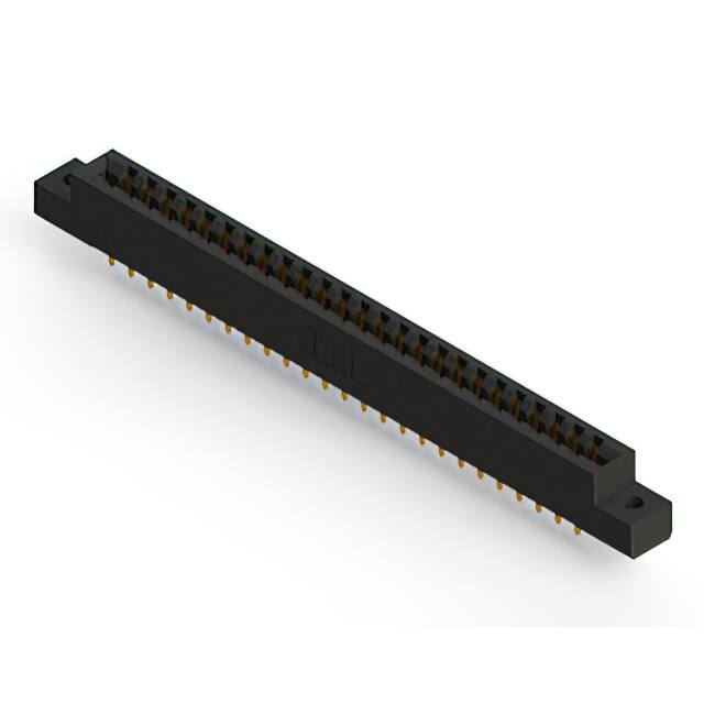

Mounting Option 03-.116 (2.95) I.D. Floating Eyelets Contact Detail 520-P.C. Tail .046x.013(1.17x0.33) - Tail LG.=.213(5.41) .156 [3.96] Contact Spacing x .140 [3.56] Row Spacing ISSUE NUMBER THIS IS A C.A.D. GENERATED DRAWING DO NOT MAKE MANUAL REVISIONS TO MASTER. ORIGINAL 1 0.500 12.70 Card Slot Accepts .054 (1.37) to .070 (1.78) Thick P.C. Board 0.156 3.96 4.688 119.08 0.295 7.49 Card Slot 4.834 122.78 5.120 130.05 SECTION A-A 0.460 11.68 A A 0.090 2.29 Point of Contact 5.430 137.92 305 / 315 / 355 Card Edge Connector Part Number: 355-058-520-203 See Accompanying Page for: • Mounting Options EDAC INC TORONTO, ONTARIO CANADA YOUR CONNECTION TO QUALITY & SERVICE THESE DRAWINGS AND SPECIFICATIONS ARE THE PROPERTY OF EDAC INC.,AND SHALL NOT BE REPRODUCED,OR COPIED OR USED AS THE BASIS FOR THE MANUFACTURE OR SALE OF APPARATUS WITHOUT WRITTEN PERMISSION. ACAD REFERENCE NO. J.LEE DRAWN: CHECKED: SCALE: NTS DRAWING NUMBER 305 Assembly 305 ENG MASTER DATE: SEPT. 21/09 DATE: SHEET 1 OF 2 ISSUE 1 0.125 3.18 Code x01 Code x12 ISSUE NUMBER THIS IS A C.A.D. GENERATED DRAWING DO NOT MAKE MANUAL REVISIONS TO MASTER. ORIGINAL 1 .128 [3.25] Dia Through Holes .128 [3.25] Dia Through Holes 0.468 11.89 0.344 8.74 0.125 3.18 0.060 1.52 Code x02 0.116 2.95 I.D. Floating Eyelets 0.090 2.29 0.250 6.35 Dia. .010 [0.25] Radial Float 2.750 69.85 Code x03 2.500 63.50 0.328 8.33 0.005 0.13 1.550 39.37 .156 [3.96] Dia Through Holes 0.250 6.35 Code x04 M3-0.5 Metric Threaded Insert #4-40 UNC Threaded Insert Code x68 305 / 315 / 355 Card Edge Connector Mounting Options EDAC INC Code x08 0.250 6.35 0.242 6.15 0.423 10.74 Code x58 Code x07 0.250 6.35 TORONTO, ONTARIO CANADA YOUR CONNECTION TO QUALITY & SERVICE THESE DRAWINGS AND SPECIFICATIONS ARE THE PROPERTY OF EDAC INC.,AND SHALL NOT BE REPRODUCED,OR COPIED OR USED AS THE BASIS FOR THE MANUFACTURE OR SALE OF APPARATUS WITHOUT WRITTEN PERMISSION. Code x78 ACAD REFERENCE NO. J.LEE DRAWN: CHECKED: SCALE: NTS DRAWING NUMBER 305 Assembly 305 ENG MASTER DATE: SEPT. 21/09 DATE: SHEET 2 OF 2 ISSUE 1

- 物料型号:Part Number: 355-058-520-203 - 器件简介:文档描述了一种卡边缘连接器,具体为305 / 315 / 355 Card Edge Connector。 - 引脚分配:文档中提到了接触点间距为0.156英寸(3.96毫米),行间距为0.140英寸(3.56毫米)。 - 参数特性:提到了几种不同的孔径和通过孔,例如0.128英寸(3.25毫米)直径的通过孔,以及0.125英寸(3.18毫米)直径的孔。 - 功能详解:文档中提到了卡槽可以接受0.054英寸(1.37毫米)到0.070英寸(1.78毫米)厚的PCB板。 - 应用信息:文档中提到了几种不同的安装选项和代码,例如Code x01, Code x12, Code x02, Code x03, Code x04, Code x58, Code x68, Code x78, Code x07, 和Code x08。 - 封装信息:文档中提到了几种不同的安装选项,但没有详细说明封装的具体信息。
