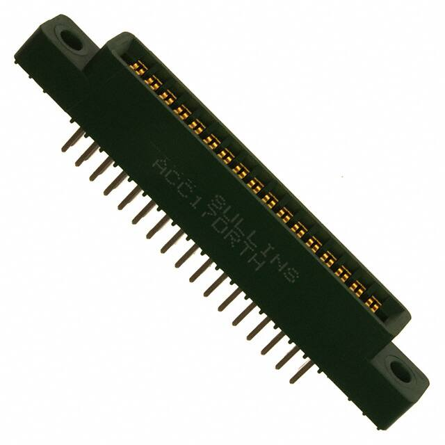

    CONN EDGE DUAL FMALE 34POS 0.100
ACC17DRTH 数据手册
Female Card Edge .100” [2.54 mm] Contact Centers, .431” [10.95 mm] Insulator Height, Dip Solder/Eyelet/Right Angle for .062” [1.57 mm] or .031” [0.79 mm] Mating PCB SPECIFICATIONS • Accommodates .062” ± .008” [1.57 mm ± 0.20 mm] or .031” ± .006” [0.79 mm ± 0.15 mm] mating PCB (for .093” [2.36 mm] PC board see following pages) • PBT, PPS, PA9T or PEEK insulator • Molded-in key available • 3 Amps current rating for one contact energized • 30 milli Ohms maximum at rated current • UL Flammability Rating: 94V-0 POLARIZING KEYS (For .062” Mating PCB Only) READOUT FULL BELLOWS PLA-K1 KEY IN BETWEEN CONTACTS (ORDER SEPARATELY) BACK-UP SPRING CANTILEVER Female Card Edge .230” [5.84] .030” [0.76] LETTER 'A' SIDE DUAL (D) .200” [5.08] CONSULT FACTORY FOR MOLDED-IN KEY HALF LOADED (H) TERMINATION TYPE FULL BELLOW TAIL LENGTH 'B' SIDE ROW SPACING MIN HOLE SIZE FULL BELLOW EYELET ACCEPTS 3-#26 AWG STRAIGHT .185” RIGHT ANGLE [4.70] .125” [3.18] (RA) .050” [1.27] .156” [3.96] STRAIGHT .200” [5.08] (RT) .440” [11.19] (RY) .140” [3.56] Ø.043” [1.09] .275” [6.98] .225” [5.72] .140” [3.56] Ø.043” [1.09] Ø.043” [1.09] .007”[0.18] THICK (RE) CARD EXTENDER .014”[0.36] THICK (TE) ACCEPTS .062” [1.57] PCB TAIL LENGTH .185” [4.70] (RX) .200” [5.08] .165” [4.19] (RJ) .250” [6.35] .210” [5.33] EYELET (RE) .185” [4.70] (RT) .425” [10.80] (RY) Ø.043” [1.09] Ø.043” [1.09] MODIFICATION CODE -S13 -S13 -S13 SURFACE MOUNT (RT) MODIFICATION CODE CRIMP TO CENTER (SX) .160” [4.06] -S924 Ø.043” [1.09] .600” [15.24] CANTILEVER RIGHT ANGLE SURFACE MOUNT (RA) TAIL LENGTH ROW SPACING MIN HOLE SIZE .200” [5.08] (ET) .140” [3.56] Ø.040” [1.02] .440” [11.19] (EY) .140” [3.56] Ø.040” [1.02] MODIFICATION CODE -S2106 .150” [3.81] .350” [8.88] MOUNTING STYLE Ø.125” [3.18] #4-40 Ø.116” [2.95], CLEARANCE FOR #4 SCREW .100” [2.54] Ø.125” [3.18] .135” [3.43] CLEARANCE HOLE (H) 50 THREADED INSERT (I) FLOATING BOBBIN (F) NO MOUNTING EARS (N) SIDE MOUNTING (S) OPEN CARDSLOT (B) www.sullinscorp.com | 760-744-0125 | toll-free 888-774-3100 | fax 760-744-6081 | info@sullinscorp.com Female Card Edge .100” [2.54 mm] Contact Centers, .431” [10.95 mm] Insulator Height, Dip Solder/Eyelet/Right Angle for .062”[1.57 mm] or .031” [0.79 mm] Mating PCB PART NUMBER OPTIONS E B C 43 D RE H - Sxxx CONTACT FINISH - RoHS Compliant All platings are Lead Free and have .000050” Nickel underplate Contact Surface .000010” Gold .000030” Gold .000010” Gold .000030” Gold Contact Surface S = .000010” Gold M = .000030” Gold E = .000100” Pure Tin, Matte B C G Y = = = = Termination .000100” Pure Tin, Matte .000100” Pure Tin, Matte .000005” Gold .000005” Gold Overall Plating .000010” Gold .000010” Gold .000100” Pure Tin, Matte CONTACT CENTERS C = .100” [2.54 mm] DIMENSIONS Dimensions in [ ] are in millimeters, all others are in inches. B A F D E .265 [6.73] INSERTION DEPTH REFER TO MOUNTING STYLE C .025[0.64] .100 [2.54] TYP. CONTACT MARKINGS B 1 2 3 . . . 58 59 60 B A 1 2 3 . . . 58 59 60 A .431 [10.95] B 1 2 59 60 B A 1 2 59 60 A Female Card Edge MODIFICATIONS (Consult Factory) OMIT FOR STANDARD -S13 = Card Extender Accepts .062” [1.57 mm] PCB (RE, RT, RY Terminations Only) -S734 = .031”±.006” [0.79 mm ± 0.15 mm] Mating PCB -S924 = Surface Mount -S2106 = Right Angle Surface Mount MOUNTING STYLE (Opposite Page) H = .125” [3.18 mm] Clearance Holes N = No Mounting B = Open Card slot S = Side Mounting I = Threaded Insert F = Floating Bobbin TERMINATION TYPE (Opposite Page) RA = Right Angle RE = Eyelet (Standard) TE = Eyelet (Overall Plated Only) **ET, RT = .140” [3.56 mm] X .200” [5.08 mm] Dip Solder **EY, RY = .140” [3.56 mm] X .440” [11.19 mm] Dip Solder RX = .200” [5.08 mm] X .185” [4.70 mm] Dip Solder RJ = .250” [6.35 mm] X .165” [4.19 mm] Dip Solder SX = .110” [2.79 mm] Centered Dip Solder READOUT (Opposite Page) D = Dual H = Half Loaded NUMBER OF CONTACT POSITIONS See Chart Below **'ET' & 'EY' Only available in 'B' & 'C' Plating code MATERIALS (INSULATOR/CONTACT) E = PBT/Phosphor Bronze (Standard) R = PPS/Phosphor Bronze G = PA9T/Phosphor Bronze H = PBT/Beryllium Copper A = PPS/Beryllium Copper J = PA9T/Beryllium Copper *F = PPS/Spinodal (Overall Gold Plating Only) Consult Factory for Special Soldering Guidelines *C = PPS/Beryllium Nickel (Overall Gold Plating Only) *W = PEEK/Beryllium Nickel (Overall Gold Plating Only) *Consult factory for availability. Refer to Page 7 for Operating/Processing Temperatures .245 [6.22] REFER TO TERMINATION TYPE Tolerances on non-critical dimensions may very slightly due to shrinkage differential per insulator material; Consult factory. POSITIONS/ CONTACTS 04/08* 05/10 06/12 07/14 08/16 10/20 12/24 13/26 15/30 17/34 18/36 19/38 20/40 22/44 23/46* 25/50 26/52 28/56 30/60 31/62 35/70 36/72 40/80 43/86 44/88 49/98 50/100 52/104* 60/120 65/130 INCHES A±.008 B±.008 C±.015 D±.010 E±.020 0.300 0.500 0.675 0.975 1.275 0.400 0.600 0.775 1.075 1.375 0.500 0.700 0.875 1.175 1.475 0.600 0.800 0.975 1.275 1.575 0.700 0.900 1.075 1.375 1.675 0.900 1.100 1.275 1.575 1.875 1.100 1.300 1.475 1.775 2.075 1.200 1.400 1.575 1.875 2.175 1.400 1.600 1.775 2.075 2.375 1.600 1.800 1.975 2.275 2.575 1.700 1.900 2.075 2.375 2.675 1.800 2.000 2.175 2.475 2.775 1.900 2.100 2.275 2.575 2.875 2.100 2.300 2.475 2.775 3.075 2.200 2.400 2.575 2.875 3.175 2.400 2.600 2.775 3.075 3.375 2.500 2.700 2.875 3.175 3.475 2.700 2.900 3.075 3.375 3.675 2.900 3.100 3.275 3.575 3.875 3.000 3.200 3.375 3.675 3.975 3.400 3.600 3.775 4.075 4.375 3.500 3.700 3.875 4.175 4.475 3.900 4.100 4.275 4.575 4.875 4.200 4.400 4.575 4.875 5.175 4.300 4.500 4.675 4.975 5.275 4.800 5.000 5.175 5.475 5.775 4.900 5.100 5.275 5.575 5.875 5.100 5.300 5.475 5.775 6.075 5.900 6.100 6.275 6.575 6.875 6.400 6.600 6.775 7.075 7.375 MILLIMETERS F+.005/-.015 0.330 0.400 A±0.20 7.62 10.16 12.70 15.24 17.78 22.86 27.94 30.48 35.56 40.64 43.18 45.72 48.26 53.34 55.88 60.96 63.50 68.58 73.66 76.20 86.36 88.90 99.06 106.68 109.22 121.92 124.46 129.54 149.86 162.56 B±0.20 12.70 15.24 17.78 20.32 22.86 27.94 33.02 35.56 40.64 45.72 48.26 50.80 53.34 58.42 60.96 66.04 68.58 73.66 78.74 81.28 91.44 93.98 104.14 111.76 114.30 127.00 129.54 134.62 154.94 167.64 C±0.38 17.15 19.69 22.23 24.77 27.31 32.39 37.47 40.01 45.09 50.17 52.71 55.25 57.79 62.87 65.41 70.49 73.03 78.11 83.19 85.73 95.89 98.43 108.59 116.21 118.75 131.45 133.99 139.07 159.39 172.09 D±0.25 24.77 27.31 29.85 32.39 34.93 40.01 45.09 47.63 52.71 57.79 60.33 62.87 65.41 70.49 73.03 78.11 80.65 85.73 90.81 93.35 103.51 106.05 116.21 123.83 126.37 139.07 141.61 146.69 167.01 179.71 E±0.51 32.39 34.93 37.47 40.01 42.55 47.63 52.71 55.25 60.33 65.41 67.95 70.49 73.03 78.11 80.65 85.73 88.27 93.35 98.43 100.97 111.13 113.67 123.83 131.45 133.99 146.69 149.23 154.31 174.63 187.33 F+0.13/-0.38 8.38 10.16 * Consult factory for availability. www.sullinscorp.com | 760-744-0125 | toll-free 888-774-3100 | fax 760-744-6081 | info@sullinscorp.com 51
