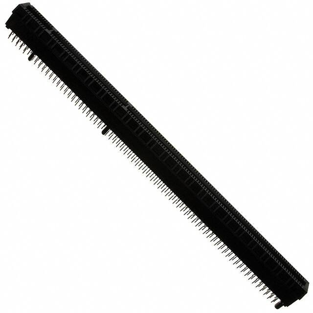

    SULLINS
    CONN PCI EXP FEMALE 280POS 0.039
NWE140DHHN-T921 数据手册
8 7 4 5 6 1 2 3 REVISIONS F REV. ECO. NO DESCRIPTION DATE BY A 1595 INITIAL RELEASE 04/01/08 VJ B 1707 05/30/08 ASK C 1946 UPDATE P/N CODING CHART, PLATING UPDATE NOTES, COLOR CODE & TOLERANCE BLOCK, TAIL LENGTH OPTION 1 REMOVED 06/26/09 JH F 131.68 5.184 E 11.67 .459 38.27 1.507 10.00 .394 PIN A1 IDENTIFIER PIN A2 PIN A1 37.00 1.457 E 91.68 3.609 90.00 3.543 1.73±0.08 .068±.003 1.73±0.08 .068±.003 1.00 .039 TYP 7.50 .295 MAX PIN B1 PIN B2 D 1.50 .059 3.75 .148 MAX D 11.25 .443 MAX +0.15 +.006 1.80 .071 - 0.08 - .003 2X 1.20 .047 149.00 5.866 0.90±0.20 .035±.008 5.10 .201 A 3.75 .148 7.80 .307 C 15.60 .614 4.40±0.20 .173±.008 1.00 .039 TYP 1.25 .049 SECTION A-A 3.25 .128 133.15 5.242 14.65 .577 40.00 1.575 TAIL LENGTH SEE PART NUMBER CODING B NOTES: 3X 2.15±0.10 .085±.004 1. INSULATOR MATERIAL: NYLON46, UL 94V-0. 2. CONTACT MATERIAL: PHOSPHOR BRONZE. 3. CONTACT PLATING: SEE PART NUMBER CODING. 4. CURRENT RATING: 1.1 AMP. 5. VOLTAGE RATING: 50 V DC. 6. INSULATOR RESISTANCE: 1000 MEGOHMS MIN. 7. CONTACT RESISTANCE: 30 MILLI OHMS MAX. 8. DIELECTRIC WITHSTANDING: 500V DC. 9. INSERTION FORCE: 117gf (1.15 N) MAX PER CONTACT PAIR USING A 1.7 mm (.067") STEEL CARD. 10. WITHDRAWAL FORCE: 15.3gf (0.15 N) MIN PER CONTACT PAIR USING A 1.44 mm (.057") STEEL CARD. 11. OPERATING TEMPERATURE: -55° C TO +105° C. 12. PROCESSING TEMP.: 260° C FOR 10 SECS MAX. (INDICATED TEMPERATURE AND TIME IS FOR COMPONENT INSULATOR. HIGHER PROCESSING TEMPERATURE MAY BE USED, PROVIDED HEAT IS APPLIED FROM BACK SIDE OF PCB, AND INSULATOR DOES NOT EXCEED oHS COMPLIANT INDICATED TEMPERATURE AND TIME.) Pb R 8 C 5.60 .220 A 0.34X0.25 [.013X.010] TYP 2X 2.00±0.10 .079±.004 A 8.85 .348 7 6 5 4 UNLESS OTHERWISE SPECIFIED: DIMENSIONS ARE IN MM[INCHES] TOLERANCES: ANGULAR: 5 .X= .3 [.01] .XX= .25 [.010] .XXX= .080 [.0030] SURFACE FINISH: 63 Ra REMOVE ALL BURRS AND SHARP EDGES .010 MAX DRAWN NAME 3/23/09 JH THE INFORMATION HEREIN CONTAINS PROPIETARY INFORMATION OF SULLINS ELECTRONICS AND IS NOT DESCRIPTION TO BE REPRODUCED, USED OR DISCLOSED TO OTHERS FOR ANY PURPOSE EXCEPT AS SPECIFICALLY PART NUMBER AUTHORIZED IN WRITING BY AN OFFICER OF SULLINS ELECTRONICS. PCI EXPRESS, 1mm CC, 140P, DIP SOLDER N_E140DHHN-T9_ _ SIZE DWG. NO. C INTERPRET DIMENSIONS AND GEOMETRIC TOLERANCING PER: ANSI Y14.5M-1994 3 DATE B REV 11040 SCALE: 1:1 2 C SHEET 1 OF 2 1 FILE NAME: Z:\ECO PENDING\1946\11040, N_E140DHHN-T9_ _ PRINT: 9/2/2009 A 8 7 4 5 6 1 2 3 F F 1.90±0.06 .075±.002 , 2X 1.50 .059 , 2X 1.50 .059 , 2X PIN B1 4.20 .165 E 5.60 .220 B 0.70 .028 TYP 1.00 .039 TYP. 10.00 .394 37.00 1.457 90.00 3.543 12.15 .478 40.00 1.575 92.15 3.628 E 0.50[.020] x 45 TYP 144.30 5.681 I/O PANEL DIRECTION PRIMARY (COMPONENT) SIDE D D 1.57±0.13 .062±.005 PIN A1 0.70 .028 TYP. 1.40 .055 1 I/O PANEL DIRECTION SECONDARY (SOLDER) SIDE C C 20.0° ADD-IN CARD EDGE-FINGER DIMENSIONS DETAIL B SCALE 8 : 1 133.15 5.242 PIN A2 B 40.00 1.575 1.65 .065 1.35 .053 PIN A1 1.65 .065 1.35 .053 2.00 .079 TYP 3X 1.00 .039 TYP 2.35±0.05 .093±.002 B 6.50 .256 PIN B1 0.70±0.08 .028±.003 TYP PIN B2 10.00 .394 37.00 1.457 2.50 .098 90.00 3.543 RECOMMENDED PCB LAYOUT TOLERANCE: 0.13 [.005] Pb A 1. CHAMFER EDGE MUST BE FREE OF CUTTING BURRS. DESCRIPTION PCI EXPRESS, 1mm CC, 140P, DIP SOLDER PART NUMBER N_E140DHHN-T9_ _ SIZE DWG. NO. RoHS COMPLIANT C REV 11040 SCALE: NTS 8 7 6 5 4 3 2 C SHEET 2 OF 2 1 FILE NAME: Z:\ECO PENDING\1946\11040, N_E140DHHN-T9_ _ PRINT: 9/2/2009 A
