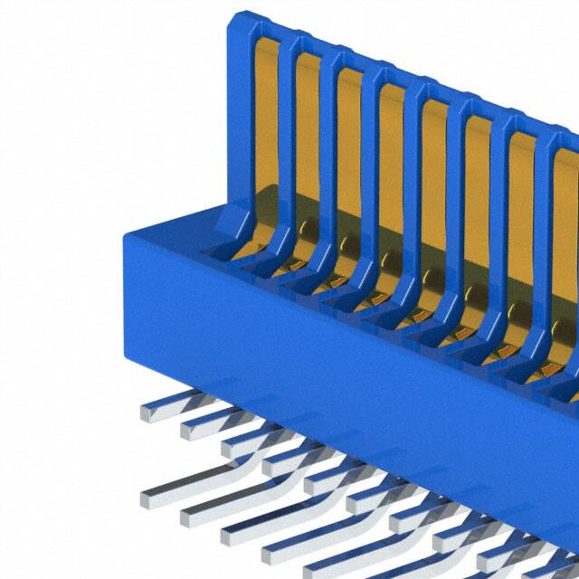

    CONN CARDEDGE MALE 34POS 0.100
EBC17MMAN 数据手册
8 7 4 5 6 1 2 3 REVISIONS F D C A REV. ECO. NO DESCRIPTION DATE BY F 3177 UPDATE DWG FORMAT, UPDATE INSERT INSTALLATION IN 'V' MOUNTING 3/10/2015 MG H 3182 UPDATE GAP FROM PIN TO BODY TO .050 FROM .030 4/23/2015 MG J 3613 ADD S2196, REMOVE 'A' MATERIAL, ADD 'Q' MATERIAL, UPDATE 'R' MATERIAL OPERATING TEMPERATURE, REMOVE 'Y' & 'S' PLATING 2/2/2017 EP F +.005 +0.13 .370 9.40 - .015 - 0.38 E E 2X .100 2.54 B .125 3.18 THRU FITS EDGECARDS THAT ACCEPT .062[1.57] PCB'S A D .540±.010 13.72±0.25 .030 0.76 .250 6.35 MA = .100±.025 2.54±0.64 MV = .130 .025 [3.30 0.64] MB = .180 .025 [4.57 0.64] MD = .250 .025 [6.35 0.64] MJ = .500 .025 [12.70 0.64] MK = .560 .025 [14.22 0.64] D .050±.010 1.27±0.25 C .025 0.64 STD = .150 3.81 ROW SPACING S189 = .200 [5.08] ROW SPACING A _ _C_ _M_ _D _ _C_ _M_ _D-S189 _ _C_ _M_ _D-S2196) C SECTION A-A C .125 3.18 USE FOR Z & V MOUNTING ONLY (SEE SHEET 2) A B B .145 3.68 .100 2.54 .043 1.09 MIN .150 3.81 (FOR STANDARD) .200[5.08] (FOR S189) NOTES: 1. INSULATOR MATERIAL: SEE PART NUMBER CODING RECOMMENDED PCB LAYOUT 2. CONTACT MATERIAL: SEE PART NUMBER CODING 3. PLATING: SEE PART NUMBER CODING 4. OPERATING TEMPERATURE: SEE PART NUMBER CODING UNLESS OTHERWISE SPECIFIED: DRAWN 5. PROCESSING TEMP: SEE PART NUMBER CODING DIMENSIONS ARE IN INCHES [MM] 6. UL FLAMMABILITY RATING: 94V-0 TOLERANCES: 7. OPERATION VOLTAGE: 700 VAC 8. CURRENT RATING: 3 AMP ANGULAR: 1 9. CONTACT RESISTANCE: 30 MILLI OHMS MAX DECIMALS .XX= .02 [.5] 10. INSULATION RESISTANCE: 5000 MEGA OHMS .XXX= .005 [.13] 11. CONNECTOR IDENTIFICATION: PART SHALL BE MARKED WITH A PART NUMBER AND LOT CODE .XXXX= .0005 [.013] RoHS COMPLIANT 12. MODIFICATION: SEE PART NUMBER CODING CUSTOMER COPY A Pb 8 7 6 5 4 DATE NAME 02/05/08 MNH THE INFORMATION HEREIN CONTAINS PROPIETARY INFORMATION OF SULLINS ELECTRONICS AND IS NOT TO BE REPRODUCED, USED OR DISCLOSED TO OTHERS FOR ANY PURPOSE EXCEPT AS SPECIFICALLY AUTHORIZED IN WRITING BY AN OFFICER OF SULLINS ELECTRONICS. 3 TITLE A MALE, RIGHT ANGLE BEND, .100 CC PART NUMBER _ _C_ _M_ _(MA,MV,MB,MD,MJ,MK)_-(S189,S2196) SIZE C CAGE CODE 54453 SCALE: 4:1 2 DWG. NO. C11052 SHEET 1 OF 3 1 REV J FILE NAME: C11052, _ _C_ _M(MA,MV,MB,MD,MJ,MK)_ -(OMIT,S189,S2196) 8 7 4 5 6 E C 2X #4-40 THREADED INSERTS F 1 2 3 F E E _ _C_ _M_ _N _ _C_ _M_ _N-S189 _ _C_ _M_ _N-S2196 D _ _C_ _M_ _T _ _C_ _M_ _T-S189 _ _C_ _M_ _T-S2196 D C C C C 2X .125 3.18 .125 3.18 B B .125 3.18 2X #4-40 THREADED INSERTS _ _C_ _M_ _Z _ _C_ _M_ _Z-S189 _ _C_ _M_ _Z-S2196 CUSTOMER COPY Pb A RoHS COMPLIANT 8 7 _ _C_ _M_ _V _ _C_ _M_ _V-S189 _ _C_ _M_ _V-S2196 6 5 4 UNLESS OTHERWISE SPECIFIED: DRAWN DATE NAME DIMENSIONS ARE IN INCHES [MM] 02/05/08 MNH TOLERANCES: ANGULAR: 1 DECIMALS .XX= .02 [.5] .XXX= .005 [.13] .XXXX= .0005 [.013] THE INFORMATION HEREIN CONTAINS PROPIETARY INFORMATION OF SULLINS ELECTRONICS AND IS NOT TO BE REPRODUCED, USED OR DISCLOSED TO OTHERS FOR ANY PURPOSE EXCEPT AS SPECIFICALLY AUTHORIZED IN WRITING BY AN OFFICER OF SULLINS ELECTRONICS. TITLE PART NUMBER _ _C_ _M_ _(MA,MV,MB,MD,MJ,MK)_-(S189,S2196) SIZE C CAGE CODE 54453 SCALE: 3:1 3 A MALE, RIGHT ANGLE BEND, .100 CC 2 DWG. NO. C11052 SHEET 2 OF 3 1 REV J FILE NAME: C11052, _ _C_ _M(MA,MV,MB,MD,MJ,MK)_ -(OMIT,S189,S2196) 8 7 4 5 6 1 2 3 F F E E D D C C B B CUSTOMER COPY Pb A RoHS COMPLIANT 8 7 6 5 4 UNLESS OTHERWISE SPECIFIED: DRAWN DATE NAME DIMENSIONS ARE IN INCHES [MM] 02/05/08 MNH TOLERANCES: ANGULAR: 1 DECIMALS .XX= .02 [.5] .XXX= .005 [.13] .XXXX= .0005 [.013] THE INFORMATION HEREIN CONTAINS PROPIETARY INFORMATION OF SULLINS ELECTRONICS AND IS NOT TO BE REPRODUCED, USED OR DISCLOSED TO OTHERS FOR ANY PURPOSE EXCEPT AS SPECIFICALLY AUTHORIZED IN WRITING BY AN OFFICER OF SULLINS ELECTRONICS. TITLE PART NUMBER _ _C_ _M_ _(MA,MV,MB,MD,MJ,MK)_-(S189,S2196) SIZE C CAGE CODE 54453 SCALE: 2:1 3 A MALE, RIGHT ANGLE BEND, .100 CC 2 DWG. NO. C11052 SHEET 3 OF 3 1 REV J FILE NAME: C11052, _ _C_ _M(MA,MV,MB,MD,MJ,MK)_ -(OMIT,S189,S2196)
EBC17MMAN
1. 物料型号:文档列出了不同型号的连接器,如C04M至C60M,每个型号都有其特定的引脚数量和尺寸。
2. 器件简介:连接器适用于接受0.062" (1.57mm) PCB的边缘卡,具有不同的引脚间距和行间距。
3. 引脚分配:文档提供了详细的引脚分配图,包括不同型号的连接器的引脚布局。
4. 参数特性: - 操作电压:700 VAC - 电流额定值:3安培 - 接触电阻:最大30毫欧姆 - 绝缘电阻:5000兆欧姆 - 操作温度范围:根据不同型号有不同的范围 - 连接器识别:部件应标记有部件编号和批次代码
5. 功能详解:文档提供了连接器的详细功能描述,包括其电气特性和物理特性。
6. 应用信息:连接器适用于多种应用,文档中提到了推荐的PCB布局和安装指南。
7. 封装信息:文档包含了连接器的封装尺寸和公差信息。
8. 其他:文档还包含了修订历史、材料编码、镀层编码和加工温度等信息。
