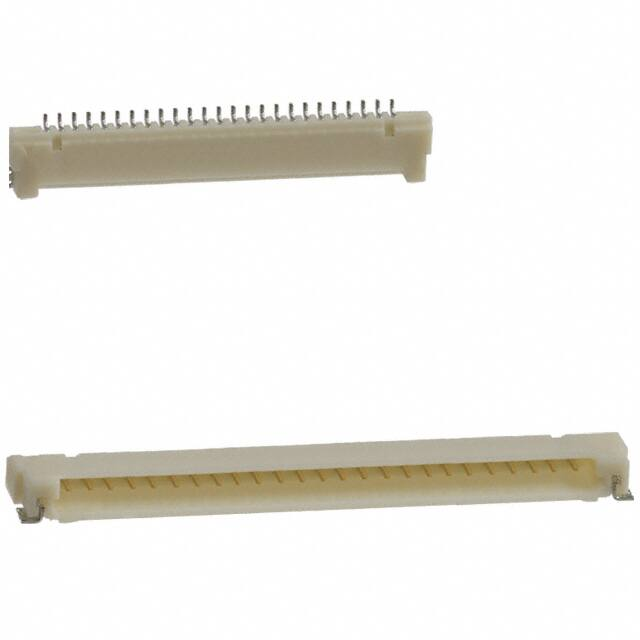

Nov.1.2021 Copyright 2021 HIROSE ELECTRIC CO., LTD. All Rights Reserved. DF14 Series 1.25mm Pitch, Low Profile Crimp Connector Feb. 2021 DF14 Series/1.25mm Pitch, Low Profile Crimp Connector Features 1. Low Profile DF14-#P1.25H 2.5 DF14 is a right angle connector that enables a low profile on the board. Signals can be routed in places where there is no space between boards using DF14. The on- board type, DF14( A) , has a board mounted height of 2. 5mm. The offset type, DF14H, has an even lower profile with a board mounted height of 1. 6mm. Box-shaped Header DF14( A) On Board Type Board Mounted Diagram (7.3) (1) (1.6) (2.4) Nov.1.2021 Copyright 2021 HIROSE ELECTRIC CO., LTD. All Rights Reserved. 7.3 DF14-#S-1.25C DF14H Offset Type Board Mounted Diagram 2. Pick & Place Mounting The header has a vacuum suction surface and embossed tape packaging for pick & place mounting. Additionally, tube packaging is available for the on- board type. 3. Four- wall Design The box- shaped header prevents prying and mis- insertion. The walls on the header prevent issues resulting from friction to the board cause by the socket. Retention tabs are added to prevent solder peeling. Applications LCD ( crystal panel) , Note PCs, PDAs, Small Office Equipment, Video Devices and other Consumer Products. 2 DF14 Series/1.25mm Pitch, Low Profile Crimp Connector Product Specifications Rated Current 1A/pin Rated Voltage 150V AC/DC Operating Temperature (Note 1) -35 to + 85℃ Operating Humidity Range (Note 2) 40 to 80% Storage Temperature Range (Note 3) -10 to +60℃ Storage Humidity Range (Note 3) 40 to 70% Note 1 : Includes temperature rise due to current flow. Note 2 : Please use without condensation. Note 3 : Applicable to unused items in packaged state. Nov.1.2021 Copyright 2021 HIROSE ELECTRIC CO., LTD. All Rights Reserved. Item Specification Condition Insulation Resistance 500M Ω Min. 100V DC Withstanding Voltage No flashover or insulation breakdown. 500V AC per min. Contact Resistance 30m Ω Max. Measured at 20mV or less, 1mA (DC or 1000Hz) Insertion/ Extraction Force 0.15N Min. (15gf), 3N Max. (300gfl) mm square pin Measured with 0.3+0.005 -0 Vibration Resistance No electrical discontinuity of 1μ s or more Frequency : 10 to 55Hz, single amplitude of 0.75mm, 2 hours in each of the 3 directions. Humidity (Steady State) Contact resistance : 30m Ω Max. Insulation resistance : 500M Ω Min. 96 hours at temperature of 40 ± 2℃ and humidity of 90% to 95% Temperature Cycle Contact resistance : 30m Ω Max. Insulation resistance : 500M Ω Min. (-55℃ : 30 minutes → 5 to 35℃ : 2-3 minutes → 85℃ : 30 minutes → 5 to 35℃ : 2-3 minutes) 5 cycles Mating Durability Contact resistance : 30m Ω Max. Tin Plating : 30 cycles Gold Plating : 50 cycles Soldering Heat Resistance No deformation of components affecting performance. SMT Type Reflow : At the recommended temperature profile Manual soldering : 350℃ for 3 seconds Material / Finish Product Part Material Finish Remarks Crimp Socket Insulator Polyamide Beige UL94V-0 Socket Crimp Contact Contact Phosphor Copper Tin or Gold Plated - Insulator Polyamide Beige UL94V-0 Contact Brass Tin or Gold Plated - Retention Tab Phosphor Copper Tin Plated - Pin Header 3 RoHS2 〇 DF14 Series/1.25mm Pitch, Low Profile Crimp Connector Product Number Structure Refer to the chart below when determining the product specifications from the product number. Please select from the product numbers listed in this catalog when placing orders. ■ Connector DF14 # - # S - 1.25 C ❶ ❸ ❹ ❺ ❻ Series Name DF14 ❹ Connector Type S : Single Row Socket P : Single Row Pin Header ❷ Configuration Blank : Standard On-board, with Boss A : On-board, without Boss H : Offset ❺ Contact Pitch 1.25mm ❸ No. of Pos. 2 to 10, 15, 20, 25, 30 ❻ Contact Type C : Crimping Socket H : Right Angle SMT ❷ Packaging Type SCF : Socket contact/reel ❸ Plating Type Blank : Tin Plated A : Gold Plated ❶ Nov.1.2021 Copyright 2021 HIROSE ELECTRIC CO., LTD. All Rights Reserved. ❷ ■ Contact DF14 - 2628 SCF A ❶ ❶ Applicable Cable Size ❷ ❸ 2628:26 to 28 AWG 3032:30 to 32 AWG 4 DF14 Series/1.25mm Pitch, Low Profile Crimp Connector Crimp Socket A B 2.3 1.55 P=1.25 5.8 Nov.1.2021 Copyright 2021 HIROSE ELECTRIC CO., LTD. All Rights Reserved. Shown with crimp contacts assembled. Contact No.1 Unit : mm Part No. HRS No. No. of Pos. A B DF14-2S-1.25C CL0538-0005-8-00 2 4.45 1.25 DF14-3S-1.25C CL0538-0006-0-00 3 5.70 2.50 DF14-4S-1.25C CL0538-0007-3-00 4 6.95 3.75 DF14-5S-1.25C CL0538-0008-6-00 5 8.20 5.00 DF14-6S-1.25C CL0538-0009-9-00 6 9.45 6.25 DF14-7S-1.25C CL0538-0010-8-00 7 10.70 7.50 DF14-8S-1.25C CL0538-0011-0-00 8 11.95 8.75 DF14-9S-1.25C CL0538-0013-6-00 9 13.20 10.00 DF14-10S-1.25C CL0538-0014-9-00 10 14.45 11.25 DF14-15S-1.25C CL0538-0054-3-00 15 20.70 17.50 DF14-20S-1.25C CL0538-0059-7-00 20 26.95 23.75 DF14-25S-1.25C CL0538-0064-7-00 25 33.20 30.00 DF14-30S-1.25C CL0538-0012-3-00 30 39.45 36.25 5 Purchase Unit 100pcs per bag DF14 Series/1.25mm Pitch, Low Profile Crimp Connector Socket Crimp Contact 1 0.85 ● Applicable 2.15 0.55 Nov.1.2021 Copyright 2021 HIROSE ELECTRIC CO., LTD. All Rights Reserved. 8.4 1 4.9 0.9 1 Cable (Tin Plating Annealed Copper Wire) Strip Length : 1. 2 to 1. 9mm ( Note 3) Part No. DF14-2628SCF DF14-2628SCFA HRS No. Finish CL0538-0001-7-00 Tin Plated CL0538-0002-0-00 Applicable Cable (Tin Plated Annealed Conductor) (Note 1) Purchase Unit UL 1571 Gold Plated 1571 10,000pcs per reel DF14-3032SCF DF14-3032SCFA CL0538-0003-2-00 CL0538-0004-5-00 Tin Plated 1571 Gold Plated 1571 AWG Wire Construction Sectional area Jacket diameter (Note 2) 26 AWG 7/0.16mm 0.141mm2 0.54 to 1mm(0.98mm) 28 AWG 7/0.127mm 0.089mm 0.54 to 1mm(0.88mm) 26 AWG 7/0.16mm 0.141mm 0.54 to 1mm(0.98mm) 28 AWG 7/0.127mm 0.089mm 0.54 to 1mm(0.88mm) 30 AWG 7/0.1mm 0.055mm 0.54 to 1mm(0.7mm) 32 AWG 7/0.08mm 0.035mm 0.54 to 1mm(0.54mm) 30 AWG 7/0.1mm 0.055mm 0.54 to 1mm(0.7mm) 32 AWG 7/0.08mm 0.035mm 0.54 to 1mm(0.54mm) 2 2 2 2 2 2 2 Note 1 : Please contact a Hirose sales representative when using cables other than those specified. Note 2 : When crimping with a manual crimping tool, only the wires with the outer diameter of the coating shown in parentheses are applicable. Note 3 : The strip length is a reference value. Adjust each dimension after crimping so that it satisfies the standard value. 6 DF14 Series/1.25mm Pitch, Low Profile Crimp Connector Right Angle Pin Header (On-board SMT) A B Contact No.1 0.3 2.5 0.6 C Note 1 : Guide Post Note 1 : "Without boss" indicates the style with no boss. PCB Mounting Pattern D±0.1 2.6±0.1 5.3±0.1 2±0.1 2±0.1 2) 7 e Note 2 : "Without boss" indicates that no hole is needed. ot 0.7±0.05 P=1.25±0.05 B±0.05 C±0.08 (N 1.8±0.1 .1 +0 0 1 1. φ Nov.1.2021 Copyright 2021 HIROSE ELECTRIC CO., LTD. All Rights Reserved. 5.7 1 P=1.25 DF14 Series/1.25mm Pitch, Low Profile Crimp Connector Unit : mm Without Boss Part No. HRS No. Part No. HRS No. No. of Pos. DF14-2P-1.25H(##) CL0538-0021-4-## DF14A-2P-1.25H(##) CL0538-0033-3-## 2 7.45 1.25 6.45 8.05 66pcs per tube DF14-3P-1.25H(##) CL0538-0022-7-## DF14A-3P-1.25H(##) CL0538-0034-6-## 3 8.70 2.50 7.70 9.30 56pcs per tube DF14-4P-1.25H(##) CL0538-0023-0-## DF14A-4P-1.25H(##) CL0538-0035-9-## 4 9.95 3.75 8.95 10.55 49pcs per tube DF14-5P-1.25H(##) CL0538-0024-2-## DF14A-5P-1.25H(##) CL0538-0036-1-## 5 11.20 5.00 10.20 11.80 44pcs per tube DF14-6P-1.25H(##) CL0538-0025-5-## DF14A-6P-1.25H(##) CL0538-0037-4-## 6 12.45 6.25 11.45 13.05 39pcs per tube DF14-7P-1.25H(##) CL0538-0026-8-## DF14A-7P-1.25H(##) CL0538-0038-7-## 7 13.70 7.50 12.70 14.30 36pcs per tube DF14-8P-1.25H(##) CL0538-0027-0-## DF14A-8P-1.25H(##) CL0538-0039-0-## 8 14.95 8.75 13.95 15.55 32pcs per tube DF14-9P-1.25H(##) CL0538-0028-3-## DF14A-9P-1.25H(##) CL0538-0040-9-## 9 16.20 10.00 15.20 16.80 30pcs per tube DF14-10P-1.25H(##) CL0538-0029-6-## DF14A-10P-1.25H(##) CL0538-0041-1-## 10 17.45 11.25 16.45 18.05 28pcs per tube DF14-15P-1.25H(##) CL0538-0084-4-## DF14A-15P-1.25H(##) CL0538-0114-3-## 15 23.70 17.50 22.70 24.30 20pcs per tube DF14-20P-1.25H(##) CL0538-0089-8-## DF14A-20P-1.25H(##) CL0538-0119-7-## 20 29.95 23.75 28.95 30.55 16pcs per tube DF14-25P-1.25H(##) CL0538-0094-8-## DF14A-25P-1.25H(##) CL0538-0124-7-## 25 36.20 30.00 35.20 36.80 13pcs per tube DF14-30P-1.25H(##) CL0538-0020-1-## DF14A-30P-1.25H(##) CL0538-0045-2-## 30 42.45 36.25 41.45 43.05 11pcs per tube [Specifications] -##, (##) (22) : Tin Plated, Embossed Tape Packaging (35) : Tin Plated, Tube Packaging (52) : Gold Plated, Embossed Tape Packaging (65) : Gold Plated, Tube Packaging Note 1 : Please order the tube packaging product, multiplying the packaging quantity (pcs.). Note 2 : Please order the embossed tape packaging product according to reel number. (1000pcs./reel) Tube Packaging Dimensions 9.5±0.3 4.7±0.3 Nov.1.2021 Copyright 2021 HIROSE ELECTRIC CO., LTD. All Rights Reserved. With Boss 8 A B C D Purchase Unit DF14 Series/1.25mm Pitch, Low Profile Crimp Connector Right Angle Pin Header (Offset SMT) Contact No.1 A 0.3 5.7 1.6 P=1.25 B 2.4 0.8 PCB Mounting Pattern 0.7±0.05 (0.4) D +0.2 0 A±0.05 P=1.25±0.05 (0.3) 3.6±0.1 6.7±0.1 1.4±0.1 (0.5) 1.3 (0.5) Nov.1.2021 Copyright 2021 HIROSE ELECTRIC CO., LTD. All Rights Reserved. C +0.2 0 Unit : mm Part No. HRS No. No. of Pos. A B C D Purchase Unit DF14H-20P-1.25H(##) CL0538-0167-0-## 20 23.75 29.3 32.6 29.7 DF14H-30P-1.25H(##) CL0538-0188-0-## 30 36.25 41.8 45.1 42.2 1000pcs per reel [Specific No.] -##, (##) (52) : Gold Plated, Embossed Tape Packaging 9 DF14 Series/1.25mm Pitch, Low Profile Crimp Connector Embossed Carrier Tape Dimensions (JIS-C-0806) ■2~10極 ■2 to 10 pos. 2±0.1 12±0.1 1.75±0.1 4±0.1 . -0 1 (2.8) B±0.1 D±0.1 A±0.2 A±0.2 3.7±0.2 3.7±0.2 Unreeling Direction (6.1) Product Name Label 5 0. ± 13 φ 2±0.5 φ21 ±0 .8 φ330±2 (φ80) Nov.1.2021 Copyright 2021 HIROSE ELECTRIC CO., LTD. All Rights Reserved. Unreeling Direction (6.1) (2.8) 0.38±0.1 B±0.1 0.38±0.1 φ1 .5 5 +0 1.75±0.1 -0 .1 2±0.1 12±0.1 φ 1. 55 +0 4±0.1 ■15, 20, 25, 30 pos. 2±0.5 C+20 Unit : mm Part No. No. of Pos. DF14/14A- 2P-1.25H 2 DF14/14A- 3P-1.25H 3 DF14/14A- 4P-1.25H 4 DF14/14A- 5P-1.25H 5 DF14/14A- 6P-1.25H 6 DF14/14A- 7P-1.25H 7 DF14/14A- 8P-1.25H 8 DF14/14A- 9P-1.25H 9 DF14/14A-10P-1.25H 10 DF14/14A-15P-1.25H 15 DF14/14A-20P-1.25H 20 DF14/14A-25P-1.25H 25 DF14/14A-30P-1.25H 30 A B C D 16.0 7.5 16.4 - 24.0 11.5 24.4 - 44.0 20.2 44.4 40.4 56.0 26.2 56.4 52.4 10 DF14 Series/1.25mm Pitch, Low Profile Crimp Connector Embossed Carrier Tape Dimensions (JIS-C-0806) 2±0.1 0 .1 12±0.1 (3) 0.3±0.1 引き出し方向 0. ± φ1.5送り穴奥 Lead Hole Depth 13 A部 φ21 ±0.8 (φ80) 品名ラベル Product Name Label φ330±2 2±0.5 5 Unreeling Direction φ Nov.1.2021 Copyright 2021 HIROSE ELECTRIC CO., LTD. All Rights Reserved. D±0.1 A±0.3 B±0.1 φ 1. 5 +0 4±0.1 1.75±0.1 DF14H-#P-1.25H C+20 (C+6)MAX Unit : mm Part No. No. of Pos. A B C D DF14H-20P-1.25H 20 44.0 20.2 44.4 40.4 DF14H-30P-1.25H 30 56.0 26.2 56.4 52.4 11 DF14 Series/1.25mm Pitch, Low Profile Crimp Connector Applicable Crimping Tool Type HRS No. Applicable Contact AP105-DF14-2628S CL0901-4548-1-00 DF14-2628SCF/DF14-2628SCFA AP105-DF14-3032S CL0901-4544-0-00 DF14-3032SCF/DF14-3032SCFA DF14-2628/CR-HT CL0901-0001-0-00 DF14-2628SCF/DF14-2628SCFA DF14-3032/CR-HT CL0550-0261-1-00 DF14-3032SCF/DF14-3032SCFA Press Unit CM-105C CL0901-0001-0-00 Extraction tool DF-C-PO(B) CL0550-0179-2-00 Applicator Manual Crimping Tool Nov.1.2021 Copyright 2021 HIROSE ELECTRIC CO., LTD. All Rights Reserved. Part No. DF14-2628SCF/DF14-2628SCFA DF14-3032SCF/DF14-3032SCFA Note 1 : Please perform crimping work based on the crimping quality standard (ETAD-H0819-00) and crimping condition table. Note 2 : The warranty does not cover problems caused by tools other than those specified by us. Note 3 : For manual crimping tools, the reel terminals are cut continuously. Crimping Precautions ■ Items Required Prior to Crimping The work- related documents shown below are required before starting harness assembly. ( The ● mark represents required documents. ) Please contact your Hirose sales representative if you do not have these documents. Document Title Description Automatic Crimping Hand Crimping Remarks Crimping Machine Main Unit Instruction Manual Explanation of main press unit ● - Bundled with purchase of main press machine unit. Applicator Instruction Manual Crimp Method ● - Applicator Spare Parts List Applicator Installation Instruction ● - Crimp Conditions Crimp height, tensile strength standard value ● - Crimp Quality Standards Various standards for crimping conditions ● - Hand Tool Operating Instructions Crimp method, crimp height and tensile height standard value - ● Bundled with purchase of hand tool. Cable Assembly Cable assembly ● ● Contact a Hirose sales representative. Bundled with purchase of applicator. ■ Tools ・Use tools designated by Hirose when crimping. ・Crimping performed using tools other than those specified is outside the scope of warranty. ・The operating instructions are available for the crimping machine and the applicator. Be sure to carefully read the operating instructions manual before beginning work. 12 DF14 Series/1.25mm Pitch, Low Profile Crimp Connector ■ Applicable Cables Check that the cables to be used are within the applicable range. If you intend to use a cable other than those recommended, contact a sales representative. Nov.1.2021 Copyright 2021 HIROSE ELECTRIC CO., LTD. All Rights Reserved. [ Precautions] • Cables applicable to crimping connectors are tin- plated stranded soft- copper wire. • Avoid crimping solid wire, wires with polyester threads or tin coated wires. • Avoid crimping two cables together. • The crimp height setting values ( Note 1) may vary between tin- plated and gold- plated terminals even if the same electric wires are used. • The crimp height setting values ( Note 1) may vary depending on the difference in the core wire configuration even if the computed cross- sectional area is the same. Note 1 : The crimp height is an important item that determines crimping quality. We execute crimping tests for each electric wire to ensure the optimal value for the crimp height with high precision, thereby ensuring optimal setup     values. Precautions 1. Recommended Temperature Profile   (SMT) Temperature 250 10s Max. 240 220 IR Reflow Conditions Preheating area : 150℃ for 60 to 120 seconds 200 150 60 to 120s Preheating Soldering area : 250 for 10 seconds Max. 220℃ Min. 60 seconds Max. 60s Max. Solderling 100 Time Note 1 : Up to 2 cycles of reflow soldering are possible under the same conditions, provided that there is a return to normal temperature between the first and second cycle. Note 2 : The temperature profile indicates the temperature of the surface of the connector lead. 2. Recommended Manual Soldering Conditions (SMT) Manual soldering : 350℃ for 3 seconds 3. Recommended Screen   Thickness (SMT) 0.15 to 0.2mm 4. Board Warpage (SMT) Max 0.03mm at the connector in reference in the both edges of the connector. 5. Cleaning Conditions Refer to “Wire-to-Board Connector Use Handbook.” 6. Termination Conditions Refer to “Wire-to-Board Connector Use Handbook.” ■ Crimp contacts are small, so please make sure to perform crimping based on the instructions   in the "Crimping Conditions" and "Crimping Quality Standards". 7. Cautions ■ Excessive prying during mating and unmating may result in damage. For details, refer to the "Instruction Manual". 8. Handling Please refer to the following documents when handling the product. ■ Crimp Quality Standard(ETAD-H0819-00) ■ Wire-to-Board Connector Use Handbook 13 DF14 Series/1.25mm Pitch, Low Profile Crimp Connector ■ Precautions During Insertion ● Handling Method : Lightly grasping the base of the cable, press the connector with your finger and insert it. Nov.1.2021 Copyright 2021 HIROSE ELECTRIC CO., LTD. All Rights Reserved. ● Insertion Angle [ Caution] Do not insert at an angle of 30°or greater. Doing so will cause contact deformation or case damage. Method : Insert with the connector parallel to the board. Parallel 〇 Diagonal × Parallel 〇 Diagonal × ■ Precautions During Disconnection ● Handling Method : Grasp the cable so that it held evenly and pull out. ● Removal Angle [ Caution] Do not remove at an angle of 30°or greater. Doing so will cause contact deformation or case damage. Method : Remove with the connector parallel to the board. Parallel 〇 Diagonal × Parallel 〇 Diagonal × 14 DF14 Series/1.25mm Pitch, Low Profile Crimp Connector While taking in consideration Nov.1.2021 Copyright 2021 HIROSE ELECTRIC CO., LTD. All Rights Reserved. Specifications mentioned in this catalog are reference values. When considering to order or use this product, please confirm the " Drawing" and " Product Specifications" sheets. Use an appropriate cable when using the connector in combination with cables. If considering usage of a non- specified cable, please contact your sales representative. If assembly process is done by jigs & tools which are not identified by Hirose assurance will not be given. Please consult with your Hirose sales representative if you are planning to use the product for any of the following applications. ( Automotive, medical, public infrastructure, aerospace/ defense, etc. ) Hirose will consider the validity of the warranty depending on the conditions. 2-6-3,Nakagawa Chuoh,Tsuzuki-Ku,Yokohama-Shi 224-8540,JAPAN        https://www.hirose.com https://www.hirose-connectors.com ※ The contents of this catalog are current as of date of 2/ 2021. Contents are subject to change without notice for the purpose of improvements. 15

物料型号:HIROSE ELECTRIC CO., LTD. 的DF14系列,1.25mm间距,低剖面压接连接器。
器件简介: - DF14系列是一种直角连接器,能够在板间空间有限的地方布线。 - 有板载型(DF14(A))和偏移型(DF14H),其中DF14H具有更低的剖面高度。
引脚分配:提供2至30个位置的配置。
参数特性: - 额定电流:每针1A。 - 额定电压:150V AC/DC。 - 工作温度范围:-35°C至+85°C。 - 存储温度范围:-10°C至+60°C。
功能详解: - 支持Pick & Place自动贴装。 - 四壁设计,防止撬起和误插。 - 适用于LCD(晶体面板)、笔记本电脑、PDA、小型办公设备、视频设备等消费产品。
应用信息:主要应用于消费电子产品,如LCD面板、笔记本电脑、PDA、办公设备和视频设备。
封装信息: - 绝缘体材料:聚酰胺(Polyamide),米色,符合UL94V-0标准。 - 接触材料:磷青铜,锡或金镀层。 - 保持片材料:磷青铜,锡镀层。
