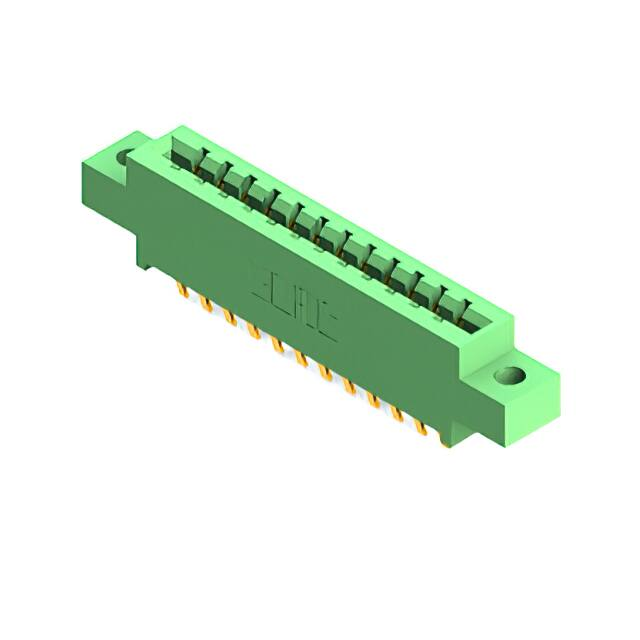

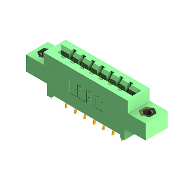

Mounting Option 04-.156 (3.96) Dia. Mounting Holes 0.370 9.40 Contact Detail THIS IS A C.A.D. GENERATED DRAWING 544-Wire Wrap .050x.025(1.27x0.64) - Tail LG=.750(19.05)DO NOT MAKE MANUAL REVISIONS TO MASTER. .156 [3.96] Contact Spacing x .200 [5.08] Row Spacing ISSUE NUMBER ORIGINAL 1 Card Slot Accepts .054 [1.37] to .070 [1.78] Thick P.C. Board 0.330 8.38 Card Slot 0.160 4.06 Point of Contact 0.156 3.96 2.192 55.68 2.338 59.39 0.600 15.24 0.420 10.67 0.170 4.32 SECTION A-A A A See Accompanying Pages for: • Contact Bend Details • Mounting Options 337 / 387 Series Card Edge Connector Part Number: 337-013-544-604 EDAC INC TORONTO, ONTARIO CANADA YOUR CONNECTION TO QUALITY & SERVICE THESE DRAWINGS AND SPECIFICATIONS ARE THE PROPERTY OF EDAC INC.,AND SHALL NOT BE REPRODUCED,OR COPIED OR USED AS THE BASIS FOR THE MANUFACTURE OR SALE OF APPARATUS WITHOUT WRITTEN PERMISSION. ACAD REFERENCE NO. DRAWN: J.LEE DATE: CHECKED: SCALE: 337 ENG MASTER DATE: OCT. 06/09 NTS DRAWING NUMBER 337 Assembly SHEET 1 OF 3 ISSUE 1 ISSUE NUMBER THIS IS A C.A.D. GENERATED DRAWING DO NOT MAKE MANUAL REVISIONS TO MASTER. 0.120 3.05 0.635 16.13 0.635 16.13 0.235 5.97 0.285 7.24 0.095 2.41 0.245 6.22 .125 [3.18] to .185 [4.70] Outside Tails .045 [1.14] to .060 [1.52] Between Tails .045 [1.14] to .060 [1.52] Between Tails 556 Contact Code 1 0.165 4.19 0.170 4.32 .125 [3.18] to .210 [5.33] Outside Tails 555 Contact Code ORIGINAL 0.375 9.53 0.200 5.08 0.060 1.52 558 Contact Code 0.150 3.81 559 Contact Code 337 / 387 Series Card Edge Connector Contact Bend Detail EDAC INC TORONTO, ONTARIO CANADA YOUR CONNECTION TO QUALITY & SERVICE .125 [3.18] to .210 [5.33] Outside Tails .045 [1.14] to .060 [1.52] Between Tails 0.060 1.52 THESE DRAWINGS AND SPECIFICATIONS ARE THE PROPERTY OF EDAC INC.,AND SHALL NOT BE REPRODUCED,OR COPIED OR USED AS THE BASIS FOR THE MANUFACTURE OR SALE OF APPARATUS WITHOUT WRITTEN PERMISSION. 560 Contact Code ACAD REFERENCE NO. DRAWN: J.LEE DATE: CHECKED: SCALE: 337 ENG MASTER DATE: OCT. 06/09 NTS DRAWING NUMBER 337 Assembly SHEET 2 OF 3 ISSUE 1 0.125 3.18 Code x01 ISSUE NUMBER THIS IS A C.A.D. GENERATED DRAWING DO NOT MAKE MANUAL REVISIONS TO MASTER. ORIGINAL 1 .128 [3.25] Dia Through Holes Code x12 .128 [3.25] Dia Through Holes 0.468 11.89 0.344 8.74 0.125 3.18 0.250 6.35 Code x02 0.060 1.52 0.116 2.95 I.D. Floating Eyelets 0.250 6.35 Dia. 0.090 2.29 .010 [0.25] Radial Float Code x03 2.755 69.98 0.328 8.33 2.505 63.63 0.005 0.13 1.550 39.37 .156 [3.96] Dia Through Holes Code x04 0.250 6.35 0.250 6.35 0.250 6.35 0.250 6.35 M3-0.5 Metric Threaded Insert 0.242 6.15 0.423 10.74 Code x58 Code x07 #4-40 UNC Threaded Insert Code x68 337 / 387 Series Card Edge Connector Mounting Options EDAC INC Code x08 TORONTO, ONTARIO CANADA YOUR CONNECTION TO QUALITY & SERVICE THESE DRAWINGS AND SPECIFICATIONS ARE THE PROPERTY OF EDAC INC.,AND SHALL NOT BE REPRODUCED,OR COPIED OR USED AS THE BASIS FOR THE MANUFACTURE OR SALE OF APPARATUS WITHOUT WRITTEN PERMISSION. Code x78 ACAD REFERENCE NO. DRAWN: J.LEE DATE: CHECKED: SCALE: 337 ENG MASTER DATE: OCT. 06/09 NTS DRAWING NUMBER 337 Assembly SHEET 3 OF 3 ISSUE 1 Mouser Electronics Authorized Distributor Click to View Pricing, Inventory, Delivery & Lifecycle Information: EDAC: 337-013-544-604
