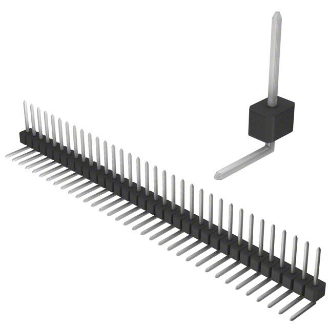

Headers .100” [2.54 mm] Contact Centers, Male Breakaway Headers, Straight/Right Angle/SMT SPECIFICATIONS • • • • • • 3 Amps current rating UL Flammability Rating: 94V-0 Insulator: PBT, PA9T, PPS, PEEK Contact Material: Phosphor Bronze See jumpers section for options available Consult Factory for PCB Layout TERMINATION TYPES STRAIGHT TERMINATIONS .100 [2.54] .100 [2.54] HEAD TAIL .200 [5.08] HEAD .100 [2.54] Headers TAIL .100 [2.54] .100 [2.54] .230 [5.84] .120 [3.05] RETENTION LEAD MOUNTING (EXAMPLE P/N: PBC36SAAR) P/N CODE AA AB AC AD AE AF AG AH AI* AJ* AK* FA FB FC FD FE FF* FG* FH* FI* FJ* ZA ZB* ZC ZD ZI* ZJ* ZO* ZQ* ZR* HEAD TAIL .230 [5.84] .120ˮ [3.05] .230 [5.84] .230ˮ [5.84] .230 [5.84] .320ˮ [8.13] .230 [5.84] .420ˮ [10.67] .23ˮ [5.84] .520ˮ [13.21] .230 [5.84] .620ˮ [15.75] .230ˮ [5.84] .720ˮ [18.29] .230ˮ [5.84] .820ˮ [20.83] .230ˮ [5.84] .900ˮ [22.86] .230ˮ [5.84] 1.000ˮ [25.40] .230ˮ [5.84] .035ˮ [0.89] .318ˮ [8.08] .120ˮ [3.05] .318ˮ [8.08] .220ˮ [5.59] .318ˮ [8.08] .320ˮ [8.13] .318ˮ [8.08] .420ˮ [10.67] .318ˮ [8.08] .520ˮ [13.21] .318ˮ [8.08] .620ˮ [15.75] .318ˮ [8.08] .710ˮ [18.03] .318ˮ [8.08] .810ˮ [20.57] .318ˮ [8.08] .910ˮ [23.11] .318ˮ [8.08] .050ˮ [1.27] .120ˮ [3.05] .120ˮ [3.05] .120ˮ [3.05] .095ˮ [2.41] .120ˮ [3.05] .260ˮ [6.60] .120ˮ [3.05] .610ˮ [15.49] .520ˮ [13.21] .110ˮ [2.79] .720ˮ [18.29] .110ˮ [2.79] .820ˮ [20.83] .110ˮ [2.79] 1.020ˮ [25.91] .110ˮ [2.79] 1.220ˮ [30.99] .110ˮ [2.79] RIGHT ANGLE TERMINATIONS .140[3.56] .100[2.54] TAIL .100 [2.54] .100 [2.54] HEAD .060 [1.52] RIGHT ANGLE (Standard) .240 [6.10] .100 [2.54] HEAD .060 [1.52] TAIL .200 [5.08] .100 [2.54] .060 [1.52] RIGHT ANGLE (Standard) HEAD RIGHT ANGLE SINGLE (Narrow) -M71, -M509, -M595 Modification Code TAIL .140 [3.56] HEAD .100 [2.54] TAIL P/N CODE BS GS ZC* ZU* HEAD TAIL .230ˮ [5.84] .318ˮ [8.08] .120ˮ [3.05] .420ˮ [10.67] .180ˮ [4.57] .180ˮ [4.57] .180ˮ [4.57] .180ˮ [4.57] *Consult factory for availability. SMT TERMINATIONS Single or Dual Row with -M30, -M508, -M596 Modification Code .100 [2.54] HEAD .100 [2.54] .200 [5.08] TAIL TAIL P/N CODE AB FB ZS* ZT* HEAD .230ˮ [5.84] .318ˮ [8.08] .120ˮ [3.05] .420ˮ [10.67] HEAD .100 [2.54] SINGLE ROW TAIL .320ˮ [8.13] .300ˮ [7.62] .200ˮ [5.08] .200ˮ [5.08] DUAL ROW TAIL .420ˮ [10.67] .400ˮ [10.16] .300ˮ [7.62] .300ˮ [7.62] *Consult factory for availability. *Consult factory for availability. TAIL SMT TERMINATIONS Single Row with -M89, -M511, -M308 Modification Code HEAD .060 [1.52] RIGHT ANGLE DUAL (Narrow) -M71, -M509, -M595 Modification Code P/N CODE BA BB BC BD BE BF** BG** BH* BI* BJ* GA GB GC** GD** GE* GF* DA** HEAD .230ˮ [5.84] .230ˮ [5.84] .230ˮ [5.84] .230ˮ [5.84] .230ˮ [5.84] .230ˮ [5.84] .230ˮ [5.84] .230ˮ [5.84] .230ˮ [5.84] .230ˮ [5.84] .318ˮ [8.08] .318ˮ [8.08] .318ˮ [8.08] .318ˮ [8.08] .318ˮ [8.08] .318ˮ [8.08] .120ˮ [3.05] TAIL .100ˮ [2.54] .200ˮ [5.08] .300ˮ [7.62] .400ˮ [10.16] .500ˮ [12.70] .600ˮ [15.24] .700ˮ [17.78] .800ˮ [20.32] .900ˮ [22.86] 1.000ˮ [25.40] .100ˮ [2.54] .200ˮ [5.08] .300ˮ [7.62] .400ˮ [10.16] .600ˮ [15.24] .800ˮ [20.32] .120ˮ [3.05] -M71, -M509 , -M595 TAIL .120ˮ [3.05] .220ˮ [5.59] .320ˮ [8.13] .420ˮ [10.67] .520ˮ [13.21] .620ˮ [15.75] .720ˮ [18.29] .820ˮ [20.83] .920ˮ [23.37] 1.020ˮ [25.91] .120ˮ [3.05] .220ˮ [5.59] .320ˮ [8.13] .420ˮ [10.67] .620ˮ [15.75] .820ˮ [20.83] .140ˮ [3.56] *Consult factory for availability. **Consult factory for availability in Dual Readout. 112 www.sullinscorp.com | 760-744-0125 | toll-free 888-774-3100 | fax 760-744-6081 | info@sullinscorp.com Headers PART NUMBER OPTIONS .100” [2.54 mm] Contact Centers, Male Breakaway Headers, Straight/Right Angle/SMT MATERIALS (INSULATOR/CONTACT) P = Black PBT or Equivalent/Phosphor Bronze Operating Temperature: -65°C to +125°C Processing Temperature: Manual/Wave Soldering G = Black PA9T/Phosphor Bronze Operating Temperature: -65°C to +150°C Processing Temperature: 260°C Max. for 10 sec. *R = Green PPS/Phosphor Bronze (Consult Factory) Operating Temperature: -65°C to +200°C Processing Temperature: 260°C Max. for 20 sec. *Q = Tan PEEK/Phosphor Bronze (Consult Factory) Operating Temperature: -65°C to +250°C Processing Temperature: 260°C Max. for 20 sec. *Available with overall gold plating ('M') only P B C 36 D AA N - Mxxx CONTACT FINISH - RoHS Compliant All platings are Lead Free and have .000050” Nickel underplate Contact Surface Termination B = .000010” Gold .000100” Pure Tin, Matte C = .000030” Gold .000100” Pure Tin, Matte E = .000100” Pure Tin, Matte, Overall G = .000010” Gold .000005” Gold S = .000010” Gold .000010” Gold Overall M = .000030” Gold .000010” Gold Overall CONTACT CENTERS C = .100” [2.54 mm] NUMBER OF POSITIONS 01 Thru 36 (eg. 36 Dual = 72 Contacts) READOUT (Opposite Page) S = Single D = Dual DIMENSIONS A 2X .050 [1.27] .100 TYP. [2.54] HEAD TAIL .025 [0.64] SQUARE POST FITS Ø .040[1.02] MINIMUM B SINGLE READOUT, STRAIGHT TAIL SHOWN 2X .050 [1.27] A .100 TYP. [2.54] HEAD TAIL .025 [0.64] SQUARE POST FITS Ø .040[1.02] MINIMUM B DUAL READOUT, STRAIGHT TAIL SHOWN MOUNTING STYLE N = No Mounting R = Retention Lead (Single Row & 'AA' Termination Only) TERMINATION TYPE (Opposite Page) Straight = AA, AB, AC, AD, AE, AF, AG, AH, AI, AJ, AK, FA, FB, FC, FD, FE, FF, FG, FH, FI, FJ, ZA, ZB, ZC, ZD, ZI, ZJ, ZO, ZQ, ZR Right Angle = BA, BB, BC, BD, BE, BF, BG, BH, BI, BJ GA, GB, GC, GD, GE, GF, DA Right Angle with -M71, -M509, -M595 Modification Code = BA, BB, BC, BD, BE, BH, BI, BJ, GA, GB, GE, GF SMT with -M89, -M511, -M308 Modification Code = BS, GS, ZC, ZU SMT with -M30, -M508, -M596 Modification Code = AB, FB, ZS, ZT PART NUMBER NUMBER OF CONTACTS SINGLE/DUAL in mm in mm _ _ C01S(D) _ _ _ _ _ C02S(D) _ _ _ _ _ C03S(D)_ _ _ _ _ C04S(D) _ _ _ _ _ C05S(D) _ _ _ _ _ C06S(D) _ _ _ _ _ C07S(D) _ _ _ _ _ C08S(D) _ _ _ _ _ C09S(D) _ _ _ _ _ C10S(D) _ _ _ _ _ C11S(D) _ _ _ _ _ C12S(D) _ _ _ _ _ C13S(D) _ _ _ _ _ C14S(D) _ _ _ _ _ C15S(D) _ _ _ _ _ C16S(D) _ _ _ _ _ C17S(D) _ _ _ _ _ C18S(D) _ _ _ _ _ C19S(D) _ _ _ _ _ C20S(D) _ _ _ _ _ C21S(D) _ _ _ _ _ C22S(D) _ _ _ _ _ C23S(D) _ _ _ _ _ C24S(D) _ _ _ _ _ C25S(D) _ _ _ _ _ C26S(D) _ _ _ _ _ C27S(D) _ _ _ _ _ C28S(D) _ _ _ _ _ C29S(D) _ _ _ _ _ C30S(D) _ _ _ _ _ C31S(D) _ _ _ _ _ C32S(D) _ _ _ _ _ C33S(D) _ _ _ _ _ C34S(D) _ _ _ _ _ C35S(D) _ _ _ _ _ C36S(D) _ _ _ 01/02 02/04 03/06 04/08 05/10 06/12 07/14 08/16 09/18 10/20 11/22 12/24 13/26 14/28 15/30 16/32 17/34 18/36 19/38 20/40 21/42 22/44 23/46 24/48 25/50 26/52 27/54 28/56 29/58 30/60 31/62 32/64 33/66 34/68 35/70 36/72 0.000 0.100 0.200 0.300 0.400 0.500 0.600 0.700 0.800 0.900 1.000 1.100 1.200 1.300 1.400 1.500 1.600 1.700 1.800 1.900 2.000 2.100 2.200 2.300 2.400 2.500 2.600 2.700 2.800 2.900 3.000 3.100 3.200 3.300 3.400 3.500 0.00 2.54 5.08 7.62 10.16 12.70 15.24 17.78 20.32 22.86 25.40 27.94 30.48 33.02 35.56 38.10 40.64 43.18 45.72 48.26 50.80 53.34 55.88 58.42 60.96 63.50 66.04 68.58 71.12 73.66 76.20 78.74 81.28 83.82 86.36 88.90 0.100 0.200 0.300 0.400 0.500 0.600 0.700 0.800 0.900 1.000 1.100 1.200 1.300 1.400 1.500 1.600 1.700 1.800 1.900 2.000 2.100 2.200 2.300 2.400 2.500 2.600 2.700 2.800 2.900 3.000 3.100 3.200 3.300 3.400 3.500 3.600 2.54 5.08 7.62 10.16 12.70 15.24 17.78 20.32 22.86 25.40 27.94 30.48 33.02 35.56 38.10 40.64 43.18 45.72 48.26 50.80 53.34 55.88 58.42 60.96 63.50 66.04 68.58 71.12 73.66 76.20 78.74 81.28 83.82 86.36 88.90 91.44 A B www.sullinscorp.com | 760-744-0125 | toll-free 888-774-3100 | fax 760-744-6081 | info@sullinscorp.com Headers Dimensions in [ ] are in millimeters, all others are in inches. MODIFICATION CODE (Consult Factory) OMIT FOR STANDARD -M500 = Brown PPS** -M594 = White PA9T*** -M30 = SMT, Vertical (M508 for brown PPS**, M596 for white PA9T***) -M89 = SMT, Horizontal (M511 for brown PPS**, M308 for white PA9T***) Available with single row only -M71 = Narrow Body (M509 for brown PPS**, M595 for white PA9T***) Available with Right Angle Only **Brown PPS available with material code 'R' only ***White PA9T available with material code 'G' only 113
PEC34SGBN
1. 物料型号:文档中列出了多种型号的直插式和SMT封装的男性断开式排母头,例如BS、GS、ZC、ZU等。
2. 器件简介:文档描述了Sullins品牌的.100" [2.54 mm]接触中心的男性断开式排母头,它们具有不同的端接类型,包括直插式、直角式和SMT。
3. 引脚分配:文档提供了详细的引脚分配表格,包括头部和尾部的尺寸,以及不同型号的排母头的引脚尺寸。
4. 参数特性: - 电流额定值:3安培 - UL阻燃等级:94V-0 - 绝缘体材料:PBT, PA9T, PPS, PEEK - 接触材料:磷青铜
5. 功能详解:文档提供了不同端接类型的详细描述,包括直插式、直角式和SMT端接,并提供了修改代码以定制特定需求。
6. 应用信息:文档中提到了不同材料和接触镀层选项,以及它们的工作温度和加工温度。
7. 封装信息:文档提供了不同封装类型的尺寸信息,包括头部和尾部的尺寸。
