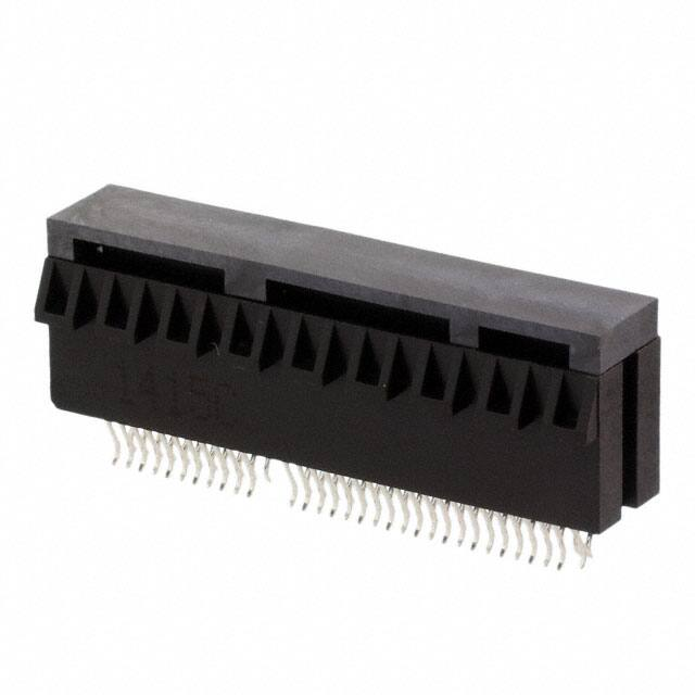

8 7 4 5 6 1 2 3 REVISIONS F 1.00 .039 PIN #A1 IDENTIFIER REV. ECO. NO DESCRIPTION DATE BY E 2536 UPDATE PROCESSING TEMP FOR "N" MTL 3/30/2012 JH F 2740 REMOVE 'NYLON 46' MATERIAL PART 04/24/2013 LH H 3463 ADD NOTE 15 06/06/2016 LH C PIN A 'N+12' 1.73±0.08 .068±.003 1.50 .059 1.50 .059 PIN A1 F E E 7.50 .295 MAX. 8.85 .348 2X 1.70±0.05 .067±.002 PIN B1 11.65 .459 14.50 .571 3.75 .148 MAX. 0.90 .035 7.00 .276 A 1.50 .059 MAX. 1.80 .071 D PIN B 'N+12' B D 4.40 .173 3.75 .148 7.80 .307 0.80 .031 C 2.50 .098 12.50 .492 10.25 .404 MAX. 3.00 .118 4.10 .161 A 0.34 .013 TYP. 1.20 .047 1.00 .039 TYP. A 10.00 .394 C 3.00 .118 SECTION A-A B A 2X 1.00 .039 0.00 +.000 D ' - 0.10 - .004 NOTES: 1. INSULATOR MATERIAL: NYLON 9T, UL 94V-0, COLOR: BLACK. 2. CONTACT MATERIAL: PHOSPHOR BRONZE. 3. CONTACT PLATING: SEE PART NUMBER CODING. 4. CURRENT RATING: 1.1 AMPS PER CONTACT. 5. VOLTAGE RATING: 50 VAC/DC. 6. INSULATOR RESISTANCE: 1000 MEGOHMS MIN. 7. CONTACT RESISTANCE: 30 MILLI OHMS MAX. 8. DIELECTRIC WITHSTANDING: 500 VAC. 9. OPERATING TEMP.: -10 C TO + 85 C 10. PROCESSING TEMP.: 260 C FOR 10 SEC. MAX. 11. BOARD THICKNESS ACCOMMODATED: 1.57mm 0.13[.062 .005] 12. INSERTION FORCE: 117.3g(1.173N) MAX PER CONTACT PAIR WHEN USING A 1.70mm[.067"] TEST BLADE. 13. WITHDRAWAL FORCE: 15.31g(0.153N) MIN PER CONTACT PAIR USING A 1.44mm[.057"] PCB. 14. CAP NEEDS TO BE ON DURING IR REFLOW PROCESS TO PREVENT WARPAGE. 15. MATERIAL CODE "N" EQUIVALENT TO "G". 8 7 6 5 B DRAWN UNLESS OTHERWISE SPECIFIED: DIMENSIONS ARE IN MM[INCHES] Pb TOLERANCES: ANGULAR: RoHS COMPLIANT 4 5 .X= 0.35 [.014] .XX= 0.25 [.010] .XXX= 0.080 [.0031] DATE NAME 07/08/09 JH THE INFORMATION HEREIN CONTAINS PROPIETARY INFORMATION OF SULLINS ELECTRONICS AND IS NOT TO BE REPRODUCED, USED OR DISCLOSED TO OTHERS FOR ANY PURPOSE EXCEPT AS SPECIFICALLY AUTHORIZED IN WRITING BY AN OFFICER OF SULLINS ELECTRONICS. TITLE PART NUMBER SIZE C 3 A PCI E, STRADDLE MOUNT, NO PEGS G_E_ _DHRN-T941 CAGE CODE 54453 DWG. NO. REV 11044 H SCALE: 3:1 SHEET 1 OF 2 2 1 FILE NAME: Z:\ECO RELEASED\3463, PCI E 1.0mm CC, STRADDLE TYPE, DWG 11042, 11043 AND 11044\11044, G_E_ _DHRN-T941 PRINT: 6/13/2016 8 7 4 5 6 1 2 3 0.70±0.05 .028±.002 F 1.00 .039 CL 1.90±0.06 .075±.002 0.70±0.05 .028±.002 3.20 .126 PIN B12 E 2. PIN B11 D 1.57±0.13 .062±.005 PIN B 'N+11' 1. 10 SPACES @1.00 [.039]EACH D E 1.40 .055 1. 5.60 .220 A 10.00 .394 20.0°±2° 2.40 .094 PIN 'K' G 2X 0.50[.020]X 45 1.00 .039 TYP. I/O PANEL DIRECTION PRIMARY (COMPONENT) SIDE +0.05 +.002 1.57 .062 0.00 - .000 E 0.05[ .002] 13.50 .531 'N' SPACES @1.0[.039] EACH=H 12.15 .478 5.10 .201 3.00 .118 1.50 .059 4X 0.50[.020]x45 D 0.50 .020 B 1.00 .039 B 3.00±0.05 .118±.002 7.00 .276 MAX. 30.0° CL C C SECTION B-B SCALE 3 : 1 RECOMMENDED PCB LAYOUT OF TYPE 1 PIN A11 1. 2.40 .094 PIN 'K' F 1.00 .039 PIN B1 8.40 .331 0.70±0.05 .028±.002 CL PIN A1 PIN A12 PIN A 'N+12' A 0.05[ .002] 10.00 .394 CL 2X 0.50[.020]X 45 +0.05 +.002 1.57 .062 0.00 - .000 3.20 .126 3.00±0.05 .118±.002 B B I/O PANEL DIRECTION SECONDARY (SOLDER) SIDE RECOMMENDED PCB LAYOUT OF TYPE 2 DRAWN A UNLESS OTHERWISE SPECIFIED: DIMENSIONS ARE IN MM[INCHES] Pb 1. NO TIE BAR PERMITTED FROM CARD EDGE TO LEADING EDGE OF PAD FOR PINS 'A1' AND 'K'. 2. CHAMFER EDGES MUST BE FREE OF CUTTING BURR. TOLERANCES: ANGULAR: RoHS COMPLIANT 8 7 6 5 4 5 .X= 0.35 [.014] .XX= 0.25 [.010] .XXX= 0.080 [.0031] DATE NAME 07/08/09 JH THE INFORMATION HEREIN CONTAINS PROPIETARY INFORMATION OF SULLINS ELECTRONICS AND IS NOT TO BE REPRODUCED, USED OR DISCLOSED TO OTHERS FOR ANY PURPOSE EXCEPT AS SPECIFICALLY AUTHORIZED IN WRITING BY AN OFFICER OF SULLINS ELECTRONICS. TITLE C 3 PCI E, STRADDLE MOUNT, NO PEGS PART NUMBER SIZE A G_E_ _DHRN-T941 CAGE CODE 54453 DWG. NO. REV 11044 H SCALE: 2:1 SHEET 2 OF 2 2 1 FILE NAME: Z:\ECO RELEASED\3463, PCI E 1.0mm CC, STRADDLE TYPE, DWG 11042, 11043 AND 11044\11044, G_E_ _DHRN-T941 PRINT: 6/13/2016
