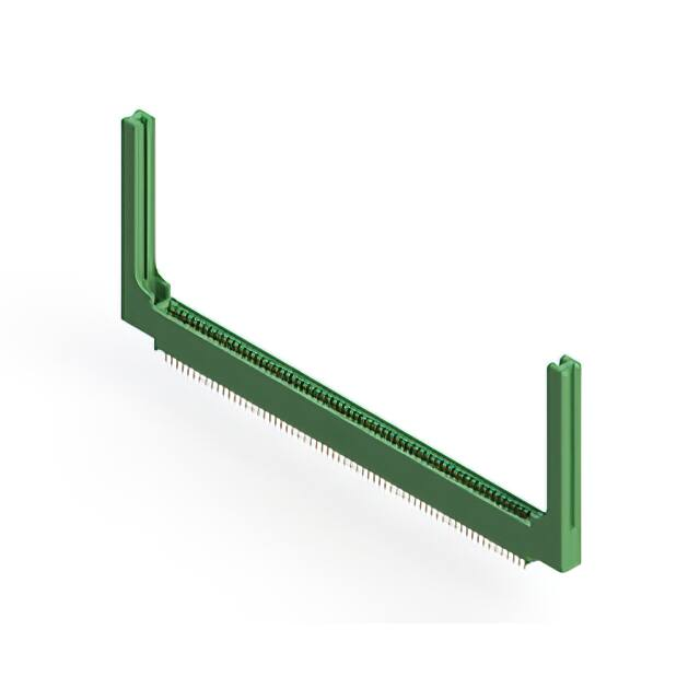

345/395 SERIES Card Edge Connectors 0.100” (2.54mm) Pitch Features: • • • • • • • • • • 0.100” (2.54mm) contact spacing x 0.200” (5.08mm) row spacing Accepts 0.062” (1.57mm) nominal thickness P.C. board High profile insulator body, 0.600” (15.24mm) Contact termination options include P.C. tail, wire wrap, 90 degree bends and extender board bends Single or dual row configurations Large variety of mounting options, flush or offset lugs Accepts between contact and in-contact polarizing keys Pre-assembled card guides are available Automatic wire wrap positioning holes RoHS Compliant & UL Certified Specifications: Insulator Material UL 94V-0 Thermoplastic Polyester Contact Material Copper Alloy Contact Plating Gold Plating on mating area and Tin Plating on tails with Nickel underplating all over Current Rating 3 amps Contact Resistance 10 milliohms maximum Dielectric Withstanding Voltage 1200 V AC rms at sea level between adjacent contacts Insulation Resistance 5000 megaohms minimum Operating Temperature -40°C to +105°C Insertion Force 16 oz (4.45 N) maximum per contact pair when tested with .070” (1.78mm) thick gauge Withdrawal Force 1 oz (0.28 N) minimum per contact pair when tested with .054” (1.37mm) thick gauge Contact Code: Tail Description: Tail Size: Tail Length “G”: 500 Wire Hole .050 x .025 (1.27 x 0.64) .260 (6.60) 520 P.C. Tail .030 x .018 (0.76 x 0.46) .175 (4.45) Contact Code 521 P.C. Tail .025 Square (0.64 Square) .150 (3.81) Contact Rows and Insulator Style 523 P.C. Tail .025 Square (0.64 Square) .390 (9.91) Mounting Options 524 P.C. Tail .018 Square (0.46 Square) .175 (4.45) 525 P.C. Tail .018 Square (0.46 Square) .150 (3.81) 540 Wire Wrap .025 Square (0.64 Square) .560 (14.22) 541 Wire Wrap .025 Square (0.64 Square) .750 (19.05) 542 Wire Wrap .025 Square (0.64 Square) .645 (16.38) 544 Wire Wrap .050 x .025 (1.27 x 0.64) .750 (19.05) 555 EXTENDER BOARD BEND (CODE 500 CONTACTS) 556 EXTENDER BOARD BEND (CODE 520 CONTACTS) 558 90 DEGREE BEND (CODE 541 CONTACTS) 559 90 DEGREE BEND (CODE 541 CONTACTS) 560 EXTENDER BOARD BEND (CODE 523 CONTACTS) Example Part Number: 345-050-520-202 Series Total Number of Contacts Series: Insulator Color: 345 Thermoplastic Polyester, Green 395 Thermoplastic Polyester, Black Total Number of Contacts: Contact Rows: 005, 006, . . . . 072 Single Row 010, 012, . . . . 144 Dual Row Insulator Style: Description: Insulator Style 1 Single Row Flush Mounting Lugs 2 Dual Row Flush Mounting Lugs 4 Single Row .110 (2.79) Offset Lugs 5 Dual Row .110 (2.79) Offset Lugs Mounting Options: Description: No Mounting Lug 6 Single Row .170 (4.32) Offset Lugs 01 8 Dual Row .170 (4.32) Offset Lugs 02 Ø.128” (Ø3.25mm) Mounting Holes 03 Ø.116” (Ø2.95mm) I.D. Floating Eyelets 04 Ø.156” (Ø3.96mm) Mounting Holes 07 M3-0.5 Metric Threaded Inserts 08 #4-40 Unified Threaded Inserts 12 Ø.128” (Ø3.25mm) Side Mounting Holes 58 .468” (11.89mm) Offset Card Guides 78 In-Line Card Guides 2.750” (69.85mm) Long 88 In-Line Card Guides 1.250” (31.75mm) Long Ordering Code Notes: 1) All connector sizes up to 72 contacts single row / 144 contacts dual row are available upon request. 2) The 500 contact code is only available in the 345 series. Green Diallyl Phthalate insulator material will be supplied. 3) For details of the extender board and 90 degree bends refer to next pages. 4) For lug-less connectors, code 01 mounting, specify contact row code 1 or 2. 5) For details of the mounting options refer to page 3 & page 4. www.edac.net customerservice@edac.net 345/395 SERIES Card Edge Connectors 0.100” (2.54mm) Pitch SECTIONS THROUGH CONTACT POSITION DUAL ROW SINGLE ROW 0.025±0.005 (NOSE GAP) "A" AUTOMATIC WIRE WRAP POSITIONING HOLE AND SLOT "B" .330 (8.38) CARD SLOT "C" .600 (15.24) .160 (4.06) POINT OF CONTACT .370 (9.40) EVEN NUMBERED SIDE OF CONNECTOR (2,4,6,8...) 0.200(5.08) CARD SLOT ACCEPTS .054 (1.37) TO .070 (1.78) THICK P.C. BOARD .128 (3.25) DIA THROUGH HOLES B "D" .250 (6.35) .250 (6.35) .170 (4.32) OR .110 (2.79) OFFSET LUGS G 0.125(3.18) B FLUSH MTG. LUG FOR RIGHT ANGLE MOUNTING WITH FLUSH OR OFFSET LUGS .100 (2.54) .030 (0.76) X .080 (2.03) WIRE HOLE .125 (3.18) "E" SEE SHEET 3 "F" .200 (5.08) FOR CONTACT CODES, DESCRIPTION AND TAIL SIZES, SEE SHEET 1 FOR 90°, EXTENDER BOARD BENDS CONTACTS, SEE SHEET 3 FOR IN CONTACTS AND BETWEEN CONTACTS POLARIZING KEYS PART NO., SEE SHEET 1 .136 (3.45) DIA REF 0.100 .400 (10.16) 0.055 (1.40) .042 (1.07) .080 (2.03) CUT OUT FOR IN-CONTACT POLARIZING KEY. CUT OUT FOR BETWEEN CONTACT POLARIZING KEY. +.000 D MINUS .012 (0.30) -.015 (0.38) RECOMMENDED DAUGHTER BOARD NUMBER OF CONTACTS "A"±.015 (±0.38) .200 PANEL MOUNT (5.08) CUT OUT .350 (8.89) .100 (2.54) .140 (3.56) PANEL MOUNT E .042 (1.07) +.004 (0.10)/-.000 FOR ALL P.C. TAILS EXCEPT CODE 524 .031 (0.79) +.004 (0.10)/-.000 FOR CODE 524 P.C. TAIL .008 (0.20) DIA CONNECTOR MOUNTING PATTERN "B"±.010 (±0.25) B "C"±.015 (±0.38) "D"+.010 /-.006 (+0.25/-0.15) “E”±.005 (±0.13) Single Double Inch mm Inch mm Inch mm Inch mm Inch mm 5 10 1.335 33.91 1.075 27.31 0.760 19.30 0.600 15.24 0.400 10.16 10 20 1.835 46.61 1.575 40.01 1.260 32.00 1.100 27.94 0.900 22.86 13 26 2.135 54.23 1.875 47.63 1.560 39.62 1.400 35.56 1.200 30.48 15 30 2.335 59.31 2.075 52.71 1.760 44.70 1.600 40.64 1.400 35.56 18 36 2.635 66.93 2.375 60.33 2.060 52.32 1.900 48.26 1.700 43.18 22 44 3.035 77.09 2.775 70.49 2.460 62.48 2.300 58.42 2.100 53.34 25 50 3.335 84.71 3.075 78.11 2.760 70.10 2.600 66.04 2.400 60.96 30 60 3.835 97.41 3.575 90.81 3.260 82.80 3.100 78.74 2.900 73.66 31 62 3.935 99.95 3.675 93.35 3.360 85.34 3.200 81.28 3.000 76.20 36 72 4.435 112.65 4.175 106.05 3.860 98.04 3.700 93.98 3.500 88.90 43 86 5.135 130.43 4.875 123.83 4.560 115.82 4.400 111.76 4.200 106.68 50 100 5.835 148.21 5.575 141.61 5.260 133.60 5.100 129.54 4.900 124.46 60 120 6.835 173.61 6.575 167.01 6.260 159.00 6.100 154.94 5.900 149.86 72 144 8.035 204.09 7.775 197.49 7.460 189.48 7.300 185.42 7.100 180.34 www.edac.net customerservice@edac.net 345/395 SERIES Card Edge Connectors 0.100” (2.54mm) Pitch .250 (6.35) DIA A .010 (0.25) RADIAL FLOAT DIA THROUGH HOLES 0.328(8.33) CONNECTOR CONNECTOR C DIMENSION DIMENSION CONNECTOR B MOUNTING OPTION CODES x02 AND xO4 (THROUGH MOUNTING HOLES) MOUNTING OPTION CODE x01 (NO MOUNTING LUGS) B DIMENSION .005 (0.51) VERTICAL FLOAT .116 (2.95) I.D. FLOATING EYELETS MOUNTING OPTION CODE x03 (FLOATING EYLETS) CODE x07 M3-0.5 METRIC CODE x08 #4-40 UNC THREADED INSERTS .128 (3.25) DIA THROUGH HOLES CODE X02 AND X04- THROUGH MTG. HOLES 0.125(3.18) CONNECTOR DIMENSION CONNECTOR DIMENSION B "A" DIA. B CODE X08 M3-0.5(METRIC) CODE X17 #4-40 UNC CODE X18 M3-0.5(METRIC) #4-40 UNC CODES X78 AND X88- IN-LINE CARD GUIDES .120 (3.05) "A" CODE X78 CODE X88 2.750(69.85) 1.250(31.75) CARD GUIDE 2.755 (69.98) A CONNECTOR CONNECTOR .250 (6.35) .250 (6.35) #4-40 UNC THREADED INSERT #4-40 UNC THREADED INSERT B MOUNTING OPTION CODES x78 & x88 (IN-LINE CARD GUIDE) www.edac.net 0.156(3.96) SIDE MOUNTING HOLES WITH INSERTS .468 (11.89) 0.083(2.11) CONNECTOR DIMENSION 0.128(3.25) CODE X07 INSERT INSERT CARD GUIDE CODE X04 CODE X07 AND X08- THREADED INSERTS MOUNTING OPTION CODES x07 & xO8 (THREADED INSERTS) MOUNTING OPTION CODE x12 (SIDE MOUNTING HOLES) WITH INSERTS: CODES X17 & X18, SEE TABLE CODE X02 CONNECTOR DIMENSION B .402 (10.21) MOUNTING OPTION CODES x58 (OFFSET CARD GUIDES) customerservice@edac.net Mouser Electronics Authorized Distributor Click to View Pricing, Inventory, Delivery & Lifecycle Information: EDAC: 345-048-524-478 345-048-524-603 345-048-524-607 345-048-524-658 345-048-540-108 345-048-540-112 345048-540-478 345-048-540-603 345-048-540-608 345-048-541-102 345-048-541-107 345-048-541-404 345-048541-412 345-048-541-488 345-048-541-603 345-048-541-608 345-048-541-678 345-048-542-107 345-048-542-404 345-048-542-408 345-048-542-478 345-048-542-608 345-048-544-101 345-048-544-112 345-048-544-188 345048-544-402 345-048-544-488 345-048-544-588 345-048-544-604 345-048-544-612 345-048-544-878 345-048544-888 345-048-555-203 345-048-555-208 345-048-555-278 345-048-555-558 345-048-555-578 345-048-555-803 345-048-555-858 345-048-556-288 345-048-556-578 345-048-556-803 345-048-558-101 345-048-558-112 345048-558-404 345-048-558-458 345-048-558-507 345-048-558-512 345-048-558-588 345-048-558-803 345-048558-808 345-048-559-278 345-048-559-403 345-048-559-558 345-048-559-602 345-048-559-607 345-048-560-208 345-048-560-807 345-048-560-858 345-049-500-103 345-049-500-402 345-049-500-602 345-049-520-103 345049-520-188 345-049-520-403 345-049-520-408 345-049-520-478 345-049-520-658 345-049-521-104 345-049521-107 345-049-521-112 345-049-521-188 345-049-521-478 345-049-521-488 345-049-521-612 345-049-523-102 345-049-523-404 345-049-523-488 345-049-523-604 345-049-524-402 345-049-524-403 345-049-524-458 345049-524-658 345-049-540-103 345-049-540-108 345-049-540-178 345-049-540-478 345-049-540-602 345-049540-607 345-049-541-178 345-049-541-404 345-049-541-408 345-049-541-603 345-049-541-608 345-049-542-104 345-049-542-188 345-049-542-688 345-049-544-107 345-049-544-158 345-049-544-412
345-126-541-201
物料型号:345/395系列
器件简介:EDAC cardEDGE 卡边缘连接器,具有0.100英寸(2.54mm)的接触间距和0.200英寸(5.08mm)的行间距。
引脚分配:接受0.062英寸(1.57mm)标称厚度的PCB板,提供单排或双排配置。
参数特性: - 绝缘体材料:UL 94V-0热塑性聚酯 - 接触材料:铜合金 - 接触镀层:接触区域的金镀层和尾部的锡镀层,整体镍底层 - 电流额定值:3安培 - 接触电阻:最大10毫欧姆 - 介电耐压:在海平面上相邻接触之间1200V AC rms - 绝缘电阻:最小5000兆欧姆 - 工作温度:-40°C至+105°C - 插入力:每对接触最大16盎司(4.45牛顿),使用0.070英寸(1.78mm)厚的测量仪 - 拔出力:每对接触最小1盎司(0.28牛顿),使用0.054英寸(1.37mm)厚的测量仪
功能详解:提供多种接触终止选项,包括PCB尾部、线绕、90度弯曲和扩展板弯曲。还有多种安装选项,包括齐平或偏移的凸耳。
应用信息:RoHS合规和UL认证。
封装信息:高轮廓绝缘体体,尺寸为0.600英寸(15.24mm)。提供预装卡片指南和自动线绕定位孔。
