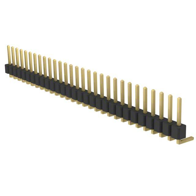

    弯插,P=2.54mm
    排针 间距:2.54mm 1x27P 弯插
PRPC027SBAN-M71RC 数据手册
8 7 4 5 6 1 2 3 REVISIONS REV. ECO. NO DESCRIPTION DATE BY A 2268 INITIAL RELEASE 03/21/2011 LH B 2422 ADD 'P' PLATING OPTION 08/08/2011 GC F F E E B .012[ 0.30] .098 2.50 A TAIL DIM. .012[0.30] D D HEAD DIM. .098 2.50 .100 2.54 .158 4.02 .025 0.64 C C A .100 2.54 RECOMMENDED PCB LAYOUT B A .039 1.00 B NOTES: 1. INSULATOR MATERIAL: SEE PART NUMBER CODING, UL 94V-0, BLACK. 2. CONTACT MATERIAL: SEE PART NUMBER CODING. 3. CONTACT PLATING: SEE PART NUMBER CODING. 4. CURRENT RATING: 3 AMPS PER CONTACT. 5. INSULATOR RESISTANCE: 5000 MEGOHMS MIN. 6. CONTACT RESISTANCE: 20 MILLIOHMS MAX. 7. DIELECTRIC WITHSTANDING: 1000 VAC. 8. OPERATING TEMPERATURE: SEE PART NUMBER CODING. 9. *PROCESSING TEMP.: SEE PART NUMBER CODING. DRAWN *INDICATED TEMPERATURE AND TIME IS FOR COMPONENT INSULATOR. HIGHER PROCESSING TEMPERATURES MAY BE USED, PROVIDED HEAT IS APPLIED FROM BACK SIDE OF PCB, AND INSULATOR DOES NOT EXCEED INDICATED TEMPERATURE AND TIME. 8 7 6 5 UNLESS OTHERWISE SPECIFIED: DIMENSIONS ARE IN INCHES [MM] Pb TOLERANCES: ANGULAR: .XX= .012 [.30] .XXX= .008 [.20] .XXXX= .0040 [.100] RoHS COMPLIANT 4 INTERPRET DIMENSIONS AND TOLERANCING PER: ASME Y14.5M-2009 3 DATE NAME 03/21/2011 LH THE INFORMATION HEREIN CONTAINS PROPIETARY INFORMATION OF SULLINS ELECTRONICS AND IS NOT TO BE REPRODUCED, USED OR DISCLOSED TO OTHERS FOR ANY PURPOSE EXCEPT AS SPECIFICALLY AUTHORIZED IN WRITING BY AN OFFICER OF SULLINS ELECTRONICS. TITLE HEADER MALE .100"[2.54mm]PITCH, RA PART NUMBER SIZE C _ R _C_ _ _S_ _N-M71RC CAGE CODE 54453 SCALE: 4:1 2 DWG. NO. 11637 SHEET 1 OF 1 1 REV B FILE NAME: Z:\ECO PENDING\2422, TAIWAN HEADER 100 CC ADD P PLATING\11637, _ R_C_ _ _S_ _N-M71RC PRINT: 8/26/2011 A
PRPC027SBAN-M71RC
1. 物料型号:N-M71RC 2. 版本信息: - 初始发布:2011年3月21日,版本A - 添加镀层选项:2011年8月8日,版本B 3. 绝缘体/接触材料: - PR=PBT/黄铜,工作温度:-40°C至+105°C - NR=尼龙6T/黄铜,工作温度:-40°C至+105°C 4. 引脚分配:文档列出了不同型号的引脚分配,包括头部尺寸、尾部尺寸、引脚间距等。 5. 参数特性: - 电流额定值:每个接触点3安培 - 绝缘体电阻:最小5000兆欧姆 - 接触电阻:最大20毫欧姆 - 耐电压:1000伏交流电 6. 功能详解:文档提供了详细的引脚分配和尺寸信息,以及加工温度和时间的说明。 7. 应用信息:文档中没有明确提供应用信息,但根据物料型号参数特性,可以推断这些连接器可能用于电子设备的电路连接。 8. 封装信息:文档提供了不同型号的封装尺寸,包括头部和尾部尺寸。
