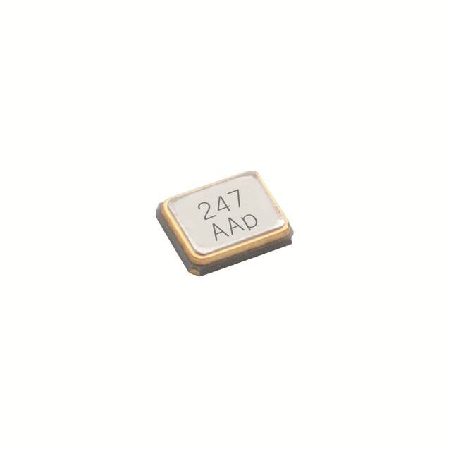

    无源晶振 120Ω 8pF 26MHz ±10ppm -10℃~+70℃ SMD1612_4P
C16-26.000-8-1010-R3 数据手册
RoHS Compliant Pb - Lead Free Ltr Revisions Appr Date Electrical Specifications: Frequency Range Mode of Oscillation Fundamental Standard Frequency Tolerance at 25°C Optional Standard Frequency Stability over Temperature Range Optional Standard Extended Operating Temperature Range Storage Temperature Range Aging Load Capacitance Shunt Capacitance Equivalent Series Resistance (ESR) Drive Level Insulation Resistance 24.000 to 48.000 24.000 to 48.000 ±30 ±25 ±20 ±15 ±10 ±50 ±30 ±25 ±20 ±15* -10 to +70 -40 to +85 -55 to +125 ±3 6 to 32 and Series Resonance 3.0 See ESR Table 100 500 at 100 Vdc ± 15Vdc MHz PPM Max (Note 1) PPM Max (Note 1) ºC PPM Max/Year Frequency Range and ESR Values: Frequency Range in MHz ESR Ohm Max Mode of Operation 24.000 to 29.999 150 Fundamental 30.000 to 36.999 100 Fundamental 37.000 to 48.000 80 Fundamental Specification Title: 11-3 Chien-Kuo Rd T.E.P.Z. 4027 Taiwan, ROC All dimensions are millimeters. CAD: TCR EG Review: JL Appr: Page: 1/4 Date: Nov 25, 2018 Microprocessor Crystal Unit Low Profile 1.2 x 1.6 millimeter Surface Mount General Product Specification Part Number: C16 Series www.aker-usa.com pF Ohm uW Max M Ohm Mechanical Outline: 1.6 ± 0.15 Ceramic Base 1.2 ± 0.15 #4 Metal Lid #3 AKER #2 #1 0.4 Max. 1.05 0.5 #2 #4 #3 0.6 0.4 0.8 0.3 #1 0.5 #2:GND #4:NC 0.75 Package is Seam Sealed Ceramic-Metal. Dimensions are millimeters. Page: 2/4 Date: July 25, 2013 P/N: www.aker-usa.com C16 Series Carrier Tape Dimensions: Dimensions are millimeters. Solder Reflow Characteristics: Page: 3/4 Date: Nov 25, 2018 P/N: www.aker-usa.com C16 Series How to build a Part Number: Series Package C 16 Frequency 24.000 to 48.000 Load Capacitance Standard Frequency Tolerance (Note 1) Option Standard Frequency Stability (Note 1) Option Standard Temperature Range Extended Packaging 6 10 12 16 18 20 32 30 25 20 15 10 50 30 25 20 15 See Notes X M R R3 - - - Parameter 1.6 x 1.2 mm Seam Seal MHz 6 pF 10 pF 12 pF 16 pF 18 pF 20 pF 32 pF ±30 PPM ±25 PPM ±20 PPM ± 15 PPM ±10 PPM ±50 PPM ±30 PPM ±25 PPM ±20 PPM ±15 PPM* -10 to +70 ºC -40 to +85 ºC 250pcs Reel 1000pcs Reel 3000pcs Reel Part Number Example: C16-40.000-10-3030-R C16- 1.6 x 2.0 mm SMD Seam Seal Crystal Unit 40.000 MHz Nominal Frequency 10 pF Load Capacitance 3030: ±30 PPM Frequency Tolerance and ±30 PPM Frequency Stability Fundamental Mode -20 to +70° C Temperature Range R: Tape and Reel Packaging - 1000pcs Notes: 1- Frequency Tolerance and Stability options are limited due to physical size. * ±10 PPM Temperature Stability is only available from -30 to +85° C. 2- Standard Temperature Range does not need to be included in Part Number description. 3- Product is shipped in Tape and Reel configuration 4- Quantities less than 250pcs are shipped in tape only. 5- Specification subject to change without notice. Page: 4/4 Date: Nov 25, 2018 P/N: www.aker-usa.com C16 Series
1. 物料型号:C16系列 2. 器件简介:这是一种低轮廓的1.2 x 1.6毫米表面贴装微处理器晶体单元。 3. 引脚分配:文档中提到了四个引脚,其中#2为GND,#4为NC(无连接)。 4. 参数特性: - 频率范围:24.000至48.000 MHz - 振荡模式:基频 - 频率容差:标准为±30 PPM,可选±25、±20、±15、±10 PPM - 温度范围内的频率稳定性:标准为±50 PPM,可选±30、±25、±20、±15 PPM - 工作温度范围:标准为-10至+70°C,扩展为-40至+85°C - 老化:±3 PPM/年 - 负载电容:6至32 pF和串联谐振 - 等效串联电阻(ESR):见ESR表 - 驱动水平:最大100微瓦 - 绝缘电阻:在100 Vdc±15Vdc时为500 MΩ 5. 功能详解:文档提供了详细的电气规格和机械轮廓,以及如何构建部件编号的指南。 6. 应用信息:适用于需要精确时钟源的微处理器应用。 7. 封装信息:封装为密封陶瓷金属,尺寸为1.6 x 1.2毫米。
