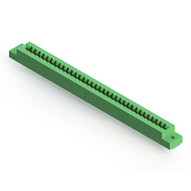

Mounting 0.500 Option 12.70 02-.128 (3.25) Dia. Mounting Holes Contact Detail 500-Wire Hole .087x.013(2.21x0.33) - Tail LG.=.282(7.16) .156 [3.96] Contact Spacing x .140 [3.56] Row Spacing ISSUE NUMBER THIS IS A C.A.D. GENERATED DRAWING DO NOT MAKE MANUAL REVISIONS TO MASTER. ORIGINAL 1 Card Slot Accepts .054 (1.37) to .070 (1.78) Thick P.C. Board 0.156 3.96 5.312 134.92 0.295 7.49 Card Slot 5.458 138.63 5.744 145.90 0.460 11.68 A A 0.090 2.29 Point of Contact 6.054 153.77 305 / 315 / 355 Card Edge Connector Part Number: 305-066-500-202 See Accompanying Page for: • Mounting Options EDAC INC TORONTO, ONTARIO CANADA YOUR CONNECTION TO QUALITY & SERVICE THESE DRAWINGS AND SPECIFICATIONS ARE THE PROPERTY OF EDAC INC.,AND SHALL NOT BE REPRODUCED,OR COPIED OR USED AS THE BASIS FOR THE MANUFACTURE OR SALE OF APPARATUS WITHOUT WRITTEN PERMISSION. SECTION A-A ACAD REFERENCE NO. J.LEE DRAWN: CHECKED: SCALE: NTS DRAWING NUMBER 305 Assembly 305 ENG MASTER DATE: SEPT. 21/09 DATE: SHEET 1 OF 2 ISSUE 1 0.125 3.18 Code x01 Code x12 ISSUE NUMBER THIS IS A C.A.D. GENERATED DRAWING DO NOT MAKE MANUAL REVISIONS TO MASTER. ORIGINAL 1 .128 [3.25] Dia Through Holes .128 [3.25] Dia Through Holes 0.468 11.89 0.344 8.74 0.125 3.18 0.060 1.52 Code x02 0.116 2.95 I.D. Floating Eyelets 0.090 2.29 0.250 6.35 Dia. .010 [0.25] Radial Float 2.750 69.85 Code x03 2.500 63.50 0.328 8.33 0.005 0.13 1.550 39.37 .156 [3.96] Dia Through Holes 0.250 6.35 Code x04 M3-0.5 Metric Threaded Insert #4-40 UNC Threaded Insert Code x68 305 / 315 / 355 Card Edge Connector Mounting Options EDAC INC Code x08 0.250 6.35 0.242 6.15 0.423 10.74 Code x58 Code x07 0.250 6.35 TORONTO, ONTARIO CANADA YOUR CONNECTION TO QUALITY & SERVICE THESE DRAWINGS AND SPECIFICATIONS ARE THE PROPERTY OF EDAC INC.,AND SHALL NOT BE REPRODUCED,OR COPIED OR USED AS THE BASIS FOR THE MANUFACTURE OR SALE OF APPARATUS WITHOUT WRITTEN PERMISSION. Code x78 ACAD REFERENCE NO. J.LEE DRAWN: CHECKED: SCALE: NTS DRAWING NUMBER 305 Assembly 305 ENG MASTER DATE: SEPT. 21/09 DATE: SHEET 2 OF 2 ISSUE 1 Mouser Electronics Authorized Distributor Click to View Pricing, Inventory, Delivery & Lifecycle Information: EDAC: 305-066-500-202

- 物料型号: 305-066-500-202 - 器件简介: 该文档是EDAC INC的CAD生成图纸,涉及305 / 315 / 355卡边缘连接器的组装。 - 引脚分配: 提供了不同代码(如Code x01, Code x02, Code x03等)的详细引脚和安装孔信息,包括直径、间距和特定功能。 - 参数特性: 包括接触点间距、行间距、卡槽尺寸等详细参数。 - 功能详解: 描述了连接器的组装和功能,如浮动眼圈、M3-0.5米制螺纹嵌入件、#4-40 UNC螺纹嵌入件等。 - 应用信息: 卡槽可接受0.054到0.070英寸厚的PCB板。 - 封装信息: 提供了详细的安装选项和安装孔尺寸。
