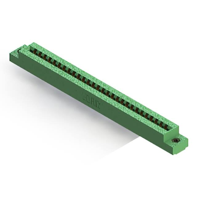

Mounting Option 102-.128 (3.25) Dia. Mounting Holes Contact Detail 500-Wire Hole .087x.015(2.21x0.38) - Tail LG.=.282(7.16) .156 [3.96] Contact Spacing with Single Centreline Row ISSUE NUMBER THIS IS A C.A.D. GENERATED DRAWING DO NOT MAKE MANUAL REVISIONS TO MASTER. ORIGINAL 1 3.898 99.01 3.732 94.79 0.128 3.25 Card Slot Accepts .054 (1.37) to .070 (1.78) Thick P.C. Board 0.343 8.71 0.295 7.49 Card Slot A 0.250 6.35 0.165 4.19 Point of Contact SECTION A-A A 0.126 3.20 0.460 11.68 See Accompanying Pages for: • Mounting Options • Features and Specifications 306 / 316 / 356 Card Edge Connector Part Number: 316-023-500-102 EDAC INC TORONTO, ONTARIO CANADA YOUR CONNECTION TO QUALITY & SERVICE THESE DRAWINGS AND SPECIFICATIONS ARE THE PROPERTY OF EDAC INC.,AND SHALL NOT BE REPRODUCED,OR COPIED OR USED AS THE BASIS FOR THE MANUFACTURE OR SALE OF APPARATUS WITHOUT WRITTEN PERMISSION. ACAD REFERENCE NO. J.LEE DRAWN: CHECKED: SCALE: NTS DRAWING NUMBER 306 Assembly 306 ENG MASTER DATE: SEPT. 14/09 DATE: SHEET 1 OF 3 ISSUE 1 0.125 3.18 Code x01 Code x12 ISSUE NUMBER THIS IS A C.A.D. GENERATED DRAWING DO NOT MAKE MANUAL REVISIONS TO MASTER. ORIGINAL 1 .128 [3.25] Dia Through Holes .128 [3.25] Dia Through Holes 0.468 11.89 0.344 8.74 0.125 3.18 0.060 1.52 Code x02 0.116 2.95 I.D. Floating Eyelets 0.090 2.29 0.250 6.35 Dia. .010 [0.25] Radial Float 2.750 69.85 Code x03 2.500 63.50 0.328 8.33 0.005 0.13 1.550 39.37 .156 [3.96] Dia Through Holes 0.250 6.35 Code x04 M3-0.5 Metric Threaded Insert #4-40 UNC Threaded Insert Code x68 306 / 316 / 356 Card Edge Connector Mounting Options EDAC INC Code x08 0.250 6.35 0.242 6.15 0.423 10.74 Code x58 Code x07 0.250 6.35 TORONTO, ONTARIO CANADA YOUR CONNECTION TO QUALITY & SERVICE THESE DRAWINGS AND SPECIFICATIONS ARE THE PROPERTY OF EDAC INC.,AND SHALL NOT BE REPRODUCED,OR COPIED OR USED AS THE BASIS FOR THE MANUFACTURE OR SALE OF APPARATUS WITHOUT WRITTEN PERMISSION. Code x78 ACAD REFERENCE NO. J.LEE DRAWN: CHECKED: SCALE: NTS DRAWING NUMBER 306 Assembly 306 ENG MASTER DATE: SEPT. 14/09 DATE: SHEET 2 OF 3 ISSUE 1 ISSUE NUMBER THIS IS A C.A.D. GENERATED DRAWING DO NOT MAKE MANUAL REVISIONS TO MASTER. ORIGINAL 1 Features • • • • • • • • 316/306/356 Series UL Recognized .156 (3.96) Contact Spacing with Single Centreline Row Accepts .062 (1.57) Nominal Thickness P.C. Board Low Profile Insulator Body .460 (11.68) Contact Termination Options include P.C. Tail, Wire Hole & Wire Wrap Large Variety of Mounting Options Pre-assembled Card Guides Available Accepts Between Contact and In-Contact Polarizing Keys Specifications • • • • • • • • • • Insulator Material: Thermoplastic Polyester, UL 94V-0 Contact Material: Copper Alloy Contact Plating: Gold on the Mating Area, Tin on the Contact Tails, Nickel Underplate Current Rating: 5 Amperes Continuous Contact Resistance: 10 Milliohms Maximum Dielectric Withstanding Voltage: 1800 V AC rms at Sea Level Between Adjacent Contacts Insulation Resistance: 5000 Megohms Minimum Operating Temperature: -65 to +105 Degrees C Insertion Force: 16 oz (4.45 N) Maximum per Contact Pair when Tested with a .070 (1.78) Thick Gauge Withdrawal Force: 1 oz (0.28 N) Minimum per Contact Pair when Tested with a .054 (1.37) Thick Gauge 306 / 316 / 356 Card Edge Connector Features and Specifications EDAC INC TORONTO, ONTARIO CANADA YOUR CONNECTION TO QUALITY & SERVICE THESE DRAWINGS AND SPECIFICATIONS ARE THE PROPERTY OF EDAC INC.,AND SHALL NOT BE REPRODUCED,OR COPIED OR USED AS THE BASIS FOR THE MANUFACTURE OR SALE OF APPARATUS WITHOUT WRITTEN PERMISSION. ACAD REFERENCE NO. J.LEE DRAWN: CHECKED: SCALE: NTS DRAWING NUMBER 306 Assembly 306 ENG MASTER DATE: SEPT. 14/09 DATE: SHEET 3 OF 3 ISSUE 1 Mouser Electronics Authorized Distributor Click to View Pricing, Inventory, Delivery & Lifecycle Information: EDAC: 316-023-500-102
316-028-521-108
1. 物料型号:文档中提到的型号是“316-023-500-102”。 2. 器件简介:文档描述了一种卡边连接器,具有多种安装选项和特性。 3. 引脚分配:文档中提到了.156 [3.96] 接触间距,单中心线排,以及多种接触终止选项,包括PC尾、线孔和绕线。 4. 参数特性: - 绝缘体材料:热塑性聚酯,UL 94V-0 - 接触材料:铜合金 - 接触镀层:接触区域金镀层,接触尾部锡镀层,镍底层 - 电流额定值:5安培连续 - 接触电阻:最大10毫欧姆 - 介电耐压:在海平面上相邻接触之间1800 V AC rms - 绝缘电阻:最小5000兆欧姆 - 操作温度范围:-65至+105摄氏度 - 插入力:最大每对接触16盎司(4.45牛顿) - 拔出力:最小每对接触1盎司(0.28牛顿) 5. 功能详解:文档提供了详细的安装选项和特性,包括接受0.062(1.57)名义厚度的PCB板,低轮廓绝缘体体,以及预装的卡导轨等。 6. 应用信息:文档提到了Mouser Electronics作为授权分销商,并提供了点击查看定价、库存、交货和生命周期信息的链接。 7. 封装信息:文档中包含了详细的图纸和规格说明,但没有提供封装的详细信息。
