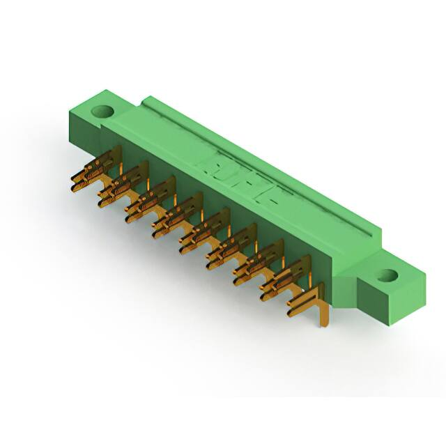

421/422/423 SERIES METAL TO METAL CARD EDGE CONNECTORS Features: • • • • • • 0.200” (5.08mm) contact spacing x 0.300” (7.62mm) row spacing with staggered grid Mount into 0.062” (1.57mm) or 0.093” (2.36mm) nominal thickness P.C. board by soldering and/or staking of P.C. tails Edacon hermaphroditic contact mating design Mounting hole and guide pin options 421 Series designed to mate with non-card guide versions of 408 or 415 Series, 422 Series designed to mate with card guide versions of 408 or 415 Series, 423 Series designed to mate with 424 or 438 Series RoHS Compliant Specifications: Insulator Material UL 94V-0 Diallyl Phthalate, Green Color Contact Material Copper Alloy Contact Plating Gold Plating over Nickel over entire contact Current Rating 10 amps Contact Resistance 10 milliohms maximum Dielectric Withstanding Voltage 2000 V AC rms at sea level Insulation Resistance 5000 megaohms minimum Operating Temperature -65°C to +125°C Insertion Force 2 to 16 oz (0.56 to 4.45 N) per contact position Withdrawal Force 2 to 16 oz (0.56 to 4.45 N) per contact position 423-041-520-102 Contact Code: Tail Description: Tail Size: Tail Length "G": 520 P.C. Tail .044 x .025 (1.12 x 0.64) .122 (3.10) Total Number of Contacts 521 P.C. Tail .044 x .025 (1.12 x 0.64) .153 (3.89) Contact Code Code: Insulator Mounting Option: Card Slot Width and Mounting Options 100 No Mounting Holes (422 Series) 102 .128 (3.25) Dia. Mounting Holes (421 Series) .128 (3.25) Dia. Mounting Holes and Guide Pins as per MIL-C-21097 (423 Series) Example Part Number: Series Series: 421 422 423 Total Number of Contacts: 017, 023, 029, 035, 041 or 047 www.edac.net customerservice@edac.net 421/422/423 SERIES METAL TO METAL CARD EDGE CONNECTORS NUMBER OF CONTACTS "A" "B" 408 424 "D" 408 424 "E" 408 "F" 408, 424 424 inch mm inch mm inch mm inch mm inch mm inch mm inch mm 17 2.406 61.11 2.570 65.28 2.134 54.20 2.300 58.42 1.920 48.77 1.600 40.64 1.900 48.26 23 3.006 76.35 3.170 80.52 2.734 69.44 2.900 73.66 2.520 64.01 2.200 55.88 2.500 63.50 29 3.606 91.59 3.770 95.76 3.334 84.68 3.500 88.90 3.120 79.25 2.800 71.12 3.100 78.74 35 4.206 106.83 4.370 111.00 3.934 99.92 4.100 104.14 3.720 94.49 3.400 86.36 3.700 93.98 41 4.806 122.07 4.970 126.24 4.534 115.16 4.700 119.38 4.320 109.73 4.000 101.60 4.300 109.22 www.edac.net customerservice@edac.net
