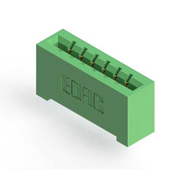

Mounting Option 02-.128 (3.25) Dia. Mounting Holes Contact Detail 542-Wire Wrap .025 Sq.(0.64 Sq.) - Tail LG=.645(16.38) .156 [3.96] Contact Spacing x .200 [5.08] Row Spacing ISSUE NUMBER THIS IS A C.A.D. GENERATED DRAWING DO NOT MAKE MANUAL REVISIONS TO MASTER. ORIGINAL 1 1.417 35.99 1.256 31.90 Card Slot Accepts .054 [1.37] to .070 (1.78) Thick P.C. Board 0.388 9.86 Card Slot 0.370 9.40 .160 [4.06] Point of Contact A 0.180 4.57 A See Accompanying Page for: • Bend Detail • Mounting Options • Features and Specifications SECTION A-A 333 Series Card Edge Connector Part Number: 333-014-542-802 EDAC INC TORONTO, ONTARIO CANADA YOUR CONNECTION TO QUALITY & SERVICE THESE DRAWINGS AND SPECIFICATIONS ARE THE PROPERTY OF EDAC INC.,AND SHALL NOT BE REPRODUCED,OR COPIED OR USED AS THE BASIS FOR THE MANUFACTURE OR SALE OF APPARATUS WITHOUT WRITTEN PERMISSION. ACAD REFERENCE NO. J.LEE DRAWN: CHECKED: SCALE: NTS DRAWING NUMBER 333 Assembly 333 ENG MASTER DATE: OCT. 14/09 DATE: SHEET 1 OF 4 ISSUE 1 ISSUE NUMBER THIS IS A C.A.D. GENERATED DRAWING DO NOT MAKE MANUAL REVISIONS TO MASTER. 0.120 3.05 0.635 16.13 0.635 16.13 0.235 5.97 0.285 7.24 0.095 2.41 0.245 6.22 .125 [3.18] to .185 [4.70] Outside Tails .045 [1.14] to .060 [1.52] Between Tails .045 [1.14] to .060 [1.52] Between Tails 556 Contact Code 1 0.165 4.19 0.170 4.32 .125 [3.18] to .210 [5.33] Outside Tails 555 Contact Code ORIGINAL 0.375 9.53 0.200 5.08 0.150 3.81 0.060 1.52 558 Contact Code .125 [3.18] to .210 [5.33] Outside Tails .045 [1.14] to .060 [1.52] Between Tails 0.060 1.52 559 Contact Code 560 Contact Code 333 Series Card Edge Connector Contact Bend Detail EDAC INC TORONTO, ONTARIO CANADA YOUR CONNECTION TO QUALITY & SERVICE THESE DRAWINGS AND SPECIFICATIONS ARE THE PROPERTY OF EDAC INC.,AND SHALL NOT BE REPRODUCED,OR COPIED OR USED AS THE BASIS FOR THE MANUFACTURE OR SALE OF APPARATUS WITHOUT WRITTEN PERMISSION. ACAD REFERENCE NO. J.LEE DRAWN: CHECKED: SCALE: NTS DRAWING NUMBER 333 Assembly 333 ENG MASTER DATE: OCT. 14/09 DATE: SHEET 2 OF 4 ISSUE 1 ISSUE NUMBER THIS IS A C.A.D. GENERATED DRAWING DO NOT MAKE MANUAL REVISIONS TO MASTER. ORIGINAL 1 .010 [0.25] Radial Float .156 [3.96] Dia Through Holes 0.116 2.95 I.D. Floating Eyelets .128 [3.25] x .146 [3.71] Slot M3-0.5 Metric Threaded Insert #4-40 UNC Threaded Insert 0.250 6.35 Dia. 0.135 3.43 .128 [3.25] Dia Through Holes 0.005 0.13 0.348 8.84 Code x01 Code x02 Code x03 Code x04 Code x07 Code x08 333 Series Card Edge Connector Mounting Options EDAC INC TORONTO, ONTARIO CANADA YOUR CONNECTION TO QUALITY & SERVICE THESE DRAWINGS AND SPECIFICATIONS ARE THE PROPERTY OF EDAC INC.,AND SHALL NOT BE REPRODUCED,OR COPIED OR USED AS THE BASIS FOR THE MANUFACTURE OR SALE OF APPARATUS WITHOUT WRITTEN PERMISSION. Code x12 ACAD REFERENCE NO. J.LEE DRAWN: CHECKED: SCALE: NTS DRAWING NUMBER 333 Assembly 333 ENG MASTER DATE: OCT. 14/09 DATE: SHEET 3 OF 4 ISSUE 1 ISSUE NUMBER THIS IS A C.A.D. GENERATED DRAWING DO NOT MAKE MANUAL REVISIONS TO MASTER. ORIGINAL 1 Features x.156 (3.96) Contact Spacing x .200 (5.08) Row Spacing xAccepts .062 (1.57) Nominal Thickness P.C. Board xHigh Profile Insulator Body .600 (15.24) xContact Termination Options include P.C. Tail, Wire Hole, Wire Wrap, 90 Degree, & Extender Board Bends xSingle or Dual Row Configurations xVariety of Mounting Options, Flush or Offset Lugs xAccepts Between Contact and In-Contact Polarizing Keys Specifications xInsulator Material: Thermoplastic Polyester, UL 94V-0, Colour: Green xContact Material: Copper, Nickel, Tin Alloy CA-725 xContact Plating: Gold on the Mating Area, Tin on the Contact Tails, Nickel Underplate xCurrent Rating: 3 Amperes Continuous xContact Resistance: 10 Milliohms Maximum xDielectric Withstanding Voltage: 1800 V AC rms at Sea Level Between Adjacent Contacts xInsulation Resistance: 5000 Megohms Minimum xOperating Temperature: -65 to +105 Degrees C xInsertion Force: 16 oz (4.45 N) Maximum per Contact Pair when Tested with a .070 (1.78) Thick Gauge xWithdrawal Force: 1 oz (0.28 N) Minimum per Contact Pair when Tested with a .054 (1.37) Thick Gauge 333 Series Card Edge Connector Features and Specifications EDAC INC TORONTO, ONTARIO CANADA YOUR CONNECTION TO QUALITY & SERVICE THESE DRAWINGS AND SPECIFICATIONS ARE THE PROPERTY OF EDAC INC.,AND SHALL NOT BE REPRODUCED,OR COPIED OR USED AS THE BASIS FOR THE MANUFACTURE OR SALE OF APPARATUS WITHOUT WRITTEN PERMISSION. ACAD REFERENCE NO. J.LEE DRAWN: CHECKED: SCALE: NTS DRAWING NUMBER 333 Assembly 333 ENG MASTER DATE: OCT. 14/09 DATE: SHEET 4 OF 4 ISSUE 1 Mouser Electronics Authorized Distributor Click to View Pricing, Inventory, Delivery & Lifecycle Information: EDAC: 333-014-542-802
333-006-524-101
1. 物料型号:333-014-542-802 2. 器件简介:文档描述了333系列卡边连接器的装配图和规格,包括接触点间距、行间距、接受的PCB板厚度、绝缘体材料、接触材料等。 3. 引脚分配:文档提供了接触点的详细尺寸和排列,例如接触点间距为0.156英寸(3.96mm),行间距为0.200英寸(5.08mm)。 4. 参数特性:包括绝缘体材料为热塑性聚酯,UL 94V-0,颜色为绿色;接触材料为铜,镀镍锡合金CA-725;接触镀层为接触区域的金和接触尾部的锡,镍底层;连续电流额定值为3安培;接触电阻最大为10毫欧姆;介电耐压为1800V交流峰值,相邻接触点间在海平面;绝缘电阻最小为5000兆欧姆;操作温度范围为-65至+105摄氏度;插入力为每对接触点最大16盎司(4.45牛顿),使用0.070英寸(1.78mm)厚的规尺测试;拔出力为每对接触点最小1盎司(0.28牛顿),使用0.054英寸(1.37mm)厚的规尺测试。 5. 功能详解:文档详细描述了连接器的特点,如高轮廓绝缘体体、多种接触终止选项、单排或双排配置、多种安装选项等。 6. 应用信息:文档提到了Mouser Electronics作为授权分销商,并提供了查看定价、库存、交货和生命周期信息的链接。 7. 封装信息:文档中没有明确提到封装信息,但提供了连接器的装配图和规格,可以推断封装相关的细节。
