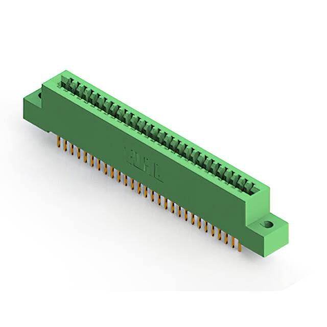

Mounting Option 03-.116 (2.95) I.D. Floating Eyelets Contact Detail 524-P.C. Tail .018 Sq.(0.46 Sq.) - Tail LG=.185(4.70) .100 [2.54] Contact Spacing x .200 [5.08] Row Spacing ISSUE NUMBER THIS IS A C.A.D. GENERATED DRAWING DO NOT MAKE MANUAL REVISIONS TO MASTER. ORIGINAL 1 2.100 53.34 1.822 46.28 1.546 39.27 0.370 9.40 1.400 35.56 0.410 10.41 0.100 2.54 Card Slot Accepts .054 [1.37] to .070 [1.78] Thick P.C. Board 0.270 6.86 0.590 14.99 A SECTION A-A A See Accompanying Pages for: • Contact Bend Details • Mounting Options 342 / 392 Card Edge Connector Part Number: 342-013-524-103 EDAC INC TORONTO, ONTARIO CANADA YOUR CONNECTION TO QUALITY & SERVICE THESE DRAWINGS AND SPECIFICATIONS ARE THE PROPERTY OF EDAC INC.,AND SHALL NOT BE REPRODUCED,OR COPIED OR USED AS THE BASIS FOR THE MANUFACTURE OR SALE OF APPARATUS WITHOUT WRITTEN PERMISSION. ACAD REFERENCE NO. J.LEE DRAWN: CHECKED: SCALE: NTS DRAWING NUMBER 342 Assembly 342 ENG MASTER DATE: OCT. 06/09 DATE: SHEET 1 OF 3 ISSUE 1 ISSUE NUMBER THIS IS A C.A.D. GENERATED DRAWING DO NOT MAKE MANUAL REVISIONS TO MASTER. 0.120 3.05 0.645 16.38 0.645 16.38 0.245 6.22 0.295 7.49 0.095 2.41 0.255 6.48 .125 [3.18] to .185 [4.70] Outside Tails .045 [1.14] to .060 [1.52] Between Tails .045 [1.14] to .060 [1.52] Between Tails 556 Contact Code 1 0.165 4.19 0.180 4.57 .125 [3.18] to .210 [5.33] Outside Tails 555 Contact Code ORIGINAL 0.385 9.78 0.200 5.08 0.060 1.52 558 Contact Code 0.150 3.81 .125 [3.18] to .210 [5.33] Outside Tails .045 [1.14] to .060 [1.52] Between Tails 0.060 1.52 559 Contact Code 560 Contact Code 342 / 392 Series Card Edge Connector Contact Bend Detail EDAC INC TORONTO, ONTARIO CANADA YOUR CONNECTION TO QUALITY & SERVICE THESE DRAWINGS AND SPECIFICATIONS ARE THE PROPERTY OF EDAC INC.,AND SHALL NOT BE REPRODUCED,OR COPIED OR USED AS THE BASIS FOR THE MANUFACTURE OR SALE OF APPARATUS WITHOUT WRITTEN PERMISSION. ACAD REFERENCE NO. J.LEE DRAWN: CHECKED: SCALE: NTS DRAWING NUMBER 342 Assembly 342 ENG MASTER DATE: OCT. 06/09 DATE: SHEET 2 OF 3 ISSUE 1 ISSUE NUMBER THIS IS A C.A.D. GENERATED DRAWING DO NOT MAKE MANUAL REVISIONS TO MASTER. ORIGINAL 1 .010 [0.25] Radial Float .156 [3.96] Dia Through Holes 0.116 2.95 I.D. Floating Eyelets .128 [3.25] x .146 [3.71] Slot M3-0.5 Metric Threaded Insert #4-40 UNC Threaded Insert 0.250 6.35 Dia. 0.135 3.43 .128 [3.25] Dia Through Holes 0.005 0.13 0.348 8.84 Code x01 Code x02 Code x03 Code x04 Code x07 Code x08 342 / 392 Card Edge Connector Mounting Options EDAC INC TORONTO, ONTARIO CANADA YOUR CONNECTION TO QUALITY & SERVICE THESE DRAWINGS AND SPECIFICATIONS ARE THE PROPERTY OF EDAC INC.,AND SHALL NOT BE REPRODUCED,OR COPIED OR USED AS THE BASIS FOR THE MANUFACTURE OR SALE OF APPARATUS WITHOUT WRITTEN PERMISSION. Code x12 ACAD REFERENCE NO. J.LEE DRAWN: CHECKED: SCALE: NTS DRAWING NUMBER 342 Assembly 342 ENG MASTER DATE: OCT. 06/09 DATE: SHEET 3 OF 3 ISSUE 1

1. 物料型号:342-013-524-103 2. 器件简介:文档中没有提供器件的简介信息。 3. 引脚分配:文档中提供了详细的引脚分配信息,包括接触细节和安装选项。 4. 参数特性:文档中提供了一些参数特性,如接触间距、行间距、卡槽接受的PCB板厚度等。 5. 功能详解:文档中没有提供功能详解。 6. 应用信息:文档中没有提供应用信息。 7. 封装信息:文档中提供了封装信息,包括接触代码和安装选项。
