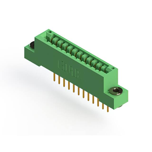

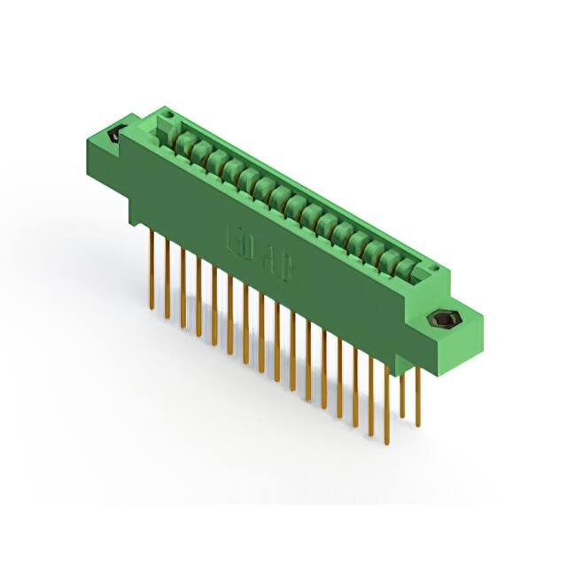

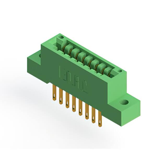

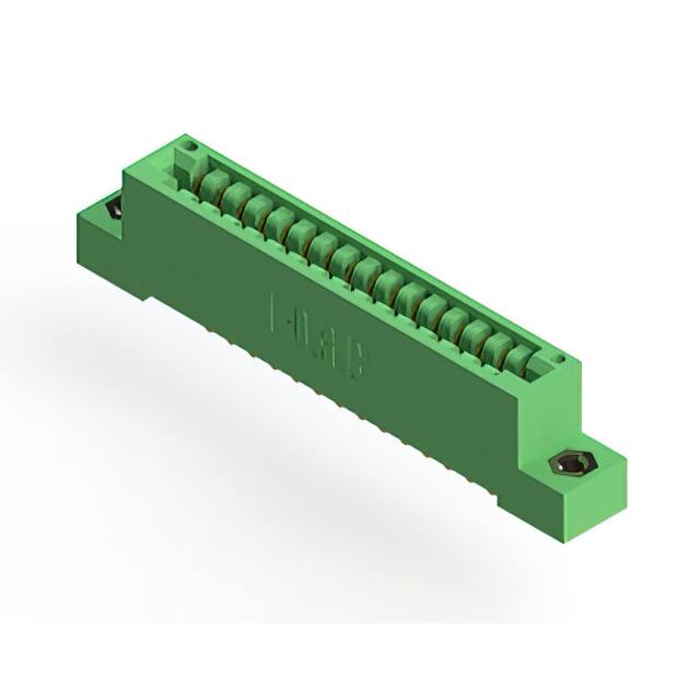

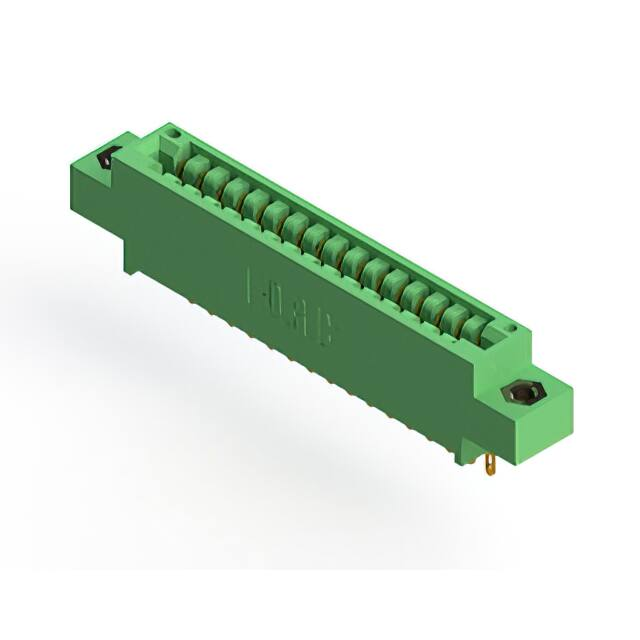

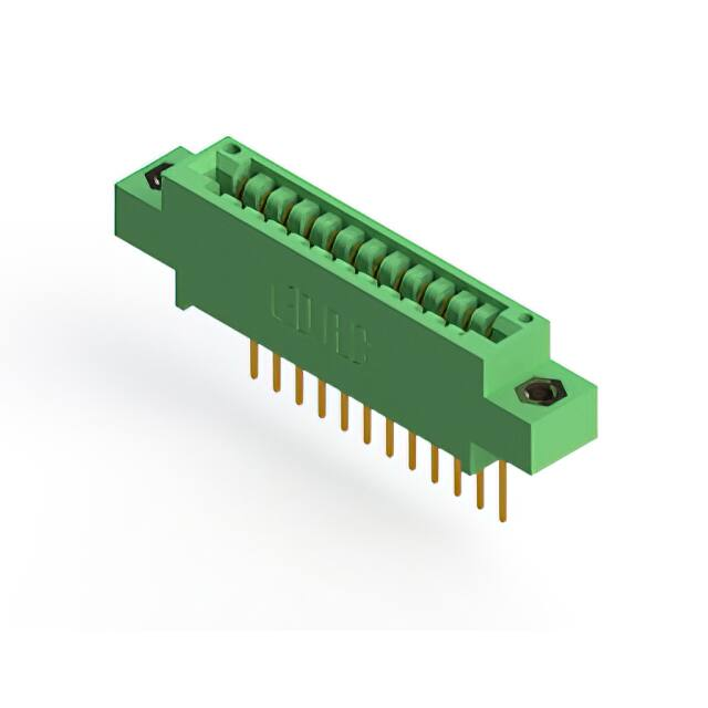

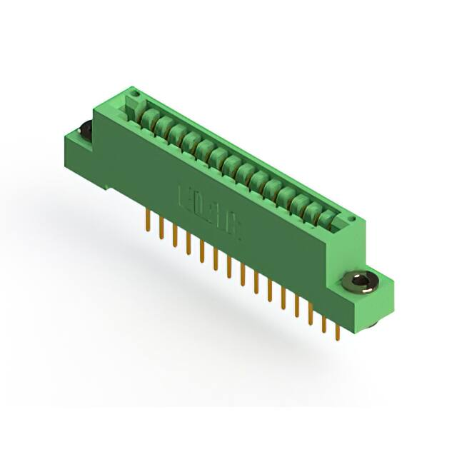

846/896 SERIES High Temp Card Edge Connectors 0.125” (3.175mm) Pitch Features: • • • • • • • • • • 0.100” (2.54mm) contact spacing x 0.200” (5.08mm) row spacing Accepts 0.062” (1.57mm) nominal thickness P.C. board High profile insulator body, 0.600” (15.24mm) Contact termination options include P.C. tail, wire wrap, wire hole, 90 degree bends and extender board bends Single or dual row configurations Large variety of mounting options, flush or offset lugs Accepts between contact and in-contact polarizing keys Pre-assembled card guides are available Automatic wire wrap positioning holes RoHS Compliant & UL Certified Specifications: Insulator Material (846: Diallyl Phthalate) (896: Polyphenylene sulfide) , UL 94V-0 Contact Material Copper Alloy Contact Plating Gold Plating on mating area and Tin Plating on tails with Nickel underplating all over Current Rating 3 amps Contact Resistance 10 milliohms maximum Dielectric Withstanding Voltage 1500 V AC rms at sea level between adjacent contacts Insulation Resistance 5000 megaohms minimum Operating Temperature -40°C to +125°C Insertion Force 16 oz (4.45 N) maximum per contact pair when tested with .070” (1.78mm) thick gauge Withdrawal Force 1 oz (0.28 N) minimum per contact pair when tested with .054” (1.37mm) thick gauge Example Part Number: 846-056-540-802 Series Total Number of Contacts Contact Code Contact Rows and Insulator Style Mounting Options Series: Insulator Color: Contact Code: Tail Description: Tail Size: Tail Length "G": 846 Green 500 Wire Hole .050 x .025 (1.27 x 0.64) .260 (6.60) 896 Black 520 P.C. Tail .025 Square (0.64 Square) .175 (4.45) Total Number of Contacts: Contact Rows: 521 P.C. Tail .025 Square (0.64 Square) .150 (3.81) 005, 006, . . . . 050 Single Row 522 P.C. Tail .025 Square (0.64 Square) .440 (11.18) 010, 012, . . . . 100 Dual Row 526 P.C. Tail .025 Square (0.64 Square) .350 (8.89) Contact Rows: Description: Insulator Style: 540 Wire Wrap .025 Square (0.64 Square) .560 (14.22) 1 Single Row Flush Mounting Lugs 541 Wire Wrap .025 Square (0.64 Square) .750 (19.05) 2 Dual Row Flush Mounting Lugs 555 EXTENDER BOARD BEND (CODE 500 CONTACTS) 6 Single Row .170 (4.32) Offset Lugs 556 EXTENDER BOARD BEND (CODE 520 CONTACTS) 8 Dual Row .170 (4.32) Offset Lugs 558 90 DEGREE BEND (CODE 541 CONTACTS) Mounting Options: Description: 559 90 DEGREE BEND (CODE 541 CONTACTS) 01 No Mounting Lug 560 EXTENDER BOARD BEND (CODE 523 CONTACTS) 02 Ø.128" (Ø3.25mm) Mounting Holes 03 Ø.116” (Ø2.95mm) I.D. Floating Eyelets 04 Ø.156" (Ø3.96mm) Mounting Holes 07 M3-0.5 Metric Threaded Inserts 08 #4-40 Unified Threaded Inserts 12 Ø.128" (Ø3.25mm) Side Mounting Holes www.edac.net Ordering Code Notes: 1) All connector sizes up to 50 contacts single row / 100 contacts dual row are available upon request. 2) For details of the extender board and 90 degree bends refer to next pages. 3) Consult with EDAC Inc. regarding connectors with a .420” (10.67mm) card slot depth. 4) For lug-less connectors, code 01 mounting, specify contact row code 1 or 2. 5) In-line card guides are only available with offset mounting lugs. 6) For details of the mounting options refer to page 3. customerservice@edac.net 846/896 SERIES High Temp Card Edge Connectors 0.125” (3.175mm) Pitch IN-CONTACT POLARIZING KEY AUTOMATIC WIRE WRAP POSITIONING SLOT AND HOLE BETWEEN CONTACT POLARIZING KEY P/N 306-240-318 P/N 345-240-328 .370 (9.40) CARD SLOT ACCEPTS .054 (1.37) TO .070 (1.78) THICK P.C. BOARD SECTIONS THROUGH CONTACT POSITION .330 (8.38) CARD SLOT .600 (15.24) .250 (6.35) .250 (6.35) FLUSH MOUNTING LUGS .160 (4.06) POINT OF CONTACT .205 (5.21) .125 (3.18) .170 (4.32) .030 (0.76) X .080 (2.03) WIRE HOLE DUAL ROW OFFSET LUGS EVEN NUMBERED SIDE OF CONNECTOR .250 (6.35) 1 3 5 7 9 11 13 15 17 19 21 23 25 27 29 2 4 6 8 10 12 14 16 18 20 22 24 26 28 30 SINGLE ROW .250 (6.35) .115 (2.92) PANEL MOUNT CUT OUT .136 (3.45) DIA REF. .350 (8.89) .400 (10.16) PANEL MOUNT CUT OUT .080 (2.03) CUT OUT FOR IN-CONTACT POLARIZING KEY .125 (3.18) .042 (1.07) +.004 (0.10)/-.000 FOR P.C. TAILS MINUS .012 (0.30) .008 (0.20) DIA NUMBER OF CONTACTS .055 (1.40) CUT OUT FOR BETWEEN CONTACT POLARIZING KEY "A" "B" "C" +.000 -.015 (0.38) "D" "E" Single Double Inch mm Inch mm Inch mm Inch mm Inch mm 5 10 1.435 36.45 1.170 29.72 0.910 23.11 1.435 36.45 0.500 12.70 6 12 1.560 39.62 1.295 32.89 1.035 26.29 1.560 39.62 0.625 15.88 10 20 2.060 52.32 1.795 45.59 1.535 38.99 2.060 52.32 1.125 28.58 15 30 2.685 68.20 2.420 61.47 2.160 54.86 2.685 68.20 1.750 44.45 18 36 3.060 77.72 2.795 70.99 2.535 64.39 3.060 77.72 2.125 53.98 22 44 3.560 90.42 3.295 83.69 3.035 77.09 3.560 90.42 2.625 66.68 25 50 3.935 99.95 3.670 93.22 3.410 86.61 3.935 99.95 3.000 76.20 30 60 4.560 115.82 4.295 109.09 4.035 102.49 4.560 115.82 3.625 92.08 31 62 4.685 119.00 4.420 112.27 4.160 105.66 4.685 119.00 3.750 95.25 35 70 5.185 131.70 4.920 124.97 4.660 118.36 5.185 131.70 4.250 107.95 36 72 5.310 134.87 5.045 128.14 4.785 121.54 5.310 134.87 4.375 111.13 40 80 5.810 147.57 5.545 140.84 5.285 134.24 5.810 147.57 4.875 123.83 43 86 6.185 157.10 5.920 150.37 5.660 143.76 6.185 157.10 5.250 133.35 50 100 7.060 179.32 6.795 172.59 6.535 165.99 7.060 179.32 6.125 155.58 www.edac.net customerservice@edac.net 846/896 SERIES High Temp Card Edge Connectors 0.125” (3.175mm) Pitch .250 (6.35) DIA A .010 (0.25) RADIAL FLOAT DIA THROUGH HOLES 0.328(8.33) CONNECTOR DIMENSION CONNECTOR C DIMENSION CONNECTOR B MOUNTING OPTION CODES x02 AND xO4 (THROUGH MOUNTING HOLES) MOUNTING OPTION CODE x01 (NO MOUNTING LUGS) MOUNTING OPTION CODE x03 (FLOATING EYLETS) CODE x07 M3-0.5 METRIC CODE x08 #4-40 UNC THREADED INSERTS .128 (3.25) DIA THROUGH HOLES B DIMENSION .005 (0.51) VERTICAL FLOAT .116 (2.95) I.D. FLOATING EYELETS CODE X02 AND X04- THROUGH MTG. HOLES "A" DIA. CODE X02 CODE X04 0.128(3.25) 0.156(3.96) CODE X07 AND X08- THREADED INSERTS 0.125(3.18) CODE X07 INSERT CONNECTOR B DIMENSION CONNECTOR B DIMENSION MOUNTING OPTION CODE x12 (SIDE MOUNTING HOLES) WITH INSERTS: CODES X17 & X18, SEE TABLE M3-0.5(METRIC) CODE X08 #4-40 UNC SIDE MOUNTING HOLES WITH INSERTS CODE X17 MOUNTING OPTION CODES x07 & xO8 (THREADED INSERTS) INSERT M3-0.5(METRIC) CODE X18 #4-40 UNC .120 (3.05) "A" .045 (1.14) TO .060 (1.52) BETWEEN TAILS .125 (3.18) TO .210 (5.33) OUTSIDE TAILS CONTACT CODE 555 BEND USES WIRE HOLE CONTACTS .095 (2.41) "A" .045 (1.14) TO .060 (1.52) BETWEEN TAILS .125 (3.18) TO .185 (4.70) OUTSIDE TAILS NUMBERED SIDE, EVEN NUMBERED SIDE OR ROW "A" SIDE OF CONNECTOR (DEPENDIND UPON SERIES) NUMBERED SIDE, EVEN NUMBERED SIDE OR ROW "A" SIDE OF CONNECTOR (DEPENDIND UPON SERIES) .060 (1.52) .060 (1.52) .200 (5.08) "A" "B" THIS CONTACT ROW IS STANDARD FOR SINGLE ROW BEND CONTACT CODE 558 "A" "B" CONTACT CODE 556 .165 (4.19) .150 (3.81) "A" THIS CONTACT ROW IS STANDARD FOR SINGLE ROW BEND .045 (1.14) TO .060 (1.52) BETWEEN TAILS CONTACT CODE 559 .125 (3.18) TO .210 (5.33) OUTSIDE TAILS CONTACT CODE 560 www.edac.net customerservice@edac.net
