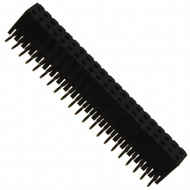

    CONN HDR 42P 0.079 GOLD PCB R/A
NPPN212FJFN-RC 数据手册
8 7 4 5 6 1 2 3 REVISIONS F REV. ECO. NO E 2515 F 3120 H 3473 DESCRIPTION DATE REMOVE CONTACT DEPTH TOLERANCE ADD 01/13/2012 "REF.", ADD NOTE 10 MATING PARTS UPDATE PROCESSING TEMPERATURE FOR NYLON 6T MATERIAL, INSERTION DEPTH TO 1.81mm (WAS 1.85mm), CURRENT RATING TO 2 AMPS 04/15/2015 (WAS 1 AMP), UPDATE STRAIGHTNESS TOL ADD 30u GOLD/GOLD FLASH PLATING OPTION, UPDATE PN CODING FROM NPxNxx2FJFN-RC TO 4/13/2016 NP_N_ _2FJFN-RC BY LH F LH JH E E .191 4.85 A±.004 [ 0.10] .031±.002 0.80±0.05 .079±.002 2.00±0.05 D D .079±.004 2.00±0.10 .020±.002 0.50±0.05 .079±.002 2.00±0.05 A .008[ 0.20] RECOMMENDED PCB LAYOUT 02-20, 0.20mm MAX. 21-30, 0.30mm MAX. 31-40, 0.40mm MAX. C .079±.002 2.00±0.05 C B .014 [ 0.35] .057±.002 1.45±0.05 .071 1.81 .283 7.20 .079±.004 2.00±0.10 B A NOTES: 1. INSULATOR MATERIAL: SEE PART NUMBER CODING. 2. CONTACT MATERIAL: PHOSPHOR BRONZE. 3. CONTACT PLATING: SEE PART NUMBER CODING. 4. CURRENT RATING: 2 AMPS. 5. INSULATOR RESISTANCE: 5000 MEGOHMS MIN. 6. CONTACT RESISTANCE: 20 MILLIOHMS MAX. 7. DIELECTRIC WITHSTANDING: 500 V AC. 8. OPERATING TEMPERATURE: -40° C TO +105° C. 9. PROCESSING TEMP.: WAVE/MANUAL SOLDERING ONLY 10.MATES WITH SULLINS .079 [2.00] CONTACT CENTER MALE HEADER SERIES. (.020 [0.50] SQUARE POSTS) 8 7 6 5 B .118±.008 3.00±0.20 .008±.002 0.20±0.05 Pb RoHS COMPLIANT 4 UNLESS OTHERWISE SPECIFIED: DIMENSIONS ARE IN INCHES [MM] TOLERANCES: ANGULAR: DECIMALS .X= .012 [.30] .XX= .008 [.20] .XXX= .006 [.15] DRAWN DATE NAME 01/09/2009 JH THE INFORMATION HEREIN CONTAINS PROPIETARY INFORMATION OF SULLINS ELECTRONICS AND IS NOT TO BE REPRODUCED, USED OR DISCLOSED TO OTHERS FOR ANY PURPOSE EXCEPT AS SPECIFICALLY AUTHORIZED IN WRITING BY AN OFFICER OF SULLINS ELECTRONICS. TITLE HEADER, FEMALE 2mm CC, 2 ROWS, RA PART NUMBER SIZE C CAGE CODE 54453 SCALE: 12:1 3 2 NP_N_ _2FJFN-RC DWG. NO. 10461 SHEET 1 OF 1 1 REV H FILE NAME: 10461, NP_N_ _2FJFN-RC A
