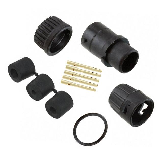

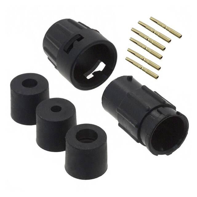

MINI-CON-X® FIELD INSTALLABLE CONNECTORS Cable Pin Panel Mount P/C Tail Panel Mount 6X8X-XPG-XXX Matching Mates: • Cable-Cable 7X8X-XXG-XXX Matching Mates: • Cable Pin 7XXX-XXG-XXX Matching Mates: • Cable Pin 8X8X-XSG-XXX • Panel 6X8X-XPG-XXX • Cable Socket 7XXX-XSG-XXX 6X8X-XPG-XXX • Cable Socket 6X8X-XSG-XXX 6X8X-XSG-XXX Cable Socket Cable to Cable Dust Cap 6X8X-XSG-XXX Matching Mates: • Cable-Cable 8X8X-XXG-XXX Matching Mates: • Cable Pin 6295 8X8X-XPG-XXX • Panel 6X8X-XPG-XXX • Cable Socket 7XXX-XPG-XXX 6X8X-XSG-XXX Winged Coupling Ring W/6482 Molded Cable Assemblies Cable End ® (See pages 3 & 26) Cable to Cable Right Angle 601 East Wildwood, Villa Park, Illinois 60181 • Telephone (630) 834-7504 • Fax (630) 834-8540 10 ® MINI-CON-X® FIELD INSTALLABLE CONNECTORS Dimensions Molded Cable Assemblies (See pages 3 & 26) 1.100 [24.9] 1.690 [42.9] 1.690 [42.9] 1.375 [34.9] CABLE END ASSEMBLY CABLE TO CABLE ASSEMBLY CABLE END ASSEMBLY STRAIGHT BOOT 0.375 [9.5] MAX. CABLE O.D. STRAIGHT BOOT 0.375 [9.5] MAX. CABLE O.D. 90º BOOT 0.310 [7.9] MAX. CABLE O.D. ® 601 East Wildwood, Villa Park, Illinois 60181 • Telephone (630) 834-7504 • Fax (630) 834-8540 11 ® MINI-CON-X® FIELD INSTALLABLE CONNECTORS Part Number to Order X X XX-XXG-XXX Grommet Code – Cable O.D. Range: Connector Type: 6 - Cable End 7 - Panel Mount 8 - Cable to Cable Back Shell Style 3 11 15 18 21 - .09 - .14 (2.3 - 3.5) .15 - .17 (3.8 - 4.3) .18 - .20 (4.6 - 5.1) .21 - .23 (5.3 - 5.8) Back Shell Style 5 13 16 19 22 - .13 - .15 (3.3 - 3.8) .16 - .18 (4.1 - 4.6) .19 - .21 (4.8 - 5.3) .22 - .25 (5.6 - 6.3) Contact Size: 2 - #20 (2-8 Contacts) 3 - #16 (2-5 Contacts) Contact Style: 80 81 82 91 92 - Crimp (Supplied loose) P/C Tail .187" (4.7) (Supplied assembled) Solder Cup (Supplied assembled) P/C Tail .280" (7.1) (Supplied assembled)* P/C Tail .335" (8.5) (Supplied assembled)* Back Shell Style: Weathertight grommet grip/ seal & (1) interfacial “O” ring. 3DC - Daisy chain grommet with 3 I.D.s. (.125, .188 & .250) 5 Long back shell with extended grommet & cable grip. Use with crimp or solder. 3 Number of Contacts: 2, 3, 4, 5, 6, 7 & 8 Type of Contact: 300 - Panel mount with hex nut & gasket. 3ES - 300 with Epoxy P - Pin S - Socket Contact Plating: G - Gold over Nickel (Standard) *Available in #20 size contact only. Consult factory for optional threaded coupling.. Consult factory for your custom design cable assemblies and connectors. (See pages 3 & 26) Contact Arrangements 1 1 2 2 1 4 3 1 2 1 5 1 2 3 2-#16 3 3-#16 4-#16 1 1 2 5 4 5-#16* 1 6 5 2-#20 1 7 3-#20 1 8 7 2 3 4-#20 5-#20 6-#20 7-#20* 8-#20* Contact arrangements shown are wiring view of cable end pins/sockets. Key/keyway shown for orientation only. *Available in connector types: cable end socket, panel mount pin, and cable to cable pin styles only. ® 601 East Wildwood, Villa Park, Illinois 60181 • Telephone (630) 834-7504 • Fax (630) 834-8540 12 ® MINI-CON-X® FIELD INSTALLABLE CONNECTORS Specifications Typical Specifications Manufacturers Identifications Description Rating Conductor Size Configuration Certification Mini-Con-X® Field Installable Connector & Custom Cable Assemblies 4.8 thru 13.0A, 600V #16 contacts, 16 thru 18 AWG #20 contacts, 20 thru 24 AWG 2 thru 5 #16 Contacts or 2 thru 8 #20 Contacts UL Recognized File #E138878 - 250V CSA Certified File #LR89277 - 600V Material Specifications Cable Pin/Socket Backshell (Removable Twist Lock) Grommet Coupling Ring Contacts Connector Body O-Ring Optional Long Backshell (Removable Twist Lock) Winged Coupling Ring Cable to Cable Backshell (Removable Twist Lock) Grommet Contacts Connector Body Panel Mount Contacts Panel Body Gasket Hex Nut Optional Dust Cap Mechanical Specifications Durability Vibration Nylon, UL Recognized, Black Santoprene Rubber, Black Nylon, UL Recognized, Black Brass, Gold over Nickel Nylon, UL Recognized, Black Nitrile Rubber, Black Nylon, UL Recognized, Black (Style #5) Nylon, UL Recognized, Black (W/6482) Nylon, UL Recognized, Black Santoprene Rubber, Black Brass, Gold over Nickel Nylon, UL Recognized, Black Brass, Gold over Nickel Nylon, UL Recognized, Black Nitrile Rubber, Black Nylon, UL Recognized, Black Santoprene Rubber, Black (Part No. 6295) Hex Nut Torque Minimum 300 mate/unmate cycles without mechanical or electrical failure Coupling rings have overriding locking feature to prevent loosening or separation of connector All series hex nut to withstand 10-12 inch/lb tightening torque Electrical Specifications Voltage Current 600 V See Electrical Current Rating Chart (Page 27) Environmental Specifications Temperature Rating Corrosion Weathertight -55°C to +125°C (-67°F to +257°F) 300 Hr salt spray contacts Consult factory with specific application Molded Cable Assemblies Watertight (See Pages 3 & 26) NEMA 6P, 13: IEC IP67 ® 601 East Wildwood, Villa Park, Illinois 60181 • Telephone (630) 834-7504 • Fax (630) 834-8540 13 ®

物料型号: - 该文档描述了MINI-CON-X®系列的现场可安装连接器,包括电缆端连接器、面板安装连接器和电缆对电缆连接器。
器件简介: - MINI-CON-X®连接器是一种现场可安装的连接器,适用于电缆端、面板安装和电缆对电缆连接。
引脚分配: - 引脚分配包括2至8个#20引脚或2至5个#16引脚,具体取决于连接器类型。
参数特性: - 额定电流为4.8至13.0A,电压为600V。 - 导体尺寸为#16接触点的16至18 AWG,#20接触点的20至24 AWG。
功能详解: - 连接器具有至少300次的插拔耐久性,无机械或电气故障。 - 耦合环具有覆盖锁定特性,防止连接器松动或分离。
应用信息: - 该连接器适用于多种应用,包括定制电缆组件和连接器。
封装信息: - 连接器材料包括尼龙、Santoprene橡胶、黄铜(镀金)、Nitrile橡胶等,均符合UL认可标准。
