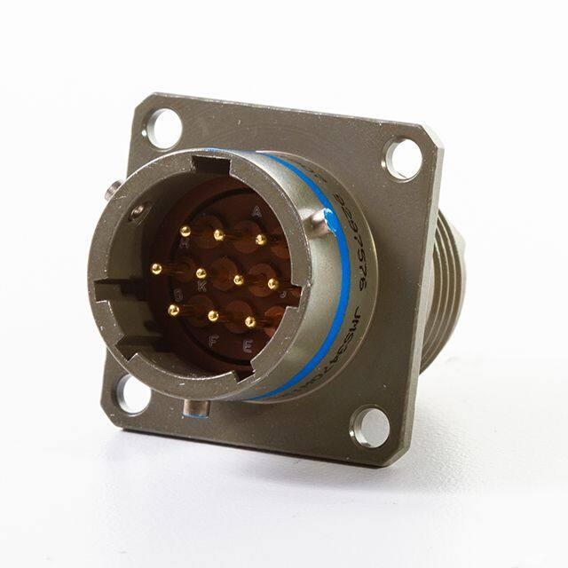

MIL-DTL-26482 Features and Application Series 2 Features and Application MIL-DTL-26482 Series 2, bayonet coupling, rear-removable crimp contact connectors were designed as an upgrade to MIL-DTL-26482 Series 1. Series 2 connectors are intermountable and interchangeable with both solder and front-release crimp Series 1. They are also identical to the inactivated MIL-DTL- 83723 Series I connectors. Series 2 connectors are widely used on commercial, military and aerospace systems requiring general-purpose, miniature cylindrical bayonet coupling connectors. This family of connectors is offered in 4 receptacle-mounting styles. They include narrow flange wall mounting receptacles, wide flange wall mounting receptacles, cable connecting receptacles and jam nut mounting receptacles which incorporate “O” ring seals, designed for rear panel “D” hole mounting. Closed-Entry Socket Insert – Hard dielectric socket face has lead-in chamfers for positive alignment of pins (even partially bent within pre-established limits) with sockets. Interfacial Pin Insert Seal – Raised moisture barriers around each pin, which mate into lead-in chamfers of hard face socket insert, provide individual contact sealing. Interfacial seal is never touched by service tools. Elastomer Wire Sealing Grommet – Sealing over a wide range of wire diameters is assured by a triple wire seal in each cavity at the rear of the connector. Superior Contact Stability – Rear release crimp contact system features a stamped beryllium-copper retaining clip captivated by molded-in shoulders of each contact cavity in the insulator. A rear-inserted M81969 plastic tool expands the tines beyond the shoulder, releasing the contact. Plugs are available in two designs, with and without RFI grounding. 26482 S 2 Thirty-three insert arrangements per MIL-STD-1669 are tooled and qualified to MIL-DTL-26482 Series 2, utilizing 3 to 61 M39029 contacts. Contacts come in sizes 20, 16 and 12, terminating wire sizes from 24 to 12 gauge. These connectors are available in wide range of shell materials and finishes. Aluminum shells are offered in electroless nickel, olive drab cadmium and black anodic. Other finishes such as zinc cobalt are available upon request to commercial callouts only. In addition, we offer passivated stainless steel shells with standard environment-resisting inserts (commercial callouts only), and for highly corrosive environments, nickel-aluminum-bronze shells with standard environment-resisting inserts (commercial callouts only). Universal I/R Tool – A single, expendable plastic tool is used for both insertion and removal of contacts. Insert Polarization – Alternate insert clocking positions aid in mating of adjacent connectors having identical insert arrangement. www.conesys.com – 108 – sales@aero-electric.com MIL-DTL-26482 Performance Specifications Series 2 Performance Specifications Durability Mated connectors withstand a minimum of 250 mating cycles for RFI plug (MS3475) and 500 cycles for standard plug (MS3476). Operating Temperature Range Classes A, L and S*: -55°C to +200°C (-67°F to +392°F) Classes W and ZC*: -55°C to +175°C (-67°F to +347°F) Shock and Vibration Requirements Wired, mated connectors shall not be damaged, coupling ring shall not loosen, and there shall be no interruption of electrical continuity longer than one microsecond when subjected to the following: Material and Finish Data (Class) A – aluminum shell, black anodized finish L – aluminum shell, electroless nickel finish W – aluminum shell, olive drab cadmium over nickel base S* – stainless steel shell, passivated BN*– aluminum shell, black nickel finish (Aero P/N only) Corrosion Resistance Classes A, S*, W and BN* withstand 500-hour salt spray. Class L withstands 48-hour salt spray. Shock Mated connectors withstand a pulse of approximate half sine wave of 300 G magnitude with duration of three milliseconds applied in each direction of the three major axes. Vibration Mated connectors withstand the following vibration levels: • Random vibration per MIL-STD-202, method 214, test condition II, letter J. Environmental Seal Wired, mated connectors with specified accessories attached, shall meet the altitude-immersion test specified in MIL-DTL-26482 Series 2. 26482 S 2 Shielding Effectiveness RFI attenuation at the specified frequency meets the requirements of MIL-DTL-26482 Series 2. • RFI shielding effectiveness of mated connectors with RFI backshells is measured in a triaxial radio frequency leakage fixture. Fluid Resistance Connectors resist specified immersions in MIL-PRF-7808 (lubricating oil), MIL-PRF-23699 (lubricating oil), MIL-PRF-5606 (hydraulic fluid), M2-V Chevron oil, Coolanol 25, ASTM D4814 (gasoline), SAE-AMS1424 Type I (defrosting fluid), MIL-DTL-5624 (JP-5), and solvents specified in Method 215 of MIL-STD-202. Shell-to-Shell Conductivity • With RFI spring fingers, the maximum potential drop shall not exceed 5 millivolts. • Without spring fingers, the maximum potential drop shall not exceed 200 millivolts. * Not on QPL, can be supplied to Aero-Electric P/N only. Voltage Rating Suggested Operating Voltage** Test Voltage Test Voltage Test Voltage Test Voltage (Sea Level) Service Rating Sea Level 50,000 Ft. 70,000 Ft. 110,000 Ft. AC (RMS) DC V RMS V RMS V RMS V RMS I 600 850 1,500 500 375 200 II 1,000 1,275 2,300 750 500 200 ** To be used by designer only as a guide. www.conesys.com – 109 – sales@aero-electric.com MIL-DTL-26482 Part Number Development Series 2 Military and Aero-Electric Part Number Development Mil. Prefix Aero Prefix MS34 AE7 70 70 L L 12 12 - 10 10 P P W W -340 Shell type 70 = Narrow flange receptacle 71 = Cable connecting receptacle 72 = Wide flange receptacle 74 = Jam nut receptacle 75 = RFI grounding plug 76 = Straight plug Class (Material and Finish) A = Aluminum shell, black anodized finish (not available in RFI plug) L = Aluminum shell, electroless nickel finish W = Aluminum shell, olive drab cadmium over electroless nickel base S* = Stainless steel shell, passivated (Aero part number only) BN* = Aluminum shell,Black Nickel finish, (RoHS), (Aero part number only) Shell Size 8, 10, 12, 14, 16, 18, 20, 22 or 24 Insert Arrangement See pages 125 thru 126 Contact Style P = Pin S = Socket A = Pin connector less pins (with intent to use non-std contact) 26482 S 2 B = Socket connector less sockets (with intent to use non-std contacts) Polarization N = Normal (not included in part number) W, X, Y or Z = Alternate insert polarizations (see pages 123 for position availability) Modification (applies to Aero part numbers only) 01 = Less contacts (is not marked on the part) 340 = Connector kitted with M85049/31-XXX E-nut 341 = Connector kitted with M85049/52-1-XXX straight clamp 342 = Connector kitted with M85049/51-1-XXX right angle clamp * Not on QPL, can be supplied to Aero part number only. Consult factory for availability. Note 2: Proper part number marking has no “0” in front of single digit shell size ( 8) and no “0” after the dash between shell size and single digit layout. Example of each: MS3470W8-33P and MS3470W10-6P. In both “N” for normal was omitted. Note 3: Insert layouts 8-2, 8-3 and 8-4 can only be ordered to Aero-Electric part number. Non standard contacts are required and to avoid confusion are sold “with contacts” only. See page 80 for the correct contact part numbers. Note 1: Each connector is furnished with contacts unless ordered less contacts (L/C) as follows: One spare contact for inserts requiring 2 to 26 of each contact and two spares for inserts with 27 or more of each size, and a minimum of one sealing plug up to 15% of the number of contacts. In addition, one plastic insetion/removal tool of each size is included. www.conesys.com – 110 – sales@aero-electric.com MS3470 Narrow Flange Receptacle AE770 Bayonet Coupling, Crimp Removable, Rear Release D MAX A MAX PANEL THICKNESS .125(3.18) MAX B E F MASTER KEYWAY .290 (7.37) MIN FULL THREAD .190 (4.83) .130 (3.30) GROMMET EXTENSION 3 ACCESSORY TEETH  4x  C H 3 BAYONET PINS MOUNTING HOLES G ACCESSORY THREAD 4 MINOR KEYWAYS BLUE COLOR BAND BLUE COLOR BAND MAX PANEL THICKNESS & SCREWHEAD .087(2.21) S.S. 8–18 .212(5.38) S.S. 20–24 26482 S 2 Page 110 Page 121 Pages 125, 126 Page 109 Pages 123, 124 Page 123 Completed Part Number Contacts, Sealing Plugs and Tools Insert Arrangements Performance Specifications Insert Availability and Contact Information Polarization A B Maximum (TP) Shell Size inch mm inch ØC Note: Maximum grommet O.D. is same as Ø C max on page 113. D ±.005 ±.13 mm inch mm inch E F G ±.016 ±.41 +.016 -.015 +.41 -.38 mm inch mm inch mm Maximum ØH Accessory Thread Class 2A ±.003 ±.08 inch mm 8 .828 21.03 .594 15.09 .120 3.05 1.215 30.86 .062 1.57 .446 11.33 1/2-20UNF .471 11.96 10 .954 24.23 .719 18.26 .120 3.05 1.215 30.86 .062 1.57 .446 11.33 5/8-24UNEF .588 14.94 12 1.047 26.59 .812 20.62 .120 3.05 1.215 30.86 .062 1.57 .446 11.33 3/4-20UNEF .748 19.00 14 1.141 28.98 .906 23.01 .120 3.05 1.215 30.86 .062 1.57 .446 11.33 7/8-20UNEF .873 22.17 16 1.234 31.34 .969 24.61 .120 3.05 1.215 30.86 .062 1.57 .446 11.33 1-20UNEF .998 25.35 18 1.328 33.73 1.062 26.97 .120 3.05 1.215 30.86 .062 1.57 .446 11.33 1-1/16-18UNEF 1.123 28.52 20 1.453 36.91 1.156 29.36 .120 3.05 1.275 32.39 .094 2.39 .571 14.50 1-3/16-18UNEF 1.248 31.70 22 1.578 40.08 1.250 31.75 .120 3.05 1.275 32.39 .094 2.39 .571 14.50 1-5/16-18UNEF 1.373 34.87 24 1.703 43.26 1.375 34.93 .147 3.73 1.275 32.39 .094 2.39 .604 15.34 1-7/16-18UNEF 1.498 38.05 www.conesys.com – 111 – sales@aero-electric.com MS3471 Cable Connecting Receptacle AE771 Bayonet Coupling, Crimp Removable, Rear Release C A MAX MAX .290 (7.37) MIN FULL THREAD D E MASTER KEYWAY .190 (4.83) .130 (3.30) GROMMET EXTENSION 3 ACCESSORY TEETH F B 4 MINOR KEYWAYS 3 BAYONET PINS G ACCESSORY THREAD BLUE COLOR BANDS Completed Part Number Contacts, Sealing Plugs and Tools Insert Arrangements Performance Specifications Insert Availability and Contact Information Polarization A ØB Maximum Shell Size inch mm Note: Maximum grommet O.D. is same as Ø C max on page 113. C ±.020 ±.51 inch mm inch D E ØF G ±.016 ±.41 +.016 -.015 +.41 -.38 ±.003 ±.08 mm inch mm inch mm inch mm Maximum Accessory Thread Class 2A 8 .828 21.03 .938 23.83 1.215 30.86 .062 1.57 .446 11.33 .471 11.96 1/2-20UNF 10 .954 24.23 1.062 26.97 1.215 30.86 .062 1.57 .446 11.33 .588 14.94 5/8-24UNEF 12 1.047 26.59 1.156 29.36 1.215 30.86 .062 1.57 .446 11.33 .748 19.00 3/4-20UNEF 14 1.141 28.98 1.250 31.75 1.215 30.86 .062 1.57 .446 11.33 .873 22.17 7/8-20UNEF 16 1.234 31.34 1.344 34.14 1.215 30.86 .062 1.57 .446 11.33 .998 25.35 1-20UNEF 18 1.328 33.73 1.438 36.53 1.215 30.86 .062 1.57 .446 11.33 1.123 28.52 1-1/16-18UNEF 20 1.453 36.91 1.562 39.67 1.275 32.39 .094 2.39 .571 14.50 1.248 31.70 1-3/16-18UNEF 22 1.578 40.08 1.688 42.88 1.275 32.39 .094 2.39 .571 14.50 1.373 34.87 1-5/16-18UNEF 24 1.703 43.26 1.812 46.02 1.275 32.39 .094 2.39 .604 15.34 1.498 38.05 1-7/16-18UNEF www.conesys.com – 112 – sales@aero-electric.com 26482 S 2 Page 110 Page 121 Pages 125, 126 Page 109 Pages 123, 124 Page 123 MS3472 Wide Flange Receptacle AE772 Bayonet Coupling, Crimp Removable, Rear Release D A MAX MAX PANEL THICKNESS .125(3.18) MAX B F MASTER KEYWAY E .190 (4.83) .130 (3.30) GROMMET EXTENSION .290 (7.37) MIN FULL THREAD 3 ACCESSORY TEETH C H  .150±.005 ( 3.81±.13) MOUNTING HOLES MAX GROMMET 3 BAYONET PINS G ACCESSORY THREAD 4 MINOR KEYWAYS BLUE COLOR BAND BLUE COLOR BAND MAX PANEL THICKNESS & SCREWHEAD .118(3.00) S.S. 8–18 .212(5.38) S.S. 20–24 26482 S 2 Page 110 Page 121 Pages 125, 126 Page 109 Pages 123, 124 Page 123 Completed Part Number Contacts, Sealing Plugs and Tools Insert Arrangements Performance Specifications Insert Availability and Contact Information Polarization A B ØC D Maximum (TP) Maximum Maximum Shell Size inch mm inch mm inch E F G ØH ±.016 ±.41 +.016 -.015 +.41 -.38 Accessory Thread Class 2A ±.003 ±.08 inch mm mm inch mm inch mm inch mm 8 1.065 27.05 .734 18.64 .305 7.75 1.215 30.86 .062 1.57 .477 12.12 1/2-20UNF .471 11.96 10 1.141 28.98 .812 20.62 .405 10.29 1.215 30.86 .062 1.57 .477 12.12 5/8-24UNEF .588 14.94 12 1.266 32.16 .938 23.83 .531 13.49 1.215 30.86 .062 1.57 .477 12.12 3/4-20UNEF .748 19.00 14 1.360 34.54 1.031 26.19 .665 16.89 1.215 30.86 .062 1.57 .477 12.12 7/8-20UNEF .873 22.17 16 1.453 36.91 1.125 28.58 .790 20.07 1.215 30.86 .062 1.57 .477 12.12 1-20UNEF .998 25.35 18 1.532 38.91 1.203 30.56 .869 22.07 1.215 30.86 .062 1.57 .477 12.12 1-1/16-18UNEF 1.123 28.52 20 1.688 42.88 1.297 32.94 .994 25.25 1.275 32.39 .094 2.39 .571 14.50 1-3/16-18UNEF 1.248 31.70 22 1.766 44.86 1.375 34.93 1.119 28.42 1.275 32.39 .094 2.39 .571 14.50 1-5/16-18UNEF 1.373 34.87 24 1.891 48.03 1.500 38.10 1.244 31.60 1.275 32.39 .094 2.39 .604 15.34 1-7/16-18UNEF 1.498 38.05 www.conesys.com – 113 – sales@aero-electric.com MS3474 Jam Nut Receptacle AE774 Bayonet Coupling, Crimp Removable, Rear Release C MAX A E D MASTER KEYWAY .290(7.37) MIN FULL THREAD "O" RING .190 (4.83) .130 (3.30) GROMMET EXTENSION F 3X REAR ACCESSORY TEETH FLAT B 3 BAYONET PINS G BLUE COLOR BAND ACCESSORY THREAD (SAME AS FOR MS3472 ON PREVIOUS PAGE) H THREAD HEX NUT PER MS3186 EXCEPT FOR THICKNESS BLUE COLOR BAND .125(3.18) .108(2.74) PANEL THICKNESS .187(4.75) S.S. 8–18 .062(1.57) .250(6.35) S.S. 20–24 .062(1.57) Completed Part Number Contacts, Sealing Plugs and Tools Insert Arrangements Performance Specifications Insert Availability and Contact Information Polarization A Shell Size ØB C +.000 -.031 +.00 -.79 +.000 -.031 +.00 -.79 inch mm inch mm Note: Maximum grommet O.D. is same as Ø E max on page 113. D E Maximum inch mm mm inch inch mm F H Flat ±.005 ±.13 Jam Nut Thread mm UNEF-2A inch 8 .954 24.23 1.078 27.38 1.215 30.86 .113/.086 2.87/2.18 .707/.658 17.96/16.71 .525 13.34 9/16-24 10 1.078 27.38 1.203 30.56 1.215 30.86 .113/.086 2.87/2.18 .707/.658 17.96/16.71 .650 16.51 11/16-24 12 1.266 32.16 1.391 35.33 1.215 30.86 .113/.086 2.87/2.18 .707/.658 17.96/16.71 .813 20.65 7/8-20 14 1.391 35.33 1.516 38.51 1.215 30.86 .113/.086 2.87/2.18 .707/.658 17.96/16.71 .937 23.80 1-20 16 1.516 38.51 1.641 41.68 1.215 30.86 .113/.086 2.87/2.18 .707/.658 17.96/16.71 1.061 26.95 1-1/8-18 18 1.641 41.68 1.766 44.86 1.215 30.86 .113/.086 2.87/2.18 .707/.658 17.96/16.71 1.186 30.12 1-1/4-18 20 1.828 46.43 1.954 49.63 1.275 32.39 .148/.096 3.76/2.44 .772/.721 19.61/18.31 1.311 33.30 1-3/8-18 22 1.954 49.63 2.078 52.78 1.275 32.39 .148/.096 3.76/2.44 .772/.721 19.61/18.31 1.436 36.47 1-1/2-18 24 2.078 52.78 2.203 55.96 1.275 32.39 .148/.096 3.76/2.44 .772/.721 19.61/18.31 1.561 39.65 1-5/8-18 www.conesys.com – 114 – sales@aero-electric.com 26482 S 2 Page 110 Page 121 Pages 125, 126 Page 109 Pages 123, 124 Page 123 MS3475 RFI Grounding Plug AE775 Bayonet Coupling, Crimp Removable, Rear Release 1.230(31.24) MAX .320(8.13) MIN C MAX COUPLING NUT MASTER KEY RFI STRIP .290 (7.37) MIN FULL THREAD BLUE COLOR BAND 3 ACCESSORY TEETH EQUALLY SPACED A B E MAX INSERT MAX GROMMET .190 (4.83) .130 (3.30) GROMMET EXTENSION 4 MINOR KEYS 26482 S 2 Page 110 Page 121 Pages 125, 126 Page 109 Pages 123, 124 Page 123 Completed Part Number Contacts, Sealing Plugs and Tools Insert Arrangements Performance Specifications Insert Availability and Contact Information Polarization ØB ØA Maximum Shell Size D ACCESSORY THREAD ØC Maximum D Accessory Thread Class 2A ØE Maximum inch mm ±.003 inch ±.08 mm inch mm 8 .285 7.24 .355 9.02 .782 19.86 1/2-20UNF 10 .402 10.21 .483 12.27 .926 23.52 5/8-24UNEF .405 10.29 12 .516 13.11 .595 15.11 1.043 26.49 3/4-20UNEF .531 13.49 14 .641 16.28 .720 18.29 1.183 30.05 7/8-20UNEF .665 16.89 16 .766 19.46 .845 21.46 1.305 33.15 1-20UNEF .790 20.07 18 .855 21.72 .945 24.00 1.391 35.33 1-1/16-18UNEF .869 22.07 20 .980 24.89 1.070 27.18 1.531 38.89 1-3/16-18UNEF .994 25.25 22 1.105 28.07 1.195 30.35 1.656 42.06 1-5/16-18UNEF 1.119 28.42 24 1.229 31.22 1.320 33.53 1.777 45.14 1-7/16-18UNEF 1.244 31.60 www.conesys.com – 115 – inch mm .305 7.75 sales@aero-electric.com MS3476 Straight Plug AE776 Bayonet Coupling, Crimp Removable, Rear Release 1.230(31.24) MAX .320(8.13) MIN C MAX COUPLING NUT .290 (7.37) MIN FULL THREAD BLUE COLOR BAND MASTER KEY 3 ACCESSORY TEETH EQUALLY SPACED E A  B MAX MAX GROMMET INSERT .190 (4.83) .130 (3.30) GROMMET EXTENSION 4 MINOR KEYS Completed Part Number Contacts, Sealing Plugs and Tools Insert Arrangements Performance Specifications Insert Availability and Contact Information Polarization ØA Maximum Shell Size inch 26482 S 2 Page 110 Page 121 Pages 125, 126 Page 109 Pages 123, 124 Page 123 D ACCESSORY THREAD ØC Maximum ØB mm ±.003 inch ±.08 mm inch ØE Maximum D mm Accessory Thread Class 2A inch mm 8 .285 7.24 .355 9.02 .782 19.86 1/2-20UNF .305 7.75 10 .402 10.21 .483 12.27 .926 23.52 5/8-24UNEF .405 10.29 12 .516 13.11 .595 15.11 1.043 26.49 3/4-20UNEF .531 13.49 14 .641 16.28 .720 18.29 1.183 30.05 7/8-20UNEF .665 16.89 16 .766 19.46 .845 21.46 1.305 33.15 1-20UNEF .790 20.07 18 .855 21.72 .945 24.00 1.391 35.33 1-1/16-18UNEF .869 22.07 20 .980 24.89 1.070 27.18 1.531 38.89 1-3/16-18UNEF .994 25.25 22 1.105 28.07 1.195 30.35 1.656 42.06 1-5/16-18UNEF 1.119 28.42 24 1.229 31.22 1.320 33.53 1.777 45.14 1-7/16-18UNEF 1.244 31.60 www.conesys.com – 116 – sales@aero-electric.com AC3475 Arctic Coupling Nut, RFI Plug Bayonet Coupling, Crimp Removable, Rear Release 1.230(31.24) MAX C MAX COUPLING NUT MASTER KEY .290 (7.37) MIN FULL THREAD RFI STRIP 3 ACCESSORY TEETH EQUALLY SPACED E A B MAX GROMMET MAX INSERT .190 (4.83) .130 (3.30) GROMMET EXTENSION 4 MINOR KEYS D ACCESSORY THREAD AC3475 – 10- 7 Aero Prefix P N Polarization N = Normal (N included in part number marking) A, B, C, D, E or F (Alternate key positions) and W, X, Y or Z (Alternate insert clocking positions) Class (Material and Finish) –  = Aluminum shell, cadmium olive drab for the plug shell – aluminum shell, hard anodized, black plating for the coupling nut ZC = Aluminum shell, zinc cobalt finish L = Aluminum shell, electroless nickel Contact Style P = Pin S = Socket Shell Size Layout 8, 10, 12, 14, 16, 18, 20, 22 or 24 See pages 125 and 126 26482 S 2 Page 110 Page 121 Pages 125, 126 Page 109 Pages 123, 124 Page 123 ØA Shell Size Note: AC3475 Arctic Coupling Nut, RFI Plug is available to Aero-Electric part number only. Mating part is AC3474 which is same as AE774 on page 114. Additional mates are AC3470 (same as AE770 on page 111), AC3471 (same as AE771 on page 112)and AC3472 (same as AE772 on page 113). Completed Part Number Contacts, Sealing Plugs and Tools Insert Arrangements Performance Specifications Insert Availability and Contact Information Polarization ØB Maximum inch mm ±.003 inch ØC ±.08 mm D Maximum inch mm Accessory Thread Class 2A ØE Maximum inch mm 8 .285 7.24 .355 9.02 .900 22.86 1/2-20UNF .305 7.75 10 .402 10.21 .483 12.27 1.010 25.65 5/8-24UNEF .405 10.29 12 .516 13.11 .595 15.11 1.180 29.97 3/4-20UNEF .531 13.49 14 .641 16.28 .720 18.29 1.310 33.27 7/8-20UNEF .665 16.89 16 .766 19.46 .845 21.46 1.510 38.35 1-20UNEF .790 20.07 18 .855 21.72 .945 24.00 1.620 41.15 1-1/16-18UNEF .869 22.07 20 .980 24.89 1.070 27.18 1.740 44.20 1-3/16-18UNEF .994 25.25 22 1.105 28.07 1.195 30.35 1.850 46.99 1-5/16-18UNEF 1.119 28.42 24 1.229 31.22 1.320 33.53 1.980 50.29 1-7/16-18UNEF 1.244 31.60 www.conesys.com – 117 – sales@aero-electric.com MIL-DTL-26482 Series 2 Flange and Jam Nut Receptacles Panel Cutouts Panel Cutouts C A A F E B G MS3470(AE770) MS3474(AE774) D MS3472(AE772) 26482 S 2 Flange and Jam Nut Mounting Dimensions ØA B ±.13 ØC (TP) D F ±.25 ±.005 inch mm .150 3.81 20.62 .150 23.83 .150 1.031 26.19 3.05 1.125 3.05 1.203 .120 3.05 .120 3.05 .147 3.73 ±.010 ±.25 ØE ØG ±.13 ±.005 inch mm inch mm .536 13.61 .572 14.53 3.81 .661 16.79 .697 17.70 3.81 .824 20.93 .895 22.73 .150 3.81 .948 24.08 1.010 25.65 28.58 .150 3.81 1.072 27.23 1.135 28.83 30.56 .150 3.81 1.197 30.40 1.260 32.00 1.297 32.94 .150 3.81 1.322 33.58 1.385 35.18 1.375 34.93 .150 3.81 1.447 36.75 1.510 38.35 1.500 38.10 .150 3.81 1.572 39.93 1.635 41.53 Shell Size ±.005 (TP) ±.010 inch mm inch mm inch mm inch mm 8 .568 14.43 .594 15.09 .120 3.05 .734 18.64 10 .685 17.40 .719 18.26 .120 3.05 .812 12 .864 21.95 .812 20.62 .120 3.05 .938 14 .989 25.12 .906 23.01 .120 3.05 16 1.113 28.27 .969 24.61 .120 18 1.238 31.45 1.062 26.97 .120 20 1.363 34.62 1.156 29.36 22 1.488 37.80 1.250 31.75 24 1.615 41.02 1.375 34.93 ±.13 Note: For Ø C and Ø E, MS3470 and MS3472 call out for tolerance of ±.010 (±.25), however we recommend ±.005 (±.13). www.conesys.com – 118 – sales@aero-electric.com MS3180 Protective Cover, Plug AE1580 Protective Cover, Plug Part Number Configuration MIL. Prefix Aero Prefix MS3180AE1580- XX XX X X A A X X Shell Size 8 THRU 24 (Note: single digit for shell size 8) 26482 S 2 Style C = Chain R = Wire Rope Assembly Material Finish A = Aluminum, Hard Black Anodized Chain/Wire Rope Lengh Blank - for standard length “H” L= 5.000 +500 -.250 SHELL SIZE ØA +.001 -.005 ØB +.006 -.002 ØC +.000 -.016 ØD +.005 -.001 ØF MAX. H +.500 -.250 J +.010 -.020 L Max. M +.031 -.000 ØQ +.005 -.006 W X MAX 8 .473 .078 .563 .362 .719 3.000 .328 .562 .368 .412 .100 .781 10 .590 .078 .680 .490 .844 3.000 .328 .562 .368 .540 .100 .781 12 .750 .078 .859 .607 1.000 3.500 .328 .562 .368 .689 .100 .781 14 .875 .078 .984 .732 1.125 3.500 .328 .562 .368 .814 .100 .781 16 1.000 .078 1.108 .857 1.250 3.500 .328 .562 .368 .939 .100 .781 18 1.125 .078 1.233 .962 1.375 3.500 .328 .562 .368 1.039 .100 .781 20 1.250 .078 1.358 1.087 1.500 4.000 .390 .625 .430 1.164 .100 .844 22 1.375 .078 1.483 1.212 1.625 4.000 .390 .625 .430 1.289 .100 .844 24 1.500 .078 1.610 1.337 1.750 4.000 .390 .625 .430 1.414 .109 .875 www.conesys.com – 119 – sales@aero-electric.com MS3181 Protective Cover, Receptacle AE1581 Protectice Cover, Receptacle Part Number Configuration MIL. Prefix Aero Prefix MS3181- XX AE1581- XX X X A A X X Shell Size 8 THRU 24 (Note: single digit for shell size 8) Style 26482 S 2 C = Chain R = Wire Rope Assembly N = Chain/Ring Assembly Material Finish A = Aluminum, Hard Black Anodized Chain/Wire Rope Lengh Blank - for standard length “H” L= 5.000 +500 -.250 SHELL SIZE ØA +.001 -.005 B +.006 -.002 ØG +.005 -.006 H +.500 -.250 J +.010 -.020 L Max. ØN MIN. ØQ +.005 -.006 ØK MAX X MAX 8 .481 .149 .576 3.000 .115 .562 .578 .734 .812 .844 10 .602 .149 .697 3.000 .115 .562 .703 .859 1.000 .844 12 .761 .149 .871 3.500 .115 .562 .891 1.000 1.188 .844 14 .885 .149 .995 3.500 .115 .562 1.016 1.125 1.438 .844 16 1.010 .149 1.120 3.500 .115 .562 1.141 1.250 1.562 .844 18 1.136 .149 1.245 3.500 .115 .562 1.266 1.375 1.688 .844 20 1.260 .149 1.370 4.000 .115 .562 1.391 1.500 1.812 .844 22 1.385 .149 1.495 4.000 .115 .562 1.516 1.625 1.938 .844 24 1.510 .087 1.624 4.000 .147 .602 1.641 1.750 2.062 .875 www.conesys.com – 120 – sales@aero-electric.com MIL-DTL-26482 Contacts, Tools and Seal Plugs Series 2 Contacts, Plastic Insertion/Removal Tools and Seal Plugs Application Pin Contacts Socket Contacts Seal Plugs Insertion/Removal Tools Contact Size Type Military No. Military No. Military No. Military No. 20 Power/Signal M39029/4-110 M39029/5-115 MS27488-20-1 M81969/14-11 16 Power/Signal M39029/4-111 M39029/5-116 MS27488-16-1 M81969/14-03 12 Power/Signal M39029/4-113 M39029/5-118 MS27488-12-1 M81969/14-04 20* Power/Signal 5291-022-204H 5091-022-204H MS27488-20-1 M81969/39-01 Extraction Tool Plastic * Size 20 contacts for 8–2, 8–3 and 8–4 layouts are only available to Aero-Electric part numbers. Connectors incorporating these three layouts are only sold to Aero-Electric callouts (AE770, AE771, AE772, AE774, AE775, AE776, AC3470, AC3471, AC3472, AC3474 and AC3475). Standard size 20 contacts M39029/4-110 and M39029/5-115 will not work in these 3 layouts. Crimping and Metal Insertion/Extraction Tools Contact Size 20 Crimp Tool Positioner Positioner Insertion Tool For Pin Contacts For Socket Contacts Metal Metal Military No. Military No. Military No. Military No. Military No. M22520/1-01 M22520/1-02 M22520/1-02 M22520/2-01 M22520/2-02 M22520/2-02 M81969/8-205 M81969/8-206 26482 S 2 16 M22520/1-01 M22520/1-02 M22520/1-02 M81969/8-207 M81969/8-208 12 M22520/1-01 M22520/1-02 M22520/1-02 M81969/8-209 M81969/8-210 20* M22520/2-01 M22520/2-08 M22520/2-08 M81969/8-205 M81969/8-206 Contact and Wire Data Contact Size Test Current Voltage DC Test Max. Drop Well Dia. Amps Millivolts inch inch mm AWG mm2 inch mm inch mm 7.5 55 .049 ±.001 .155 3.94 24-20 .20-.52 .040 1.02 .083 2.11 20 Crimp Well Data Wire Range Minimum Well Dept Finished Wire Ø Range Minimum Maximum 16 13.0 49 .067 ±.001 .250 6.35 20-16 .52-1.31 .053 1.35 .103 2.62 12 23.0 42 .100 ±.002 .250 6.35 14-12 2.08-3.31 .097 2.46 .158 4.01 Note: Test Current and Maximum Voltage Drop when tested with silver-plated wire at 25°C. www.conesys.com – 121 – sales@aero-electric.com MIL-DTL-26482 Contact Installation Instructions Series 2 Contact Installation Instructions 3. Place the correct insertion tool on the contact so that the wire runs along the groove in the tool. (Tool tip will butt against the shoulder.) Hold the plug or receptacle body firmly. Crimping Contacts 1. Select the appropriate crimp tool and ensure that the proper crimp head positioner is used. 4. Beginning with a center cavity, insert the contact into the insulator with a slow, even pressure until the contact snaps into position. Make sure the contact and tool are held perpendicular to the face of the insert during the contact installation or the grommet could be damaged. 2. Cycle the tool to be sure the indentors are open. 3. Determine the correct selector setting for the wire size from the data plate on the positioner (turret head assembly) and set the selector knob on the crimp tool to match. 4.1 If contacts are not inserted all the way prior to removing insertion tool, do not try to reinsert the insertion tool. Instead, remove the contact and try again; otherwise reinserting the insertion tool may damage the inside of the contact cavity. 4. Place the contact, mating end first, into the tool. 5. Remove tool and check the face of the connector for proper contact installation. Proper installation may also be checked by pulling back lightly on the wire to make sure the contact is properly seated. 5. Insert the stripped wire into the hollow end of the contact. Be sure the wire is inserted as far as it will go. 6. Close the tool completely to crimp. Unless the tool is closed completely, the tool will not release the contact. Completion After all the cavities have been filled, slide the hardware back into position on the connector and tighten. 7. Remove the crimped contact from the tool. Check the inspection hole to verify that the wire is fully inserted. Extraction of Contacts (Rework) 1. Slide the hardware back over the wire bundle. 2. Select the appropriate tool. Place the wire into the extraction tool of the pin or socket. 3. Slowly slide the extraction tool down wire into the contact cavities until the tool tip bottoms against the contact shoulder, expanding the clip retaining tines. Hold the wire firmly in the tool and pull the wired contact and tool straight out of the rear of the insulator. 2. To assist insertion of contacts, lubricate insulator (grommet) cavities with isopropyl alcohol. Alcohol will evaporate and will not leave a conductive film. Caution: Never use any lubricant other than isopropyl alcohol. Size Pin Contact Socket Contact Basic Crimp Tool Pin Positioner Socket Positioner 20 M39029/4-110 M39029/5-115 M22520/1-01 M22520/1-02 Red M22520/1-02 Red M22520/2-01 M22520/2-02 M22520/2-02 16 M39029/4-111 M39029/5-116 M22520/1-01 M22520/1-02 Blue M22520/1-02 Blue 12 M39029/4-113 M39029/5-118 M22520/1-01 20* 5291-022-204H 5091-022-204H M22520/2-01 M22520/1-02 Yellow M22520/1-02 Yellow M22520/2-08 M22520/2-08 Insertion/Removal Tool M81969/14-11 M81969/14-03 M81969/14-04 M81969/39-01 * Aero-Electric proprietary size 20 contacts used in 8-2, 8-3 and 8-4 layouts only. www.conesys.com – 122 – sales@aero-electric.com 26482 S 2 Insertion of Contacts 1. Before inserting the contacts, unscrew the accessories (clamps, backshells or adapters) from rear of plug or receptacle. Slide the hardware over the wire bundle in the proper order for reassembly after all the contacts are inserted. MIL-DTL-26482 Series 2 Polarization, Insert Availability & Contact Information per MIL-STD-1669 Polarization (Insert Clocking) 1. In the normal insert clocking position (position N), the insert centerline coincides with the centerline of the master keyway (key) of the shell: L = 0°. 2. In the alternate clocking positions (W, X, Y and Z), the pin insert (viewing from mating side) is rotated clockwise relative to the centerline of the master keyway (key) of the shell. 3. The socket insert is rotated counter-clockwise. 4. Plugs have keys; receptacles have keyways. L° MASTER KEYWAY (KEY) OF A SHELL INSERT VERTICAL CENTERLINE Note: Be careful with alternate positions. See table below for position availability on layouts of interest. PIN INSERT MATING FACE (SOCKET INSERT IS OPPOSITE) Insert Availability, Contact Information and Clocking Positions Aero-Electric Total Contact Quantity Status No. of By Size Service Insert Positions In Degrees 26482 S 2 Insert Arrangement QPL’d Tooled Contacts 20 Rating N W X Y Z 8-2* No Yes 2 2 I 0 58 122 — — 8-3* No Yes 3 3 I 0 60 210 — — 8-4* No Yes 4 4 I 0 45 — — — 8-33 Yes Yes 3 3 I 0 90 — — — 8-98 Yes Yes 3 3 I 0 — — — — 10-6 Yes Yes 6 6 I 0 90 — — — 10-7** N/A Yes 7 7 — 12-3 Yes Yes 3 12-8 Yes Yes 8 8 12-10 Yes Yes 10 10 14-2** N/A Yes 2 2 14-4 Yes Yes 4 4 14-5 Yes Yes 5 14-9 Yes Yes 9 5 14-12 Yes Yes 12 8 14-15 Yes Yes 15 14 14-18 Yes Yes 18 18 14-19 Yes Yes 19 19 16 12 I 0 90 — — II 0 — — 180 — I 0 90 112 203 292 I 0 60 155 270 295 I 0 — — — — I 0 45 — — — II 0 40 92 184 273 I 0 15 90 180 240 4 I 0 43 90 — — 1 I 0 17 110 155 234 I 0 15 90 180 270 I 0 30 165 315 — 3 5 4 * Not qualified to MIL-DTL-26482 Series 2. These layouts were designed to mate with solder Series 1 connectors using proprietary Aero-Electric contacts (not QPL’d to M39029) and to avoid confusion are sold only “with contacts”. www.conesys.com ** Non MIL-STD-1669 layouts, available to Aero-Electric part numbers only and utilize standard M39029 contacts. These layouts were originally designed for use in AC3475 Arctic Coupling RFI plugs and AC3474 jam nut receptacles. – 123 – sales@aero-electric.com MIL-DTL-26482 Series 2 Polarization, Insert Availability & Contact Information per MIL-STD-1669 Insert Availability, Contact Information and Clocking Positions Aero-Electric Status Total Contact Quantity No. of Insert Arrangement QPL’d Tooled Contacts Insert Positions By Size 20 Yes Yes 8 Yes Yes 14 8 16-23 Yes Yes 23 22 16-26 Yes Yes 26 26 18-8 Yes Yes 8 18-11 Yes Yes 11 18-30 Yes Yes 30 29 18-32 Yes Yes 32 32 20-16 Yes Yes 16 20-24 Yes Yes 24 24 20-39 Yes Yes 39 37 20-41 Yes Yes 41 41 22-12 Yes Yes 12 22-21 Yes Yes 21 22-41 Yes Yes 41 27 22-55 Yes Yes 55 55 22-95 Yes Yes 32 26 24-19 Yes No 19 24-31 Yes Yes 31 24-61 Yes Yes 61 16 In Degrees 12 Rating N W X Y Z II 0 54 152 180 331 I 0 25 78 180 240 I 0 158 270 — — I 0 60 — 275 338 I 0 180 — — — 11 II 0 62 119 241 340 1 I 0 180 193 285 350 I 0 85 138 222 265 16 II 0 238 318 333 347 I 0 70 145 215 290 I 0 63 144 252 333 I 0 45 126 225 — 8 6 1 8 2 I 0 — — — — 21 12 II 0 16 135 175 349 14 I 0 39 135 264 — I 0 30 142 226 314 6 I 0 26 180 266 — 19 II 0 30 165 315 — I 0 90 225 255 — I 0 90 180 270 324 31 61 – 124 – sales@aero-electric.com 26482 S 2 16-8 16-14 www.conesys.com Service MIL-STD-1669 Insert Arrangements (Pin Front View) for MIL-DTL-26482 Series 2 Connectors Insert Arrangement Views B A C A B 8-2* 2 # 20, I F 8-3* 3 # 20, I B C G B C H P 26482 S 2 J E S A d T R P c C L L T W U V E a U S M Z g Y X K R D P E N M F X Y c L G B D U H W F E V C F E 18-8 8 # 12, I X Y Z J H G B M D g a A K W b D G L h K H G C C f S J N 18-32 32 # 20, I C E F H R D P G E F 18-30 1 # 16, 29 # 20, I F H V J D E 14-19 19 # 20, I B d S G H E R V T J C P U D A U e N K 16-26 26 # 20, I T f Z C B A L B c S W M B P F T b L F R * Not on QPL, available to Aero-Electric part number only. www.conesys.com N A A S N G U 14-4 4 # 12, I D E V J D 18-11 11 # 16, II Z C C e a K F B 14-18 18 # 20, I R B b M A M G 16-23 1 # 16, 22 # 20, I N G E J A L T H P S H 16-14 8 # 20, 6 # 12, I B Y X F K D F K M J H L D D J B R M C G C A N L K 14-15 1 # 16, 14 # 20, I B P N G A N H B D 14-12 4 # 16, 8 # 20, I B 16-8 8 # 16, II D 14-2** 2 # 12, I P L J E A A H E K A C 10-6 6 # 20, I B C R C D 14-9 5 # 20, 4 # 12, I H C D D M J M F E F J L B K C F G B B E K J G G 14-5 5 # 16, II E 8-98 3 # 20, I 12-10 10 # 20, I A B J C K F 12-8 8 # 20, I A B B A C H E A G C D 12-3 3 # 16, II A 8-33 3 # 20, I B H B 10-7** 7 # 20, I B F A E D C A A F C C A H A G D D 8-4* 4 # 20, I A E A 20-16 16 # 16, II ** Non MIL-STD-1669 layout, available in AC3470 through AC3475 shell styles only. – 125 – sales@aero-electric.com MIL-STD-1669 Insert Arrangements (Pin Front View) for MIL-DTL-26482 Series 2 Connectors Insert Arrangement Views L K A M W N X Y a J B Z U T G D R S X B W R U H T G C m b c m P r R H z R P F N e g P F N f M L e K N C Z U R V D N a Y X S E J W V H G F T H F 24-31 31 # 16, I – 126 – L 22-95 6 # 12, 26 # 20, I Z V T PP MM x CC p F y m AA BB z h i k M H J j P N g G n R E f KK LL DD D e JJ NN C d w HH EE q B c v GG r U A b a u t FF S E J K M W s D H d N Q S G c P Y U G 24-19 19 # 12, II G c d F b e H X C E a j R J R g e T J P D Z f F B b f K K b S A M B P g T E 22-55 55 # 20, I L L D c d f L C Y h U 26482 S 2 A u v M J B a t w 22-41 14 # 16, 27 # 20, I M DD A V Y Z EE x C s FF g K X CC HH y h X W B r GG l E G H d q E 22-12 12 # 12, I W q BB D F A V p AA k D n t T D 22-21 21 # 16, II www.conesys.com U n T S i E L G J K 20-41 41 # 20, I B C K G H d L s S U N a i p c A j V C S V J q e M H F b M Z k E a f P J Y A X K R G H B D n r K L m t g J Z s h 20-39 2 # 16, 37 # 20, I P W c d C Y k S F A B X j i E a n P e M N L q f N 20-24 24 # 20, I T b P E F M m r D Z g R V H h U Y k i S C P C A W V B X J T A W V U K L 24-61 61 # 20, I sales@aero-electric.com

物料型号:MIL-DTL-26482 Series 2
器件简介:MIL-DTL-26482系列2的插座采用硬质介电插座面,具有引导斜面,可实现引脚(即使在预设限制内部分弯曲)与插座的准确对齐。该系列连接器设计为MIL-DTL-26482系列1的升级版,与系列1的焊接和前释放压接连接器可互换且可互装。它们与已停产的MIL-DTL-83723系列1连接器相同。
引脚分配:33种插入排列方式符合MIL-STD-1669标准,使用3到61个M39029接触件。接触件有20、16和12号尺寸,可终止24至12号的电线。
参数特性: - 工作温度范围:A、L和S等级为-55°C至+200°C,W和ZC等级为-55°C至+175°C。 - 耐腐蚀等级:A、S、W和BN等级可承受500小时的盐雾测试,L等级可承受48小时盐雾测试。 - 耐压要求:包括冲击和振动测试,以及屏蔽效能和壳体间的导电性。
功能详解:Series 2连接器广泛应用于需要通用、小型圆柱形刺刀耦合连接器的商业、军事和航空系统。其特点是卓越的接触稳定性,后释放压接接触系统采用模塑在每个接触腔的肩部固定的冲压铍铜保持夹。
应用信息:这些连接器提供4种插座安装样式,包括窄法兰壁安装插座、宽法兰壁安装插座、电缆连接插座和带“O”形圈密封的卡箍安装插座,设计用于后面板“D”孔安装。插头有带和不带射频接地的两种设计。
封装信息:连接器提供多种壳体材料和表面处理方式。铝壳提供无电解镍、橄榄绿镉和黑色阳极氧化处理。其他如锌钴表面处理可应要求提供商业呼叫。此外,还提供钝化不锈钢壳体和标准抗环境插入件(仅限商业呼叫),对于高腐蚀环境,提供镍铝青铜壳体和标准抗环境插入件(仅限商业呼叫)。
