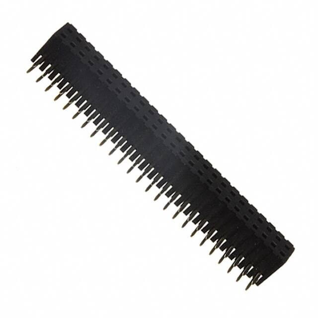

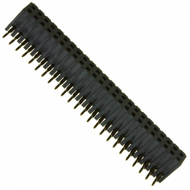

    排母 间距:2mm 2x24P 弯插
NPPN242FJFN-RC 数据手册
8 7 4 5 6 1 2 3 REVISIONS F REV. ECO. NO E 2515 F 3120 H 3473 DESCRIPTION DATE REMOVE CONTACT DEPTH TOLERANCE ADD 01/13/2012 "REF.", ADD NOTE 10 MATING PARTS UPDATE PROCESSING TEMPERATURE FOR NYLON 6T MATERIAL, INSERTION DEPTH TO 1.81mm (WAS 1.85mm), CURRENT RATING TO 2 AMPS 04/15/2015 (WAS 1 AMP), UPDATE STRAIGHTNESS TOL ADD 30u GOLD/GOLD FLASH PLATING OPTION, UPDATE PN CODING FROM NPxNxx2FJFN-RC TO 4/13/2016 NP_N_ _2FJFN-RC BY LH F LH JH E E .191 4.85 A±.004 [ 0.10] .031±.002 0.80±0.05 .079±.002 2.00±0.05 D D .079±.004 2.00±0.10 .020±.002 0.50±0.05 .079±.002 2.00±0.05 A .008[ 0.20] RECOMMENDED PCB LAYOUT 02-20, 0.20mm MAX. 21-30, 0.30mm MAX. 31-40, 0.40mm MAX. C .079±.002 2.00±0.05 C B .014 [ 0.35] .057±.002 1.45±0.05 .071 1.81 .283 7.20 .079±.004 2.00±0.10 B A NOTES: 1. INSULATOR MATERIAL: SEE PART NUMBER CODING. 2. CONTACT MATERIAL: PHOSPHOR BRONZE. 3. CONTACT PLATING: SEE PART NUMBER CODING. 4. CURRENT RATING: 2 AMPS. 5. INSULATOR RESISTANCE: 5000 MEGOHMS MIN. 6. CONTACT RESISTANCE: 20 MILLIOHMS MAX. 7. DIELECTRIC WITHSTANDING: 500 V AC. 8. OPERATING TEMPERATURE: -40° C TO +105° C. 9. PROCESSING TEMP.: WAVE/MANUAL SOLDERING ONLY 10.MATES WITH SULLINS .079 [2.00] CONTACT CENTER MALE HEADER SERIES. (.020 [0.50] SQUARE POSTS) 8 7 6 5 B .118±.008 3.00±0.20 .008±.002 0.20±0.05 Pb RoHS COMPLIANT 4 UNLESS OTHERWISE SPECIFIED: DIMENSIONS ARE IN INCHES [MM] TOLERANCES: ANGULAR: DECIMALS .X= .012 [.30] .XX= .008 [.20] .XXX= .006 [.15] DRAWN DATE NAME 01/09/2009 JH THE INFORMATION HEREIN CONTAINS PROPIETARY INFORMATION OF SULLINS ELECTRONICS AND IS NOT TO BE REPRODUCED, USED OR DISCLOSED TO OTHERS FOR ANY PURPOSE EXCEPT AS SPECIFICALLY AUTHORIZED IN WRITING BY AN OFFICER OF SULLINS ELECTRONICS. TITLE HEADER, FEMALE 2mm CC, 2 ROWS, RA PART NUMBER SIZE C CAGE CODE 54453 SCALE: 12:1 3 2 NP_N_ _2FJFN-RC DWG. NO. 10461 SHEET 1 OF 1 1 REV H FILE NAME: 10461, NP_N_ _2FJFN-RC A
NPPN242FJFN-RC
1. 物料型号:NP_N__2FJFN-RC,其中包含对型号编码的解释,例如P代表金闪镀层,N代表尼龙6T绝缘材料。
2. 器件简介:文档提到了修订历史,包括去除接触深度公差、增加"REF."和注释10,以及对尼龙6T材料的加工温度和插入深度的更新。
3. 引脚分配:提供了不同位置/引脚数量的尺寸表,包括英寸和毫米单位。
4. 参数特性:包括绝缘材料、接触材料、接触镀层、电流等级、绝缘电阻、接触电阻、介电强度、工作温度和加工温度等。
5. 功能详解:文档中提到了符合RoHS标准,以及公差标准。
6. 应用信息:提到了与Sullins Electronics的.079 [2.00]接触中心的男性头系列兼容。
7. 封装信息:提供了推荐的PCB布局信息,包括引脚间距和尺寸公差。
