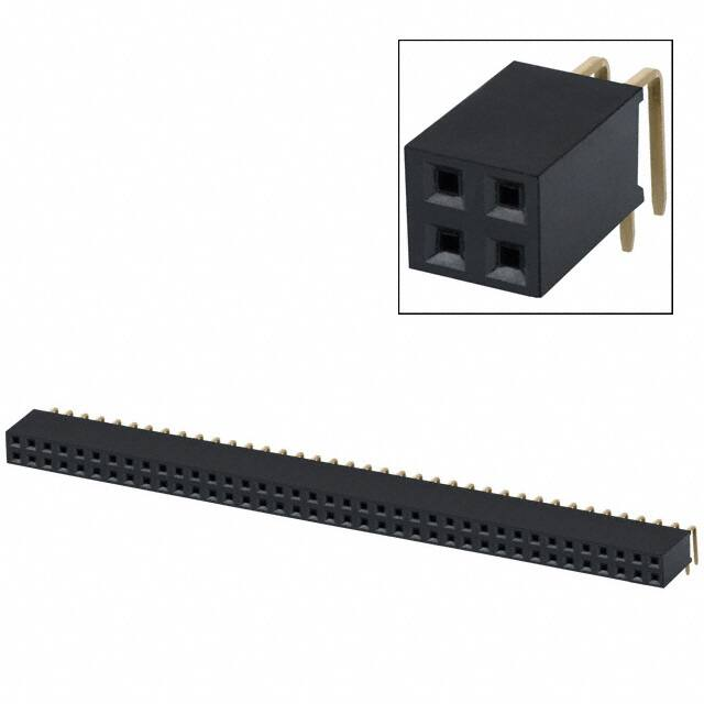

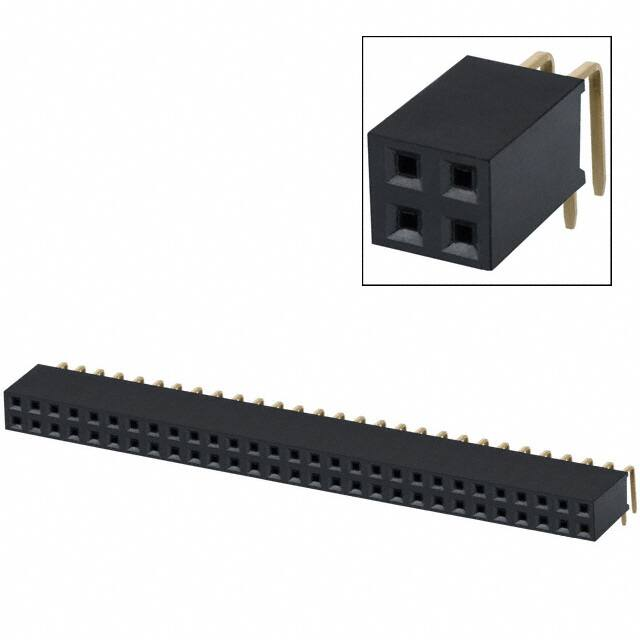

PPPC262LJBN
PPPC262LJBN
    SULLINS
    CONN HDR 52POS 0.1 GOLD PCB R/A
PPPC262LJBN 数据手册
8 7 4 5 6 1 2 3 REVISIONS F REV. ECO. NO DESCRIPTION DATE BY A 648 INITIAL RELEASE 6/15/2005 TT B 679 REMOVED KEY, FROM 3.2 TO 3.15 7/13/2005 TT C 1126 MV D 1869 UPDATE SPECIFICATION 9/12/2006 UPDATE CONTACT DEPTH TO 6.5mm, TOLERANCE & 12/23/2008 TEXT F JH E E A .197 5.00 .100 2.54 D D .100 2.54 A±.008 [ 0.20] B±.014 [ 0.35] .040±.002 1.02±0.05 RECOMMENDED PCB LAYOUT 02-20, 0.20mm MAX. 21-40, 0.30mm MAX. C C .124±.012 3.15±0.30 .256±.008 6.50±0.20 .335 8.50 .063±.010 1.60±0.25 B A B NOTES: 1. INSULATOR MATERIAL: SEE PART NUMBER CODING. 2. CONTACT MATERIAL: PHOSPHOR BRONZE. 3. CONTACT PLATING: SEE PART NUMBER CODING. 4. CURRENT RATING: 3 AMPS 5. INSULATOR RESISTANCE: 5000 MEGOHMS MIN. 6. CONTACT RESISTANCE: 20 MILLIOHMS MAX. 7. DIELECTRIC WITHSTANDING: AC 500V. 8. OPERATING TEMPERATURE: -40° C TO +105° C. .100±.010 2.54±0.25 .024(w) X .016(t) [0.60 X 0.40] UNLESS OTHERWISE SPECIFIED: Pb *INDICATED TEMPERATURE AND TIME IS FOR COMPONENT INSULATOR. HIGHER PROCESSING TEMPERATURES MAY BE USED, PROVIDED HEAT IS APPLIED FROM BACK SIDE OF PCB, AND INSULATOR DOES NOT EXCEED INDICATED TEMPERATURE AND TIME. 8 7 6 .100±.004 2.54±0.10 DIMENSIONS ARE IN INCHES[MM] TOLERANCES: ANGULAR: 5 .XX= .014 [.35] .XXX= .008 [.20] SURFACE FINISH: 63 Ra REMOVE ALL BURRS AND SHARP EDGES .010 MAX RoHS COMPLIANT 5 4 DRAWN NAME 12/15/08 JH THE INFORMATION HEREIN CONTAINS PROPIETARY INFORMATION OF SULLINS ELECTRONICS AND IS NOT DESCRIPTION TO BE REPRODUCED, USED OR DISCLOSED TO OTHERS FOR ANY PURPOSE EXCEPT AS SPECIFICALLY PART NUMBER AUTHORIZED IN WRITING BY AN OFFICER OF SULLINS ELECTRONICS. HEADER FEMALE, 2.54mm CC, 2 ROWS, RA xPxCxx2LJBN-RC SIZE DWG. NO. C INTERPRET DIMENSIONS AND GEOMETRIC TOLERANCING PER: ANSI Y14.5M-1994 3 DATE REV 10494 SCALE: 8:1 2 D SHEET 1 OF 1 1 FILE NAME: Z:\COMPONENTS\Taiwan\10494, P(N)PxCxx2LJBN-RC PRINT: 2/3/2009 A
PPPC262LJBN
1. 物料型号:xPxCxx2LJBN-RC,其中x代表不同的参数,如接触数量、引脚间距等。 2. 引脚分配:表格列出了不同引脚数量(从2到64)和对应的尺寸(英寸和毫米)。 3. 参数特性: - 接触材料:磷青铜。 - 接触镀层:见物料型号编码。 - 绝缘材料:根据物料型号编码,可能是聚酯或尼龙。 - 电流额定值:3安培。 - 绝缘电阻:最小5000兆欧。 - 接触电阻:最大20毫欧。 - 介电强度:交流500伏。 - 工作温度范围:-40°C至+105°C。 4. 功能详解:文档提供了详细的尺寸和公差信息,包括角度公差、表面光洁度和去毛刺要求。 5. 应用信息:文档提到了组件绝缘体的特定温度和时间限制,以及如果PCB的背面施加热量,可以使用更高的加工温度。 6. 封装信息:文档提供了推荐的PCB布局和尺寸信息,以及对尺寸和几何公差的解释。
