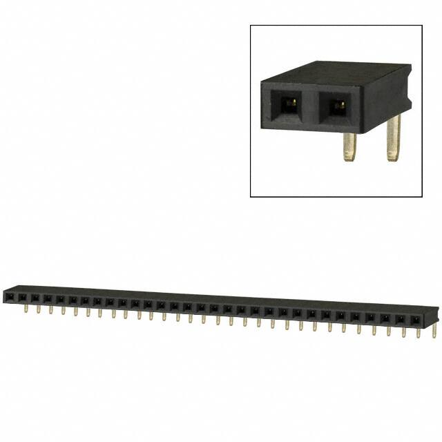

    CONN HDR 31POS 0.1 GOLD PCB R/A
PPPC311LGBN 数据手册
8 7 4 5 6 1 2 3 REVISIONS REV. ECO. NO G 2516 H 3120 DESCRIPTION DATE UPDATE NOTE 10 AND ADD NOTE 11 MATING PARTS 02/14/2012 UPDATE PROCESSING TEMPERATURE FOR NYLON 6T 04/15/2015 MATERIAL BY LH LH F F E E .100±.008 2.54±0.20 A±.008 [ 0.20] B±.014[ 0.35] D D .124±.008 3.15±0.20 .102 2.58 .257±.008 6.53±0.20 .335±.006 8.50±0.15 C C .063±.008 1.60±0.20 .024(w)X.016(t) [0.60x0.40] A±.004[ 0.10] .100±.002 2.54±0.05 02-20, 0.20mm MAX. 21-30, 0.30mm MAX. 31-40, 0.40mm MAX. B A .100±.002 2.54±0.05 NOTES: 1. INSULATOR MATERIAL: SEE PART NUMBER CODING. 2. CONTACT MATERIAL: PHOSPHOR BRONZE. 3. CONTACT PLATING: SEE PART NUMBER CODING. 4. CURRENT RATING: 3 AMPS. 5. VOLTAGE RATING: 250V AC/DC 6. INSULATOR RESISTANCE: 5000 MEGOHMS MIN. 7. CONTACT RESISTANCE: 20 MILLIOHMS MAX. 8. DIELECTRIC WITHSTANDING: 500V AC. 9. OPERATING TEMPERATURE: -40° C TO +105° C. 10.PROCESSING TEMPERATURE: SEE PART NUMBER CODING. 11.MATES WITH SULLINS .100 [2.54] CONTACT CENTER MALE HEADER SERIES. (.025 [0.64] SQUARE POSTS) 8 7 6 5 .040±.002 1.02±0.05 B RECOMMENDED PCB LAYOUT Pb RoHS COMPLIANT 4 UNLESS OTHERWISE SPECIFIED: DIMENSIONS ARE IN INCHES [MM] TOLERANCES: ANGULAR: 5 DECIMALS .X= .012 [.30] .XX= .008 [.20] .XXX= .006 [.15] DRAWN DATE NAME 12/15/2008 JH THE INFORMATION HEREIN CONTAINS PROPIETARY INFORMATION OF SULLINS ELECTRONICS AND IS NOT TO BE REPRODUCED, USED OR DISCLOSED TO OTHERS FOR ANY PURPOSE EXCEPT AS SPECIFICALLY AUTHORIZED IN WRITING BY AN OFFICER OF SULLINS ELECTRONICS. TITLE HEADER FEMALE, 2.54mm CC, 1 ROW, RA PART NUMBER SIZE C CAGE CODE 54453 SCALE: 12:1 3 2 xPxCxx1LGBN-RC DWG. NO. 10493 SHEET 1 OF 1 1 REV H FILE NAME: 10493, P(N)PxCxx1LGBN-RC A
PPPC311LGBN
1. 物料型号:xPxCxx1LGBN-RC,其中x代表不同的参数,例如间距和引脚数。 2. 器件简介:文档中没有直接提供器件简介,但根据标题“HEADER FEMALE, 2.54mm CC, 1 ROW, RA”可以推断这是一个2.54mm间距、1排、直角的雌性连接器。 3. 引脚分配:文档提供了详细的引脚分配表,包括引脚位置、英寸和毫米尺寸。 4. 参数特性: - 接触材料:磷青铜 - 接触镀层:根据型号编码 - 电流额定值:3安培 - 电压额定值:250V AC/DC - 绝缘体电阻:最小5000兆欧 - 接触电阻:最大20毫欧 - 耐电压:500V AC - 工作温度:-40°C至+105°C - 加工温度:见型号编码 5. 功能详解:文档中没有提供功能详解,但根据参数特性可以推断其作为连接器的基本功能。 6. 应用信息:文档指出该连接器适用于Sullins .100 [2.54] 接触中心雄性连接器系列,具有0.025 [0.64]平方柱。 7. 封装信息封装信息包括引脚间距、引脚数、角度(5度)、以及RoHS合规性。
