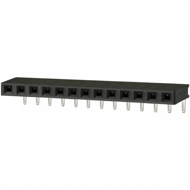

    CONN HDR 13POS 0.1 TIN PCB R/A
PPTC131LGBN 数据手册
8 7 4 5 6 1 2 3 REVISIONS REV. ECO. NO G 2516 H 3120 DESCRIPTION DATE UPDATE NOTE 10 AND ADD NOTE 11 MATING PARTS 02/14/2012 UPDATE PROCESSING TEMPERATURE FOR NYLON 6T 04/15/2015 MATERIAL BY LH LH F F E E .100±.008 2.54±0.20 A±.008 [ 0.20] B±.014[ 0.35] D D .124±.008 3.15±0.20 .102 2.58 .257±.008 6.53±0.20 .335±.006 8.50±0.15 C C .063±.008 1.60±0.20 .024(w)X.016(t) [0.60x0.40] A±.004[ 0.10] .100±.002 2.54±0.05 02-20, 0.20mm MAX. 21-30, 0.30mm MAX. 31-40, 0.40mm MAX. B A .100±.002 2.54±0.05 NOTES: 1. INSULATOR MATERIAL: SEE PART NUMBER CODING. 2. CONTACT MATERIAL: PHOSPHOR BRONZE. 3. CONTACT PLATING: SEE PART NUMBER CODING. 4. CURRENT RATING: 3 AMPS. 5. VOLTAGE RATING: 250V AC/DC 6. INSULATOR RESISTANCE: 5000 MEGOHMS MIN. 7. CONTACT RESISTANCE: 20 MILLIOHMS MAX. 8. DIELECTRIC WITHSTANDING: 500V AC. 9. OPERATING TEMPERATURE: -40° C TO +105° C. 10.PROCESSING TEMPERATURE: SEE PART NUMBER CODING. 11.MATES WITH SULLINS .100 [2.54] CONTACT CENTER MALE HEADER SERIES. (.025 [0.64] SQUARE POSTS) 8 7 6 5 .040±.002 1.02±0.05 B RECOMMENDED PCB LAYOUT Pb RoHS COMPLIANT 4 UNLESS OTHERWISE SPECIFIED: DIMENSIONS ARE IN INCHES [MM] TOLERANCES: ANGULAR: 5 DECIMALS .X= .012 [.30] .XX= .008 [.20] .XXX= .006 [.15] DRAWN DATE NAME 12/15/2008 JH THE INFORMATION HEREIN CONTAINS PROPIETARY INFORMATION OF SULLINS ELECTRONICS AND IS NOT TO BE REPRODUCED, USED OR DISCLOSED TO OTHERS FOR ANY PURPOSE EXCEPT AS SPECIFICALLY AUTHORIZED IN WRITING BY AN OFFICER OF SULLINS ELECTRONICS. TITLE HEADER FEMALE, 2.54mm CC, 1 ROW, RA PART NUMBER SIZE C CAGE CODE 54453 SCALE: 12:1 3 2 xPxCxx1LGBN-RC DWG. NO. 10493 SHEET 1 OF 1 1 REV H FILE NAME: 10493, P(N)PxCxx1LGBN-RC A
