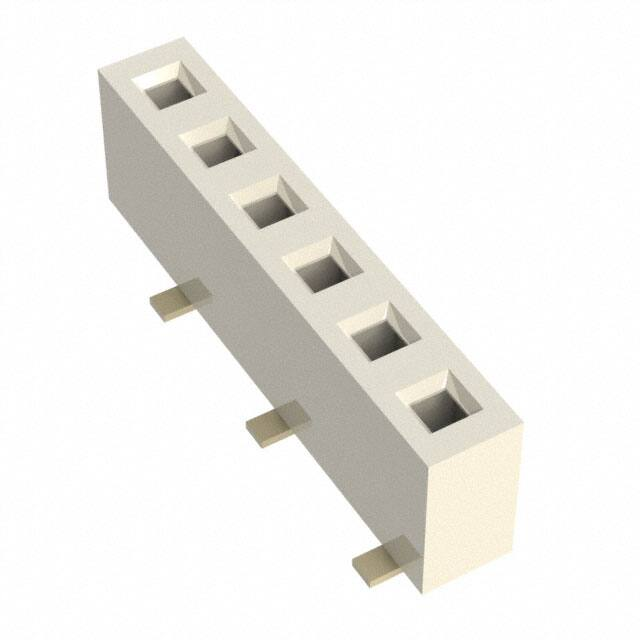

BG306-06-A-2-0400-L-B
    GCT
    SMD,P=2.54mm
    排母 间距:2.54mm 1x6P SMT
BG306-06-A-2-0400-L-B 数据手册
R1 Type A±0.30 2.54±0.05 Number of Contacts G R2 Type A±0.30 10.16 5 13.20 6 15.74 12.70 7 18.28 15.24 8 20.82 17.78 Electrical Current Rating: 3A per pin Contact Resistance: 20 mΩ max. Insulating Resistance: 1000 MΩ min. Dielectric Withstand Voltage: 500V AC Solder Area 5.10±0.20 5±0.15 XX X 0.80 x 0.25 Pin Soldering Process: IR Reflow: 260°C for 10 sec. Manual Solder: 350°C for 3-5 sec. 0.12 4±0.30 X 0400 L X Request Samples and Quotation No. of Contacts 02 to 08 Packing Options B = Tape & Reel with Cap (available in 3, 4, 5 ,6,7&8 contacts) Contact Plating A = Gold Flash All Over (MOQ 1,200 pieces - Standard R1 Footprint) G = Plastic Box (available in 2 contacts) (MOQ 1,000 pieces - Standard R1 Footprint) Insulator Material L = LCP (Natural) Footprint width (1/100mm) 0400 = 4.00mm Type 1 = R1 Type (Standard) 2 = R2 Type 2 3 Mates With: BG301 (4.00mm pin length) BG303 BG304 BG305 Standard black version of BG306 is BG125 Part Number Product Description BG306 2.54mm Pitch Pin Socket, Single Row Vertical, Top Entry, Surface Mount, Natural LCP Drawing Date 18th April 2012 By Detail 1 7.62 Mechanical & Environmental Operating Temperature: -40°C to +105°C (Other plating options available on request) A 5.08 10.66 Plating Underplating: 50µ”-100µ” Nickel all over Contact Area: See Ordering Grid Ordering Grid B 8.12 4 Material Insulator: LCP, 30% GF, UL94V-0, Natural Contact: Phosphor Bronze D BG306 3 Recommended PCB Layout 1.63 Minimum Insertion Depth 2.54±0.10 2.54 Specifications 2.54±0.05 B±0.20 C B 5.58 Solder Area 1.02±0.05 E Pin 1 Dimensions A Recommended PCB Layout 1.9 F 1.02±0.05 2.54±0.15 B±0.20 2 5.20 1.9 Pin 1 5.20 H 4 Revision Date 5 CC BG306 D PCN D3 05/06/20 Tolerances (Except as Noted) Length Angle X. ± 0.30 X.X ± 0.20 Units: Metric (mm) C 3rd Angle Projection 6 7 This drawing is confidential and copyright of Global Connector Technology, Ltd (GCT). This drawing must not be copied or disclosed without written consent. E & OE www.gct.co Not to Scale Drawn By ASE 8 Sheet No. 1/3 2 Pin H G PE Bag Dimension : 160 x 105,T=0.01 1000pcs/PE Bag F Box Dimension : 130 x 90 x 60 mm 1000pcs/Box E D Carton Dimension : 425 x 285 x 190 mm 8000pcs/Carton C H=190 B L= A 42 5 Pins pcs/PE Bag pcs/Box Boxes/Carton pcs/Carton 2 1000 1000 8 8,000 Part Number Product Description BG306 2.54mm Pitch Pin Socket, Single Row Vertical, Top Entry, Surface Mount, Natural LCP Drawing Date 5 28 W= 18th April 2012 By Detail Revision Date 1 2 3 4 5 CC Tolerances (Except as Noted) BG306 D PCN D3 05/06/20 X. ± 0.30 X.° ± 4° X.X° ± 3° X.X ± 0.25 X.XX ± 0.20 X.XX° ± 2° X.XXX ± 0.15 X.XXX° ± 1° Length Angle 6 Units: Metric (mm) C 3rd Angle Projection 7 This drawing is confidential and copyright of Global Connector Technology, Ltd (GCT). This drawing must not be copied or disclosed without written consent. E & OE www.gct.co Not to Scale Drawn By ASE 8 Sheet No. 2/3 D Peel off direction 2 C A G PEELING RESISTANCE: 0.2~0.8N(20.4gf~81.6gf). PEELING SPEED: 300mm/minutes. Ø13 Ø1 00 Empty cover tape 400mm. 2 Ø 5 1. Empty carrier & Cover tape160 mm. Product 1200 pcs Empty carrier tape100 mm. A 4 P 1 2 3 4 B 1 E C 2 3 4 1.75 6,7,8 Pin F Peeling angle: 165°~180° Pull out direction Ø381±2.0 P 1. 5 4 Ø H 1.75 3,4,5 Pin D 0.2 Detail A R0 .7 5 Detail A See table for number of reels per carton TRANSPARENT GLUE TAPE 3,5 B H=400 Dimensions No. of Contacts A B C D P 11.5±0.25 / 24±0.30 24+2 -0 12±0.25 8±0.25 12±0.25 12±0.25 4 11.5±0.25 / 24±0.30 6 14.2±0.25 28.4±0.25 32±0.30 7 14.2±0.25 28.4±0.25 32±0.30 24+2 -0 32+2 -0 32+2 -0 8 20.2±0.25 40.4±0.25 44±0.30 44 OUTSIDE C REEL L= 39 0 39 W= 0 8±0.25 VACUUM BAG Pins Pieces/Reel Reels/Carton Pieces/Carton 3,4,5 6,7 1200 1200 1200 10 8 6 12,000 9,600 7,200 Part Number Product Description BG306 2.54mm Pitch Pin Socket, Single Row Vertical, Top Entry, Surface Mount, Natural LCP Drawing Date A 8 18th April 2012 By Detail Revision Date 1 2 3 4 5 CC Tolerances (Except as Noted) BG306 D PCN D3 05/06/20 X. ± 0.30 X.° ± 4° X.X° ± 3° X.X ± 0.25 X.XX ± 0.20 X.XX° ± 2° X.XXX ± 0.15 X.XXX° ± 1° Length Angle 6 Units: Metric (mm) C 3rd Angle Projection 7 This drawing is confidential and copyright of Global Connector Technology, Ltd (GCT). This drawing must not be copied or disclosed without written consent. E & OE www.gct.co Not to Scale Drawn By ASE 8 Sheet No. 3/3
