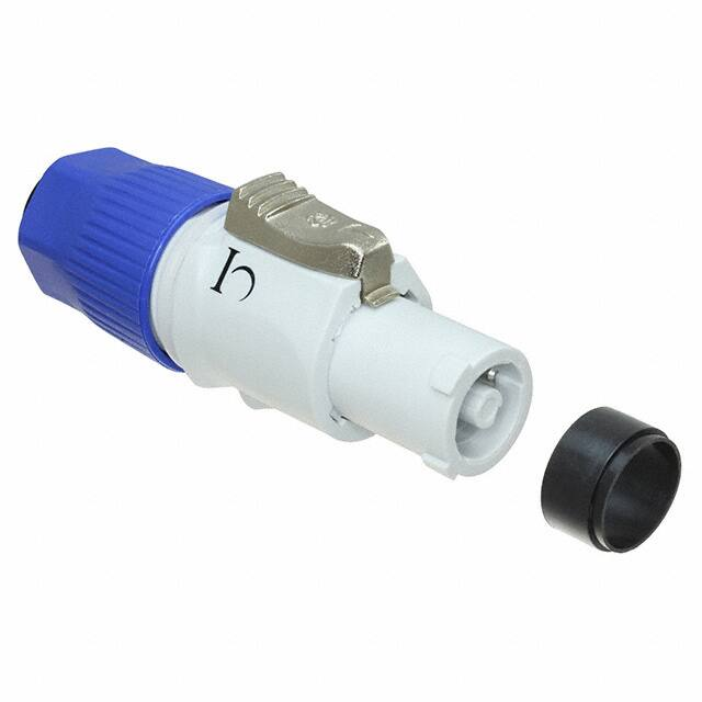

POWERLATCH™ CABLE CONNECTORS Specialized AC power connectors for AVL equipment with a heavy duty locking mechanism. Used in tandem with Powerlatch™ chassis connectors. UL Recognized and Approved Components IO-PRC3FA IO-PRC3FB SPECIFICATIONS PRODUCT MECHANICAL Gender: Female Lifetime: > 1000 Mating Cycles Contacts: 3 Cable O.D.: 5.0 - 15.0mm ELECTRICAL Wiresize: 12 AWG (2.75mm) Max O.D. Contact Resistance: ≤ 3 mΩ Wiring: Screw Terminals Insulation Resistance: > 100 MΩ MATERIAL Dielectric Strength: 2000V @ 60s Contacts: Brass Current Rating: 20 A / 250 V AC Contact Plating: Silver ENVIRONMENTAL Shell: PA Flammability Grade: UL94 V-0 Shell Finish: Blue or Grey Standard Compliance: IEC 61984 Strain Relieving Insert: PA6 Working Temperature: -40°C ~ +70° C (-40°F ~ +158°F) Push Button: Die Cast Zinc UL Listed (US): E500108 Push Button Finish: Nickel Product specifications may change without prior notification Io Audio Technologies® is a registered trademark of Knight Electronics, Inc. 10557 Metric Dr. Dallas, TX 75243 | 214-340-0265 | 800-323-2439 | Fax: 214-340-5870 | www.ioaudiotechnologies.com DRAWINGS IO-PRC3FA IO-PRC3FB FEATURES & APPLICATIONS Powerlatch™ AC power chassis connectors are designed for single-phase AC applications and are rated for 20A at 250V AC which makes them perfect for high current applications like stage productions, lighting, or video distribution systems. As such, these connectors include several safety features to protect the user. They utilize a twist-to-lock motion in order to provide the safest connection for high current applications by virtually eliminating the possibility of accidental unplugging while protecting the user from unintentional shocks and conductor damage. The connectors are also specifically keyed and color coded for input (blue or A) and output (gray or B) to eliminate the possibility of intermating. Lastly, they feature a pre-mating ground contact to ensure the circuit is properly grounded before the rest of the conductors make a connection. Powerlatch™ chassis connectors are a perfect solution for applications where local cable standards differ, but safety must be maintained at all times. We have enhanced modularity by enabling devices to use different power cables depending on the market and application. The sturdy, locking plastic connectors offer durability that will ensure years of reliable service without interruption or fatigue even in harsh environments. The ability to install or remove them in the field means that installers and integrators can customize their use and get the job done. NOTE: Not to be disconnected under load. PART NUMBER BREAKDOWN STANDARDS & CLASSIFICATIONS IO-PRC3FA Power Connector IO-PRC3FA 3 Conductor IO-PRC3FA Female IO-PRC3FA A = Blue, B = Gray Cable Connector Product specifications may change without prior notification Io Audio Technologies® is a registered trademark of Knight Electronics, Inc. 10557 Metric Dr. Dallas, TX 75243 | 214-340-0265 | 800-323-2439 | Fax: 214-340-5870 | www.ioaudiotechnologies.com
