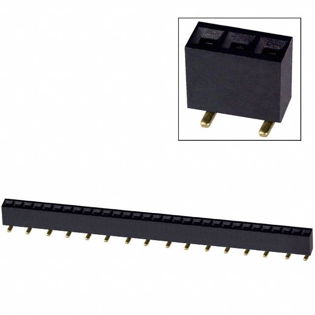

    排母 间距:2.54mm 1x31P SMT
NPPC311KFXC-RC 数据手册
8 7 4 5 6 1 2 3 REVISIONS F REV. ECO. NO DESCRIPTION DATE BY A 647 INITIAL RELEASE 6/14/2005 TT B 707 UPDATE DIMENSIONS 8/18/2005 TT C 767 10/13/2005 TT D 1869 ADD .20mm TO B DIMS ADD PCB LAYOUT D STYLE, UPDATE POSITION CHART FORMAT 12/04/2008 JH A 0.100 2.54 F 0.039 1.00 E E PIN 1 0.209 5.30 0.079 2.00 D MOUNTING STYLE RECOMMENDED PCB LAYOUT D MOUNTING STYLE B±0.016 [ 0.40] D D A A±0.008 [ 0.20] 0.039 1.00 0.100 2.54 0.079 2.00 C MOUNTING STYLE 0.209 5.30 PIN 1 0.098±0.004 2.50±0.10 0.280±0.006 7.10±0.15 C C RECOMMENDED PCB LAYOUT C MOUNTING STYLE 0.295±0.010 7.50±0.25 0.024(w) X 0.010(t) [0.60 X 0.25] B B 0.169±0.012 4.30±0.30 0.100±0.004 2.54±0.10 A NOTES: 1. INSULATOR MATERIAL: NYLON 6T, UL 94V-0. 02-20, 0.20mm MAX. 2. CONTACT MATERIAL: PHOSPHOR BRONZE. 21-40, 0.30mm MAX. 3. CONTACT PLATING: SEE PART NUMBER CODING. 4. CURRENT RATING: 3 AMPS 5. INSULATOR RESISTANCE: 5000 MEGOHMS MIN. 6. CONTACT RESISTANCE: 20 MILLIOHMS MAX. 7. DIELECTRIC WITHSTANDING: AC 500V. 8. OPERATING TEMPERATURE: -40° C TO +125° C. 9. *MAX PROCESSING TEMP.: 230° C FOR 30 - 60 SECONDS (260° C FOR 10 SECONDS). *INDICATED TEMPERATURE AND TIME IS FOR COMPONENT INSULATOR. HIGHER PROCESSING TEMPERATURES MAY BE USED, PROVIDED HEAT IS APPLIED FROM BACK SIDE OF PCB, AND INSULATOR DOES NOT EXCEED INDICATED TEMPERATURE AND TIME. 8 7 6 UNLESS OTHERWISE SPECIFIED: Pb DIMENSIONS ARE IN INCHES[MM] TOLERANCES: ANGULAR: 5 .XX= .014 [.35] .XXX= .008 [.20] SURFACE FINISH: 63 Ra REMOVE ALL BURRS AND SHARP EDGES .010 MAX RoHS COMPLIANT 5 4 DRAWN NAME 12/4/2008 JH THE INFORMATION HEREIN CONTAINS PROPIETARY INFORMATION OF SULLINS ELECTRONICS AND IS NOT DESCRIPTION TO BE REPRODUCED, USED OR HEADER FEMALE, DISCLOSED TO OTHERS FOR ANY PURPOSE EXCEPT AS SPECIFICALLY PART NUMBER AUTHORIZED IN WRITING BY AN OFFICER OF SULLINS ELECTRONICS. 2.54mm CC, 1 ROW, SMT NPxCxx1KFXx-RC SIZE DWG. NO. C INTERPRET DIMENSIONS AND GEOMETRIC TOLERANCING PER: ANSI Y14.5M-1994 3 DATE REV 10487 SCALE: 4:1 2 D SHEET 1 OF 1 1 FILE NAME: Z:\COMPONENTS\Taiwan\10487, NPxCxx1KFXx-RC PRINT: 2/2/2009 A
NPPC311KFXC-RC
1. 物料型号:文档中提到了型号“NPxCxx1KFXx-RC”,但具体的型号代码没有给出完整信息。 2. 器件简介:文档中没有直接提供器件简介,但提到了该器件是符合RoHS标准的,并且是2.54mm中心距的单排SMT插座。 3. 引脚分配:文档提供了详细的引脚分配表,从2到40个引脚,每个引脚的英寸和毫米尺寸都有列出。 4. 参数特性: - 绝缘材料:NYLON 6T, UL 94V-0 - 接触材料:磷青铜 - 接触镀层:见零件编号编码 - 电流额定值:3安培 - 绝缘电阻:最小5000兆欧姆 - 接触电阻:最大20毫欧姆 - 耐电压:交流500伏 - 工作温度:-40°C至+125°C - 最大加工温度:230°C(30-60秒)或260°C(10秒),针对组件绝缘体 5. 功能详解:文档中没有提供功能详解,但根据参数特性可以推断这是一个用于电子设备的插座,具有特定的电气和物理特性。 6. 应用信息:文档中没有直接提供应用信息,但根据参数和引脚分配,可以用于需要高电流和高绝缘电阻的电子应用。 7. 封装信息:文档提供了两种封装风格的推荐PCB布局,分别是C型和D型,包括尺寸和公差。
