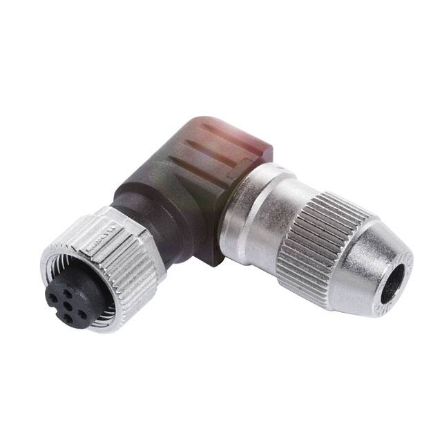

Field-Attachable Connectors BKS-S 76-RT04 Order Code: BCC02H6 Basic features Environmental conditions Approval/Conformity cURus Ambient temperature -40...85 °C EAC IP rating IP67 WEEE Material Electrical connection Conductor insulation material PVC Cable diameter D 4...5.1 mm Housing material PA Connection M12x1-Female, right-angle, 5-pin, Material contact carrier PA Material contacts Brass A-coded Number of connectable contacts 4 System Can be fabricated Electrical data Operating voltage Ub 32 VDC / 32 VAC Rated current (40 °C) 4.0 A Mechanical data Conductor diameter min. 1.2 mm Connection cross-section 0.25...0.5 mm² Connection cycles min. 100 Core diameter max. 1.60 mm Tightening torque pigtail 0.6 Nm Type of wire mounting IDC Remarks Enclosure rating per IEC 60529, only in screwed state with the associated mating piece. Internet www.balluff.com eCl@ss 9.1: 27-44-01-02 Subject to change without notice: 148572 ETIM 6.0: EC002062 BCC02H6_0.51_2021-03-29 1/2 Field-Attachable Connectors BKS-S 76-RT04 Order Code: BCC02H6 Connector Drawings Internet www.balluff.com eCl@ss 9.1: 27-44-01-02 Subject to change without notice: 148572 ETIM 6.0: EC002062 BCC02H6_0.51_2021-03-29 2/2

1. 物料型号:BKS-S 76-RT04,订购代码为BCC02H6。 2. 器件简介:BALLUFF生产的现场可安装连接器,具有M12x1-Female直角5针A编码电气连接。 3. 引脚分配:5针A编码。 4. 参数特性: - 操作电压:32 VDC / 32 VAC。 - 额定电流:4.0 A(在40°C环境温度下)。 - 环境温度:-40...85°C。 - IP等级:IP67。 5. 功能详解:适用于电缆直径D 4...5.1 mm,可以制造的系统,最小导体直径1.2mm,连接截面积0.25...0.5mm²,最小连接周期100次,最大芯径1.60mm,尾部紧固扭矩0.6Nm,接线方式为IDC。 6. 应用信息:文档提到了IEC 60529的外壳等级,只有在拧紧状态和相关配合件一起使用时才适用。 7. 封装信息:导体绝缘材料为PVC,外壳材料为PA,接触载体材料为PA,接触材料为黄铜。
