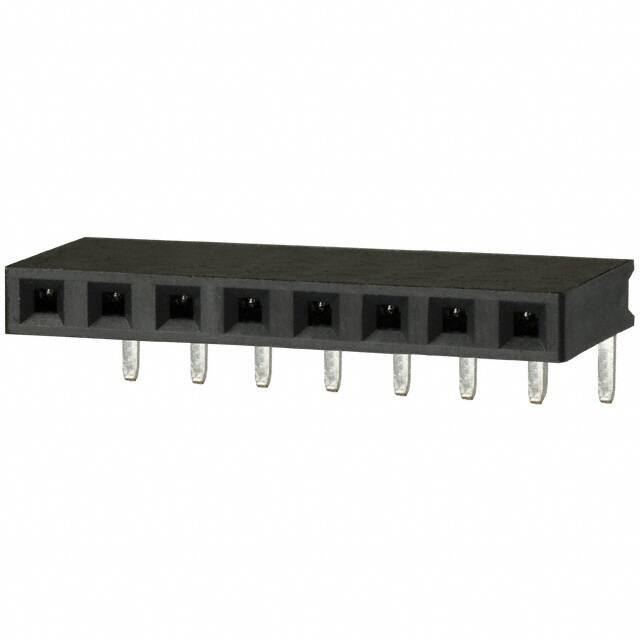

    CONN HDR 8POS 0.1 TIN PCB R/A
PPTC081LGBN 数据手册
8 7 4 5 6 1 2 3 REVISIONS F REV. ECO. NO DESCRIPTION DATE BY A 648 INITIAL RELEASE 6/15/2005 TT B 720 FROM 3.4 TO 3.15, 2.5 TO 2.4 9/26/2005 TT C 1126 MV D 1869 UPDATE SPECIFICATIONS 9/12/2005 ADD CONTACT DEPTH 6.4mm, UPDATE TOP VIEW & 12/23/2008 TOLERANCE, WIDTH 2.54 WAS 2.4 F JH E E .100±.008 2.54±0.20 A±.08 [ 0.20] B±.014 [ 0.35] D D 02-20, 0.20mm MAX. 21-40, 0.30mm MAX. .124±.012 3.15±0.30 .252±.008 6.40±0.20 C C .335±.010 8.50±0.25 .063±.010 1.60±0.25 .024(w) X .016(t) [0.60 X 0.40] B A NOTES: 1. INSULATOR MATERIAL: SEE PART NUMBER CODING. 2. CONTACT MATERIAL: PHOSPHOR BRONZE. 3. CONTACT PLATING: SEE PART NUMBER CODING. 4. CURRENT RATING: 3 AMPS 5. INSULATOR RESISTANCE: 5000 MEGOHMS MIN. 6. CONTACT RESISTANCE: 20 MILLIOHMS MAX. 7. DIELECTRIC WITHSTANDING: AC 500V. 8. OPERATING TEMPERATURE: -40° C TO +105° C. 7 6 A .100 2.54 B .040±.002 1.02±0.05 RECOMMENDED PCB LAYOUT UNLESS OTHERWISE SPECIFIED: Pb *INDICATED TEMPERATURE AND TIME IS FOR COMPONENT INSULATOR. HIGHER PROCESSING TEMPERATURES MAY BE USED, PROVIDED HEAT IS APPLIED FROM BACK SIDE OF PCB, AND INSULATOR DOES NOT EXCEED INDICATED TEMPERATURE AND TIME. 8 .100±.004 2.54±0.10 DIMENSIONS ARE IN INCHES[MM] TOLERANCES: ANGULAR: 5 .XX= .014 [.35] .XXX= .008 [.20] SURFACE FINISH: 63 Ra REMOVE ALL BURRS AND SHARP EDGES .010 MAX RoHS COMPLIANT 5 4 DRAWN NAME 12/15/08 JH THE INFORMATION HEREIN CONTAINS PROPIETARY INFORMATION OF SULLINS ELECTRONICS AND IS NOT DESCRIPTION TO BE REPRODUCED, USED OR HEADER FEMALE, DISCLOSED TO OTHERS FOR ANY PURPOSE EXCEPT AS SPECIFICALLY PART NUMBER AUTHORIZED IN WRITING BY AN OFFICER OF SULLINS ELECTRONICS. 2.54mm CC, 1 ROW, RA xPxCxx1LGBN-RC SIZE DWG. NO. C INTERPRET DIMENSIONS AND GEOMETRIC TOLERANCING PER: ANSI Y14.5M-1994 3 DATE REV 10493 SCALE: 12:1 2 D SHEET 1 OF 1 1 FILE NAME: Z:\COMPONENTS\Taiwan\10493, P(N)PxCxx1LGBN-RC PRINT: 2/3/2009 A
PPTC081LGBN
1. 物料型号:xPxCxx1LGBN-RC,其中x代表不同的参数。 2. 器件简介:文档提到了不同的修订版本,包括初始发布和后续的规格更新。 3. 引脚分配:提供了不同位数(从2到40)的引脚分配和尺寸,包括英寸和毫米单位。 4. 参数特性: - 绝缘材料:根据部件编号编码。 - 接触材料:磷青铜。 - 接触镀层:根据部件编号编码。 - 电流额定值:3安培。 - 绝缘电阻:最小5000兆欧。 - 接触电阻:最大20毫欧。 - 耐电压:交流500伏。 - 工作温度范围:-40°C至+105°C。 5. 功能详解:文档详细描述了连接器的物理尺寸和公差,包括角度公差和尺寸公差。 6. 应用信息:推荐PCB布局和表面处理要求,如去除毛刺和锐利边缘,表面粗糙度为63 Ra。 7. 封装信息:提供了封装的详细尺寸,包括引脚中心距、引脚长度等。
