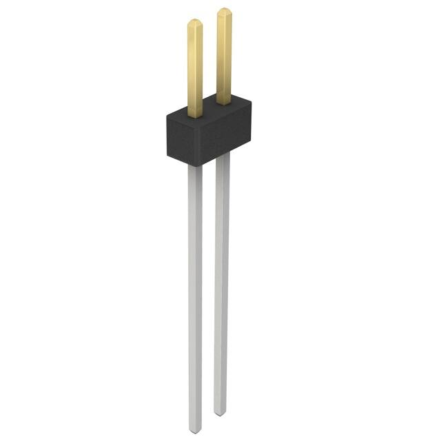

    排针 2x1P 直插
PBC01DAHN 数据手册
Headers .100” [2.54 mm] Contact Centers, Male Breakaway Headers, Straight/Right Angle/SMT SPECIFICATIONS • • • • • • 3 Amps current rating UL Flammability Rating: 94V-0 Insulator: PBT, PA9T, PPS, PEEK Contact Material: Phosphor Bronze See jumpers section for options available Consult Factory for PCB Layout TERMINATION TYPES STRAIGHT TERMINATIONS .100 [2.54] .100 [2.54] HEAD TAIL .200 [5.08] HEAD .100 [2.54] Headers TAIL .100 [2.54] .100 [2.54] .230 [5.84] .120 [3.05] RETENTION LEAD MOUNTING (EXAMPLE P/N: PBC36SAAR) P/N CODE AA AB AC AD AE AF AG AH AI* AJ* AK* FA FB FC FD FE FF* FG* FH* FI* FJ* ZA ZB* ZC ZD ZI* ZJ* ZO* ZQ* ZR* HEAD TAIL .230 [5.84] .120ˮ [3.05] .230 [5.84] .230ˮ [5.84] .230 [5.84] .320ˮ [8.13] .230 [5.84] .420ˮ [10.67] .23ˮ [5.84] .520ˮ [13.21] .230 [5.84] .620ˮ [15.75] .230ˮ [5.84] .720ˮ [18.29] .230ˮ [5.84] .820ˮ [20.83] .230ˮ [5.84] .900ˮ [22.86] .230ˮ [5.84] 1.000ˮ [25.40] .230ˮ [5.84] .035ˮ [0.89] .318ˮ [8.08] .120ˮ [3.05] .318ˮ [8.08] .220ˮ [5.59] .318ˮ [8.08] .320ˮ [8.13] .318ˮ [8.08] .420ˮ [10.67] .318ˮ [8.08] .520ˮ [13.21] .318ˮ [8.08] .620ˮ [15.75] .318ˮ [8.08] .710ˮ [18.03] .318ˮ [8.08] .810ˮ [20.57] .318ˮ [8.08] .910ˮ [23.11] .318ˮ [8.08] .050ˮ [1.27] .120ˮ [3.05] .120ˮ [3.05] .120ˮ [3.05] .095ˮ [2.41] .120ˮ [3.05] .260ˮ [6.60] .120ˮ [3.05] .610ˮ [15.49] .520ˮ [13.21] .110ˮ [2.79] .720ˮ [18.29] .110ˮ [2.79] .820ˮ [20.83] .110ˮ [2.79] 1.020ˮ [25.91] .110ˮ [2.79] 1.220ˮ [30.99] .110ˮ [2.79] RIGHT ANGLE TERMINATIONS .140[3.56] .100[2.54] TAIL .100 [2.54] .100 [2.54] HEAD .060 [1.52] RIGHT ANGLE (Standard) .240 [6.10] .100 [2.54] HEAD .060 [1.52] TAIL .200 [5.08] .100 [2.54] .060 [1.52] RIGHT ANGLE (Standard) HEAD RIGHT ANGLE SINGLE (Narrow) -M71, -M509, -M595 Modification Code TAIL .140 [3.56] HEAD .100 [2.54] TAIL P/N CODE BS GS ZC* ZU* HEAD TAIL .230ˮ [5.84] .318ˮ [8.08] .120ˮ [3.05] .420ˮ [10.67] .180ˮ [4.57] .180ˮ [4.57] .180ˮ [4.57] .180ˮ [4.57] *Consult factory for availability. SMT TERMINATIONS Single or Dual Row with -M30, -M508, -M596 Modification Code .100 [2.54] HEAD .100 [2.54] .200 [5.08] TAIL TAIL P/N CODE AB FB ZS* ZT* HEAD .230ˮ [5.84] .318ˮ [8.08] .120ˮ [3.05] .420ˮ [10.67] HEAD .100 [2.54] SINGLE ROW TAIL .320ˮ [8.13] .300ˮ [7.62] .200ˮ [5.08] .200ˮ [5.08] DUAL ROW TAIL .420ˮ [10.67] .400ˮ [10.16] .300ˮ [7.62] .300ˮ [7.62] *Consult factory for availability. *Consult factory for availability. TAIL SMT TERMINATIONS Single Row with -M89, -M511, -M308 Modification Code HEAD .060 [1.52] RIGHT ANGLE DUAL (Narrow) -M71, -M509, -M595 Modification Code P/N CODE BA BB BC BD BE BF** BG** BH* BI* BJ* GA GB GC** GD** GE* GF* DA** HEAD .230ˮ [5.84] .230ˮ [5.84] .230ˮ [5.84] .230ˮ [5.84] .230ˮ [5.84] .230ˮ [5.84] .230ˮ [5.84] .230ˮ [5.84] .230ˮ [5.84] .230ˮ [5.84] .318ˮ [8.08] .318ˮ [8.08] .318ˮ [8.08] .318ˮ [8.08] .318ˮ [8.08] .318ˮ [8.08] .120ˮ [3.05] TAIL .100ˮ [2.54] .200ˮ [5.08] .300ˮ [7.62] .400ˮ [10.16] .500ˮ [12.70] .600ˮ [15.24] .700ˮ [17.78] .800ˮ [20.32] .900ˮ [22.86] 1.000ˮ [25.40] .100ˮ [2.54] .200ˮ [5.08] .300ˮ [7.62] .400ˮ [10.16] .600ˮ [15.24] .800ˮ [20.32] .120ˮ [3.05] -M71, -M509 , -M595 TAIL .120ˮ [3.05] .220ˮ [5.59] .320ˮ [8.13] .420ˮ [10.67] .520ˮ [13.21] .620ˮ [15.75] .720ˮ [18.29] .820ˮ [20.83] .920ˮ [23.37] 1.020ˮ [25.91] .120ˮ [3.05] .220ˮ [5.59] .320ˮ [8.13] .420ˮ [10.67] .620ˮ [15.75] .820ˮ [20.83] .140ˮ [3.56] *Consult factory for availability. **Consult factory for availability in Dual Readout. 112 www.sullinscorp.com | 760-744-0125 | toll-free 888-774-3100 | fax 760-744-6081 | info@sullinscorp.com Headers PART NUMBER OPTIONS .100” [2.54 mm] Contact Centers, Male Breakaway Headers, Straight/Right Angle/SMT MATERIALS (INSULATOR/CONTACT) P = Black PBT or Equivalent/Phosphor Bronze Operating Temperature: -65°C to +125°C Processing Temperature: Manual/Wave Soldering G = Black PA9T/Phosphor Bronze Operating Temperature: -65°C to +150°C Processing Temperature: 260°C Max. for 10 sec. *R = Green PPS/Phosphor Bronze (Consult Factory) Operating Temperature: -65°C to +200°C Processing Temperature: 260°C Max. for 20 sec. *Q = Tan PEEK/Phosphor Bronze (Consult Factory) Operating Temperature: -65°C to +250°C Processing Temperature: 260°C Max. for 20 sec. *Available with overall gold plating ('M') only P B C 36 D AA N - Mxxx CONTACT FINISH - RoHS Compliant All platings are Lead Free and have .000050” Nickel underplate Contact Surface Termination B = .000010” Gold .000100” Pure Tin, Matte C = .000030” Gold .000100” Pure Tin, Matte E = .000100” Pure Tin, Matte, Overall G = .000010” Gold .000005” Gold S = .000010” Gold .000010” Gold Overall M = .000030” Gold .000010” Gold Overall CONTACT CENTERS C = .100” [2.54 mm] NUMBER OF POSITIONS 01 Thru 36 (eg. 36 Dual = 72 Contacts) READOUT (Opposite Page) S = Single D = Dual DIMENSIONS A 2X .050 [1.27] .100 TYP. [2.54] HEAD TAIL .025 [0.64] SQUARE POST FITS Ø .040[1.02] MINIMUM B SINGLE READOUT, STRAIGHT TAIL SHOWN 2X .050 [1.27] A .100 TYP. [2.54] HEAD TAIL .025 [0.64] SQUARE POST FITS Ø .040[1.02] MINIMUM B DUAL READOUT, STRAIGHT TAIL SHOWN MOUNTING STYLE N = No Mounting R = Retention Lead (Single Row & 'AA' Termination Only) TERMINATION TYPE (Opposite Page) Straight = AA, AB, AC, AD, AE, AF, AG, AH, AI, AJ, AK, FA, FB, FC, FD, FE, FF, FG, FH, FI, FJ, ZA, ZB, ZC, ZD, ZI, ZJ, ZO, ZQ, ZR Right Angle = BA, BB, BC, BD, BE, BF, BG, BH, BI, BJ GA, GB, GC, GD, GE, GF, DA Right Angle with -M71, -M509, -M595 Modification Code = BA, BB, BC, BD, BE, BH, BI, BJ, GA, GB, GE, GF SMT with -M89, -M511, -M308 Modification Code = BS, GS, ZC, ZU SMT with -M30, -M508, -M596 Modification Code = AB, FB, ZS, ZT PART NUMBER NUMBER OF CONTACTS SINGLE/DUAL in mm in mm _ _ C01S(D) _ _ _ _ _ C02S(D) _ _ _ _ _ C03S(D)_ _ _ _ _ C04S(D) _ _ _ _ _ C05S(D) _ _ _ _ _ C06S(D) _ _ _ _ _ C07S(D) _ _ _ _ _ C08S(D) _ _ _ _ _ C09S(D) _ _ _ _ _ C10S(D) _ _ _ _ _ C11S(D) _ _ _ _ _ C12S(D) _ _ _ _ _ C13S(D) _ _ _ _ _ C14S(D) _ _ _ _ _ C15S(D) _ _ _ _ _ C16S(D) _ _ _ _ _ C17S(D) _ _ _ _ _ C18S(D) _ _ _ _ _ C19S(D) _ _ _ _ _ C20S(D) _ _ _ _ _ C21S(D) _ _ _ _ _ C22S(D) _ _ _ _ _ C23S(D) _ _ _ _ _ C24S(D) _ _ _ _ _ C25S(D) _ _ _ _ _ C26S(D) _ _ _ _ _ C27S(D) _ _ _ _ _ C28S(D) _ _ _ _ _ C29S(D) _ _ _ _ _ C30S(D) _ _ _ _ _ C31S(D) _ _ _ _ _ C32S(D) _ _ _ _ _ C33S(D) _ _ _ _ _ C34S(D) _ _ _ _ _ C35S(D) _ _ _ _ _ C36S(D) _ _ _ 01/02 02/04 03/06 04/08 05/10 06/12 07/14 08/16 09/18 10/20 11/22 12/24 13/26 14/28 15/30 16/32 17/34 18/36 19/38 20/40 21/42 22/44 23/46 24/48 25/50 26/52 27/54 28/56 29/58 30/60 31/62 32/64 33/66 34/68 35/70 36/72 0.000 0.100 0.200 0.300 0.400 0.500 0.600 0.700 0.800 0.900 1.000 1.100 1.200 1.300 1.400 1.500 1.600 1.700 1.800 1.900 2.000 2.100 2.200 2.300 2.400 2.500 2.600 2.700 2.800 2.900 3.000 3.100 3.200 3.300 3.400 3.500 0.00 2.54 5.08 7.62 10.16 12.70 15.24 17.78 20.32 22.86 25.40 27.94 30.48 33.02 35.56 38.10 40.64 43.18 45.72 48.26 50.80 53.34 55.88 58.42 60.96 63.50 66.04 68.58 71.12 73.66 76.20 78.74 81.28 83.82 86.36 88.90 0.100 0.200 0.300 0.400 0.500 0.600 0.700 0.800 0.900 1.000 1.100 1.200 1.300 1.400 1.500 1.600 1.700 1.800 1.900 2.000 2.100 2.200 2.300 2.400 2.500 2.600 2.700 2.800 2.900 3.000 3.100 3.200 3.300 3.400 3.500 3.600 2.54 5.08 7.62 10.16 12.70 15.24 17.78 20.32 22.86 25.40 27.94 30.48 33.02 35.56 38.10 40.64 43.18 45.72 48.26 50.80 53.34 55.88 58.42 60.96 63.50 66.04 68.58 71.12 73.66 76.20 78.74 81.28 83.82 86.36 88.90 91.44 A B www.sullinscorp.com | 760-744-0125 | toll-free 888-774-3100 | fax 760-744-6081 | info@sullinscorp.com Headers Dimensions in [ ] are in millimeters, all others are in inches. MODIFICATION CODE (Consult Factory) OMIT FOR STANDARD -M500 = Brown PPS** -M594 = White PA9T*** -M30 = SMT, Vertical (M508 for brown PPS**, M596 for white PA9T***) -M89 = SMT, Horizontal (M511 for brown PPS**, M308 for white PA9T***) Available with single row only -M71 = Narrow Body (M509 for brown PPS**, M595 for white PA9T***) Available with Right Angle Only **Brown PPS available with material code 'R' only ***White PA9T available with material code 'G' only 113
