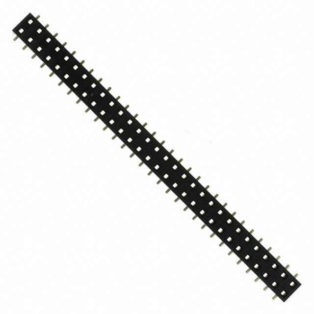

    排母 间距:2mm 2x30P SMT
NPPN302GFNS-RC 数据手册
Headers .079” [2.00 mm] Contact Centers, Female Headers, Straight/Right Angle/SMT SPECIFICATIONS • • • • 2 Amps current rating UL Flammability Rating: 94V-0 Insulator Material: Black Nylon Contact Material: Phosphor Bronze READOUT DUAL (2) SINGLE (1) QUAD (4) TERMINATION TYPE B P/N CODE A STRAIGHT Headers TAIL ROWS TERMINATION TYPE A B TAIL BFC 1 STRAIGHT .173ˮ [4.40] .094ˮ [2.40] .094ˮ [2.40] AFC 2 STRAIGHT .169ˮ [4.30] .157ˮ [4.00] .094ˮ [2.40] AFE 2 STRAIGHT .169ˮ [4.30] .157ˮ [4.00] .110ˮ [2.80] EFC 4 STRAIGHT .250ˮ [6.35] .315ˮ [8.00] .094ˮ [2.40] P/N CODE ROWS TERMINATION TYPE A B TAIL FGG 1 RIGHT ANGLE .169ˮ [4.30] .110ˮ [2.80] .122ˮ [3.10] FJF 2 RIGHT ANGLE .283ˮ [7.20] .191ˮ [4.85] .118ˮ [3.00] P/N CODE ROWS TERMINATION TYPE A B TAIL TAIL B RIGHT ANGLE A B A SMT BFL 1 SMT .181ˮ [4.60] .094ˮ [2.40] .157ˮ [4.00] BHL 1 SMT .169ˮ [4.30] .094ˮ [2.40] .157ˮ [4.00] GFN 2 SMT .110ˮ [2.80] .165ˮ [4.20] .228ˮ [5.80] 2 SMT GHN Refer to Mounting Style FFK TAIL Replaced by GFN .173ˮ [4.40] .157ˮ [4.00] .228ˮ [5.80] MOUNTING STYLE PIN 1 PIN 1 PIN 1 Straight or Right Angle (N) 106 Single Row SMT, Pin 1 Left (C) PIN 1 Single Row SMT, Pin 1 Right (D) Guide Post Dual Row SMT, Without Guide Posts (S) Dual Row SMT, With Guide Posts (P) www.sullinscorp.com | 760-744-0125 | toll-free 888-774-3100 | fax 760-744-6081 | info@sullinscorp.com Headers .079” [2.00 mm] Contact Centers, Female Headers, Straight/Right Angle/SMT PART NUMBER OPTIONS NP P N 40 1 BFC N - RC RoHS COMPLIANT Consult Factory For Modifications MATERIALS (INSULATOR/CONTACT) NP = Nylon /Phosphor Bronze CONTACT FINISH - RoHS Compliant Contact Surface Termination P = Gold Flash Gold Flash (For 1 and 2 Rows) R = .000020” Gold .000100” Tin (For 4 Rows) Consult factory for other plating options. CONTACT CENTERS N = .079” [2.00 mm] NUMBER OF POSITIONS Positions Termination Available 2 Thru 40 = AFC, AFE, BFL, FFK, FGG, FJF, GFN 3 Thru 40 = BFC, BHL 5 Thru 30 = EFC NUMBER OF ROWS (Opposite Page) 1 = One Row 2 = Two Rows 4 = Four Rows DIMENSIONS Dimensions in [ ] are in millimeters, all others are in inches. .059[1.50] A B SINGLE READOUT, STRAIGHT TAIL SHOWN .057 [1.45] .020[0.50] X .008[0.20] (FITS .031[0.80] HOLE) A B DUAL READOUT, STRAIGHT TAIL SHOWN .079[2.00] B .072[1.82] .250[6.35] .094[2.40] .079[2.00] .020[0.50] SQ. (FITS .031[0.80] HOLE) A QUAD READOUT, STRAIGHT TAIL SHOWN (SOLDER AREA) TERMINATION TYPE (Opposite Page) AFC = Thru Hole Top Entry AFE = Thru Hole Top Entry/Closed Bottom BFC = Thru Hole Top Entry EFC = Thru Hole Top Entry FGG = R/A Top Entry FJF = R/A Top Entry BFL = SMT Top Entry FFK = SMT Top Entry BHL, GFN = SMT Top/Bottom Entry GHN = SMT Replaced by GFN NUMBER OF CONTACTS SINGLE/DUAL/ QUAD 02/04/NA 03/06/NA 04/08/NA 05/10/20 06/12/24 07/14/28 08/16/32 09/18/36 10/20/40 11/22/44 12/24/48 13/26/52 14/28/54 15/30/60 16/32/64 17/34/68 18/36/72 19/38/76 20/40/80 21/42/84 22/44/88 23/46/92 24/48/96 25/50/100 26/52/104 27/54/108 28/56/112 29/58/116 30/60/120 31/62/NA 32/64/NA 33/66/NA 34/68/NA 35/70/NA 36/72/NA 37/74/NA 38/76/NA 39/78/NA 40/80/NA CENTER TO CENTER LENGTH [A] OVERALL LENGTH [B]** in mm in mm 0.079 2.00 0.157 4.00 0.157 0.236 0.315 0.394 0.472 0.551 0.630 0.709 0.787 0.866 0.945 1.024 1.102 1.181 1.260 1.339 1.417 1.496 1.575 1.654 1.732 1.811 1.890 1.969 2.047 2.126 2.205 2.283 2.362 2.441 2.520 2.598 2.677 2.756 2.835 2.913 2.992 3.071 4.00 6.00 8.00 10.00 12.00 14.00 16.00 18.00 20.00 22.00 24.00 26.00 28.00 30.00 32.00 34.00 36.00 38.00 40.00 42.00 44.00 46.00 48.00 50.00 52.00 54.00 56.00 58.00 60.00 62.00 64.00 66.00 68.00 70.00 72.00 74.00 76.00 78.00 0.236 0.315 0.394 0.472 0.551 0.630 0.709 0.787 0.866 0.945 1.024 1.102 1.181 1.260 1.339 1.417 1.496 1.575 1.654 1.732 1.811 1.890 1.969 2.047 2.126 2.205 2.283 2.362 2.441 2.520 2.598 2.677 2.756 2.835 2.913 2.992 3.071 3.150 6.00 8.00 10.00 12.00 14.00 16.00 18.00 20.00 22.00 24.00 26.00 28.00 30.00 32.00 34.00 36.00 38.00 40.00 42.00 44.00 46.00 48.00 50.00 52.00 54.00 56.00 58.00 60.00 62.00 64.00 66.00 68.00 70.00 72.00 74.00 76.00 78.00 80.00 Headers .020 [0.50] X .008[0.20] (FITS .031[0.80] HOLE) .079[2.00] MOUNTING STYLE N = No Mounting C = SMT, Single row female, pin 1 Left D = SMT, Single row female, pin 1 Right P = Surface mount with guide Posts S = Surface mount without guide Posts ** Dimension 'B' as shown are for 'FFK', Consult factory for other termination. www.sullinscorp.com | 760-744-0125 | toll-free 888-774-3100 | fax 760-744-6081 | info@sullinscorp.com 107
