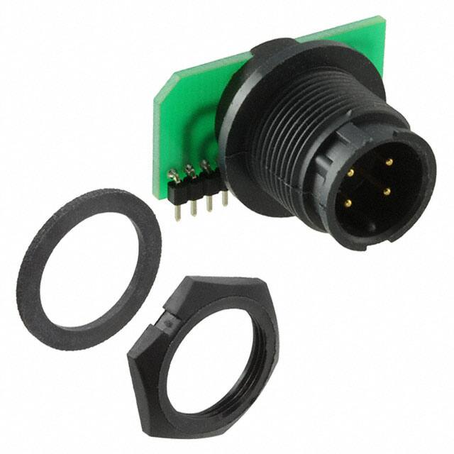

CUSTOMER DRAWING MFG. ENG. APPROVED BY: DATE: QA APPROVED BY: DATE: NOTES: 1. ALL HOLES REQUIRED REGARDLESS OF NUMBER OF POSITIONS OF CONNECTOR. 2. MAXIMUM PANEL THICKNESS RECOMMENDED: 0.188 [4.78mm] 3. HEX NUT & GASKET SHIPPED UNASSEMBLED. 4. HEX NUT TIGHTENING TORQUE: 8-10 IN/LB 5. THE DIMENSION DOES NOT INCLUDE THE GASKET. 6. CURRENT RATING5-8 CONTACT: 4.0 AMP 2-4 CONTACT: 5.0 AMP 7. TEMPERATURE RATING: -40 C TO +85 C (-40 F TO +185 F) 8. MATERIALSPANEL CONNECTOR, HEX NUT, & SPACER: THERMOPLASTIC GASKET: ELASTOMER CONTACTS: COPPER ALLOY, GOLD PLATE PCB: FR-4 HEADER INSULATOR: THERMOPLASTIC, UL94V-0 9. THIS PRODUCT IS RoHS COMPLIANT. 0.810 20.57 1.14 29.0 0.96 24.3 0.56 14.2 (SEE NOTE 5) 7251-8PG-300 SHOWN 0.57 14.5 18X 0.020 0.50 0.10 2.5 HEX NUT (SEE NOTE 3 & 4) POSITION 1 INDICATOR 1.012 25.70 8X 0.038 0.97 0.301 7.65 5/8-27 THREAD GASKET (SEE NOTE 3) 0.222 5.63 (SEE NOTE 5) 6X 0.079 2.00 0.506 12.85 4 5 6 1 2 3 NC NC CL RECOMMENDED PCB LAYOUT PCB COMPONENT SIDE SCALE 3:1 (SEE NOTE 1) CL 0.128 MAX 3.25 TO EDGE OF PCB 2, 3, 5 & 6 POSITION LOCATIONS 0.582 14.8 7251-6SG-300 SHOWN 6 PIN FEMALE ASSEMBLY 3 4 NC 1 2 NC NC NC 7251-_ _G-300 SERIES CL 4 POSITION LOCATIONS 0.610 15.5 5 RECOMMENDED PANEL CUT-OUT (SEE NOTE 2) 6 7 8 1 2 3 4 CL PART NUMBER: 7251 7251-8PG-300 SHOWN 8 PIN MALE ASSEMBLY PRELIMINARY # OF CONTACTS 2,3,4,5,6,7,8 (7&8 NOT AVAILABLE IN FEMALE) 7 & 8 POSITION LOCATIONS G - 300 CUSTOMER DRAWING 0C 0B 0A GENDER P - MALE S - FEMALE JGK JGK JGK REV. INIT. 11/05/15 9/21/15 8/28/13 DATE ALL INFORMATION ILLUSTRATED IS THE PROPERTY OF "CONXALL CORPORATION." UNAUTHORIZED DUPLICATION OR DISTRIBUTION OF THIS DOCUMENT IS PROHIBITED. ALL UNITS ARE IN FEET, INCHES, FRACTION OF INCHES AND DECIMALS. RoHS COMPLIANT UNLESS OTHERWISE SPECIFIED TOLERANCES: 3 PLACE DECIMALS ±.005 ANGLES ±1° FRACTIONS ±1/16 = CRITICAL CHARACTERISTIC FLAG PER SPEC. XXXX UPDATED NOTES. UPDATED NOTES. DRAWING CREATED PER PROJECT #09001. DESCRIPTION ORIG. DRAWN BY: JGK DATE: 8/26/13 CHECKED BY: 601 E. WILDWOOD VILLA PARK, IL 60181 TITLE: APPROVED BY: SCALE 3:2 FILE: SIZE B SAME AS P/N SHEET 1 OF 1 CUSTOMER: DIRECTORY: PART NUMBER: SLW MINI-CON-X RIGHT ANGLE 2-8 POSITION WIDE PC BOARD STANDARD PRODUCT 7251-_ _G-300 SERIES REV 0C
