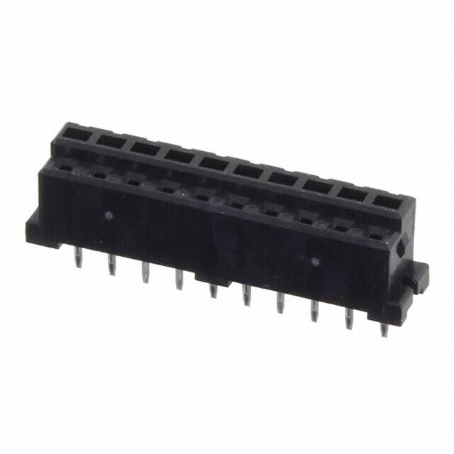

    排母 间距:2mm 1x10P 直插
DF3-10S-2DSA(55) 数据手册
2mm Pitch Connector for Discrete Wire Connection(Product approved by UL CSA Standard) Jun.1.2021 Copyright 2021 HIROSE ELECTRIC CO., LTD. All Rights Reserved. DF3 Series ■Features 1. Correspond to Board Design in Wide Variation ●Crimp Socket (1) Low profile design with mounting height 7.5mm. (2) Provide the contact crimping area with the sufficient space, and secures the stable crimping operation. ●Receptacle (1) The board can be connected horizontally or vertically in combination with the straight header with the right angle header. (2) For horizontal connection, the board to board size is the low profile of 6.6mm. (3) Compatibility with the in-line plug allows the receptacle to set the board side to the receptacle and the cable side to the plug in the board to cable connection. ●Pin Header (1) The board pre-fixed kink is treated with the post pin. (2) The style employs a scoop-proof and sturborn box type. (3) The type corresponding to SMT is avilable, using the heat-proof resin. This SMT header is equipped with the metal tab to prevent peeling in the solder joint area. ●In-line Plug (1) The crimping in-line plug consits of two types, one type, which has pursued after space merits, and the other employs the panel lock type, which can be fixed to the panel. (2) The in-line adapter is available to insert and in-line the ID socket from both sides. 2. UL, CSA Certified ■Applications Business equipment such as copy machine and printer B207 DF3 Series●2mm Pitch Connector for Discrete Wire Connection(Product approved by UL CSA Standard) ■Product Specifications Current rating Rating Crimping Note 1 Voltage rating Crimping Wire size 22 to 24 AWG : 3A Operating Temperature Range -55ç to +105ç (Note 2) 26 AWG : 2A Operating Humidity Range 28 AWG : 1A Storage Temperature Range -10ç to +60ç (Note 4) ■UL CSA Safety Standard File No. UL : E52653 CSA : LR95109 24 AWG : 3A Rated Current Jun.1.2021 Copyright 2021 HIROSE ELECTRIC CO., LTD. All Rights Reserved. 26 AWG : 2A (Note 5) Wire size 28 AWG : 1A Rated Voltage 30V AC Item Specification Condition 1. Insulation Resistance 1000Mø min. 500V DC 2. Withstanding voltage No flashover or insulation breakdown. 650V AC, 1 minute 3. Contact Resistance 30mø max 100mA 4. Single Insertor/Extraction Force 0.3N(30gf)min, 4.4N(450gf)max. 5. Vibration Measure by the square steel pin with 0.5±0.002mm No electrical discontinuity of 1μs or more Frequency : 10 to 55 Hz, single amplitude of 0.75 mm, 2 hours in each of the 3 directions. 6. Humidity (Steady state) Contact resistance : 30mø max. Insulation resistance : 500Mø min. 7. Temperature Cycle 96 hours at temperature of 40ç and humidity of 90% to 95% Contact resistance : 30mø max. Insulation resistance :1000Mø min. (-55ç : 30 minutes 5 to 35ç: 10 minutes 85ç: 30 minutes 5 to 35ç: 10minutes) 5 cycles 8. Durability (Mating/un-mating) Contact resistance : 30mø max. Tin plating : 30 cycles Gold plating: 50 cycles 9. Resistance to Soldering Heat No deformation of components affecting performance. THT type Flow : 260ç for 10 seconds Manual soldering : 300ç for 2 seconds SMT type Reflow : At the recommended temperature profile Manual soldering : 300ç for 3 seconds Note 1 : Current rating of header is 3A. Note 2 : Includes temperature rise caused by current flow. Apply to crimping contact type. Maximum operating temperature of receptacle type is 85ç. Note 3 : Please use under conditions with no condensation occurred. Note 4 : The term "storage" refers to products stored for long period of time prior to mounting and use. Operating Temperature Range and Humidity range covers non conducting condition of installed connectors in storage, shipment or during transportation. Note 5 : Apply to crimping contact type. ■Materials / Finish Product Part Material Finish Remarks Crimping Socket Insulator Polyamide Black UL94V-0 IDC Contact for Socket Receptacle Pin Header SMT Pin Header Contact Phosphor bronze Tin plated or gold plated ––––––– Insulator Polyamide Black UL94V-0 Contact Phosphor bronze Tin plated or gold plated ––––––– Insulator Polyamide Black UL94V-0 Contact Brass Tin plated or gold plated ––––––– Insulator Polyamide Beige UL94V-0 Contact Brass Tin plated or gold plated ––––––– Metal tab Brass Tin plated ––––––– In-line Plug Insulator Polyamide Black UL94V-0 In-line IDC Contact Contact Phosphor bronze Tin plated or gold plated ––––––– Insulator Polyamide Black UL94V-0 Contact Brass Tin plated ––––––– In-line Adapter B208 40% to 70% (Note 4) Storage Humidity Range 250V AC UL-CSA Safety Standard and Approved specification Rating 40% to 80% (Note 3) DF3 Series●2mm Pitch Connector for Discrete Wire Connection(Product approved by UL CSA Standard) ■Product Number Structure Refer to the chart below when determining the product specifications from the product number. Please select from the product numbers listed in this catalog when placing orders. ●Connector DF3 - * S - 2C q q Series Name w e : DF3, 3A, 3AA, 3EA rt t Connection Form/Contact Style w Number of Contacts : 2~15 C Jun.1.2021 Copyright 2021 HIROSE ELECTRIC CO., LTD. All Rights Reserved. e Connector Type : Crimp socket DSA : Straight through hole S : Socket DS : Right angle through hole P : Pin Header V : Straight SMT EP : In-line Plug H : Right angle SMT : 2mm A : Adapter r Contact Pitch ●Contact DF3 - EP2428PCFA q q Contact Type w r e e Contact Type/Packaging Type Blank : For socket SCF : Socket contact, Reel EP SC : Socket contact, Pack PCF : Plug contact, Reel PC : Plug contact, Pack : For in-line plug w Applicable Wire Size 22 : 22 AWG 2428 : 24 to 28 AWG r Plating Type Blank : Tin plated A : Gold plated (Plug contact) C : Gold plated (Socket contact) ■Application pattern DF3-※S-2C DF3(A)-※P-2DS(**) DF3EA-πP-2H(**) DF3AA-※EP-2C Panel DF3-※S-2C DF3EA-πP-2V(**) DF3(A)-※P-2DSA(**) DF3-※S-2DSA(**) DF3(A)-※P-2DS(**) DF3EA-πP-2H(**) DF3AA-※EP-2C Panel DF3EA-πP-2V(**) DF3(A)-※P-2DSA(**) B209 DF3 Series●2mm Pitch Connector for Discrete Wire Connection(Product approved by UL CSA Standard) ■Crimping Socket [Specific No.] (* *), * * Blank : 100pcs/pack Jun.1.2021 Copyright 2021 HIROSE ELECTRIC CO., LTD. All Rights Reserved. This picture shows the Contact crimped status. Unit : mm No. of Contacts A B No. of Contacts A B DF3-2S-2C(**) 543-0003-8 ** 2 06 02 DF3-19S-2C(**) 543-0010-3 ** 09 20 16 DF3-3S-2C(**) 543-0004-0 ** 3 08 DF3-4S-2C(**) 543-0005-3 ** 4 10 04 DF3-10S-2C(**) 543-0011-6 ** 10 22 18 06 DF3-11S-2C(**) 543-0012-9 ** 11 24 20 DF3-5S-2C(**) 543-0006-6 ** 5 12 08 DF3-6S-2C(**) 543-0007-9 ** 6 14 10 DF3-12S-2C(**) 543-0013-1 ** 12 26 22 DF3-13S-2C(**) 543-0014-4 ** 13 28 24 DF3-7S-2C(**) 543-0008-1 ** 7 16 12 DF3-14S-2C(**) 543-0015-7 ** 14 30 26 8 18 14 DF3-8S-2C(**) 543-0009-4 ** DF3-15S-2C(**) 543-0016-0 ** Note1 : The product's contact number indicated. Note2 : The quantity for delivery of the specification No. "None" is determined per bag (100 pcs.). If needed, please order the products per bag. 15 32 28 Part No. HRS No. RoHS YES Part No. HRS No. RoHS YES ■Receptacle [Specific No.] (* *), * * (25) : Tin plated, Tube packaging (55) : Gold plated, Tube packaging Note1 : The product's contact number indicated ●Board Through-hole Diameter : Ø0.8++0.1 0 Unit: mm Part No. B210 HRS No. No. of Contacts A B Tube Package RoHS Quantity Part No. HRS No. No. of Contacts A B Tube Package RoHS Quantity DF3-2S-2DSA(**) 543-0048-6 ** 2 06 02 80 pieces DF3- 9S-2DSA(**) 543-0055-1 ** 09 20 16 24 pieces DF3-3S-2DSA(**) 543-0049-9 ** 3 08 04 60 DF3-10S-2DSA(**) 543-0056-4 ** 10 22 18 21 DF3-11S-2DSA(**) 543-0057-7 ** 11 24 20 20 DF3-12S-2DSA(**) 543-0058-0 ** 12 26 22 18 DF3-4S-2DSA(**) 543-0050-8 ** 4 10 06 48 DF3-5S-2DSA(**) 543-0051-0 ** 5 12 08 40 DF3-6S-2DSA(**) 543-0052-3 ** 6 14 10 34 DF3-13S-2DSA(**) 543-0059-2 ** 13 28 24 17 DF3-7S-2DSA(**) 543-0053-6 ** 7 16 12 30 DF3-14S-2DSA(**) 543-0060-1 ** 14 30 26 16 8 18 14 27 DF3-15S-2DSA(**) 543-0061-4 ** DF3-8S-2DSA(**) 543-0054-9 ** Note2 : Please order the tube packaging at the multiplied tube packaging quantity (pieces). 15 32 28 15 YES YES DF3 Series●2mm Pitch Connector for Discrete Wire Connection(Product approved by UL CSA Standard) ■Straight Pin Header ●Board Through-hole Diameter: Ø0.8++0.1 0 ●Kink Pre-fixed Effective Diameter: Ø0.8++0.05 0 Unit : mm Jun.1.2021 Copyright 2021 HIROSE ELECTRIC CO., LTD. All Rights Reserved. Tin Plating Gold Plating Part No. HRS No. Part No. HRS No. 543-0165-0 543-0017-2 01 DF3A- 2P-2DSA DF3- 2P-2DSA(01) 543-0166-2 543-0018-5 01 DF3A- 3P-2DSA DF3- 3P-2DSA(01) 543-0167-5 543-0019-8 01 DF3A- 4P-2DSA DF3- 4P-2DSA(01) 543-0168-8 543-0020-7 01 DF3A- 5P-2DSA DF3- 5P-2DSA(01) 543-0169-0 543-0021-0 01 DF3A- 6P-2DSA DF3- 6P-2DSA(01) 543-0170-0 543-0022-2 01 DF3A- 7P-2DSA DF3- 7P-2DSA(01) 543-0171-2 543-0023-5 01 DF3A- 8P-2DSA DF3- 8P-2DSA(01) 543-0172-5 543-0024-8 01 DF3A- 9P-2DSA DF3- 9P-2DSA(01) 543-0173-8 543-0025-0 01 DF3A-10P-2DSA DF3-10P-2DSA(01) 543-0174-0 543-0026-3 01 DF3A-11P-2DSA DF3-11P-2DSA(01) 543-0175-3 543-0027-6 01 DF3A-12P-2DSA DF3-12P-2DSA(01) 543-0176-6 543-0028-9 01 DF3A-13P-2DSA DF3-13P-2DSA(01) 543-0177-9 543-0029-1 01 DF3A-14P-2DSA DF3-14P-2DSA(01) 543-0178-1 543-0030-0 01 DF3A-15P-2DSA DF3-15P-2DSA(01) Note : The quantity for delivery is determined per bag (100 pcs.). If needed, please order the products per bag. No. of Contacts 2 3 4 5 6 7 8 9 10 11 12 13 14 15 A B RoHS 06 08 10 12 14 16 18 20 22 24 26 28 30 32 02 04 06 08 10 12 14 YES 16 18 20 22 24 26 28 ■Right Angle Pin Header ●Board Through-hole Diameter: Ø0.8++0.1 0 ●Kink Pre-fixed Effective Diameter: Ø0.8++0.05 0 Unit : mm Tin Plating Gold Plating Part No. HRS No. Part No. HRS No. 543-0179-4 543-0031-3 01 DF3A- 2P-2DS DF3- 2P-2DS(01) 543-0180-3 543-0032-6 01 DF3A- 3P-2DS DF3 -3P-2DS(01) 543-0181-6 543-0033-9 01 DF3A- 4P-2DS DF3- 4P-2DS(01) 543-0182-9 543-0034-1 01 DF3A- 5P-2DS DF3- 5P-2DS(01) 543-0183-1 543-0035-4 01 DF3A- 6P-2DS DF3- 6P-2DS(01) 543-0184-4 543-0036-7 01 DF3A- 7P-2DS DF3- 7P-2DS(01) 543-0185-7 543-0037-0 01 DF3A- 8P-2DS DF3- 8P-2DS(01) 543-0186-0 543-0038-2 01 DF3A- 9P-2DS DF3- 9P-2DS(01) 543-0187-2 543-0039-5 01 DF3A-10P-2DS DF3-10P-2DS(01) 543-0188-5 543-0040-4 01 DF3A-11P-2DS DF3-11P-2DS(01) 543-0189-8 543-0041-7 01 DF3A-12P-2DS DF3-12P-2DS(01) 543-0190-7 543-0042-0 01 DF3A-13P-2DS DF3-13P-2DS(01) 543-0191-0 543-0043-2 01 DF3A-14P-2DS DF3-14P-2DS(01) 543-0192-2 543-0044-5 01 DF3A-15P-2DS DF3-15P-2DS(01) Note : The quantity for delivery is determined per bag(100pcs.). If needed, please order the products per bag. No. of Contacts 2 3 4 5 6 7 8 9 10 11 12 13 14 15 A B RoHS 06 08 10 12 14 16 18 20 22 24 26 28 30 32 02 04 06 08 10 12 14 YES 16 18 20 22 24 26 28 B211 DF3 Series●2mm Pitch Connector for Discrete Wire Connection(Product approved by UL CSA Standard) ■Straight Pin Header (SMT) 1.575 A 5.6 4.2 P=2 2.2 2 ※ Number of Contacts Jun.1.2021 Copyright 2021 HIROSE ELECTRIC CO., LTD. All Rights Reserved. 5.9 B BPCB mounting pattern 1.5 (0.7) HRS marking Configuration of 2 to 6 position Cavity No. C * * HRS marking Cavity No. Note : If a pattern is included in the shaded area and is not treated with resist, it could touch the connector contact. [Specific No.] (* *), * * (21) : Tin plated packaging (51) : Gold plated packaging Unit : mm Part No. HRS No. No. of Contacts A DF3EA-2P-2V(**) 543-0315-0 ** 2 02 08.5 08.74 DF3EA-3P-2V(**) 543-0316-0 ** 3 04 10.5 10.74 DF3EA-4P-2V(**) 543-0317-0 ** 4 06 12.5 12.74 DF3EA-5P-2V(**) 543-0318-0 ** 5 08 14.5 14.74 DF3EA-6P-2V(**) 543-0319-0 ** 6 10 16.5 16.74 DF3EA-7P-2V(**) 543-0320-0 ** 7 12 18.5 18.74 DF3EA-8P-2V(**) 543-0321-0 ** 8 14 20.5 20.74 DF3EA-9P-2V(**) 543-0322-0 ** 9 16 22.5 22.74 DF3EA-10P-2V(**) 543-0323-0 ** 10 18 24.5 24.74 DF3EA-11P-2V(**) 543-0324-0 ** 11 20 26.5 26.74 DF3EA-12P-2V(**) 543-0325-0 ** 12 22 28.5 28.74 DF3EA-13P-2V(**) 543-0326-0 ** 13 24 30.5 30.74 DF3EA-14P-2V(**) 543-0327-0 ** 14 26 32.5 32.74 543-0328-0 ** B C RoHS YES 15 DF3EA-15P-2V(**) 28 34.5 34.74 Note1 : Please order the emboss packaging product by the reel number. (1 reel : 1000pcs.) B212 DF3 Series●2mm Pitch Connector for Discrete Wire Connection(Product approved by UL CSA Standard) ■Right Angle Pin Header (SMT) A 5.6 4.2 P=2 Number of Contacts B 2.5 Jun.1.2021 Copyright 2021 HIROSE ELECTRIC CO., LTD. All Rights Reserved. 5.9 2.2 1 1 ※ (0.7) BPCB mounting pattern Cavity No. Configuration of 2 to 6 position Cavity No. * * 1.5 HRS marking HRS marking [Specific No.] (* *), * * (21) : Tin plated embossed packaging (51) : Gold plated embossded packaging Unit : mm Part No. HRS No. No. of Contacts A DF3EA-2P-2H(**) 543-0329-0 ** 2 02 08.5 08.74 DF3EA-3P-2H(**) 543-0330-0 ** 3 04 10.5 10.74 DF3EA-4P-2H(**) 543-0331-0 ** 4 06 12.5 12.74 DF3EA-5P-2H(**) 543-0332-0 ** 5 08 14.5 14.74 DF3EA-6P-2H(**) 543-0333-0 ** 6 10 16.5 16.74 DF3EA-7P-2H(**) 543-0334-0 ** 7 12 18.5 18.74 DF3EA-8P-2H(**) 543-0335-0 ** 8 14 20.5 20.74 DF3EA-9P-2H(**) 543-0336-0 ** 9 16 22.5 22.74 DF3EA-10P-2H(**) 543-0337-0 ** 10 18 24.5 24.74 DF3EA-11P-2H(**) 543-0338-0 ** 11 20 26.5 26.74 DF3EA-12P-2H(**) 543-0339-0 ** 12 22 28.5 28.74 DF3EA-13P-2H(**) 543-0340-0 ** 13 24 30.5 30.74 DF3EA-14P-2H(**) 543-0341-0 ** 14 26 32.5 32.74 B C RoHS YES 28 34.5 34.74 15 DF3EA-15P-2H(**) 543-0342-0 ** Note1 : Please order the emboss packaging product by the reel number. (1reel : 1000pcs.) B213 DF3 Series●2mm Pitch Connector for Discrete Wire Connection(Product approved by UL CSA Standard) ■In-line Plug Jun.1.2021 Copyright 2021 HIROSE ELECTRIC CO., LTD. All Rights Reserved. Photo: Contact inserted status B214 Part No. HRS No. No. of Contacts 543-0064-2 2 DF3- 2EP-2C 3 543-0065-5 DF3- 3EP-2C 4 543-0066-8 DF3- 4EP-2C 5 543-0067-0 DF3- 5EP-2C 6 543-0068-3 DF3- 6EP-2C 7 543-0069-6 DF3- 7EP-2C 8 543-0070-5 DF3- 8EP-2C Note : The specific No."None" item is delivered A B RoHS Part No. HRS No. No. of Contacts 543-0071-8 02 06 09 DF3- 9EP-2C 04 08 10 543-0072-0 DF3-10EP-2C 06 10 11 543-0073-3 DF3-11EP-2C YES 08 12 12 543-0074-6 DF3-12EP-2C 10 14 13 543-0075-9 DF3-13EP-2C 12 16 14 543-0076-1 DF3-14EP-2C 14 18 15 543-0077-4 DF3-15EP-2C per bag (100pcs.). Please order products per bag unit. ■In-line Plug with Panel Lock A 20 22 24 26 28 30 32 B 16 18 20 22 24 26 28 Unit : mm RoHS YES BPanel Cutouts Photo: Contact insertion status Part No. DF3AA- 2EP-2C DF3AA- 3EP-2C DF3AA- 4EP-2C DF3AA- 5EP-2C DF3AA- 6EP-2C DF3AA- 7EP-2C DF3AA- 8EP-2C DF3AA- 9EP-2C DF3AA-10EP-2C DF3AA-11EP-2C DF3AA-12EP-2C DF3AA-13EP-2C DF3AA-14EP-2C DF3AA-15EP-2C Note : The specific No. of Contacts HRS No. 2 543-0151-5 3 543-0152-8 543-0153-0 4 5 543-0154-3 6 543-0155-6 7 543-0156-9 8 543-0157-1 9 543-0158-4 10 543-0159-7 543-0160-6 11 12 543-0161-9 13 543-0162-1 14 543-0163-4 15 543-0164-7 No. "None" item is delivered Unit : mm A B C D E RoHS 9.4 6.3 02 06 11 Note1 : Applicable panel thickness is 1.6 to 1.0mm. (However, a 04 11.4 8.3 08 13 slight backlash is considered 06 13.4 10.3 10 15 for the thickness other than 1.6 08 15.4 12.3 12 17 and 1.2mm.) 10 17.4 14.3 14 19 Note2 : Use the non-radius surface at 12 19.4 16.3 16 21 the hooking panel edge. 14 21.4 18.3 18 23 YES Note3 : Contact No. indicates 1, 4, 8, 16 23.4 20.3 20 25 12, and 15. 18 25.4 22.3 22 27 20 27.4 24.3 24 29 22 29.4 26.3 26 31 24 31.4 28.3 28 33 26 33.4 30.3 30 35 28 35.4 32.3 32 37 per bag (100pcs.). Please order products per bag unit. DF3 Series●2mm Pitch Connector for Discrete Wire Connection(Product approved by UL CSA Standard) Jun.1.2021 Copyright 2021 HIROSE ELECTRIC CO., LTD. All Rights Reserved. ■In-line Adapter with Panel Lock BPanel Cutouts Adapter to in-line by pushing 2pcs. of socket from both sides No.1-No.1 connection circuit type Unit : mm Part No. HRS No. No. of Contacts A B C D E DF3- 2EP-2A 543-0267-0 2 11 06 02 9.4 6.3 DF3- 3EP-2A 543-0268-2 3 13 08 04 11.4 8.3 DF3- 4EP-2A 543-0269-5 4 15 10 06 13.4 10.3 DF3- 5EP-2A 543-0270-4 5 17 12 08 15.4 12.3 DF3- 6EP-2A 543-0271-7 6 19 14 10 17.4 14.3 DF3- 7EP-2A 543-0272-0 7 21 16 12 19.4 16.3 DF3- 8EP-2A 543-0273-2 8 23 18 14 21.4 18.3 DF3- 9EP-2A 543-0274-5 9 25 20 16 23.4 20.3 DF3-10EP-2A 543-0275-8 10 27 22 18 25.4 22.3 DF3-11EP-2A 543-0276-0 11 29 24 20 27.4 24.3 DF3-12EP-2A 543-0277-3 12 31 26 22 29.4 26.3 DF3-13EP-2A 543-0278-6 13 33 28 24 31.4 28.3 DF3-14EP-2A 543-0279-9 14 35 30 26 33.4 30.3 DF3-15EP-2A 543-0280-8 15 37 32 28 35.4 32.3 RoHS Note1 : Applicable panel thickness is 1.6 to 1.0mm.(However,backlash will occur except for 1.6, 1.2mm thickness.) Note2 : Please use the non-radius surface at the hooking panel edge. YES Note : The specific No. "None" item is delivered per bag (100pcs.). Please order products per bag unit. B215 DF3 Series●2mm Pitch Connector for Discrete Wire Connection(Product approved by UL CSA Standard) ■Crimping Contact for Socket Applicable Cable Packaging Finish RoHS ULstyle Jacket Diameter Wire Size Stranded Wire Conductor 543-0235-3 1061 22 AWG DF3-22SCF 1.2-1.5 17/0.16 10,000/reel Tin plated 543-0236-6 1061 22 AWG DF3-22SC 1.3 17/0.16 100/pack 22 AWG DF3-22SCFC 543-0861-0 1061 1.2-1.5 17/0.16 10,000/reel Gold plated 543-0862-3 1061 22 AWG DF3-22SCC 1.3 17/0.16 100/pack 24 AWG 11/0.16 1007 7/0.16 DF3-2428SCF 543-0001-2 0.75 to 1.5 26 AWG 10,000/reel 1061 28 AWG 7/0.127 Tin plated 24 AWG 11/0.16 1.5 YES 26 AWG 7/0.16 DF3-2428SC 543-0002-5 1007 1.3 100/pack 28 AWG 7/0.127 1.2 24 AWG 11/0.16 1007 7/0.16 DF3-2428SCFC 543-0046-0 0.75 to 1.5 26 AWG 10,000/reel 1061 28 AWG 7/0.127 Gold plated 24 AWG 11/0.16 1.5 26 AWG 7/0.16 1.3 DF3-2428SCC 543-0047-3 1007 100/pack 28 AWG 7/0.127 1.2 Note1 : Crimping contact Extraction Tool DF-C-PO(A) Note2 : Applicable wire with tin plated solid soft conductor. Note3 : When using other than the recommended wire, contact your nearest Hirose representative. Jun.1.2021 Copyright 2021 HIROSE ELECTRIC CO., LTD. All Rights Reserved. Part No. HRS No. ■Crimping Contact for In-line Plug Applicable Cable Packaging Finish RoHS ULstyle Jacket Diameter Wire Size Stranded Wire Conductor 24 AWG 11/0.16 1007 7/0.16 DF3-EP2428PCF 543-0062-7 0.75 to 1.5 26 AWG 10,000/reel 1061 28 AWG 7/0.127 Tin plated 24 AWG 11/0.16 1.5 26 AWG 7/0.16 DF3-EP2428PC 543-0063-0 1007 1.3 100/pack 28 AWG 7/0.127 1.2 YES 24 AWG 11/0.16 1007 7/0.16 0.75 to 1.5 26 AWG DF3-EP2428PCFA 543-0149-3 10,000/reel 1061 28 AWG 7/0.127 Gold plated 24 AWG 11/0.16 1.5 26 AWG 7/0.16 1.3 DF3-EP2428PCA 543-0150-2 1007 100/pack 28 AWG 7/0.127 1.2 Note1 : Crimping contact Extraction Tool DF-C-PO(B) Note2 : Applicable wire with tin plated solid soft conductor. Note3 : When using other than the recommended wire, contact your nearest Hirose representative. Part No. HRS No. BApplicable Crimping Tool Type Applicator Press Unit Hand Crimping Tool Extraction Tool Part No. HRS No. Applicable Contact AP105-DF3-2428S 901-4503-3 DF3-2428SCF/SCFC AP105-DF3-22S 901-4549-4 DF3-22SCF/SCFC AP105-DF3-EP2428P 901-4508-7 DF3-EP2428PCF/PCFA CM-105C 901-0001-0 ––––––––––––––––––– DF3-TA2428HC 550-0164-5 DF3-2428SC/SCC DF3EP-TA2428HC 550-0184-2 DF3-EP2428PC/PCA DF3-TA22HC 550-0257-4 DF3-22SC/SCFC DF-C-PO (A) 550-0170-8 DF3-****SC(F)(C) DF3-EP****PC(F)(A) Note1 : If any trouble has occurred due to tools other than designated tool, Hirose bears no respoisibility for any trouble. Note2 : Please follow the "Crimping quality standards" and "Table of crimping condition" when crimping contacts. B216 DF3 Series●2mm Pitch Connector for Discrete Wire Connection(Product approved by UL CSA Standard) ■ Crimped contacts with cable assemblies Jun.1.2021 Copyright 2021 HIROSE ELECTRIC CO., LTD. All Rights Reserved. ■Product Number Structure Refer to the chart below when determining the product specifications from the product number. Please select from the product numbers listed in this catalog when placing orders. DF3-2428S 2 - 24 A 9 - 300 1 1 2 3 Part No. DF3-2428SF:DF3-2428SCF Wire Type 2:UL1007 Applicable wire size 24:24 AWG Part No. DF3-2428S2-24A9-300(05) 2 4 3 4 5 Crimped condition / Terminal treatment A:Both-end crimped B:Single-end crimped / Without terminal treatment S:Single-end crimped / With terminal treatment Terminal treatment : Stripped jacket HRS No. Packaging Finish 543-9001-0 05 100pcs/pack Tin plated 6 5 6 Wire color 9:White 0:Black Wire length 300:300mm Note1 : Bag packaging (100pcs/pack). Order by number of packs. Note2 : Please contact our sales representative when using the other specifications. B217 DF3 Series●2mm Pitch Connector for Discrete Wire Connection(Product approved by UL CSA Standard) BEmbossed Carrier Tape Dimensions ●Straight Pin Header E 1.5±0.3 0.4±0.1 C±0.1 φ 13 2±0.5 .8 A±0.3 B±0.1 φ21±0 D +20 0.2 1.7 +0.05 0 (D+6) MAX E .75 R0 Unreeling direction 1.5 +0.1 0 Unit : mm Product Type Size DF3EA-*P-2V(**) No. of Contacts A B C D 2 to 4 24.0 ––– 11.5 24.4 5 to 7 32.0 28.4 14.2 32.4 8 to 10 44.0 40.4 20.2 44.4 11 to 15 56.0 52.4 26.2 56.4 ●Right Angle Pin Header 4±0.1 1 0. + 0 E 5 1. Ø 2±0.5 E–E B±0.1 A±0.3 Ø13±0.2 Ø80 C±0.1 Carrier hole (Ø1.5 +0.1 0 ) far side Ø370±2 12±0.1 1.75±0.1 2±0.1 .75 R0 E Unreeling direction 0 1.5 +0.1 D +20 0.2 0 1.7 +0.01 Jun.1.2021 Copyright 2021 HIROSE ELECTRIC CO., LTD. All Rights Reserved. Carrier hole (Ø1.5 +0.1 0 ) far side (φ80 ) 1 0. + 0 5 12±0.1 φ370±2 1. 4±0.1 6.4±0.3 ± 0.2 φ 2 ±0.1 1.75 ±0.1 E-E 0.4±0.1 (D+6)MAX 6.1±0.3 1.6±0.3 Unit : mm Product Type DF3EA-*P-2H(**) B218 Size No. of Contacts A B C D 2 to 4 24.0 ––– 11.5 24.4 5 to 7 32.0 28.4 14.2 32.4 8 to 10 44.0 40.4 20.2 44.4 11 to 15 56.0 52.4 26.2 56.4 DF3 Series●2mm Pitch Connector for Discrete Wire Connection(Product approved by UL CSA Standard) BPrecautions 1. Recommended Temperature Profile (SMT) 10secMAX MAX 250℃ 250 Jun.1.2021 Copyright 2021 HIROSE ELECTRIC CO., LTD. All Rights Reserved. TEMPERATURE (℃) 230℃ 200 180℃ 150 100 0 TIME (sec) 90 – 120sec PRE-HEATING TIME 60secMAX SOLDERING TIME [Applicable Conditions] 1.Peak temperature : a maximum of 250ç for no more than 10 seconds 2.Heating unit : no less than 230ç for no more than 60 seconds 3.Preheating unit : 150 to 180ç for 90 to 120 seconds 4.Number of times : no more than 2 times * Measurement is conducted at the contact lead part As it may change depending on the conditions such as solder paste types, manufacturers, PCB size, and other soldering materials, please fully check the mounting conditions before use. (Note 1) This temperature profile is a recommended value. 2. Recommended Manual Soldering Condition (SMT) Soldering iron temperature : 290±10ç, Soldering time: Within 3 seconds 3. Recommended Screen Thickness (SMT) 0.15 to 0.2mm 4. Board Warpage (SMT) 5. Recommended Soldering Condition (DIP) 6. Cleaning Condition Based on both connector edges, 0.03mm max. in the connector center portion ■Flow Condition with Automatic Soldering Tool. Soldering temperature : 250±5ç, Soldering time : Within 10 seconds ■Manual Soldering Condition. Soldering iron temperature : 290±10ç, Soldering time : Within 2 seconds Refer to the "Wire-to-Board Connector Use Hand book". IPA cleaning is allowed. (Cleaning is not recommended because cleaning may change the push/pull feeling etc. Please contact us when you use other cleaning agents. ) 7. Connection Condition Refer to the "Wire-to-Board Connector Use Hand book". 8. Precations Refer to the "Wire-to-Board Connector Use Hand book". B219 DF3 Series●2mm Pitch Connector for Discrete Wire Connection(Product approved by UL CSA Standard) Jun.1.2021 Copyright 2021 HIROSE ELECTRIC CO., LTD. All Rights Reserved. MEMO: B220 Mouser Electronics Authorized Distributor Click to View Pricing, Inventory, Delivery & Lifecycle Information: Hirose Electric: DF3-10S-2C DF3-10S-2DSA(25) DF3-10S-2DSA(55) DF3-12S-2C DF3-14S-2C DF3-15S-2C DF3-22SC DF322SCF DF3-22SCFC DF3-2428SC DF3-2428SCC DF3-2428SCF DF3-2428SCFC DF3-2EP-2C DF3-2S-2C DF32S-2DSA(25) DF3-2S-2DSA(55) DF3-3EP-2A DF3-3EP-2C DF3-3S-2DSA(25) DF3-4EP-2C DF3-4S-2C DF3-4S2DSA(25) DF3-5EP-2A DF3-5EP-2C DF3-5S-2C DF3-5S-2DSA(25) DF3-5S-2DSA(55) DF3-6EP-2C DF3-6S-2C DF3-6S-2DSA(25) DF3-6S-2DSA(55) DF3-7EP-2C DF3-7S-2C DF3-7S-2DSA(55) DF3-8EP-2C DF3-8S-2C DF38S-2DSA(55) DF3-9S-2C DF3A-10P-2DS DF3A-10P-2DSA DF3A-11P-2DS DF3A-12P-2DS DF3A-12P-2DSA DF3A-13P-2DSA DF3A-14P-2DSA DF3A-15P-2DS DF3A-2P-2DS DF3A-2P-2DSA DF3A-3P-2DS DF3A-3P-2DSA DF3A-4P-2DS DF3A-4P-2DSA DF3A-5P-2DS DF3A-5P-2DSA DF3A-6P-2DS DF3A-6P-2DSA DF3A-7P-2DS DF3A-7P-2DSA DF3A-8P-2DS DF3A-8P-2DSA DF3A-9P-2DS DF3A-9P-2DSA DF3AA-10EP-2C DF3AA-12EP-2C DF3AA-2EP-2C DF3AA-3EP-2C DF3AA-4EP-2C DF3AA-6EP-2C DF3AA-7EP-2C DF3AA-8EP-2C DF3-EP2428PC DF3-EP2428PCA DF3-EP2428PCFA DF3-2S-2C(10) DF3-2S-2C(18) DF3-3S-2C(10) DF3-4S-2C(10) DF3-11S-2C DF3-13S-2C DF3-3P-2DSA(01) DF3-4P-2DSA(01) DF3-5P-2DSA(01) DF3-7P-2DSA(01) DF3-8P-2DSA(01) DF39P-2DSA(01) DF3-10P-2DSA(01) DF3-12P-2DSA(01) DF3-13P-2DSA(01) DF3-14P-2DSA(01) DF3-15P-2DSA(01) DF3-2P-2DS(01) DF3-2P-2DS(22) DF3-3P-2DS(01) DF3-4P-2DS(01) DF3-5P-2DS(01) DF3-6P-2DS(01) DF3-7P2DS(01) DF3-8P-2DS(01) DF3-10P-2DS(01)

物料型号:HIROSE ELECTRIC CO., LTD.生产的DF3系列,2mm间距的离散线连接用连接器。
器件简介: - 提供多种设计选项以适应不同的板设计需求。 - 包括压接插座、插座、针头和内联插头等多种形式。 - 具有UL和CSA认证。
引脚分配: - 根据不同的连接器类型,提供了2至15个接触点的配置。
参数特性: - 电流等级:22至24 AWG线规的额定电流为3A,26 AWG为2A,28 AWG为1A。 - 电压等级:压接接触类型的额定电压为250V AC。 - 操作温度范围:-55°C至+105°C。 - 存储温度范围:-10°C至+60°C。
功能详解: - 提供了详细的产品规格,包括绝缘电阻、耐电压、接触电阻、插拔力、振动测试、湿度测试、温度循环测试和耐久性测试等。
应用信息: - 主要应用于商业设备,如复印机和打印机。
封装信息: - 材料:绝缘体采用Polyamide,接触材料包括磷青铜和黄铜,表面处理有锡镀层和金镀层。 - 封装类型包括直插式、表面贴装式和内联插头等。
