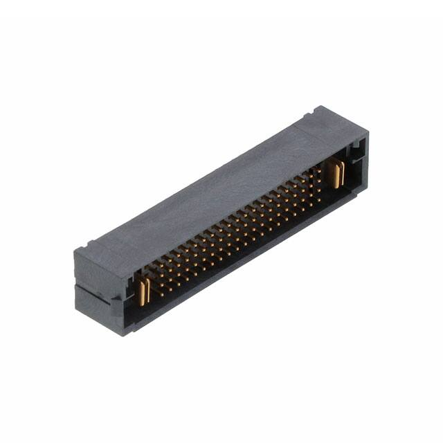

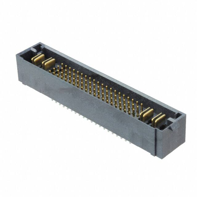

HIGH-POWER SYSTEMS 20-60 A FEATURES & BENEFITS p er bla de • Current Rating: 23 A - 58.7 A per power blade • 3.81 mm, 5.00 mm and 6.35 mm pitch • Dual blade contact system • Power only or power/signal combinations available • Right-angle and vertical orientations • Rugged screw down and locking clip options • Discrete wire cable assembly with 10-16 AWG wire • “Hinged” for unique mating in any orientation from 0° to 90° and space confined applications Selectively loading contacts achieves customer specific creepage and clearance requrements. Hermaphroditic options available (samtec.com?MPPT) Hinging options available (samtec.com?FMPT samtec.com?FMPS) KEY SPECIFICATIONS PET/PES PETC/PESC MPT/MPS MPTC/MPSC UPT/UPS FMPT/ FMPS UPPT MPPT (6.35 mm) .250" (6.35 mm) .250" (pwr) (2.54 mm) .100" (sig) (5.00 mm) .1969" (5.00 mm) .197" (pwr) (2.00 mm) .079" (sig) (3.81 mm) .150" (5.00 mm) .1969" (3.81 mm) .150" (5.00 mm) .1969" CCC (1 PIN)* 58.7 A 31.4 A 28.8 A 28.8 A 23 A 26.7 A 21.4 A 23.3 A CCC (2 PINS)* 48.5 A 28.0 A 24.7 A 24.7 A 18.6 A 22.9 A 19.8 A 20.5 A CCC (3 PINS)* 41.1 A 24.4 A 24.1 A 24.1 A 17.5 A 19.1 A 17.1 A 19.4 A CREEPAGE (3.66 mm) .144" (3.66 mm) .144" (2.86 mm) .113" (2.86 mm) .113" (5.5 mm) .217" (6.53 mm) .257" (1.91 mm) .075" (2.95 mm) .116" CLEARANCE (3.31 mm) .130" (3.31 mm) .130" (2.71 mm) .106" (2.71 mm) .106" (1.51 mm) .059" (2.71 mm) .106" (1.51 mm) .059" (2.71 mm) .106" VAC 725 VAC Signal: 450 VAC Power: 650 VAC 575 VAC 250 VAC 438 VAC 525 VAC 425 VAC 600 VAC VDC 1025 VDC Signal: 636 VDC Power: 919 VDC 812 VDC 354 VDC 620 VDC 742 VDC 600 VDC 848 VDC 100 100 100 100 25 100 100 100 SERIES PITCH CYCLES F-221 samtec.com/PowerStrip Unless otherwise approved in writing by Samtec, all parts and components are designed and built according to Samtec’s specifications which are subject to change without notice. (5.00 mm) .197"(PWR) / (2.00 mm) .079"(SIG) • 30 A SIGNAL/POWER COMBO SYSTEMS - SERIES POWER PINS MPTC Per end MPSC –02 Terminal - –01 Socket - SIGNAL PINS POWER PINS –16 Per end –40 –02 - –01 –24 –80 MPTC LEAD STYLE –6.30 = (6.30 mm) 0.248" (MPTC only) –7.70 = (7.70 mm) 0.303" (MPSC only) - TAIL LENGTH - –01 OTHER OPTION –L = Use with (1.60 mm) .062" Thick PCB –LC = 10 µ" (0.25 µm) Gold on contact, Matte Tin on tail (Power & Signal) –03 = Use with (2.36 mm) .093" Thick PCB = Locking Clip (Manual placement required) –T = Matte tin on contact and tail (power), Gold on contact, Matte tin on tail (Signal) A Board Mates: MPSC Cable Mates: MPCC -V- PLATING OPTION (12.45) .490 (11.38) .448 POWER PINS/ENDS MPSC A Board Mates: MPTC (10.16) .400 A 16 24 40 80 SIGNAL SIGNAL SIGNAL SIGNAL PINS PINS PINS PINS –01 (27.44) 1.081 (31.45) 1.238 (39.44) 1.553 (59.44) 2.340 –02 (37.44) 1.474 (41.45) 1.632 (49.44) 1.946 (69.44) 2.734 View complete specifications at: samtec.com?MPTC & samtec.com?MPSC SERIES - POWER PINS MPTC Per end MPSC –02 Terminal Socket –01 - SIGNAL PINS –24 –80 - POWER PINS TAIL LENGTH - –01 Per end = Use with (1.60 mm) .062" Thick PCB –01 –02 MPTC-RA Board Mates: MPSC Cable Mates: MPCC - 01 - –03 = Use with (2.36 mm) .093" Thick PCB A (15.70) .618 - RA - –L OTHER OPTION –SD or –LC is a required callout = 10 µ" (0.25 µm) Gold on contact, Matte Tin on tail (Power & Signal) –SD = Screw Down –T = Matte Tin on contact and tail (power), Gold on contact, Matte tin on tail (Signal) POWER PINS/ENDS (12.45) .490 –LC = Locking Clip (Manual placement required) A 24 SIGNAL PINS 80 SIGNAL PINS –01 (35.25) 1.388 (63.25) 2.490 –02 (45.25) 1.781 (73.25) 2.884 A MPSC-RA Board Mates: MPTC PLATING OPTION (15.06) .593 POWER PINS/ENDS (10.16) .400 A 24 SIGNAL PINS 80 SIGNAL PINS –01 (36.25) 1.438 (64.25) 2.540 –02 (46.25) 1.831 (74.25) 2.934 View complete specifications at: samtec.com?MPTC & samtec.com?MPSC Note: Some lengths, styles and options are non-standard, non-returnable samtec.com/PowerStrip Unless otherwise approved in writing by Samtec, all parts and components are designed and built according to Samtec’s specifications which are subject to change without notice. F-221
