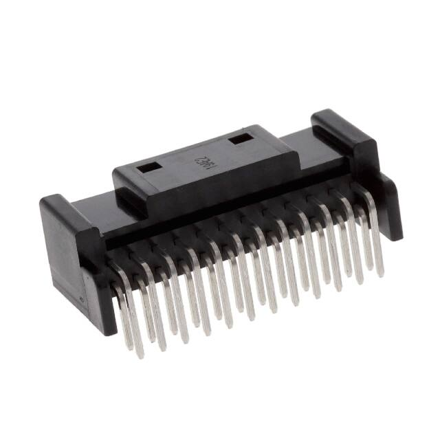

2mm Pitch, Positive lock, Wire-to-Board Connector (UL, C-UL Listed) DF51K Series Secure mating with clear tactile click Aug.1.2021 Copyright 2021 HIROSE ELECTRIC CO., LTD. All Rights Reserved. Insertion force to lock Matches the peak ■ Features 1. ‌Positive lock provides clear tactile click and secures reliable connection The locking mechanism delivers a clear tactile click, which prevents incomplete mating. (Fig.1) 2. Wide variation Insertion force to contact Matching peak insertion forces provides a clear click sound and tactile click Straight and right angle types are available in single row and double row contact arrangements for flexible board design. Gold and Tin plating options support various application needs. Fig.1 3. Easy Lock Release The width of the center lock lever increases as the pin count increases for easy extraction. Additionally, the center lock design does not need side-to-side spacing to un-mate the connector, which enables high density mounting. (Fig.2) 4. Prevents incorrect mating Visually and mechanically polarized design prevents reverse mating and incorrect mating between different number of positions. (Fig.3) 5. Suitable for potting Capable of being potted up to 3mm. (Fig.3) 6. Uses the same crimp tools as DF11 Series Wide applicable cable range : 22 to 30 AWG. (However, the crimp contact of DF51K and DF11 are not compatible with each other.) 7. UL, C-UL certified ■ Applications Office equipment, Industrial machinery, Industrial robots, Amusement equipment, Medical equipment. Center lock width gets wider as the pin count increases for easy operation. Extra spacing not required High workability and high density mounting due to center lock design Fig.2 Secure Center Lock Design Guide Key Prevents Incorrect Mating Resin Sealing 3mm Max. Fig.3 In cases where the application will demand a high level of reliability, such as automotive, please contact a company representative for further information. 2020.08 ① 1 DF51K Series ● 2mm Pitch, Positive lock, Wire-to-Board Connector (UL, C-UL Listed) ■ Product Specifications Ratings Rated Single Current Row (Note 1) Rated Voltage Aug.1.2021 Copyright 2021 HIROSE ELECTRIC CO., LTD. All Rights Reserved. Ratings Number of Contacts 22 AWG 24 AWG 26 AWG 3-6 2A 2A 2A 2A 1.5A 2 4 Double Row Rated Current (Note 1) 6-30 22 AWG 2A Rated Voltage 3A 3A 2A 2.5A 2.5A 250V AC/DC 24 to 28 AWG 1A 28 AWG 1A 30 AWG 0.5A 30 AWG 0.5A 30V AC/DC Items Operating Temperature -55 to +105°C (Note 2) Operating Humidity Range 20 to 80% (Note 3) Storage Temperature -10 to +60°C (Note 4) Storage Humidity Range 40 to 70% (Note 4) UL/C-UL File No., and Recognition No. UL, C-UL : E132750 Specifications Conditions 1. Insulation Resistance No less than 1,000MΩ Measured at 500V DC 3. Contact Resistance No more than 30mΩ Measured at 1mA and no higher than 20mV 2. Withstanding Voltage No flashover or breakdown 4. Vibration Resistance 650V AC is applied for 1 minute Frequency : 10 to 55Hz, half amplitude 0.75mm, 10 times in each of the 3 directions No electrical discontinuity of 1μs or greater 5. Shock Resistance Acceleration velocity : 490m/s2 for 11ms, half-sine wave in 3 directions, 3 times for each directions No electrical discontinuity of 1μs or greater Contact resistance : no more than 30mΩ Insulation resistance : no less than 500MΩ 6. Moisture Resistance Temperature : 40±2°C, humidity : 90 to 95%, left as it is for 96 hours Contact resistance : no more than 30mΩ Insulation resistance : no less than 1,000MΩ 7. Temperature Cycles 8. Mating Durability -55℃: 30 minutes → 105℃ : 30 minutes 5 cycles Contact resistance: no more than 30mΩ 9. Soldering Heat Resistance The resin parts should withstand the temperature and resist melting. Tin plated : 30 mating cycles, Gold plated : 50 mating cycles Flow : 260℃, 5 sec. Hand soldering : temperature of soldering iron at 270℃ for 3 seconds Note 1 : The rated current varies based on the cable size used. Note 2 : Includes temperature rise caused by current flow. Note 3 : Use without condensation on parts. Note 4 : ‌The storage condition refers to long-term storage of the product on the shelf before assembly. Please use the operating temperature for temporary storage such as pre-assembly and during shipping. ■ Material / Finish Product Header Crimp Socket Socket Contact 2 Part Material Finish Brass Tin Plated or Gold Plated Phosphor bronze Tin Plated or Gold Plated Insulator Straight : PA66 Right Angle : PBT (glass-reinforced) Insulator PBT (glass-reinforced) Contact Contact Black Black UL Regulation UL94V-0 UL94V-0 DF51K Series ● 2mm Pitch, Positive lock, Wire-to-Board Connector (UL, C-UL Listed) ■ Product Number Structure Refer to the chart below when determining the product specifications from the product number. Please select from the product numbers listed in this catalog when placing orders. ● Connector DF51K # 1 2 ● Crimp Contact * 3 P - 2 DSA 4 5 6 DF51K - 2428 SCF A Aug.1.2021 Copyright 2021 HIROSE ELECTRIC CO., LTD. All Rights Reserved. 1 7 8 9 1 Series Name : DF51K 3 Number of Contacts Single-row : 2 to 6 Double-row : 4 to 30 2 4 5 Form Type Blank : Without guide-boss B : Guide-boss type Connector type P : Single-row pin header S : Single-row crimp socket DP : Double-row pin header DS : Double-row crimp socket Contact Pitch : 2mm 6 7 8 9 Type of Housing DSA : Straight header DS : Right angle header C : Crimp socket Applicable Conductor 22 : 22 AWG 2428 : 24 to 28 AWG 30 : 30 AWG Packaging SC : Socket contacts/pack SCF : Socket contacts/reel Plating Specifications Blank : Tin plated A : Gold plated ■ Diagram of Connector Mating Combinations ● Single-row Crimp Socket DF51K-*S-2C Socket Contact DF51K-22SC(F)(A) DF51K-2428SC(F)(A) Straight Header DF51K-*P-2DSA DF51K-30SC(F)(A) Right Angle Header DF51K(B)-*P-2DS ● Double-row Crimp Socket DF51K-*DS-2C Socket Contact DF51K-22SC(F)(A) DF51K-2428SC(F)(A) Straight Header DF51K-*DP-2DSA DF51K-30SC(F)(A) Right Angle Header DF51K(B)-*DP-2DS 3 DF51K Series ● 2mm Pitch, Positive lock, Wire-to-Board Connector (UL, C-UL Listed) Aug.1.2021 Copyright 2021 HIROSE ELECTRIC CO., LTD. All Rights Reserved. ■ Single-row Straight Header Part No. HRS No. No. of Contacts 480-0543-0 ** 3 480-0545-0 ** 5 DF51K-2P-2DSA(8**) 480-0542-0 ** DF51K-4P-2DSA(8**) 480-0544-0 ** DF51K-3P-2DSA(8**) DF51K-5P-2DSA(8**) DF51K-6P-2DSA(8**) Recommended PCB Layout (t=1.6mm) A 2 480-0546-0 ** 2.0 4 11.2 6.0 6 15.2 9.2 No. of Contacts 480-0548-0 ** 6 DF51K-4DP-2DSA(8**) 480-0547-0 ** DF51K-8DP-2DSA(8**) 480-0549-0 ** DF51K-6DP-2DSA(8**) DF51K-10DP-2DSA(8**) DF51K-12DP-2DSA(8**) DF51K-14DP-2DSA(8**) DF51K-16DP-2DSA(8**) Recommended PCB Layout (t=1.6mm) B Part No. [Specification number] - **, (8**) 00 : Tin plated 05 : Gold plated HRS No. No. of Contacts 480-0555-0 ** 20 2.0 DF51K-18DP-2DSA(8**) 480-0554-0 ** 8 11.2 6.0 DF51K-22DP-2DSA(8**) 480-0556-0 ** 12 15.2 10.0 480-0552-0 ** 14 16 9.2 13.2 4.0 8.0 17.2 12.0 19.2 14.0 DF51K-20DP-2DSA(8**) DF51K-24DP-2DSA(8**) DF51K-26DP-2DSA(8**) DF51K-28DP-2DSA(8**) DF51K-30DP-2DSA(8**) Note : The sales unit is one pack (100pcs/pack). Order by number of packs. 4 10.0 7.2 10 480-0553-0 ** 8.0 4 480-0550-0 ** 480-0551-0 ** A 4.0 13.2 ■ Double-row Straight Header HRS No. B 7.2 Note : The sales unit is one pack(100pcs/pack). Order by number of packs. Part No. [Specification number] - **, (8**) 00 : Tin plated 05 : Gold plated 480-0557-0 ** 480-0558-0 ** 480-0559-0 ** 480-0560-0 ** A B 18 21.2 16.0 22 25.2 20.0 24 26 28 30 23.2 18.0 27.2 22.0 29.2 24.0 31.2 26.0 33.2 28.0 DF51K Series ● 2mm Pitch, Positive lock, Wire-to-Board Connector (UL, C-UL Listed) Aug.1.2021 Copyright 2021 HIROSE ELECTRIC CO., LTD. All Rights Reserved. ■ Single-row Right Angle Header Recommended PCB Layout (t=1.6mm) *The above drawing is of guide-boss type. Part No. HRS No. Guide-Boss No. of Contacts 480-0588-0 ** With boss 3 DF51KB-2P-2DS(8**) 480-0587-0 ** DF51K-4P-2DS(8**) 480-0589-0 ** Without boss 480-0591-0 ** Without boss DF51KB-3P-2DS(8**) DF51K-5P-2DS(8**) DF51K-6P-2DS(8**) 480-0590-0 ** Note : The sales unit is one tray. Order by number of trays. With boss Without boss A [Specification number] - **, (8**) 00 : Tin plated, tray packaging 05 : Gold plated, tray packaging B 2 7.2 2.0 4 11.2 6.0 6 15.2 5 9.2 13.2 4.0 8.0 10.0 C Quantity per Package 7.14 330 5.14 420 270 230 200 5 DF51K Series ● 2mm Pitch, Positive lock, Wire-to-Board Connector (UL, C-UL Listed) ■ Double-row Right Angle Header Aug.1.2021 Copyright 2021 HIROSE ELECTRIC CO., LTD. All Rights Reserved. Recommended PCB Layout (t=1.6mm) *The above drawing is of guide-boss type. Part No. HRS No. Guide-Boss No. of Contacts 480-0593-0 ** With boss 6 Without boss 10 Without boss 14 DF51KB-4DP-2DS(8**) 480-0592-0 ** DF51K-8DP-2DS(8**) 480-0594-0 ** Without boss DF51K-12DP-2DS(8**) 480-0596-0 ** Without boss DF51KB-6DP-2DS(8**) DF51K-10DP-2DS(8**) DF51K-14DP-2DS(8**) DF51K-16DP-2DS(8**) DF51K-18DP-2DS(8**) DF51K-20DP-2DS(8**) DF51K-22DP-2DS(8**) DF51K-24DP-2DS(8**) DF51K-26DP-2DS(8**) DF51K-28DP-2DS(8**) DF51K-30DP-2DS(8**) 480-0595-0 ** 480-0597-0 ** 480-0598-0 ** 480-0599-0 ** 480-0600-0 ** 480-0601-0 ** 480-0602-0 ** 480-0603-0 ** 480-0604-0 ** 480-0605-0 ** Note : The sales unit is one tray. Order by number of trays. 6 With boss Without boss Without boss Without boss Without boss Without boss Without boss Without boss Without boss 4 A 7.2 [Specification number] - **, (8**) 00 : Tin plated, tray packaging 05 : Gold plated, tray packaging B 2.0 9.2 4.0 13.2 8.0 8 11.2 12 15.2 10.0 19.2 14.0 16 18 20 22 24 26 28 30 17.2 21.2 23.2 25.2 27.2 29.2 31.2 33.2 6.0 12.0 16.0 18.0 20.0 22.0 24.0 26.0 28.0 C Quantity per Package 7.14 330 5.14 420 270 230 200 170 150 140 130 120 110 100 90 90 DF51K Series ● 2mm Pitch, Positive lock, Wire-to-Board Connector (UL, C-UL Listed) ■ Crimp Socket Aug.1.2021 Copyright 2021 HIROSE ELECTRIC CO., LTD. All Rights Reserved. ● Single-row Part No. HRS No. No. of Contacts 480-0562-0 00 3 DF51K-2S-2C(800) 480-0561-0 00 DF51K-4S-2C(800) 480-0563-0 00 DF51K-3S-2C(800) DF51K-5S-2C(800) DF51K-6S-2C(800) 480-0564-0 00 480-0565-0 00 Note : The sales unit is one pack (100pcs/pack). Order by number of packs. A B 2 6.8 2.0 4 10.8 6.0 6 14.8 5 8.8 12.8 4.0 8.0 10.0 ● Double-row Part No. HRS No. No. of Contacts 480-0568-0 00 6 DF51K-4DS-2C(800) 480-0567-0 00 DF51K-8DS-2C(800) 480-0569-0 00 DF51K-6DS-2C(800) DF51K-10DS-2C(800) DF51K-12DS-2C(800) DF51K-14DS-2C(800) DF51K-16DS-2C(800) DF51K-18DS-2C(800) DF51K-20DS-2C(800) DF51K-22DS-2C(800) DF51K-24DS-2C(800) DF51K-26DS-2C(800) DF51K-28DS-2C(800) DF51K-30DS-2C(800) 2.0 8 10.8 6.0 12 14.8 10.0 18.8 14.0 10 480-0572-0 00 14 480-0573-0 00 480-0574-0 00 480-0575-0 00 480-0576-0 00 480-0577-0 00 480-0578-0 00 480-0579-0 00 480-0580-0 00 Note : The sales unit is one pack (100pcs/pack). Order by number of packs. B 6.8 480-0570-0 00 480-0571-0 00 A 4 16 18 20 22 24 26 28 30 8.8 12.8 16.8 20.8 22.8 24.8 26.8 28.8 30.8 32.8 4.0 8.0 12.0 16.0 18.0 20.0 22.0 24.0 26.0 28.0 7 DF51K Series ● 2mm Pitch, Positive lock, Wire-to-Board Connector (UL, C-UL Listed) ■ Socket Contact Part No. Packaging DF51K-22SCF(800) 480-0581-0 00 10,000/reel DF51K-2428SCF(800) 480-0583-0 00 10,000/reel 480-0585-0 00 10,000/reel 480-0612-0 00 10,000/reel 480-0614-0 00 10,000/reel 480-0616-0 00 10,000/reel DF51K-22SC(800) DF51K-2428SC(800) DF51K-30SCF(800) DF51K-30SC(800) DF51K-22SCFA(800) DF51K-22SCA(800) DF51K-2428SCFA(800) Aug.1.2021 Copyright 2021 HIROSE ELECTRIC CO., LTD. All Rights Reserved. HRS No. DF51K-2428SCA(800) DF51K-30SCFA(800) DF51K-30SCA(800) 480-0582-0 00 480-0584-0 00 480-0586-0 00 480-0613-0 00 480-0615-0 00 480-0617-0 00 Finish 100/pack Tin plated 100/pack 100/pack 100/pack Gold plated 100/pack 100/pack ● Applicable wire (Tinned, Annealed copper wire) UL 1061 Wire Size (Stranded Wire Structure) 1007 1061 Jacket Diameter 22 AWG (17 pieces / 0.16mm) Ø1.2 to Ø1.45mm 26 AWG (7 pieces / 0.16mm) Ø0.9 to Ø1.45mm 30 AWG (7 pieces / 0.1mm) Ø0.8mm 24 AWG (11 pieces / 0.16mm) 28 AWG (7 pieces / 0.127mm) Note 1 : Applicable ‌ Tool : Applicator Note 2 : Contact ‌ your Hirose representative when considering usage of non-applicable wires. Applicable Crimping Tool Type Applicator Press Unit Hand Tool Contact Extraction Tool Part No. HRS No. Wire Type Applicable Contacts AP105-DF11-22S 901-4529-7 00 UL1061 (22 AWG) DF51K-22SCF/SCFA AP105-DF11-30S 901-4532-1 00 UL1061 (30 AWG) DF51K-30SCF/SCFA AP105-DF11-2428S CM-105C HT801/DF11-22S(A) HT801/DF11-2428S(A) HT801/DF11-30S(A) DF-C-PO(B) 901-4511-1 00 901-0001-0 00 UL1007 (24 to 28 AWG) DF51K-2428SCF/SCFA 550-0407-5 00 UL1061 (22 AWG) DF51K-22SC/SCA 550-0408-8 00 UL1061 (30 AWG) DF51K-30SC/SCA 550-0403-4 00 550-0179-2 00 UL1007 (24 to 28 AWG) DF51K-2428SC/SCA DF51K-*****SCF/SCFA Note 3 : Please conduct crimping work according to the "Crimping work standards" and "Crimping condition table". Note 4 : Any problems that occur from using tools other than those specified by Hirose are not covered by warranty. Note 5 : Please contact Hirose for information about hand tooling. 8 DF51K Series ● 2mm Pitch, Positive lock, Wire-to-Board Connector (UL, C-UL Listed) Mated Dimensions ● Wire-to-Board connection using the straight header [Single-row] [Double-row] DF51K-*DS-2C DF51K-*S-2C DF51K-*DP-2DSA Aug.1.2021 Copyright 2021 HIROSE ELECTRIC CO., LTD. All Rights Reserved. DF51K-*P-2DSA ● Wire-to-Board connection using the right angle header [Single-row] [Double-row] DF51K(B)-*DP-2DS DF51K(B)-*P-2DS DF51K-*S-2C Precautions for use DF51K-*DS-2C 1. ‌The connector could be damaged if pulled out forcibly. When it is hard to pull out, push it in slightly first and then depress the lock and un-mate. Please refer to “DF51K mating and unmating Procedure Document (DOC180208-010)” for points in handling regarding mating operations. 2. When mating a crimped contact into a socket, please refrain from inserting it diagonally in order to maintain performance reliability. Please refer to the "Harness procedure manual (DOC180330-002)" for points in harness operations. Operating Environment Please contact a Hirose representative if you are designing this connector into environmental conditions where high and low temperatures are repeated. While taking in consideration Specifications mentioned in this catalog are reference values. When considering to order or use this product, please confirm the " Drawing" and " Product Specifications" sheets. Use an appropriate cable when using the connector in combination with cables. If considering usage of a non-specified cable, please contact your sales representative. If assembly process is done by jigs & tools which are not identified by Hirose assurance will not be given. If considering usage for below mentioned applications, please contact your sales representative. In cases where the application will demand a high level of reliability, such as automotive, medical instruments, public infrastructure, aerospace/ defense etc. Hirose must review before assurance of reliability can be given. 9 DF51K Series ● 2mm Pitch, Positive lock, Wire-to-Board Connector (UL, C-UL Listed) Aug.1.2021 Copyright 2021 HIROSE ELECTRIC CO., LTD. All Rights Reserved. MEMO 10 DF51K Series ● 2mm Pitch, Positive lock, Wire-to-Board Connector (UL, C-UL Listed) Aug.1.2021 Copyright 2021 HIROSE ELECTRIC CO., LTD. All Rights Reserved. MEMO 11 DF51K Series ● 2mm Pitch, Positive lock, Wire-to-Board Connector (UL, C-UL Listed) [ JAPAN ] [ GERMANY ] [ TAIWAN ] Headquarters GERMAN Branch / STUTTGART Office TAIWAN Office HIROSE ELECTRIC CO., LTD. HIROSE ELECTRIC EUROPE B.V. HIROSE ELECTRIC (TAIWAN) CO., LTD. Phone : +81-45-620-7410 http://www.hirose.com Phone : +49-711-456002-1 http://www.hirose.com/eu/ Phone : +886-2-2555-7377 http://www.hirose.com/tw/ NUREMBERG Office HIROSE ELECTRIC EUROPE B.V. [ U.S.A ] Phone : +49-911-326889-63 http://www.hirose.com/eu/ US Headquarters / CHICAGO Office HIROSE ELECTRIC ( U.S.A.), INC. HANOVER Office Phone : +1-630-282-6700 http://www.hirose.com/us/ HIROSE ELECTRIC EUROPE B.V. Phone : +49-511-978261-30 http://www.hirose.com/eu/ [ KOREA ] KOREA Office HIROSE KOREA CO.,LTD. Phone : +82-31-496-7000 http://www.hirose.co.kr/ SAN JOSE Office HIROSE ELECTRIC ( U.S.A.), INC. Aug.1.2021 Copyright 2021 HIROSE ELECTRIC CO., LTD. All Rights Reserved. Phone : +1-408-253-9640 http://www.hirose.com/us/ [ FRANCE ] DETROIT Office (AUTOMOTIVE) HIROSE ELECTRIC ( U.S.A.), INC. PARIS Office Phone : +1-734-542-9963 http://www.hirose.com/us/ Phone : +33-1-85764886 http://www.hirose.com/eu/ HIROSE ELECTRIC EUROPE B.V. [ SINGAPORE ] SINGAPORE Office HIROSE ELECTRIC SINGAPORE PTE. LTD. Phone : +65-6324-6113 http://www.hirose.com/sg/ BOSTON Office HIROSE ELECTRIC ( U.S.A.), INC. [ ITALY ] Phone : +1-978-655-9850 http://www.hirose.com/us/ MILAN Office DALLAS Office HIROSE ELECTRIC EUROPE B.V. HIROSE ELECTRIC ( U.S.A.), INC. Phone : +39-02-36636350 http://www.hirose.com/eu/ Phone : +1-972-324-3370 http://www.hirose.com/us/ IRVINE Office HIROSE ELECTRIC ( U.S.A.), INC. Phone : +1-949-930-3750 http://www.hirose.com/us/ [ CHINA ] CHINA Headquarters / SHANGHAI Branch HIROSE ELECTRIC ( CHINA ) CO., LTD. Phone : +86-21-6391-3355 http://www.hirose.com/cn/ [ THE NETHERLANDS ] EU Headquarters / AMSTERDAM OFFICE HIROSE ELECTRIC EUROPE B.V. Phone : +31-20-6557460 http://www.hirose.com/eu/ [ UNITED KINGDOM ] UK Branch HIROSE ELECTRIC EUROPE B.V. Phone : +44-1908-202050 http://www.hirose.com/eu/ [ THAILAND ] BANGKOK Liaison Office HIROSE ELECTRIC SINGAPORE PTE. LTD. Phone : +66-2-686-1255 http://www.hirose.com/sg/ [ MALAYSIA ] PENANG Representative Office HIROSE ELECTRIC SINGAPORE PTE. LTD. Phone : +60-4-648-5536 http://www.hirose.com/sg/ SHENZHEN Branch HIROSE ELECTRIC ( CHINA ) CO., LTD. Phone : +86-755-8207-0851 http://www.hirose.com/cn/ [ INDIA ] BANGALORE Office BEIJING Branch HIROSE ELECTRIC INDIA PVT. LTD. HIROSE ELECTRIC ( CHINA ) CO.,LTD. Phone : +91-80-4120-1907 http://www.hirose.com/sg/ Phone : +86-10-5165-9332 http://www.hirose.com/cn/ GUANGZHOU Branch HIROSE ELECTRIC ( CHINA ) CO.,LTD. Phone : +86-180-9895-1861 http://www.hirose.com/cn/ DELHI Office HIROSE ELECTRIC INDIA PVT. LTD. Phone : +91-120-660-8018 http://www.hirose.com/sg/ [ HONG KONG ] HONG KONG Office HIROSE ELECTRIC HONGKONG TRADING CO., LTD. Phone : +852-2803-5338 http://www.hirose.com/hk/    2-6-3,Nakagawa Chuoh,Tsuzuki-Ku,Yokohama-Shi 224-8540,JAPAN 12 The contents of this catalog are current as of date of 08/2020. Contents are subject to change without notice for the purpose of improvements. Mouser Electronics Authorized Distributor Click to View Pricing, Inventory, Delivery & Lifecycle Information: Hirose Electric: DF51K-10DP-2DS(800) DF51K-12DP-2DS(805) DF51K-12DP-2DSA(800) DF51K-12DP-2DSA(805) DF51K-14DP2DS(800) DF51KB-4DP-2DS(805) HT801/DF51K-22S(A) HT801/DF51K-2428S(A) HT801/DF51K-30S(A) DF51KB2P-2DS(800) DF51KB-2P-2DS(805) DF51KB-3P-2DS(800) DF51KB-4DP-2DS(800) DF51K-6P-2DSA(805) DF51K8DP-2DS(800) DF51K-5P-2DSA(805) DF51K-5S-2C(800) DF51K-6P-2DS(800) DF51K-4P-2DSA(805) DF51K-5P2DS(800) DF51K-5P-2DS(805) DF51K-4DP-2DSA(800) DF51K-4P-2DS(800) DF51K-4P-2DS(805) DF51K30SC(800) DF51K-30SCA(800) DF51K-30SCF(800) DF51K-30SCFA(800) DF51K-3P-2DSA(805) DF51K-2S2C(800) DF51K-30DP-2DS(800) DF51K-30DP-2DS(805) DF51K-30DP-2DSA(805) DF51K-30DS-2C(800) DF51K28DP-2DS(805) DF51K-28DS-2C(800) DF51K-2P-2DSA(805) DF51K-26DP-2DS(800) DF51K-26DP-2DS(805) DF51K-26DS-2C(800) DF51K-28DP-2DS(800) DF51K-24DP-2DS(800) DF51K-24DP-2DS(805) DF51K-24DP2DSA(805) DF51K-24DS-2C(800) DF51K-2428SC(800) DF51K-2428SCF(800) DF51K-10DP-2DSA(800) DF51K12DP-2DS(800) DF51K-22DP-2DS(805) DF51K-20DP-2DS(800) DF51K-20DP-2DS(805) DF51K-22DP-2DS(800) DF51K-18DP-2DS(800) DF51K-18DP-2DS(805) DF51K-18DS-2C(800) DF51K-14DP-2DS(805) DF51K-16DP2DS(800) DF51K-16DP-2DSA(805)

物料型号:HIROSE ELECTRIC CO., LTD.生产的DF51K系列,2mm间距,正锁定,线对板连接器。
器件简介:DF51K系列提供直插和直角类型的单排和双排接触布局,支持金和锡电镀选项,适用于多种应用需求。
引脚分配:支持2至30个接触点,适用于22至30 AWG的电缆。
参数特性: - 额定电流因电缆尺寸而异,例如22 AWG为3A,24至28 AWG为2A,30 AWG为1A或0.5A。 - 工作温度范围为-55至+105°C。 - 存储温度范围为-10至+60°C。 - 绝缘电阻不低于1000MΩ,耐电压测试为650V AC持续1分钟无击穿或闪络。
功能详解: - 正锁定机制提供清晰的触觉点击感,防止不完全连接。 - 中心锁定设计便于操作,且在解锁时无需左右间距。 - 视觉和机械极性设计防止反向或不同位数的错误连接。 - 可承受最多3mm的灌封。 - 使用与DF11系列相同的压接工具。
应用信息:适用于办公设备、工业机械、工业机器人、游乐设备和医疗设备等。
封装信息: - 提供直插和直角两种封装类型。 - 绝缘体材料为PA66(直插)或PBT(玻璃纤维增强,直角)。 - 接触材料为黄铜,锡或金电镀。 - 封装符合UL94V-0标准。
