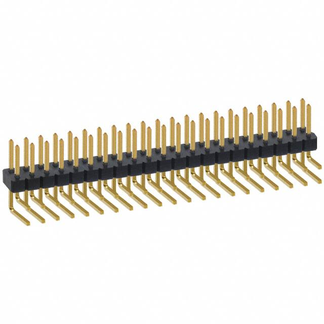

    CONN HEADER R/A 38POS 2MM
NRPN192PARN-RC 数据手册
Headers .079” [2.00 mm] Contact Centers, Male Headers, Straight/Right Angle/SMT SPECIFICATIONS • • • • • 2 Amps current rating UL Flammability Rating: 94V-0 Insulator Material: Nylon Contact Material: Brass Stacker Options available - Consult Factory JUMPERS .079” [2.00] .138” [3.50] .157” [4.00] PART NUMBER: SPN02SYBN-RC (GOLD FLASH) STN02SYBN-RC (TIN PLATE) READOUT .079” [2.00] .157” [4.00] .110” [2.80] .079” [2.00] .079” [2.00] .079” [2.00] .157” [4.00] .079” [2.00] .079” [2.00] .059” [1.50] .087” [2.20] .256” [6.50] .079”[2.00] .079”[2.00] .059” [1.50] .079” [2.00] .118” [3.00] .039”[1.00] .315”[8.00] QUAD (4) DUAL (2) SINGLE (1) Headers .079” [2.00] .157” [4.00] TERMINATION TYPE TAIL TAIL .039”[1.00] HEAD .039”[1.00] HEAD HEAD HEAD TAIL TAIL .020”[0.50] SQ. STRAIGHT P/N TERMINATION ROWS HEAD CODE TYPE .142” PAE STRAIGHT 1 [3.60] .110” [2.80] TAIL PAE 2 STRAIGHT .142” [3.60] .110” [2.80] RCC 4 STRAIGHT .173” [4.40] .094” [2.40] RIGHT ANGLE SMT P/N TERMINATION ROWS HEAD CODE TYPE .142” PAR 1 RIGHT ANGLE [3.60] .110” [2.80] .142” [3.60] .110” [2.80] PAR 2 RIGHT ANGLE TAIL P/N TERMINATION ROWS HEAD CODE TYPE TAIL .142” [3.60] .256” [6.50] MAM 2 SMT MOUNTING STYLE Guide Post Straight or Right Angle (N) 104 Dual Row SMT, Without Guide Posts (S) Dual Row SMT, With Guide Posts (P) www.sullinscorp.com | 760-744-0125 | toll-free 888-774-3100 | fax 760-744-6081 | info@sullinscorp.com Headers .079” [2.00 mm] Contact Centers, Male Headers, Straight/Right Angle/SMT PART NUMBER OPTIONS N R P N 40 1 PAE N - RC INSULATOR MATERIAL N = Nylon RoHS COMPLIANT Consult Factory For Modifications CONTACTS R = Brass CONTACT FINISH - RoHS Compliant P = Gold Flash Overall MOUNTING STYLE N = No Mounting P = Surface Mount with Guide Posts (Dual Row) S = Surface Mount without Guide Posts (Dual Row) TERMINATION TYPE MAM, PAE, PAR, RCC CONTACT CENTERS N = .079” [2.00 mm] NUMBER OF ROWS 1 = One row 2 = Two rows 4 = Four rows NUMBER OF POSITIONS Positions Termination Available 2 Thru 40 = MAM, PAE, PAR 3 Thru 30 = RCC DIMENSIONS Dimensions in [ ] are in millimeters, all others are in inches. 2X .050 [1.27] A .079 [2.00], TYP. HEAD .020 [0.50] SQUARE POST FITS Ø.031 [0.80] MINIMUM B QUAD READOUT, STRAIGHT TAIL SHOWN B DUAL READOUT, STRAIGHT TAIL SHOWN B SINGLE READOUT, STRAIGHT TAIL SHOWN NRPN02 _ _ _ _ _ -RC NRPN03 _ _ _ _ _ -RC NRPN04 _ _ _ _ _ -RC NRPN05 _ _ _ _ _ -RC NRPN06 _ _ _ _ _ -RC NRPN07 _ _ _ _ _ -RC NRPN08 _ _ _ _ _ -RC NRPN09 _ _ _ _ _ -RC NRPN10 _ _ _ _ _ -RC NRPN11 _ _ _ _ _ -RC NRPN12 _ _ _ _ _ -RC NRPN13 _ _ _ _ _ -RC NRPN14 _ _ _ _ _ -RC NRPN15 _ _ _ _ _ -RC NRPN16 _ _ _ _ _ -RC NRPN17 _ _ _ _ _ -RC NRPN18 _ _ _ _ _ -RC NRPN19 _ _ _ _ _ -RC NRPN20 _ _ _ _ _ -RC NRPN21 _ _ _ _ _ -RC NRPN22 _ _ _ _ _ -RC NRPN23 _ _ _ _ _ -RC NRPN24 _ _ _ _ _ -RC NRPN25 _ _ _ _ _ -RC NRPN26 _ _ _ _ _ -RC NRPN27 _ _ _ _ _ -RC NRPN28 _ _ _ _ _ -RC NRPN29 _ _ _ _ _ -RC NRPN30 _ _ _ _ _ -RC NRPN31 _ _ _ _ _ -RC NRPN32 _ _ _ _ _ -RC NRPN33 _ _ _ _ _ -RC NRPN34 _ _ _ _ _ -RC NRPN35 _ _ _ _ _ -RC NRPN36 _ _ _ _ _ -RC NRPN37 _ _ _ _ _ -RC NRPN38 _ _ _ _ _ -RC NRPN39 _ _ _ _ _ -RC NRPN40 _ _ _ _ _ -RC A B in mm in mm 0.079 0.157 0.236 0.315 0.394 0.472 0.551 0.630 0.709 0.787 0.866 0.945 1.024 1.102 1.181 1.260 1.339 1.417 1.496 1.575 1.654 1.732 1.811 1.890 1.969 2.047 2.126 2.205 2.283 2.362 2.441 2.520 2.598 2.677 2.756 2.835 2.913 2.992 3.071 2.00 4.00 6.00 8.00 10.00 12.00 14.00 16.00 18.00 20.00 22.00 24.00 26.00 28.00 30.00 32.00 34.00 36.00 38.00 40.00 42.00 44.00 46.00 48.00 50.00 52.00 54.00 56.00 58.00 60.00 62.00 64.00 66.00 68.00 70.00 72.00 74.00 76.00 78.00 0.157 0.236 0.315 0.394 0.472 0.551 0.630 0.709 0.787 0.866 0.945 1.024 1.102 1.181 1.260 1.339 1.417 1.496 1.575 1.654 1.732 1.811 1.890 1.969 2.047 2.126 2.205 2.283 2.362 2.441 2.520 2.598 2.677 2.756 2.835 2.913 2.992 3.071 3.150 4.00 6.00 8.00 10.00 12.00 14.00 16.00 18.00 20.00 22.00 24.00 26.00 28.00 30.00 32.00 34.00 36.00 38.00 40.00 42.00 44.00 46.00 48.00 50.00 52.00 54.00 56.00 58.00 60.00 62.00 64.00 66.00 68.00 70.00 72.00 74.00 76.00 78.00 80.00 www.sullinscorp.com | 760-744-0125 | toll-free 888-774-3100 | fax 760-744-6081 | info@sullinscorp.com Headers TAIL PART NUMBER NUMBER OF CONTACTS SINGLE/DUAL/ QUAD 02/04 03/06/12 04/08/16 05/10/20 06/12/24 07/14/28 08/16/32 09/18/36 10/20/40 11/22/44 12/24/48 13/26/52 14/28/56 15/30/60 16/32/64 17/34/68 18/36/72 19/38/76 20/40/80 21/42/84 22/44/88 23/46/92 24/48/96 25/50/100 26/52/104 27/54/108 28/56/112 29/58/116 30/60/120 31/62 32/64 33/66 34/68 35/70 36/72 37/74 38/76 39/78 40/80 105
NRPN192PARN-RC
1. 物料型号:文档列出了多种型号的公头连接器,例如SPN02SYBN-RC(金镀层)和STN02SYBN-RC(锡镀层)。
2. 器件简介:这些公头连接器具有2安培的电流额定值,UL可燃性等级94V-0,绝缘体材料为尼龙,接触材料为黄铜。
3. 引脚分配:提供了不同配置的引脚分配,包括单排、双排和四排,以及不同长度的引脚。
4. 参数特性:包括接触中心的距离(.079" [2.00 mm]),以及不同型号的尺寸参数。
5. 功能详解:文档提供了不同类型公头连接器的详细信息,如直插式(Straight)、直角式(Right Angle)和SMT(表面贴装技术)。
6. 应用信息:虽然文档没有直接提供应用信息,但从提供的规格和型号可以推断这些连接器适用于多种电子设备和电路板的连接。
7. 封装信息:提供了详细的封装尺寸,包括引脚中心距离、宽度和高度等。
8. 其他信息:文档还提供了制造商的联系信息和网站链接。
