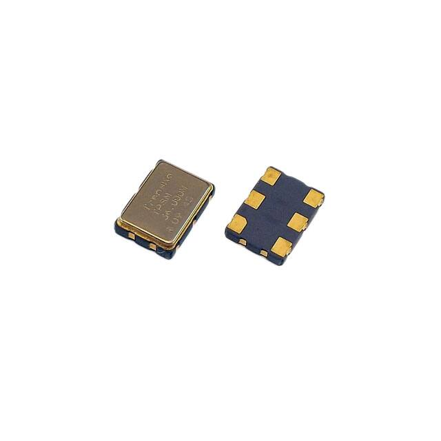

    有源晶振 96.000000MHz 2.5V 0℃~+70℃ LVPECL
TPSM-P50HM25ST1-96.000M 数据手册
TPSM RoHS Compliant CERAMIC SMD LVPECL OUTPUT OSCILLATOR (7.0 x 5.0 x 1.6mm) FEATURES:  HIGH FREQUENCY   ULTRA LOW PHASE JITTER PERFORMACE ENABLE / DISABLE ■ SPECIFICATION 2.5V: 12.000MHz ~ 312.500MHz 3.3V: 12.000MHz ~ 800.000MHz FREQUENCY RANGE FREQUENCY STABILITY ±15ppm ~ ±100ppm OPERATING TEMPERATURE RANGE STORAGE TEMPERATURE RANGE SUPPLY VOLTAGE ± 10% SUPPLY CURRENT STD: 0°C ~ 70°C, Option: -40°C ~ 85°C (See P/N guide for other options) -55°C ~ 125°C 2.5VDC ~ 3.3VDC 100mA max. LOGIC FAMILY LOAD LEVEL LOGIC ‘1’ (VOH) LEVEL LOGIC ‘0’ (VOL) OUTPUT PEAK TO PEAK SYMMETRY(DUTY CYCLE) RISE AND FALL TIME (Tr/Tf) START UP TIME ENABLE (VIH) STAND-BY VOLTAGE DISABLE (VIL) AGING @ +25°C ±3°C PHASE JITTER (12kHz ~ 20MHz) LVPECL 50 (into VDD - 2.0VDC) VDD - 1.025VDC min. VDD - 1.620VDC max. 600mV min. 800mV typ. STD: 40% / 60% , Option: 45% / 55% 250pS typ. 1.0nS max. 10mS max. 0.7 x VDD ≤ VIH ≤ VDD or N/C VIL ≤ 0.3 x VDD ±3.0ppm / 1st year max. 1.0pS max. ■ PACKAGE DIMENSIONS ■ SOLDER PATTERN ■ REFLOW PROFILE Soldering 2.0 6 5 4 170 ±5°C 1.8 150 ±5°C MARKING
