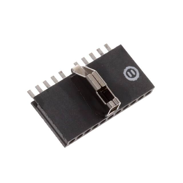

PART NO.
M AT E R IAL S & S P E C IF I C AT IO N S
A 2 4 0 0 1 -0 1 0
REV
ECO
DATE
AP P
E
102048
11-03 -1 5
TLM
INSULATOR:
P O L Y P H E N Y L E N E S U L F ID E (P P S )
P E R M IL -M -2 4 5 1 9 , T Y P E G S T
40F.
CONTACT:
B E R Y L L IU M C O P P E R P E R A S T M
B194, C 17200. G O LD PLATED
P E R A S T M B 4 8 8 , (H A R D G O L D )
T Y P E II C O D E C C L A S S 1 .2 7 .
A C T U A L S IZ E
.0 1 9 X . 0 0 5 ( T Y P )
[0 .4 8 ] [0 .1 3 ]
SO LD E R C O AT E D
TERMINATION:
S O L D E R C O A T E D W IT H S N 6 3 A P E R
J -S T D -0 0 6 O R A M S -P -8 1 7 2 8 .
.1 0 0
2 .5 4
. 0 5 0 (T Y P )
1 .2 7
L AT C H B O X :
B 1 9 4 N IC K E L P L A T E P E R S A E A M S -2 4 0 4 .
.2 8 5
7 .2 4
CU R R E N T C AP AC ITY:
3 A M P M AX.
.0 6 0
1 .5 2
(T Y P )
CON TACT RE S IS TAN CE:
2 6 M IL L IO H M S ( 6 5 m V ) M A X @
2 .5 A M P S .
.3 2 0
8 .1 3
. 0 2 5 (T Y P )
0 .6 4
C O N N E C TO R FA C E
.5 7
1 4 .5
S U G G E S T E D P A D L A YO U T
PERFORMANCE:
P R O D U C T F A M IL Y T E S T E D T O A N D
PASSED THE PERFO RMANCE
S P E C IF IC A T IO N S O F T A B L E V II O F
M IL - D T L - 8 3 5 1 3 .
BO N D E D
10
. 1 0 M AX
2 . 4 M AX
1
.0 7 5
1 .9 1
(1 0 ) S P A C E S @
. 0 5 0 = .5 0 0
[1 .2 7 ] [1 2 .7 0 ]
NOTE:
PS1
S L DW
D IM E N S IO N S IN [ ] A R E IN
M I L L IM E T E R S U N L E S S
O T H E R W IS E N O T E D A N D A R E
FO R REFER EN CE ON LY
T H IR D A N G L E
-T O L E R A N C E S U N L E S S O T H E R W IS E N O TE D
D I M E N S IO N S IN IN C H E S
2 P L D E C
3 P L D E C
4 P L D E C
ANG LES
.0 1
.0 0 5
.0 0 0 5
1
.0 3 5
0 .8 9
.3 4 0
8 .6 4
CAG E CO DE
DW G NO .
T H I S D R A W IN G C O N T A I N S C O N F ID E N T I A L A N D P R O P R IE T A R Y IN F O R M A T IO N W H I C H IS T H E P R O P E R T Y O F
O M N E T I C S C O N N E C T O R C O R P . T H I S D O C U M E N T M A Y N O T , IN W H O L E O R I N P A R T , B E D U P L IC A T E D , O R
D IS C L O S E D F O R A N Y P U R P O S E , W IT H O U T W R I T T E N P E R M IS S IO N F R O M O M N E T I C S C O N N E C T O R C O R P .
DF T M . D E L
CHK 'D.
AP P 'D.
DATE
09-26 -0 2
DATE
DATE
T I T LE :
(10) PIN MALE
CONNECTOR
W/LATCH
.0 4
1 .1
7 2 6 0 C O M M E R C E C IR C L E E A S T
M I N N E A P O L IS , M N 5 5 4 3 2
W W W .OMNETICS.COM
61873
A 2 4 0 0 1 -0 1 0
SHEET 1 OF 1
REV
S C A L E : 4 :1
E
