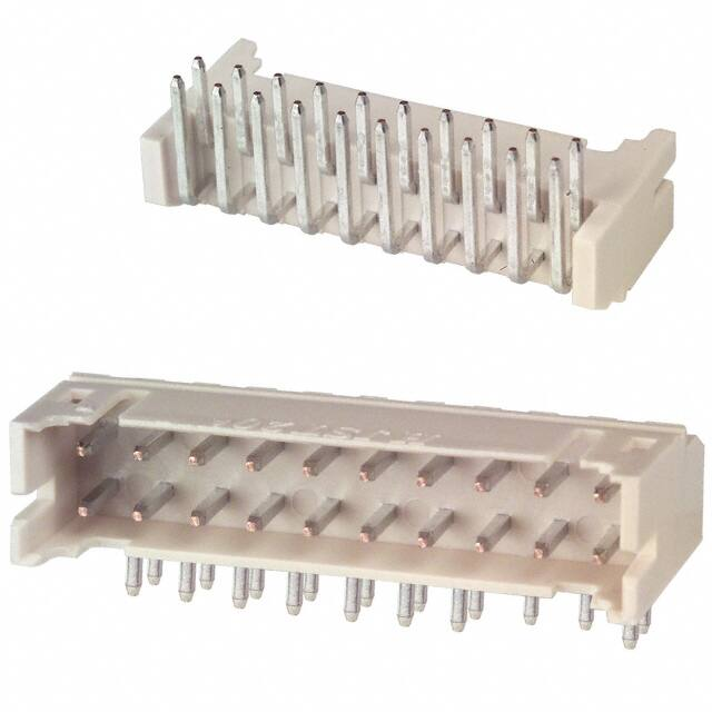

Crimp 2.0mm PHD CONNECTOR Disconnectable Crimp style connectors (.079") pitch Features –––––––––––––––––––––––– • Compact 2.0mm (.079") pitch connector, 8.8mm (.346") in height after mounting and 5.0mm (.197") in width. This compact design meets the demand for high-density connection. • Reliable contacts The box contact supplies stable contact performance even under conditions of vibration, distortion, low voltage or low current. • Fully shrouded header The header is fully shrouded, having walls on all four sides to prevent improper mating and the intrusion of flux and other contaminants. This is a 2.0mm (.079") pitch, crimp style, double-row, wire-to-board connector. It is designed to meet the demand for highdensity and low-profile connection. Specifications ––––––––––––––––––– • Current rating: 3A AC, DC (AWG#22) • Voltage rating: 250V AC, DC • Temperature range: -25˚C to +85˚C (including temperature rise in applying electrical current) • Contact resistance: Initial value/10m Ω max. After environmental testing/20m Ω max. • Insulation resistance: 1,000M Ω min. • Withstanding voltage: 800V AC/minute • Applicable wire: AWG #28 to #22 • Applicable PC board thickness: 1.6mm(.063") * Contact JST if Lead-Free product is required. * Refer to "General Instruction and Notice when using Terminals and Connectors" at the end of this catalog. * Contact JST for details. Standards –––––––––––––––––––––– 0 1 Recognized E60389 Certified LR20812 57 PHD CONNECTOR Contact ––––––––––––––––––––––––––––––––––––––––––––––––––––––––––––––––– Applicable wire 1.5(.059) Model No. mm2 AWG # Insulation O.D. mm(in.) SPHD-002T-P0.5 0.08 to 0.21 28 to 24 0.9 to 1.5(.035 to .059) SPHD-001T-P0.5 0.13 to 0.33 26 to 22 1.0 to 1.5(.039 to .059) Q'ty / reel 8,000 Material and Finish Phosphor bronze, tin-plated 6.5(.256) 2.85(.112) 1.3 (.051) Housing ––––––––––––––––––––––––––––––––––––––––––––––––––––––––––––––––– Circuit No.1 Circuit No.1 B Q'ty / bag PHDR-08VS 6.0( .236) 9.9( .390) 1,000 PHDR-10VS 8.0( .315) 11.9( .469) 1,000 12 PHDR-12VS 10.0( .394) 13.9( .547) 1,000 14 PHDR-14VS 12.0( .472) 15.9( .626) 1,000 16 PHDR-16VS 14.0( .551) 17.9( .705) 1,000 18 PHDR-18VS 16.0( .630) 19.9( .783) 1,000 20 PHDR-20VS 18.0( .709) 21.9( .862) 1,000 22 PHDR-22VS 20.0( .787) 23.9( .941) 1,000 24 PHDR-24VS 22.0( .866) 25.9(1.020) 1,000 26 PHDR-26VS 24.0( .945) 27.9(1.098) 1,000 4.2(.165) 28 PHDR-28VS 26.0(1.024) 29.9(1.177) 1,000 5.0(.197) 30 PHDR-30VS 28.0(1.102) 31.9(1.256) 1,000 32 PHDR-32VS 30.0(1.181) 33.9(1.335) 1,000 34 PHDR-34VS 32.0(1.260) 35.9(1.413) 1,000 2.0 (.079) A B Dimensions mm(in.) A 8 7.3(.287) 1.95 (.077) Model No. 10 Circuit No.2 H JST 2.0 (.079) Circuits Material Nylon 66, UL94V-0, natural (white) As the color identification, the following alphabet shall be put in the underlined part. For availability, delivery and minimum order quantity, contact JST. ex. 58 PHDR-10VSS…natural (white) K…black Y…yellow E…blue R…red PHD CONNECTOR Shrouded header ––––––––––––––––––––––––––––––––––––––––––––––––––––––––– Side entry type 2.0 1.95 (.079) (.077) Circuit No.2 Circuit No.1 2.0(.079) 1.95 (.077) 5.0(.197) Glass-filled nylon Top entry Side entry type type 7.0(.276) 5.0(.197) 1.5 2.0 (.059) (.079) A B A B Model No. Circuits JST H 6.5(.256) 9.5(.374) [3.0(.118)] 6.5(.256) JST H Circuit No.2 Circuit No.1 Circuit No.1 Circuit No.1 Q'ty / box Dimensions mm(in.) Nylon Top entry type [3.0 (.118)] 2.0 (.079) Top entry type Side entry type A B Top entry type Side entry type 8 B 8B-PHDSS S 8B-PHDSS – – 6.0( .236) 9.9( .390) – 500 10 B10B-PHDSS S10B-PHDSS B10B-PHDSS-B S10B-PHDSS-B 8.0( .315) 11.9( .469) 500 500 12 B12B-PHDSS S12B-PHDSS B12B-PHDSS-B S12B-PHDSS-B 10.0( .394) 13.9( .547) 500 500 14 B14B-PHDSS S14B-PHDSS B14B-PHDSS-B S14B-PHDSS-B 12.0( .472) 15.9( .626) 500 250 16 B16B-PHDSS S16B-PHDSS B16B-PHDSS-B S16B-PHDSS-B 14.0( .551) 17.9( .705) 500 250 18 B18B-PHDSS S18B-PHDSS B18B-PHDSS-B S18B-PHDSS-B 16.0( .630) 19.9( .783) 500 250 20 B20B-PHDSS S20B-PHDSS B20B-PHDSS-B S20B-PHDSS-B 18.0( .709) 21.9( .862) 250 250 22 B22B-PHDSS S22B-PHDSS B22B-PHDSS-B S22B-PHDSS-B 20.0( .787) 23.9( .941) 250 250 24 B24B-PHDSS S24B-PHDSS B24B-PHDSS-B S24B-PHDSS-B 22.0( .866) 25.9(1.020) 250 200 26 B26B-PHDSS S26B-PHDSS B26B-PHDSS-B S26B-PHDSS-B 24.0( .945) 27.9(1.098) 250 200 28 B28B-PHDSS S28B-PHDSS B28B-PHDSS-B S28B-PHDSS-B 26.0(1.024) 29.9(1.177) 250 200 30 B30B-PHDSS S30B-PHDSS B30B-PHDSS-B S30B-PHDSS-B 28.0(1.102) 31.9(1.256) 250 200 32 B32B-PHDSS S32B-PHDSS B32B-PHDSS-B S32B-PHDSS-B 30.0(1.181) 33.9(1.335) 250 200 34 B34B-PHDSS S34B-PHDSS B34B-PHDSS-B S34B-PHDSS-B 32.0(1.260) 35.9(1.413) 250 200 Material and Finish Post: Copper alloy, copper-undercoated, tin/lead-plated Wafer: Glass-filled nylon 66, UL94V-0, natural (ivory) Nylon 66, UL94V-0, natural (white) As the color identification, the following alphabet shall be put in the underlined part. For availability, delivery and minimum order quantity, contact JST. ex. B10B-PHDSS- ex. B10B-PHDSS-B- S…natural (ivory) S…natural (white) K…black Y…yellow E…blue R…red 59 PHD CONNECTOR PC board layout (viewed from soldering side) and Assembly layout ––––––––––––––––––– Top entry type Side entry type 11.8(.465) 5.0(.197) 7.0(.276) min. 0.7 + 00.1 (.028 + 0.004)dia. Odd number circuits Circuit No.1 [3.0(.118)] Even number circuits 2.0±0.05 (.079±.002) 8.8(.346) 2.0±0.05 (.079±.002) )dia. 2.0±0.05 1.95 (.079±.002) (.077)min. 5.0(.197) [3.0(.118)] 0.7 (.028 1.95 (.077)min. 1.5 (.059)min. 2.0±0.05 (.079±.002) + 0.1 0 + .004 0 Note: 1. Tolerances are non-cumulative: ±0.05mm(±.002") for all centers. 2. Hole dimensions differ according to the kind of PC board and piercing method. If printed circuit boards made of hard material are used, the hole dimensions should be larger. The dimensions above should serve as a guideline. Contact JST for details. Applicator for the semi-automatic press AP-K2N ––––––––––––––––––––––––––––––– Contact SPHD-001T-P0.5 SPHD-002T-P0.5 60 Crimp applicator MKS-L-10 with safety cover without safety cover Compact crimp applicator MKS-LS-10 with safety cover without safety cover Strip-crimp applicator MKS-SC-10 with safety cover APLMK SPHD001-05 APLNC SPHD001-05 APLMKLS SPHD001-05 APLLSNC SPHD001-05 APLSC SPHD001-05 APLMK SPHD002-05 APLNC SPHD002-05 APLMKLS SPHD002-05 APLLSNC SPHD002-05 APLSC SPHD002-05
