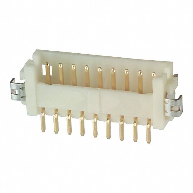

1.25mm Pitch Miniature Crimping Connector (UL Listed) DF13 Series Right Angle Type Aug.1.2021 Copyright 2021 HIROSE ELECTRIC CO., LTD. All Rights Reserved. Straight Type Type Mounting Type Mounting Height(h) DIP 5.3mm SMT 5.8mm DIP 3.6mm SMT ■Features Correspond to Automatic Mounting 1. Miniature Size Secure the automatic plain area for the absorption type automatic mounting machine. Designed in the low profile at mounting height 5.8mm. (SMT mounting straight type) (For DIP type, the mounting height is to 5.3mm to the straight and 3.6mm at the right angle) Straight Type Absorption area 2. Multi-contact The double row type achieves the multi-contact up to 40 contacts, and secures 30% higher density in the mounting area, compared with the single row type. 3. Correspond to Automatic Mounting The header provides the grade with the vacuum absorption area, and secures automatic mounting by the embossed tape packaging. In addition, the tube packaging can be selected. (Fig.1) Metal fitting 4. Integral Basic Function Despite Miniature Size The header is designed in a scoop-proof box structure, and completely prevents mis-insertion. In addition, the surface mounting (SMT) header is equipped with the metal fitting to prevent solder peeling. (Fig.1) Right Angle Type Absorption area 5. UL Certifled ■Applications Note PC, mobile terminal, miniature type business equipment, and other various consumer equipment, including video camera Fig.1 2021.2② 1 DF13 Series●1.25mm Pitch Miniature Crimping Connector (UL Listed) ■Product Specifications Specification 1A/pin UL Specification 150V AC/DC Voltage rating UL 29.9V AC/DC Current rating Rating Item Operating Temperature Range : -35 to +85ç (Note 1) Storage Temperature Range : -10 to +60ç (Note 2) Operating Moisture Range : 20 to 80% (Note 3) Storage Moisture Range : 40 to 70% (Note 2) Specification Condition 1.Insulation Resistance 500Mø min. 100V DC 2.Withstanding voltage No flashover or insulation breakdown. 500V AC/1 minute 3.Contact Resistance 30mø max. 100mA 4.Vibration No electrical discontinuity of 1μs or more Frequency : 10 to 55 Hz, single amplitude of 0.75 mm, 2 hours in each of the 3 directions. 5.Humidity (Steady state) Contact resistance : 30mø max. Insulation resistance : 500Mø min. 96 hours at temperature of 40ç and humidity of 90% to 95% Contact resistance : 30mø max. Insulation resistance : 500Mø min. 6.Temperature Cycle (-55ç : 30 minutes➝ 5 to 35ç : 10 minutes➝ 85ç : 30 minutes➝ 5 to 35ç : 10 minutes) 5 cycles Aug.1.2021 Copyright 2021 HIROSE ELECTRIC CO., LTD. All Rights Reserved. 7.Durability (Mating/un-mating) Contact resistance : 30mø max. Tin plating : 30 cycles Gold plating : 50 cycles No deformation of components affecting performance. 8.Resistance to Soldering heat Flow : 250ç for 10 seconds Manual soldering : 300ç for 3 seconds Reflow : At the recommended temperature profile Manual soldering : 300ç for 3 seconds ●UL File No. and Recognition Note 1 : Includes temperature rise caused by current flow. Note 2 : The term "storage" refers to products stored for long period of time prior to mounting and use. No. UL : E52653 Operating Temperature Range and Humidity range covers non conducting condition of installed connectors in storage, shipment or during transportation. Note 3 : Use without condensation on parts. Note 4 : Information contained in ths catalog represents general requirements for this Series. Contact us for the drawings and specifications for a specific part number shown. ■Materials/Finish Product Crimping Socket Crimping Contact for Socket Pin Header (Through hole) Pin Header (SMT Single row) Pin Header (SMT Double row) Part Insulator Contact Insulator Contact Insulator Contact Metal Fitting Insulator Contact Metal Fitting Material Polyamide Phosphor copper Polyamide Brass Polyamide Brass Phosphor copper Polyamide Brass Phosphor copper Finish Beige Tin plated or gold plated Beige Tin plated Beige Tin plated or gold plated Tin plated Beige Tin plated or gold plated Tin plated Remarks UL94V-0 UL94V-0 UL94V-0 UL94V-0 - RoHS2 Yes ■Product Number Structure Refer to the chart below when determining the product specifications from the product number. Please select from the product numbers listed in this catalog when placing orders. ●Connector DF13 q # - * S - 1.25 C w e r t y q Series Name : DF13 e Number of Contacts t Contact Pitch : 1.25mm w Style Symbol : Blank : With boss r Single row : 2 to 12, 14, 15 y Connection Form / Contact Style. ( A : Without boss r Double row : 10, 20, 30, 40 C : Crimping socket / DSA : Straight through hole C : Without boss r Connector Type DS : Right angle through hole / V : Straight SMT t S : Single row socket / P : Single row pin header H : Right angle SMT t DS : Double row socket / DP : Double row pin header ●Contact DF13 # - 2630 SCF A q w e r q Style Symbol Blank : Standard w Applicable Cable Size 2630 : 26 to 30 AWG 3032 : 30 to 32 AWG 2 e Packaging Type SCF : Socket Contact/Reel G : Low insertion / extraction r Plating Type Blank : Tin plated A : Gold plated DF13 Series●1.25mm Pitch Miniature Crimping Connector (UL Listed) Aug.1.2021 Copyright 2021 HIROSE ELECTRIC CO., LTD. All Rights Reserved. ■Single Row Socket Photo: Contact insertion Part No. HRS No. No. of Contacts A 536-0001-4 1.25 DF13-2S-1.25C 2 536-0002-7 2.50 DF13-3S-1.25C 3 536-0003-0 3.75 DF13-4S-1.25C 4 536-0004-2 5.00 DF13-5S-1.25C 5 536-0005-5 6.25 DF13-6S-1.25C 6 536-0006-8 7.50 DF13-7S-1.25C 7 536-0007-0 8.75 DF13-8S-1.25C 8 Note 1 : The quantity is delivered per bag (100pcs.). B Part No. HRS No. No. of Contacts 4.15 536-0008-3 DF13- 9S-1.25C 9 536-0009-6 5.40 DF13-10S-1.25C 10 6.65 536-0010-5 DF13-11S-1.25C 11 7.90 536-0011-8 DF13-12S-1.25C 12 9.15 536-0012-0 DF13-13S-1.25C 13 10.40 536-0013-3 DF13-14S-1.25C 14 11.65 536-0014-6 DF13-15S-1.25C 15 If needed, please select and order the products per bag. Unit : mm A B 10.00 12.90 11.25 14.15 12.50 15.40 13.75 16.65 15.00 17.90 16.25 19.15 17.50 20.40 ■Double Row Socket Photo: Contact insertion state Part No. DF13-10DS-1.25C DF13-20DS-1.25C DF13-30DS-1.25C DF13-40DS-1.25C Note : The quantity Unit : mm HRS No. No. of Contacts A B 536-0550-2 10 10.40 5.00 536-0555-6 20 16.65 11.25 536-0560-6 30 22.90 17.50 536-0565-0 40 29.15 23.75 is delivered per bag (100pcs). If needed, please select and order the products per bag. 3 DF13 Series●1.25mm Pitch Miniature Crimping Connector (UL Listed) ■Single Row Straight Pin Header (Through hole) [Specific No.] (**), ** Blank : Tin plated (75) : Tin plated, tube packaging BTube Dimensions 10 5 Aug.1.2021 Copyright 2021 HIROSE ELECTRIC CO., LTD. All Rights Reserved. ●Board Through-hole Diameter : Ø0.6±0.03 Unit: mm Part No. HRS No. No. of Contacts A B Tube Packaging Quantity Part No. HRS No. No. of Contacts A B Tube Packaging Quantity 115 37 DF13-2P-1.25DSA(**) 536-0101-9 ** 2 1.25 4.15 DF13- 9P-1.25DSA(**) 536-0108-8 ** 9 10.00 12.90 89 34 DF13-3P-1.25DSA(**) 536-0102-1 ** 3 2.50 5.40 DF13-10P-1.25DSA(**) 536-0109-0 ** 10 11.25 14.15 72 31 DF13-4P-1.25DSA(**) 536-0103-4 ** 4 3.75 6.65 DF13-11P-1.25DSA(**) 536-0110-0 ** 11 12.50 15.40 61 29 DF13-5P-1.25DSA(**) 536-0104-7 ** 5 5.00 7.90 DF13-12P-1.25DSA(**) 536-0111-2 ** 12 13.75 16.65 52 27 DF13-6P-1.25DSA(**) 536-0105-0 ** 6 6.25 9.15 DF13-13P-1.25DSA(**) 536-0112-5 ** 13 15.00 17.90 46 25 DF13-7P-1.25DSA(**) 536-0106-2 ** 7 7.50 10.40 DF13-14P-1.25DSA(**) 536-0113-8 ** 14 16.25 19.15 41 23 DF13-8P-1.25DSA(**) 536-0107-5 ** 8 8.75 11.65 DF13-15P-1.25DSA(**) 536-0114-0 ** 15 17.50 20.40 Note 1 : The quantity at the specific No."None" is delivered per bag (100pcs.). If needed, please select and order the products per bag. Note 2 : Order the tube packaging product, multiplying the tube packaging quantity. ■Single Row Right Angle Pin Header (Through hole) [Specific No.] (**), ** (20) : Tin plated tube packaging BTube Dimensions ●Board Through-hole Diameter : Ø0.6±0.03 Part No. DF13-2P-1.25DS(20) DF13-3P-1.25DS(20) DF13-4P-1.25DS(20) DF13-5P-1.25DS(20) DF13-6P-1.25DS(20) DF13-7P-1.25DS(20) DF13-8P-1.25DS(20) Note 1 : Order the 4 HRS No. No. of Contacts A B Tube Packaging Quantity Part No. 2 1.25 4.15 115 536-0151-7 20 DF13- 9P-1.25DS(20) 3 2.50 5.40 89 536-0152-0 20 DF13-10P-1.25DS(20) 4 3.75 6.65 72 536-0153-2 20 DF13-11P-1.25DS(20) 5 5.00 7.90 61 536-0154-5 20 DF13-12P-1.25DS(20) 6 6.25 9.15 52 536-0155-8 20 DF13-14P-1.25DS(20) 7 7.50 10.40 46 536-0156-0 20 DF13-15P-1.25DS(20) 8 8.75 11.65 41 536-0157-3 20 tube packaging product, multiplying the tube packaging quantity. HRS No. No. of Contacts 9 536-0158-6 20 10 536-0159-9 20 11 536-0160-8 20 12 536-0161-0 20 14 536-0163-6 20 15 536-0164-9 20 Unit : mm A B Tube Packaging Quantity 10.00 12.90 37 11.25 14.15 34 12.50 15.40 31 13.75 16.65 29 16.25 19.15 25 17.50 20.40 23 DF13 Series●1.25mm Pitch Miniature Crimping Connector (UL Listed) ■Single Row Straight Pin Header (SMT) ■(Three-Wall/Correspond to Vacuum Absorption) Aug.1.2021 Copyright 2021 HIROSE ELECTRIC CO., LTD. All Rights Reserved. 1.8 BPCB mounting pattern Note 1.Shaded area must be free of any electrically conductive traces to avoid contact with soldered pin header terminations. This pin header is a three-wall type, header has sufficiently large flat areas to allow pick-up with vacuum nozzles of automatic placement equipment. [Specific No.] (**), ** (21) : Tin plated embossed tape packaging (51) : Gold plated embossed tape packaging Unit : mm Part No. HRS No. No. of Contacts A B C D E F 1.25 4.15 7.15 5.65 1.95 2.20 2 536-0401-2 ** DF13C- 2P-1.25V(**) 2.50 5.40 8.40 6.90 3.20 3.45 3 536-0402-5 ** DF13C- 3P-1.25V(**) 3.75 6.65 9.65 8.15 4.45 3.10 4 536-0403-8 ** DF13C- 4P-1.25V(**) 5.00 7.90 10.90 9.40 5.70 4.35 5 536-0404-0 ** DF13C- 5P-1.25V(**) 6.25 9.15 12.15 10.65 6.95 5.60 6 536-0405-3 ** DF13C- 6P-1.25V(**) 7.50 10.40 13.40 11.90 8.20 6.85 7 536-0406-6 ** DF13C- 7P-1.25V(**) 8.75 11.65 14.65 13.15 9.45 8.10 8 536-0407-9 ** DF13C- 8P-1.25V(**) 10.00 12.90 15.90 14.40 10.70 9.35 9 536-0408-1 ** DF13C- 9P-1.25V(**) 11.25 14.15 17.15 15.65 11.95 10.60 10 536-0409-4 ** DF13C-10P-1.25V(**) 12.50 15.40 18.40 16.90 13.20 11.85 11 536-0410-3 ** DF13C-11P-1.25V(**) 13.75 16.65 19.65 18.15 14.45 13.10 12 536-0411-6 ** DF13C-12P-1.25V(**) 16.25 19.15 22.15 20.65 16.95 15.60 14 536-0413-1 ** DF13C-14P-1.25V(**) 17.50 20.40 23.40 21.90 18.20 16.85 15 536-0414-4 ** DF13C-15P-1.25V(**) Note 1 : Please order the embossed tape packaging product according to reel number. (1000pcs/reel) Emboss Width 16 16 24 24 24 24 24 24 24 32 32 32 44 5 DF13 Series●1.25mm Pitch Miniature Crimping Connector (UL Listed) ■Single Row Right Angle Pin Header (SMT) ■(Four-Wall/Correspond to Vacuum Absorption) Aug.1.2021 Copyright 2021 HIROSE ELECTRIC CO., LTD. All Rights Reserved. 1.8 BPCB mounting pattern [Specific No.] (**), ** (21) : Tin plated embossed tape packaging (51) : Gold plated embossed tape packaging Unit : mm Part No. HRS No. No. of Contacts A B C D Emboss Width 1.25 4.15 7.15 5.65 16 2 536-0301-8 ** DF13A- 2P-1.25H(**) 2.50 5.40 8.40 6.90 16 3 536-0302-0 ** DF13A- 3P-1.25H(**) 3.75 6.65 9.65 8.15 24 4 536-0303-3 ** DF13A- 4P-1.25H(**) 5.00 7.90 10.90 9.40 24 5 536-0304-6 ** DF13A- 5P-1.25H(**) 6.25 9.15 12.15 10.65 24 6 536-0305-9 ** DF13A- 6P-1.25H(**) 7.50 10.40 13.40 11.90 24 7 536-0306-1 ** DF13A- 7P-1.25H(**) 8.75 11.65 14.65 13.15 24 536-0307-4 ** 8 DF13A- 8P-1.25H(**) 10.00 12.90 15.90 14.40 24 9 536-0308-7 ** DF13A- 9P-1.25H(**) 11.25 14.15 17.15 15.65 24 10 536-0309-0 ** DF13A-10P-1.25H(**) 12.50 15.40 18.40 16.90 32 11 536-0310-9 ** DF13A-11P-1.25H(**) 13.75 16.65 19.65 18.15 32 12 536-0311-1 ** DF13A-12P-1.25H(**) 16.25 19.15 22.15 20.65 32 14 536-0313-7 ** DF13A-14P-1.25H(**) 17.50 20.40 23.40 21.90 44 15 536-0314-0 ** DF13A-15P-1.25H(**) Note 1 : Please order the embossed tape packaging product according to reel number. (1000pcs/reel) 6 DF13 Series●1.25mm Pitch Miniature Crimping Connector (UL Listed) ■Double Row Straight Pin Header (SMT) Aug.1.2021 Copyright 2021 HIROSE ELECTRIC CO., LTD. All Rights Reserved. ■(Four-Wall/Correspond to Vacuum Absorption) BPCB mounting pattern Note 1. Shaded area must be free of any electrically conductive traces to avoid contact with soldered pin header terminations. [Specific No.] (**), ** (22) : Tin plated embossed tape packaging (52) : Gold plated embossed tape packaging Unit : mm Spec No. Spec No. Emboss Part No. HRS No. No. of Contacts A B C (21) (51) Width DF13EA-10DP-1.25V(**) 536-0570-0 10 12.10 5.00 8.70 ✔ ✔ 24 DF13EA-20DP-1.25V(**) 536-0571-0 20 18.35 11.25 14.95 ✔ ✔ 32 44 44 DF13EA-30DP-1.25V(**) 536-0572-0 30 24.60 17.50 21.20 ✔ ✔ DF13EA-40DP-1.25V(**) 536-0573-0 40 30.85 23.75 27.45 – ✔ Note 1 : Please order the embossed tape packaging product according to reel number. (1000pcs/reel) Note 2 : The absorption cap is attached to the embossed tape packaging product. 7 DF13 Series●1.25mm Pitch Miniature Crimping Connector (UL Listed) ■Crimping Contact Reel Contact (1Reel, 10,000reel contacts) Part No. Aug.1.2021 Copyright 2021 HIROSE ELECTRIC CO., LTD. All Rights Reserved. KDF13 HRS No. Finish Applicable Cable (Tin Plated Annealing Copper Wire) (Note 1) Wire size Stranded wire conductor Calcuated coss-section Jacket Diameter UL 26 AWG 7Pieces /φ0.16mm 0.141mm2 28 AWG 7Pieces /φ0.127mm 0.089mm2 0.56 to Tin plated 30 AWG 7Pieces /φ0.1mm 0055mm2 1.0mm 1061 30 AWG 7Pieces /φ0.1mm 0.055mm2 0.52 to DF13-3032SCF 536-0299-8 1571 32 AWG 7Pieces /φ0.08mm 0.035mm2 0.8mm 2 1061 26 AWG 7Pieces /φ0.16mm 0.141mm2 0.56 to 28 AWG DF13-2630SCFA(04) 536-0298-5 04 7Pieces /φ0.127mm 0.089mm 1571 Au plated 30 AWG 7Pieces /φ0.1mm 0.055mm2 1.0mm 1061 30 AWG 7Pieces /φ0.1mm 0.055mm2 0.52 to DF13-3032SCFA 536-0641-6 1571 32 AWG 7Pieces /φ0.08mm 0.035mm2 0.8mm 2 1061 26 AWG 7Pieces /φ0.16mm 0.141mm2 0.56 to DF13G-2630SCF (Low insertion/extraction) 536-0643-1 Tin plated 1571 28 AWG 7Pieces /φ0.127mm 0.089mm2 1.0mm 30 AWG 7Pieces /φ0.1mm 0.055mm 26 AWG 7Pieces /φ0.16mm 0.141mm2 1061 DF13G-2630SCFA 0.56 to 2 536-0642-9 Au plated 1571 28 AWG 7Pieces /φ0.127mm 0.089mm2 1.0mm (Low insertion/extraction) 30 AWG 7Pieces /φ0.1mm 0.055mm Note 1 : Please contact your local Hirose sales REP if you plan on using wires other than those listed above. DF13-2630SCF 1061 1571 536-0300-5 BApplicable Crimping Tool KDF13G 1 0.15 0.5 7.2 2 0.9 3.7 3.3 0.8 1.5 ■Crimp contact with cable BProduct Number Structure Refer to the chart below when determining the product specifications from the product number. Please select from the product numbers listed in this catalog when placing orders. DF13-2630S 1 - 26 A 9 - 300 1 1 Part No. of adopted crimping contact DF13-2630S : DF13-2630SCF 2 Wire type 1 : UL1571 Part No. DF13-2630S1-26A9-300(05) 2 4 5 HRS No. Quantity 536-9001-0 05 100pcs/Pack Note 1 : Bag packaging (100pcs/pack). Order by number of packs. 8 3 3 Wire size 26 : 26AWG 4 Crimp position / End processing A : Both end crimped 6 5 Wire color 9 : White 6 Wire length 300 : 300mm Finish Tin plating BApplication Pattern Through hole (Single Row Product) SMT (Double Row Product) Right Angle SMT (Single Row Product) Straight Aug.1.2021 Copyright 2021 HIROSE ELECTRIC CO., LTD. All Rights Reserved. DF13 Series●1.25mm Pitch Miniature Crimping Connector (UL Listed) 9 DF13 Series●1.25mm Pitch Miniature Crimping Connector (UL Listed) BEmbossed Carrier Tape Dimensions 5.2±0.15 A−A (1.4) C±0.1 Product name label Ø370±2 B±0.1 A±0.3 Ø21±0.8 A A Aug.1.2021 Copyright 2021 HIROSE ELECTRIC CO., LTD. All Rights Reserved. 2±0.5 0.4±0.1 (Ø80) 4±0.1 12±0.1 A 1.75±0.1 0 Ø5.25 +0.1 2±0.1(A<44mm) 2±0.15(A≧44mm) Ø1 3± 0.2 KDF13C-*P-1.25V (**) +2 D 0 (D+6)MAX A   DIRECTION OF UNREELING 0.2 A−A (1.1) 2±0.5 3± 4.1±0.15 0.3±0.1 Ø1 Ø21± (Ø80) A C±0.1 B±0.1 A±0.3 Product name label Ø330±2 2±0.1(A
DF13-9P-1.25H(76)
物料型号:DF13系列,1.25mm间距微型压接连接器(UL认证)
器件简介: - HIROSE ELECTRIC CO., LTD.生产的1.25mm间距微型压接连接器,具有以下特点: 1. 小型化设计,SMT直插式安装高度为5.8mm。 2. 多接触点设计,双排类型最多可达40个接触点。 3. 适用于自动安装,具有真空吸附区域。 4. 尽管体积小,但具有基本的防误插功能和防止焊接剥离的金属配件。 5. 通过UL认证。
引脚分配:根据接触点数量不同,有单排和双排两种类型,单排从2到15个接触点,双排从10到40个接触点。
参数特性: - 工作温度范围:-35°C至+85°C - 存储温度范围:-10°C至+60°C - 工作湿度范围:20%至80% - 存储湿度范围:40%至70% - 电流额定值:1A/pin - 电压额定值:150V AC/DC(UL规格)和29.9V AC/DC - 绝缘电阻:最小500MΩ - 耐电压:500V AC/1分钟无闪络或绝缘击穿 - 接触电阻:最大30mΩ - 振动测试:在10至55Hz频率下,单振幅0.75mm,每个方向2小时,无电气不连续性 - 稳态湿热测试:在40°C温度和90%至95%湿度下96小时,接触电阻最大30mΩ,绝缘电阻最小500MΩ - 温度循环测试:经过5个循环后,接触电阻最大30mΩ,绝缘电阻最小500MΩ - 耐久性(插拔):锡镀层30次,金镀层50次 - 耐焊接热:在推荐的焊接温度曲线下,无影响性能的组件变形
功能详解: - 提供了详细的产品规格和测试条件,包括绝缘电阻、耐电压、接触电阻等电气性能测试,以及振动、湿热和温度循环等环境测试。
应用信息: - 适用于个人电脑、移动终端、小型商务设备和其他各种消费类设备,包括摄像机。
封装信息: - 提供了详细的封装尺寸和材料/表面处理信息,包括绝缘体、接触点和金属配件的材料和颜色。
