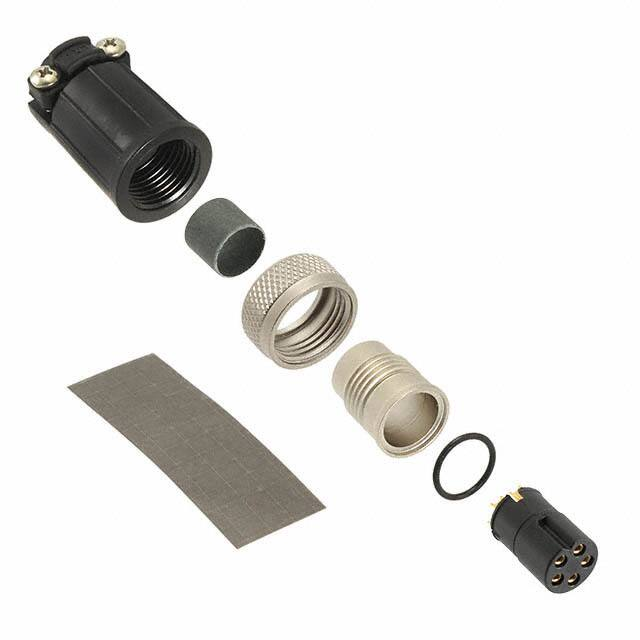

a Switchcraft Made in USA co. INTRODUCING THE SHIELDED MINI-CON-X® CONNECTOR Features and Benefits ● ● ● ● ● ● Complete replacement for MINI-CON-X® Panels are factory assembled and sealed Scoop-proof connector design Anti-slip machined nut standard on panel connectors Precision machined housings Two shell sizes & multiple keying arrangements . Mated Cable End and Panel Mount Product Specifications Materials Panel Shell, Cable Housing & Coupling Nuts: Nickel plated copper alloy All Connector Inserts: Engineered Polyester Resin Contacts: Gold plated copper alloy with nickel underplate Backshell & Strap: G.F. Nylon O-Rings: Neoprene Screws: Stainless Steel Mechanical Shock: Method 213, Mil-Std 202 Vibration: Method 201, Mil-Std 202 Life: 400 insertion/withdrawl cycles Electrical Voltage Rating: Tested at 600 VRMS Insulation Resistance: Method 302, Mil-Std 202 Contact Resistance: Method 307, Mil-Std 202 Current Ratings: 13A: 4 maximum #16 contact with 16 AWG 7.5A: 3 maximum #20 contacts with 20 AWG 5.6A: 12 maximum #20 contacts with 20 AWG Environmental Temperature Rating: -40°C (-40°F) to +120°C (+248°F) Temperature Rise: UL 1054 Thermal Shock: Method 107, Mil-Std 202 Moisture/Salt Spray: Method 106F / 101 Mil-Std 202 Cable End Epoxy Sealed Panel Mount Product Ratings IP66 / IP68 (when mated) RoHS Compliant ® www.conxall.com 601 E. Wildwood Avenue - Villa Park, IL 60181 Phone (630) 834-7504 / Fax (630) 834-8540 Product Bulletin C703 ® 2 C703 Shielded MINI-CON-X® Connector &DEOH(QG  >PP@ >PP@ >PP@ 3DQHO0RXQW  >PP@ >PP@ >PP@  >PP@  >PP@  >PP@ &XWRXW >PP@ )URQW9LHZ WR3$1(/ >PPPP@ 3DQHO0RXQW 3&WDLOFRQWDFWV 3DQHO0RXQW 6ROGHUFXSFRQWDFWV 5(&200(1'(' 3$1(/&87287 “>“PP@ &RQWDFW$UUDQJHPHQWV :LULQJ9LHZRI&DEOH(QG       $:*         $:*           $:*  $:*    $:*         $:* $:*        $:*               $:*   $:*   $:* $:* $:* DOWHUQDWH      $:* DOWHUQDWH &RQVXOW)DFWRU\ &RGH/RJLF 6) ; ; ;;  ; ; *  ;;; %DFNVKHOODQG3DQHOV (63DQHOZ(SR[\ %DFNVKHOOZ*URPPHW,' %DFNVKHOOZ*URPPHW,' 6KLHOG ) LHOG ,QVWDOODEOH &RQQHFWRU7\SH  &DEOH(QG  3DQHO0RXQW &RQWDFW3ODWLQJ * *ROG &RQWDFW7\SH 33LQ 6 6RFNHW &RQWDFW6L]H  $:*  $:* &RQWDFW6W\OH  3&7DLO 3DQHO2QO\  6ROGHU&XS RI&RQWDFWV  IRU$:*  IRU$:* 1RWH&RQVXOW)DFWRU\IRUFRQQHFWRUV ZLWKDOWHUQDWH$:*DQG$:* FRQWDFWDUUDQJHPHQWV ® www.conxall.com 601 E. Wildwood Avenue - Villa Park, IL 60181 Phone (630) 834-7504 / Fax (630) 834-8540
SF6382-3SG-520
1. 物料型号:Shielded MINI-CON-X® Connector,有Cable End和Panel Mount两种类型。 2. 器件简介:这是一种完全替代MINI-CON-X®的连接器,具有工厂组装和密封的面板,防窃设计,以及标准面板连接器上的防滑机加工螺母。 3. 引脚分配:提供了多种接触线规和数量的配置,如6-16AWG、5-16AWG、4-16AWG等,以及不同数量的20AWG接触。 4. 参数特性: - 机械:抗冲击、抗振动测试符合Mil-Std 202标准。 - 电气:电压等级测试在600 VRMS,绝缘电阻、接触电阻测试也遵循Mil-Std 202标准。 - 电流等级:根据接触数量和线规不同,有13A、7.5A和5.6A的等级。 5. 功能详解:包括连接器的机械和电气性能,以及环境适应性,如温度范围、环氧密封、热冲击和耐盐雾测试。 6. 应用信息:连接器适用于需要高防护等级和环境适应性的应用。 7. 封装信息:提供了详细的安装视图和面板安装尺寸,以及接触排列的逻辑代码。
