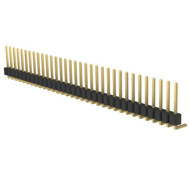

    弯插,P=2.54mm
    排针 间距:2.54mm 1x33P 弯插
PRPC033SGAN-M71RC 数据手册
8 7 4 5 6 1 2 3 REVISIONS REV. ECO. NO DESCRIPTION DATE BY A 2268 INITIAL RELEASE 03/21/2011 LH B 2422 ADD 'P' PLATING OPTION 08/08/2011 GC F F E E B .012[ 0.30] .098 2.50 A TAIL DIM. .012[0.30] D D HEAD DIM. .098 2.50 .100 2.54 .158 4.02 .025 0.64 C C A .100 2.54 RECOMMENDED PCB LAYOUT B A .039 1.00 B NOTES: 1. INSULATOR MATERIAL: SEE PART NUMBER CODING, UL 94V-0, BLACK. 2. CONTACT MATERIAL: SEE PART NUMBER CODING. 3. CONTACT PLATING: SEE PART NUMBER CODING. 4. CURRENT RATING: 3 AMPS PER CONTACT. 5. INSULATOR RESISTANCE: 5000 MEGOHMS MIN. 6. CONTACT RESISTANCE: 20 MILLIOHMS MAX. 7. DIELECTRIC WITHSTANDING: 1000 VAC. 8. OPERATING TEMPERATURE: SEE PART NUMBER CODING. 9. *PROCESSING TEMP.: SEE PART NUMBER CODING. DRAWN *INDICATED TEMPERATURE AND TIME IS FOR COMPONENT INSULATOR. HIGHER PROCESSING TEMPERATURES MAY BE USED, PROVIDED HEAT IS APPLIED FROM BACK SIDE OF PCB, AND INSULATOR DOES NOT EXCEED INDICATED TEMPERATURE AND TIME. 8 7 6 5 UNLESS OTHERWISE SPECIFIED: DIMENSIONS ARE IN INCHES [MM] Pb TOLERANCES: ANGULAR: .XX= .012 [.30] .XXX= .008 [.20] .XXXX= .0040 [.100] RoHS COMPLIANT 4 INTERPRET DIMENSIONS AND TOLERANCING PER: ASME Y14.5M-2009 3 DATE NAME 03/21/2011 LH THE INFORMATION HEREIN CONTAINS PROPIETARY INFORMATION OF SULLINS ELECTRONICS AND IS NOT TO BE REPRODUCED, USED OR DISCLOSED TO OTHERS FOR ANY PURPOSE EXCEPT AS SPECIFICALLY AUTHORIZED IN WRITING BY AN OFFICER OF SULLINS ELECTRONICS. TITLE HEADER MALE .100"[2.54mm]PITCH, RA PART NUMBER SIZE C _ R _C_ _ _S_ _N-M71RC CAGE CODE 54453 SCALE: 4:1 2 DWG. NO. 11637 SHEET 1 OF 1 1 REV B FILE NAME: Z:\ECO PENDING\2422, TAIWAN HEADER 100 CC ADD P PLATING\11637, _ R_C_ _ _S_ _N-M71RC PRINT: 8/26/2011 A
PRPC033SGAN-M71RC
1. 物料型号:N-M71RC 2. 版本:A和B,其中A版本是初始发布,B版本增加了镀层选项。 3. 绝缘体/接触材料:PBT/黄铜和尼龙6T/黄铜镀层,工作温度范围为-40°C至+105°C。 4. 引脚分配:提供了不同型号的引脚分配,包括头部尺寸、尾部尺寸、引脚间距等。 5. 参数特性:包括电流额定为每个接触点3安培,绝缘体电阻至少为5000兆欧,接触电阻最大为20毫欧,耐电压为1000VAC。 6. 功能详解:文档提供了详细的引脚分配和尺寸信息,以及加工温度和时间的说明。 7. 应用信息:适用于需要电气连接的应用,如电路板。 8. 封装信息:文档中没有明确提供封装信息,但提供了引脚分配和尺寸,这些信息对于封装设计是必要的。
