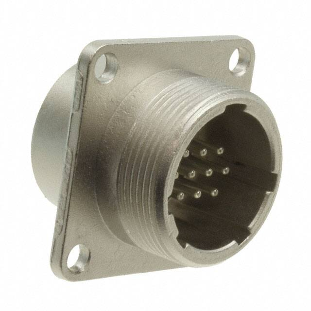

JR16RK-10P 数据手册
Circular Connectors Conforming to JIS C 5432 JR Series Features Nov.1.2021 Copyright 2021 HIROSE ELECTRIC CO., LTD. All Rights Reserved. 1. These round connectors conform to JIS C 5432 "Circular connectors for electric appliances." Product Specifications Shell size 13 16 Ratings Rated current 21 25 Ratings Rated voltage Shell size 13 16 21 25 Ratings Number of contacts 3 5 7 10, 14 10 16 26 4 5, 16 24 Rated current 10A 5A 10A 5A 10A 5A (Crimp type : 3A) 5A (Contact numbers A and B only : 10A) 30A 10A 5A (Crimp type : 3A) Number of contacts 3, 5 7, 10, 14 10, 16, 26 4, 5 16, 24 Rated voltage AC250, DC350V AC1000V, DC1400V AC250, DC350V Operating temperature range -25 to +85ç Storage temperature range -10 to +60ç Items Specifications Conditions 1. Contac resistance 5mø max. JR 21-16 contact crimping type : 10mø max. JR 25-24 contact crimping type : 10mø max. Measured at DC 1A 2. Insulation resistance 1,000Mø min. JR 25-4 and 5 contacts : 10,000Mø min. Measured at DC 500V 3. Withstanding voltage No flashover or dielectric breakdown. AC 1,000V for 1 minute JR 25-4, 5 contacts : AC 3,000V for 1 minute 4. Vibration resistance No electrical discontinuity for 10µs or greater 10 to 55Hz/cycle, amplitude : 0.75mm, 3 directions, 2 hours each 5. Shock resistance No electrical discontinuity for 10µs or greater Acceleration : 490m/s2, duration : 11ms, 6 axis directions, 3 cycles each 6. Mating cycles Contact resistance : 10mø max. 500 times Insulation resistance : 1,000Mø min. -40ç : 30 minutes ➝ Normal temperature : 10 to 7. Temperature cycle JR 25-4 and 5 contacts : Insulation resistance : 15 minutes ➝ 100ç : 30 minutes ➝ Normal 10,000Mø min. temperature : 10 to 15 minutes, left for 5 cycles 8. Moisture resistance Insulation resistance (when dry) 100Mø min. 5,000Mø min. : JR 25-4 , 5 contacts Temperature : 40ç, relative humidity: 90 to 95%, left for 96 hours ■Materials / Finish Part Material Finish Remarks Shell Aluminum alloy Nickel plating -------------- Insulator Phenol resin PPS resin -------------- UL94V-0 Contact Copper alloy Silver plating -------------- In cases where the application will demand a high level of reliability, such as automotive, please contact a company representative for further information. 2021.10⑦ 1 JR Series●Circular Connectors Conforming to JIS C 5432 Product Number Structure Refer to the chart below when determining the product specifications from the product number. Please select from the product numbers listed in this catalog when placing orders. JR 16 P A - 10 S C (**) ❶ ❷ ❸ ❹ ❺ ❻ ❼ ❽ qModel name : JR Series tNumber of contacts wShell size : The shell size is the outer shell diameter of the yContact form mating end of the plug. P : Male contact S : Female contact eShell type P : Threaded lock plug J : Threaded lock jack uContact termination method: R : Threaded lock receptacle BP : Bayonet-lock plug None : Solder termination RC : Threaded lock receptacle cap BR : Bayonet-lock receptacle C : Crimp termination Nov.1.2021 Copyright 2021 HIROSE ELECTRIC CO., LTD. All Rights Reserved. rShell variation : Letters such as A, B, C, etc. indicate variations in the shell. iOther specifications : A two-digit number is added to indicate other specifications. Solder Type Threaded lock plug E 3 ØD 1 ØC 4 ØA Z Y 2 X B JR25PH-4S JR13PK-3P(71) 114-0501-7 71 No. of contacts 3 JR13PK-5P(71) 114-0502-0 71 5 7 Part No. 2 HRS No. ØA B ØC ØD E 12.7 M18×1 21.8 8.5 45.5 16.3 M22×1 25.8 11.5 49.5 20.5 M26×1 29.8 15 53.5 JIS No. CNR01SPM013003 CNR01SPM013005 JR16PK-7P(71) 114-0503-2 71 JR16PK-10P(71) 114-0504-5 71 JR21PK-10P(71) 114-0505-8 71 JR21PK-16P(71) 114-0506-0 71 JR25PK-16P(71) 114-0507-3 71 JR25PK-24P(71) 114-0508-6 71 24 JR25PH-4P 114-0626-2 4 JR25PH-5P 114-0624-7 5 -------------- JR13PK-3S(71) 114-0509-9 71 3 CNR01SPF013003 JR13PK-5S(71) 114-0510-8 71 5 JR16PK-7S(71) 114-0511-0 71 7 JR16PK-10S(71) 114-0512-3 71 JR21PK-10S(71) 114-0513-6 71 JR21PK-16S(71) 114-0514-9 71 JR25PK-16S(71) 114-0515-1 71 10 16 24.7 12.7 M30×1 M18×1 33.8 21.8 18 8.5 56.5 45.5 16.3 M22×1 25.8 11.5 49.5 20.5 M26×1 29.8 15 53.5 16 114-0516-4 71 24 JR25PH-4S 114-0627-5 4 CNR01SPM021010 CNR01SPM021016 CNR01SPM025016 10 JR25PK-24S(71) CNR01SPM016007 CNR01SPM016010 CNR01SPM025024 -------------- CNR01SPF013005 CNR01SPF016007 CNR01SPF016010 CNR01SPF021010 CNR01SPF021016 CNR01SPF025016 24.7 M30×1 33.8 18 56.5 CNR01SPF025024 -------------- JR Series●Circular Connectors Conforming to JIS C 5432 Threaded lock receptacle C 2 D E 10.5 X 2 ØA B 15.9 M18×1 19.9 M22×1 23.9 M26×1 27.9 M30×1 15.9 M18×1 19.9 M22×1 23.9 M26×1 27.9 M30×1 10 16 24 4 3 5 7 D E 26 20 29 23 32 26 35 29 26 20 29 23 32 26 35 29 16 27 28 27 28 27 28 27 28 27.8 D JIS No. CNR01SRM013003 CNR01SRM013005 CNR01SRM016007 CNR01SRM016010 CNR01SRM021010 CNR01SRM021016 CNR01SRM025016 CNR01SRM025024 -------------CNR01SRF013003 CNR01SRF013005 CNR01SRF016007 CNR01SRF016010 CNR01SRF021010 CNR01SRF021016 CNR01SRF025016 CNR01SRF025024 --------------------------- 28 10 24 4 5 C 26.6 26.1 26.6 26.1 26.6 26.1 26.6 26.1 .3 Threaded lock jack C ØA 016010 X1 2 3 Z 4 5 6 7 8 9 10 ØD Y Nov.1.2021 Copyright 2021 HIROSE ELECTRIC CO., LTD. All Rights Reserved. No. of contacts 3 5 7 Z 3 HRS No. 114-0517-7 114-0518-0 114-0519-2 114-0520-1 114-0521-4 114-0522-7 114-0523-0 114-0524-2 114-0628-8 114-0525-5 114-0526-8 114-0527-0 114-0528-3 114-0529-6 114-0530-5 114-0531-8 114-0532-0 114-0629-0 114-0625-0 E 4 ØA 1 Y Part No. JR13RK-3P JR13RK-5P JR16RK-7P JR16RK-10P JR21RK-10P JR21RK-16P JR25RK-16P JR25RK-24P JR25RH-4P JR13RK-3S JR13RK-5S JR16RK-7S JR16RK-10S JR21RK-10S JR21RK-16S JR25RK-16S JR25RK-24S JR25RH-4S JR25RH-5S Ø3 4× B JR25RH-4P B JR25JK-24P Part No. JR13JK-3P JR13JK-5P JR16JK-7P JR16JK-10P JR21JK-10P JR21JK-16P JR25JK-16P JR25JK-24P JR13JK-3S JR13JK-5S JR16JK-7S JR16JK-10S JR21JK-10S JR21JK-16S JR25JK-24S HRS No. 114-0533-3 114-0534-6 114-0535-9 114-0536-1 114-0537-4 114-0538-7 114-0539-0 114-0540-9 114-0541-1 114-0542-4 114-0543-7 114-0544-0 114-0545-2 114-0546-5 114-0548-0 No. of contacts 3 5 7 ØA B C ØD 19 M18×1 44.5 8.5 23 M22×1 48.5 11.5 27 M26×1 52.5 15 31 M30×1 55.5 18 19 M18×1 44.5 8.5 23 M22×1 48.5 11.5 27 M26×1 52.5 15 31 M30×1 55.5 18 10 16 24 3 5 7 10 16 24 3 JR Series●Circular Connectors Conforming to JIS C 5432 Crimp Type Threaded lock plug E 1 Y4 8 ØD ØA ØC X Z 3 7 10 B JR21PK-10PC(71) Nov.1.2021 Copyright 2021 HIROSE ELECTRIC CO., LTD. All Rights Reserved. Part No. JR21PK-10PC(71) JR21PK-10SC(71) JR21PK-16PC(71) JR21PK-16SC(71) JR25PK-24PC(71) JR25PK-24SC(71) HRS No. 114-0570-0 71 114-0571-2 71 114-0572-5 71 114-0573-8 71 114-0574-0 71 114-0575-3 71 No. of contacts ØA B ØC ØD E Remarks 20.5 M26×1 29.8 15 53.5 24.7 M30×1 33.8 18 56.5 10 Contact Ø1.6 16 Contact Ø1 24 Threaded lock receptacle D C 2 E 10.5 7 3 10 E X D ØA Z 1 8 Y Part No. JR21RK-10SC JR21RK-16PC JR21RK-16SC JR25RK-24SC HRS No. 114-0577-9 114-0578-1 114-0579-4 114-0581-6 .3 Ø3 4× B JR21RK-10SC No. of contacts 10 16 24 ØA B 23.9 M26×1 27.9 M30×1 C 27.6 25.4 23 D E 32 26 35 29 Remarks Contact Ø1.6 Contact Ø1 .3 Ø3 Ø6 Threaded lock receptacle cap ØB JRC25RC (71) Part No. JRC13RC(71) JRC16RC(71) JRC21RC(71) JRC25RC(71) 4 HRS No. 114-0053-8 71 114-0054-0 71 114-0055-3 71 114-0056-6 71 A M18×1 M22×1 M26×1 M30×1 ØB 21 25 29 33 C 10 JIS No. CNR01RC013 CNR01RC016 CNR01RC021 CNR01RC025 A 4 C 80 JR Series●Circular Connectors Conforming to JIS C 5432 Solder Type Bayonet - lock plug 5 9 6 ØB ØA 8 X 10160102 4 7 3 Z 10 ØD Y C JRC16BP-14P(71) HRS No. No. of contacts ØA ØB C ØD JRC16BP-14P(71) 114-0251-1 71 14 16.3 27 91 11.2 JRC21BPA-26P(31) 114-0268-4 31 26 20.5 31 98 12.2 JRC16BP-14S(71) 114-0254-0 71 14 16.3 27 91 11.2 JRC21BP-26S(31) 114-0267-1 31 26 20.5 31 98 12.2 Remarks Bayonet - lock receptacle D C 2 E 10.5 D 5 E 2 ØA 6 4 1Z 8 .3 Ø3 4× JRC16BR-14S(71) Part No. X3 10 9 7 ØB Y Nov.1.2021 Copyright 2021 HIROSE ELECTRIC CO., LTD. All Rights Reserved. Part No. HRS No. No. of contacts ØA ØB C D E JRC16BR-14P(71) 114-0257-8 71 14 20.5 19.9 26.6 29 23 JRC21BR-26P(71) 114-0269-7 71 26 25.8 23.9 26.8 32 26 JRC16BR-14S(71) 114-0260-2 71 14 20.5 19.9 25.8 29 23 JRC21BRA-26S 114-0270-6 26 25.8 23.9 28 32 26 Remarks 5 JR Series●Circular Connectors Conforming to JIS C 5432 Crimp Contacts Contact diameter Ø1.0mm Male contact A−A B 1.4 C A A 19.3 Female contact A−A 1.4 C Nov.1.2021 Copyright 2021 HIROSE ELECTRIC CO., LTD. All Rights Reserved. Part No. HRS No. B C Applicable wire Loose contact JRC-PC2-112 114-0243-3 1.6 2.0 20 to 24 AWG JRC-PC2-122 114-0244-6 1.45 1.5 24 to 28 AWG Reel contact JRC-PC2-212 114-0245-9 1.6 2.0 20 to 24 AWG JRC-PC2-222 114-0246-1 1.45 1.5 24 to 28 AWG Type Part No. HRS No. B C Applicable wire Loose contact JRC-SC2-112 114-0247-4 1.6 2.0 20 to 24 AWG JRC-SC2-122 114-0248-7 1.45 1.5 24 to 28 AWG Reel contact JRC-SC2-212 114-0249-0 1.6 2.0 20 to 24 AWG JRC-SC2-222 114-0250-9 1.45 1.5 24 to 28 AWG B A 17 Type A Note : Loose contact in pack of 100 pcs. Reel contact contains 8,000 pcs. Contact diameter Ø1.6mm Male contact A−A B C 2.4 A 23.7 A Type Loose contact Reel contact Part No. HRS No. JRC-PC-112 114-0239-6 JRC-PC-212 114-0240-5 Part No. HRS No. JRC-SC-112 114-0241-8 JRC-SC-212 114-0242-0 B C Applicable wire 2.3 2.9 16 to 20 AWG B C Applicable wire 2.3 2.9 16 to 20 AWG Female contact A−A B 24 A C 2.4 A Type Loose contact Reel contact Note : Loose contact in pack of 100 pcs. Reel contact contains 5,000 pcs. 6 JR Series●Circular Connectors Conforming to JIS C 5432 Applicable Tools Contact dia. Type Item Manual Manual crimping tool Automatic crimping press Ø1 Automatic Part No. HRS No. Applicable terminal Applicable wire HT802/RM-11 150-0401-6 JRC-PC2-112 JRC-SC2-112 20 to 24 AWG HT802/RM-12 150-0402-9 JRC-PC2-122 JRC-SC2-122 24 to 28 AWG CM-105C 901-0001-0 -------------- -------------- AP105-JRC2-1 901-2037-1 AP105-JRC2-2 901-2038-4 RM-TP 150-0008-7 Applicator Nov.1.2021 Copyright 2021 HIROSE ELECTRIC CO., LTD. All Rights Reserved. Extraction tool Manual Manual crimping tool Automatic crimping press Ø1.6 JRC-PC2-212 JRC-SC2-212 JRC-PC2-222 JRC-SC2-222 -------------JRC-PC-112 JRC-SC-112 JRC-PC-112 JRC-SC-112 20 to 24 AWG 24 to 28 AWG -------------16 AWG JRC-TC-11 150-0033-4 JRC-TC-12 150-0034-7 CM-105C 901-0001-0 -------------- -------------- AP105-JRC-1 901-2039-7 JRC-PC-212 JRC-SC-212 16 to 20 AWG JRC-TP 150-0035-0 -------------- -------------- 18 to 20 AWG Automatic Applicator Extraction tool Hand Tool Crimp (For Contact Diameter Ø1.0mm) (For Contact Diameter Ø1.6mm) Extraction Tool (For Contact Diameter Ø1.0mm) (For Contact Diameter Ø1.6mm) Automatic Crimping Machine CM-105C Precautions 1. This product series uses silver plated contacts. Silver reacts easily to exposure to sulfur gas so the below conditions may cause tarnishing.  ・Dusty environments  ・Area with a high concentration area of gases such as sulfur dioxide gas, hydrogen sulfide gas, nitrogen dioxide gas and so on. Example; In close proximity to factory exhaust, automotive emissions, etc.  ・Close to heaters, or in other areas marked by extreme temperature differences or high humidity.  ・Close to rubber products includes rubber adhesives. The Electrical connection is not affected by tarnishing on a silver surface due to the wiping effect of the contact pins. 2. Storage Packing state; Packed in original packing or equivalent container Temperature -10 to +60℃ Humidity 85% Max (It is recommended that the product be stored in an area of normal level of temperature and humidity, and free of any temperature fluctuation) Please use this products within 6 months of delivery. (After 6 month, please check the solderbility before use) “Storage” means long-term storage of the unused products in sealed packaging, prior to assembly to PCB. 3. Ask a Hirose sales personnel to provide Cable Assembly Procedure (ETAD-C0473-00) 7 JR Series●Circular Connectors Conforming to JIS C 5432 Contact Position Arrangement Shell size 13 No. of contacts Withstanding voltage Current rating Insulation resistance Contact resistance Solderpot inner diameter 3 5 AC1000V a minute 10A 5A 1000Mø MIN. 5mø MAX. 1.7mm dia. 1.1mm dia. Shell size Nov.1.2021 Copyright 2021 HIROSE ELECTRIC CO., LTD. All Rights Reserved. 16 No. of contacts Withstanding voltage Current rating Insulation resistance Contact resistance Solderpot inner diameter 7 10 14 AC1000V a minute 10A 5A 1000Mø MIN. 5mø MAX. 1.7mm dia. 1.1mm dia. Shell size 21 No. of contacts Withstanding voltage Current rating Insulation resistance Contact resistance 10 5mø MAX. 16 AC1000V a minute 5A (crimp type 3A) 1000Mø MIN. 5mø MAX. (crimp type 10mø) Solderpot inner diameter 1.7mm dia. 1.1mm dia. 10A 26 5A 10A (only A, B) 5mø MAX. 1.7mm dia. (only A, B) Shell size 25 No. of contacts Withstanding voltage Current rating Insulation resistance Contact resistance Solderpot inner diameter 4 5 16 AC3000V a minute 30A 10A 10,000Mø MIN. 5mø MAX. 3.4mm dia. 1.7mm dia. 24 AC1000V a minute 5A (crimp type 3A) 1000Mø MIN. 5mø MAX. (crimp type 10mø) 1.1mm dia. Remarks : 1. Viewed from mating face. 2. The withstand voltage is the test value. 2-6-3,Nakagawa Chuoh,Tsuzuki-Ku,Yokohama-Shi 224-8540,JAPAN https://www.hirose.com/ 8 The characteristics and the specifications contained herein are for reference purpose. Please refer to the latest customer drawings prior to use. The contents of this catalog are current as of date of 10/2021. Contents are subject to change without notice for the purpose of improvements.
JR16RK-10P
物料型号:文档提供了多种型号的JR系列圆形连接器,包括不同壳体尺寸、接触件数量和电气规格的型号。
器件简介:这些圆形连接器符合日本工业标准(JIS C 5432),用于电器的圆形连接器。
引脚分配:文档详细列出了不同型号连接器的接触件数量和排列,例如JR13、JR16、JR21和JR25等。
参数特性: - 额定电流:不同型号的连接器有不同的额定电流,从3A到30A不等。 - 额定电压:AC 250V/DC 350V 或 AC 1000V/DC 1400V。 - 操作温度范围:-25°C 至 +85°C。 - 存储温度范围:-10°C 至 +60°C。
功能详解:文档描述了连接器的多种电气特性,包括接触电阻、绝缘电阻、耐电压、振动抵抗力、冲击抵抗力、插拔周期、温度循环和潮湿抵抗力。
应用信息:建议在汽车等对可靠性要求较高的应用中,联系公司代表以获取更多信息。
封装信息: - 壳体:铝合金,镍镀层。 - 绝缘体:酚醛树脂、PPS树脂,符合UL94V-0标准。 - 接触件:铜合金,银镀层。
