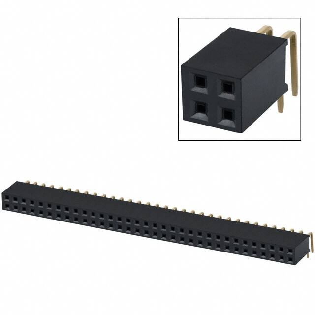

Headers .100” [2.54 mm] Contact Centers, Female Headers, Straight/Right Angle/SMT SPECIFICATIONS • • • • 3 Amps current rating UL Flammability Rating : 94V-0 Insulator Material : PBT, Nylon Contact Material : Phosphor Bronze TERMINATION TYPE B P/N TERMINATION ROWS CODE TYPE A STRAIGHT LFB A B TAIL 1 STRAIGHT .335” [8.50] .100” [2.54] .126” [3.20] 2 STRAIGHT .335” [8.50] .200” [5.08] .126” [3.20] A B TAIL TAIL B P/N TERMINATION ROWS CODE TYPE A RIGHT ANGLE LGB 1 RIGHT ANGLE .335” [8.50] 0.100” [2.54] .124” [3.15] LJB 2 RIGHT ANGLE .335” [8.50] 0.200” [5.08] .124” [3.15] ENTRY A TAIL P/N TERMINATION ROWS CODE TYPE Headers B SMT A TAIL Refer to Mounting Style KFX 1 SMT TOP ENTRY .280” [7.10] .098” [2.50] .169” [4.30] 2 SMT TOP ENTRY .280” [7.10] .197” [5.00] .270” [6.85] .200”[5.08] A LFH 2 ROW STRAIGHT WITH ELEVATED SPACER TAIL TAIL KFM P/N ROWS CODE B B MODIFICATION # OF SPACERS A B TAIL 2 M44 1 .435” [11.04] .725” [18.42] .291” [7.38] 2 M45 2 .535” [13.58] .725” [18.42] .191” [4.84] 2 M46 3 .635” [16.12] .725” [18.42] .091” [2.30] 2 M50 1 .435” [11.04] .525” [13.34] .091” [2.30] 2 M51 1 .435” [11.04] .915” [23.24] .480” [12.20] 2 M52 2 .535” [13.58] .915” [23.24] .380” [9.65] 2 M53 3 .635” [16.12] .914” [23.22] .280” [7.10] 2 M54 4 .735” [18.66] .916” [23.26] .181” [4.60] MOUNTING STYLE PIN 1 PIN 1 Guide Post No Mounting Standard (N) 114 One Row SMT, Pin 1 Left (C) One Row SMT, Pin 1 Right (D) Two Row SMT, Without Guide Post (S) Two Row SMT, With Guide Post (P) www.sullinscorp.com | 760-744-0125 | toll-free 888-774-3100 | fax 760-744-6081 | info@sullinscorp.com Headers .100” [2.54 mm] Contact Centers, Female Headers, Straight/Right Angle/SMT PART NUMBER OPTIONS PP P C 36 1 LFB N - Mxx RC MATERIALS (INSULATOR/CONTACT) PP = Polyester/Phosphor Bronze (Thru Hole Only) NP = Nylon /Phosphor Bronze CONTACT FINISH - RoHS Compliant P = Gold Flash Overall T = Tin Overall CONTACT CENTERS C = .100” [2.54 mm] NUMBER OF POSITIONS Contact per row, 02 Thru 40 NUMBER OF ROWS (Opposite Page) 1 = Single Row 2 = Dual Row RoHS Compliant MODIFICATION (Consult Factory) Required for LFH Termination See Termination Type on Opposite Page MOUNTING STYLE N = No Mounting C = SMT, Single Row, pin 1 Left D = SMT, Single Row, pin 1 Right P = SMT, Dual Row with guide posts S = SMT, Dual Row without guide posts TERMINATION TYPE LFB = Straight LGB = Single Row Right Angle LJB = Dual Row Right Angle KFX = Single Row SMT (NP SERIES ONLY) KFM = Dual Row SMT (NP SERIES ONLY) LFH = Dual Row Straight with Elevated Spacer (Requires Modification see Opposite Page) PCB LAYOUT A A .100” [2.54] .100”[2.54] Ø.040”[1.02] .100” [2.54] Ø.040”[1.02] Recommended P.C.Board Hole Layout DIMENSIONS Dimensions in [ ] are in millimeters, all others are in inches. B .236[6.00] .236[6.00] INSERTION DEPTH INSERTION DEPTH .050[1.27] .100[2.54] A .100[2.54] A .030X.016 [0.75X0.40] SINGLE READOUT, STRAIGHT TAIL SHOWN NUMBER OF POSITIONS 02 03 04 05 06 07 08 09 10 11 12 13 14 15 16 17 18 19 20 21 NUMBER OF CONTACTS 1 2 Row Row 2 4 3 6 4 8 5 10 6 12 7 14 8 16 9 18 10 20 11 22 12 24 13 26 14 28 15 30 16 32 17 34 18 36 19 38 20 40 21 42 Headers B B .050[1.27] B in mm in mm .100 .200 .300 .400 .500 .600 .700 .800 .900 1.000 1.100 1.200 1.300 1.400 1.500 1.600 1.700 1.800 1.900 2.000 2.54 5.08 7.62 10.16 12.70 15.24 17.78 20.32 22.86 25.40 27.94 30.48 33.02 35.56 38.10 40.64 43.18 45.72 48.26 50.80 .220 .320 .420 .520 .620 .720 .820 .920 1.020 1.120 1.220 1.320 1.420 1.520 1.620 1.720 1.820 1.920 2.020 2.120 5.58 8.12 10.66 13.20 15.74 18.28 20.82 23.36 25.90 28.44 30.98 33.52 36.06 38.60 41.14 43.68 46.22 48.76 51.30 53.84 A .030X.016 [0.75X0.40] DUAL READOUT, STRAIGHT TAIL SHOWN A .100[2.54] NUMBER OF POSITIONS 22 23 24 25 26 27 28 29 30 31 32 33 34 35 36 37 38 39 40 DUAL READOUT STRAIGHT TAIL WITH ELEVATED SPACER SHOWN NUMBER OF CONTACTS 1 2 Row Row 22 44 23 46 24 48 25 50 26 52 27 54 28 56 29 58 30 60 31 62 32 64 33 66 34 68 35 70 36 72 37 74 38 76 39 78 40 80 A B in mm in mm 2.100 2.200 2.300 2.400 2.500 2.600 2.700 2.800 2.900 3.000 3.100 3.200 3.300 3.400 3.500 3.600 3.700 3.800 3.900 53.34 55.88 58.42 60.96 63.50 66.04 68.58 71.12 73.66 76.20 78.74 81.28 83.82 86.36 88.90 91.44 93.98 96.52 99.06 2.220 2.320 2.420 2.520 2.620 2.720 2.820 2.920 3.020 3.120 3.220 3.320 3.420 3.520 3.620 3.720 3.820 3.920 4.020 56.38 58.92 61.46 64.00 66.54 69.08 71.62 74.16 76.70 79.24 81.78 84.32 86.86 89.40 91.94 94.48 97.02 99.56 102.10 www.sullinscorp.com | 760-744-0125 | toll-free 888-774-3100 | fax 760-744-6081 | info@sullinscorp.com 115

物料型号: - LFB、LGB、LJB、KFX、KFM、LFH等,具体型号取决于行数、端接类型和修改。
器件简介: - 这些是直插式、直角或SMT类型的女性头文件,具有3A的电流额定值和UL 94V-0的阻燃等级。
引脚分配: - 提供了不同型号的引脚分配,包括单行和双行配置。
参数特性: - 绝缘材料为PBT或尼龙,接触材料为磷青铜。 - 端接类型包括直插式、直角和SMT。
功能详解: - 描述了不同端接类型和修改选项的功能,如带提升间隔的双行直头文件。
应用信息: - 适用于多种电子应用,但文档中未提供具体应用案例。
封装信息: - 提供了详细的尺寸信息,包括引脚中心距离、插入深度等,尺寸单位为英寸和毫米。
