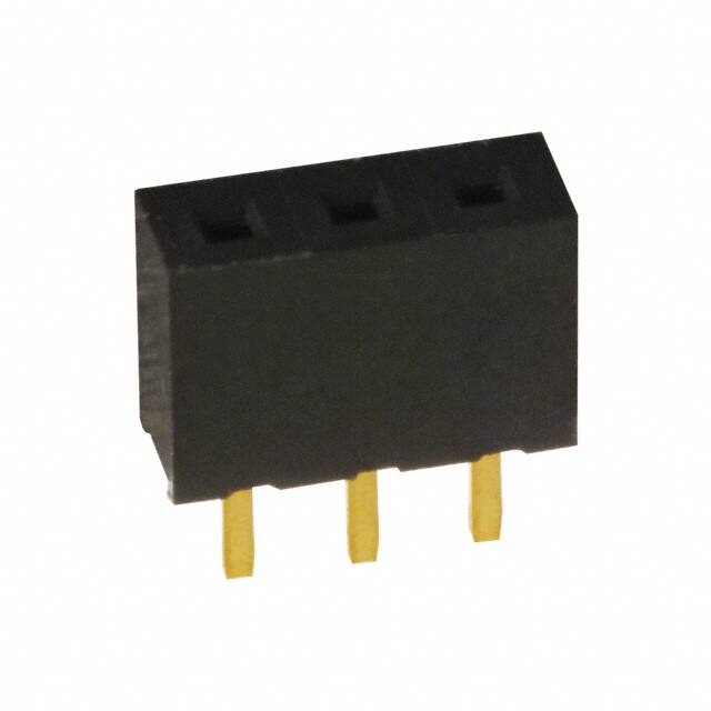

    插件,P=2mm
    排母 间距:2mm 1x3P 直插
NPPN031BFCN-RC 数据手册
8 7 4 5 6 1 2 3 REVISIONS F REV. ECO. NO DESCRIPTION DATE BY D 2515 REMOVE CONTACT GAP DIM, ADD "REF." IN CONTACT POINT DIST, ADD NOTE 10 MATING POST 01/13/2012 LH E UPDATE PROCESSING TEMPERATURE FOR NYLON 6T MATERIAL, CURRENT RATING TO 2 AMPS (WAS 1 AMP), CONTACT POINT DEPTH TO 1.52mm (WAS 1.50mm) AND 04/15/2015 INSULATOR RESISTANCE TO 5000 MEGOHMS MIN (WAS 1000 MEGOHMS MIN), UPDATE STRAIGHTNESS TOL 3120 F LH E E .094 2.40 D D .060 1.52 .173 4.40 .094±.008 2.40±0.20 .020±.002 0.50±0.05 C .008±.002 0.20±0.05 .079±.002 2.00±0.05 C A±.008 [ 0.20] B±.014 [ 0.35] A±.004 [ 0.10] .079±.002 2.00±0.05 03-20, 0.20mm MAX. 21-30, 0.30mm MAX. 31-40, 0.40mm MAX. .031±.002 0.80±0.05 B A B NOTES: 1. INSULATOR MATERIAL: SEE PART NUMBER CODING. 2. CONTACT MATERIAL: PHOSPHOR BRONZE. 3. CONTACT PLATING: .000030"-.000050" MIN NICKEL UNDERPLATE, GOLD FLASH OVERALL. 4. CURRENT RATING: 2 AMPS. 5. INSULATOR RESISTANCE: 5000 MEGOHMS MIN. 6. CONTACT RESISTANCE: 20 MILLIOHMS MAX. 7. DIELECTRIC WITHSTANDING: AC 500V. 8. OPERATING TEMPERATURE: -40° C TO +105° C. 9. PROCESSING TEMP.: WAVE/MANUAL SOLDERING ONLY. 10.MATES WITH SULLINS .079 [2.00] CONTACT CENTER MALE HEADER SERIES. (.020 [0.50] SQUARE POSTS) RECOMMENDED PCB LAYOUT Pb RoHS COMPLIANT 8 7 6 5 4 UNLESS OTHERWISE SPECIFIED: DIMENSIONS ARE IN INCHES [MM] TOLERANCES: ANGULAR: 5 DECIMALS .X= .012 [.30] .XX= .008 [.20] .XXX= .006 [.15] DRAWN DATE NAME 01/10/2009 JH THE INFORMATION HEREIN CONTAINS PROPIETARY INFORMATION OF SULLINS ELECTRONICS AND IS NOT TO BE REPRODUCED, USED OR DISCLOSED TO OTHERS FOR ANY PURPOSE EXCEPT AS SPECIFICALLY AUTHORIZED IN WRITING BY AN OFFICER OF SULLINS ELECTRONICS. TITLE HEADER, FEMALE 2mm CC, 1 ROW, ST PART NUMBER SIZE C CAGE CODE 54453 SCALE: 16:1 3 2 NPPNxx1BFCN-RC DWG. NO. 10483 SHEET 1 OF 1 1 REV E FILE NAME: 10483, NPPNxx1BFCN-RC A

1. 物料型号:文档中提到了型号编码为“NPPNxx1BFCN-RC”,其中xx代表不同的位数。
2. 器件简介:文档中提到了修订历史,包括对接触间隙尺寸的修改、接触点距离的参考标注、以及对材料、电流额定值、接触点深度和绝缘电阻的更新。
3. 引脚分配:文档列出了不同位数(从03到40)的引脚分配,包括英寸和毫米单位的尺寸。
4. 参数特性: - 绝缘材料:NYLON 6T,符合UL 94V-0标准。 - 接触材料:磷青铜。 - 接触镀层:至少0.0003英寸至0.0005英寸的镍底层,整体镀金。 - 电流额定值:2安培。 - 绝缘电阻:最小5000兆欧。 - 接触电阻:最大20毫欧。 - 耐电压:交流500伏。 - 工作温度范围:-40°C至+105°C。 - 加工温度:仅限波峰/手工焊接。
5. 功能详解:文档中提到了与Sullins .079 [2.00]接触中心的公头系列配合使用。
6. 应用信息:文档中提到了符合RoHS标准,并且包含了一些推荐的PCB布局信息。
7. 封装信息:文档中包含了封装的尺寸和公差信息,以及特定的加工和使用条件。
