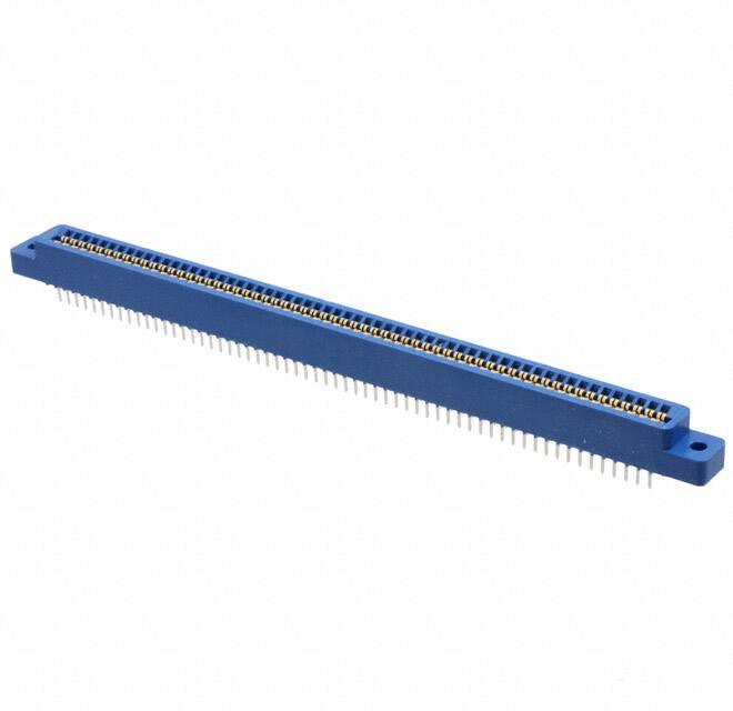

EBC60DRXH 数据手册
Female Card Edge .100” [2.54 mm] Contact Centers, .431” [10.95 mm] Insulator Height, Dip Solder/Eyelet/Right Angle for .062” [1.57 mm] or .031” [0.79 mm] Mating PCB SPECIFICATIONS • Accommodates .062” ± .008” [1.57 mm ± 0.20 mm] or .031” ± .006” [0.79 mm ± 0.15 mm] mating PCB (for .093” [2.36 mm] PC board see following pages) • PBT, PPS, PA9T or PEEK insulator • Molded-in key available • 3 Amps current rating for one contact energized • 30 milli Ohms maximum at rated current • UL Flammability Rating: 94V-0 POLARIZING KEYS (For .062” Mating PCB Only) READOUT FULL BELLOWS PLA-K1 KEY IN BETWEEN CONTACTS (ORDER SEPARATELY) BACK-UP SPRING CANTILEVER Female Card Edge .230” [5.84] .030” [0.76] LETTER 'A' SIDE DUAL (D) .200” [5.08] CONSULT FACTORY FOR MOLDED-IN KEY HALF LOADED (H) TERMINATION TYPE FULL BELLOW TAIL LENGTH 'B' SIDE ROW SPACING MIN HOLE SIZE FULL BELLOW EYELET ACCEPTS 3-#26 AWG STRAIGHT .185” RIGHT ANGLE [4.70] .125” [3.18] (RA) .050” [1.27] .156” [3.96] STRAIGHT .200” [5.08] (RT) .440” [11.19] (RY) .140” [3.56] Ø.043” [1.09] .275” [6.98] .225” [5.72] .140” [3.56] Ø.043” [1.09] Ø.043” [1.09] .007”[0.18] THICK (RE) CARD EXTENDER .014”[0.36] THICK (TE) ACCEPTS .062” [1.57] PCB TAIL LENGTH .185” [4.70] (RX) .200” [5.08] .165” [4.19] (RJ) .250” [6.35] .210” [5.33] EYELET (RE) .185” [4.70] (RT) .425” [10.80] (RY) Ø.043” [1.09] Ø.043” [1.09] MODIFICATION CODE -S13 -S13 -S13 SURFACE MOUNT (RT) MODIFICATION CODE CRIMP TO CENTER (SX) .160” [4.06] -S924 Ø.043” [1.09] .600” [15.24] CANTILEVER RIGHT ANGLE SURFACE MOUNT (RA) TAIL LENGTH ROW SPACING MIN HOLE SIZE .200” [5.08] (ET) .140” [3.56] Ø.040” [1.02] .440” [11.19] (EY) .140” [3.56] Ø.040” [1.02] MODIFICATION CODE -S2106 .150” [3.81] .350” [8.88] MOUNTING STYLE Ø.125” [3.18] #4-40 Ø.116” [2.95], CLEARANCE FOR #4 SCREW .100” [2.54] Ø.125” [3.18] .135” [3.43] CLEARANCE HOLE (H) 50 THREADED INSERT (I) FLOATING BOBBIN (F) NO MOUNTING EARS (N) SIDE MOUNTING (S) OPEN CARDSLOT (B) www.sullinscorp.com | 760-744-0125 | toll-free 888-774-3100 | fax 760-744-6081 | info@sullinscorp.com Female Card Edge .100” [2.54 mm] Contact Centers, .431” [10.95 mm] Insulator Height, Dip Solder/Eyelet/Right Angle for .062”[1.57 mm] or .031” [0.79 mm] Mating PCB PART NUMBER OPTIONS E B C 43 D RE H - Sxxx CONTACT FINISH - RoHS Compliant All platings are Lead Free and have .000050” Nickel underplate Contact Surface .000010” Gold .000030” Gold .000010” Gold .000030” Gold Contact Surface S = .000010” Gold M = .000030” Gold E = .000100” Pure Tin, Matte B C G Y = = = = Termination .000100” Pure Tin, Matte .000100” Pure Tin, Matte .000005” Gold .000005” Gold Overall Plating .000010” Gold .000010” Gold .000100” Pure Tin, Matte CONTACT CENTERS C = .100” [2.54 mm] DIMENSIONS Dimensions in [ ] are in millimeters, all others are in inches. B A F D E .265 [6.73] INSERTION DEPTH REFER TO MOUNTING STYLE C .025[0.64] .100 [2.54] TYP. CONTACT MARKINGS B 1 2 3 . . . 58 59 60 B A 1 2 3 . . . 58 59 60 A .431 [10.95] B 1 2 59 60 B A 1 2 59 60 A Female Card Edge MODIFICATIONS (Consult Factory) OMIT FOR STANDARD -S13 = Card Extender Accepts .062” [1.57 mm] PCB (RE, RT, RY Terminations Only) -S734 = .031”±.006” [0.79 mm ± 0.15 mm] Mating PCB -S924 = Surface Mount -S2106 = Right Angle Surface Mount MOUNTING STYLE (Opposite Page) H = .125” [3.18 mm] Clearance Holes N = No Mounting B = Open Card slot S = Side Mounting I = Threaded Insert F = Floating Bobbin TERMINATION TYPE (Opposite Page) RA = Right Angle RE = Eyelet (Standard) TE = Eyelet (Overall Plated Only) **ET, RT = .140” [3.56 mm] X .200” [5.08 mm] Dip Solder **EY, RY = .140” [3.56 mm] X .440” [11.19 mm] Dip Solder RX = .200” [5.08 mm] X .185” [4.70 mm] Dip Solder RJ = .250” [6.35 mm] X .165” [4.19 mm] Dip Solder SX = .110” [2.79 mm] Centered Dip Solder READOUT (Opposite Page) D = Dual H = Half Loaded NUMBER OF CONTACT POSITIONS See Chart Below **'ET' & 'EY' Only available in 'B' & 'C' Plating code MATERIALS (INSULATOR/CONTACT) E = PBT/Phosphor Bronze (Standard) R = PPS/Phosphor Bronze G = PA9T/Phosphor Bronze H = PBT/Beryllium Copper A = PPS/Beryllium Copper J = PA9T/Beryllium Copper *F = PPS/Spinodal (Overall Gold Plating Only) Consult Factory for Special Soldering Guidelines *C = PPS/Beryllium Nickel (Overall Gold Plating Only) *W = PEEK/Beryllium Nickel (Overall Gold Plating Only) *Consult factory for availability. Refer to Page 7 for Operating/Processing Temperatures .245 [6.22] REFER TO TERMINATION TYPE Tolerances on non-critical dimensions may very slightly due to shrinkage differential per insulator material; Consult factory. POSITIONS/ CONTACTS 04/08* 05/10 06/12 07/14 08/16 10/20 12/24 13/26 15/30 17/34 18/36 19/38 20/40 22/44 23/46* 25/50 26/52 28/56 30/60 31/62 35/70 36/72 40/80 43/86 44/88 49/98 50/100 52/104* 60/120 65/130 INCHES A±.008 B±.008 C±.015 D±.010 E±.020 0.300 0.500 0.675 0.975 1.275 0.400 0.600 0.775 1.075 1.375 0.500 0.700 0.875 1.175 1.475 0.600 0.800 0.975 1.275 1.575 0.700 0.900 1.075 1.375 1.675 0.900 1.100 1.275 1.575 1.875 1.100 1.300 1.475 1.775 2.075 1.200 1.400 1.575 1.875 2.175 1.400 1.600 1.775 2.075 2.375 1.600 1.800 1.975 2.275 2.575 1.700 1.900 2.075 2.375 2.675 1.800 2.000 2.175 2.475 2.775 1.900 2.100 2.275 2.575 2.875 2.100 2.300 2.475 2.775 3.075 2.200 2.400 2.575 2.875 3.175 2.400 2.600 2.775 3.075 3.375 2.500 2.700 2.875 3.175 3.475 2.700 2.900 3.075 3.375 3.675 2.900 3.100 3.275 3.575 3.875 3.000 3.200 3.375 3.675 3.975 3.400 3.600 3.775 4.075 4.375 3.500 3.700 3.875 4.175 4.475 3.900 4.100 4.275 4.575 4.875 4.200 4.400 4.575 4.875 5.175 4.300 4.500 4.675 4.975 5.275 4.800 5.000 5.175 5.475 5.775 4.900 5.100 5.275 5.575 5.875 5.100 5.300 5.475 5.775 6.075 5.900 6.100 6.275 6.575 6.875 6.400 6.600 6.775 7.075 7.375 MILLIMETERS F+.005/-.015 0.330 0.400 A±0.20 7.62 10.16 12.70 15.24 17.78 22.86 27.94 30.48 35.56 40.64 43.18 45.72 48.26 53.34 55.88 60.96 63.50 68.58 73.66 76.20 86.36 88.90 99.06 106.68 109.22 121.92 124.46 129.54 149.86 162.56 B±0.20 12.70 15.24 17.78 20.32 22.86 27.94 33.02 35.56 40.64 45.72 48.26 50.80 53.34 58.42 60.96 66.04 68.58 73.66 78.74 81.28 91.44 93.98 104.14 111.76 114.30 127.00 129.54 134.62 154.94 167.64 C±0.38 17.15 19.69 22.23 24.77 27.31 32.39 37.47 40.01 45.09 50.17 52.71 55.25 57.79 62.87 65.41 70.49 73.03 78.11 83.19 85.73 95.89 98.43 108.59 116.21 118.75 131.45 133.99 139.07 159.39 172.09 D±0.25 24.77 27.31 29.85 32.39 34.93 40.01 45.09 47.63 52.71 57.79 60.33 62.87 65.41 70.49 73.03 78.11 80.65 85.73 90.81 93.35 103.51 106.05 116.21 123.83 126.37 139.07 141.61 146.69 167.01 179.71 E±0.51 32.39 34.93 37.47 40.01 42.55 47.63 52.71 55.25 60.33 65.41 67.95 70.49 73.03 78.11 80.65 85.73 88.27 93.35 98.43 100.97 111.13 113.67 123.83 131.45 133.99 146.69 149.23 154.31 174.63 187.33 F+0.13/-0.38 8.38 10.16 * Consult factory for availability. www.sullinscorp.com | 760-744-0125 | toll-free 888-774-3100 | fax 760-744-6081 | info@sullinscorp.com 51
EBC60DRXH
- 物料型号:文档中没有明确指出具体的物料型号,但提到了多种材料选项和接触表面处理方式。 - 器件简介:文档描述了一种女性卡边缘连接器,具有2.54mm的接触中心距离和10.95mm的绝缘体高度,适用于0.062"或0.031"的配合PCB。 - 引脚分配:文档提供了详细的引脚分配和间距信息,包括不同行间距和孔大小。 - 参数特性:包括电流额定值、最大电阻、UL阻燃等级等。 - 功能详解:文档详细描述了连接器的不同特性,如极化键、全波纹悬臂、背靠背弹簧等。 - 应用信息:文档中没有直接提供应用信息,但根据连接器的规格,可以推断它适用于需要高电流和良好电气连接的应用。 - 封装信息:提供了多种封装选项,包括不同的绝缘体材料和接触材料,以及不同的表面处理方式。
