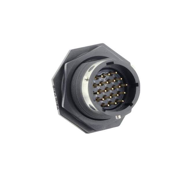

    CONN RCPT MALE 19POS SOLDER CUP
UTGX714E19P 数据手册
0,1 MATERIAL : UTGX7--E--- 0.6 0.05 for contact #20 1 0.05 for contact #16 H COMMON QUOTES FOR ALL VERSION A (without marking) 7 UTGX7-----P G Solder cup Insert 0.6 0.05 for contact #20 1 0.05 for contact #16 UTGX7-----S F NUT 5 THREAD -IP68 1 bar during 1 week: immersion under 10 m of water. (IEC 60529) -IP69K : exposure to high pressure water of cleaning equipement(DIN 40050) PANEL THICKNESS Q P 4,2 P/N : CROSS REF TABLE T 3 2 SHELL SIZE A 10 1 12 14 B C 27.00 22.15 31.75 27.15 34.90 30.20 D 0.3 0.2 MAX E F G 0.25 H MIN / MAX MAX J K 0.25 L MIN / MAX M 19.15 2.2 24.5 15.2 6.57 11.5/13.4 7.8 * 6.57 N 0.15 17.9 11.5/13.4 21.3 * 22.7 24.4 25.9 22.31 2 P 16.6 15.20 18.1 0.1 Q 0.1 0.1 0.1 0.1 R S T U 3.98 3 9.85 9.20 5.31 4.92 12.17 11.37 6.56 5.29 13.10 12.23 7.06 0.1 UNEF CLASS 2A V THREAD SHELL SIZE 10 12 14 TYPE OF LAYOUT Standard layout (No digit) D : HISEAL Dispolder contacts E : HISEAL Handsolder contacts ORIENTATIONS Normal (no digit) W,X,Y,Z INSERT ARRANGEMENT See NOTA 2 TYPE OF CONTACTS P: MALE S: FEMALE 14/02/2020 3.1 11/16 24 10 7/8 20 15 1"20 20 Scale 3/2 FORMAT G F E D C A2 3 SPECIFICATION : Without Hold on 32: With Hold on (see definition in table) Update drawing -- 25253J Latest modification - by: J.FEURPRIER PE.LANDAIS Date:10/05/2019 CUSTOMER DRAWING MOD N 2 JAM NUT RECEPTACLE - SIZE 10 12 & 14 - Standard and Hiseal version UTGX CONNECTOR Dimensions in mm General linear Tolerances: 0.2 www.souriau.com * -1mm FOR LAYOUT 12D14 H DATE TITLE MASS Jam nut receptacle 7 Designed by: 20% (g.) * P/N for example SHELL TYPE ISS 0.2 UTGX 7 14 D 19 P - -- BASIC SERIES B 0.2 MAX 5 4 SOURIAU shall not be liable for any non-conformity or damage due to a use of the Products which does not comply with the Specifications issued by either of the Parties or by a third party (professional recommendation, technical notice.) U 0.2 6 V : Drill diameter For hold down clip( x2) HATTING AREA: Contact on PCB 2/1 7 CountryJurisdiction& Control List FR NOT LISTED R Hold on ECHELLE 3 LOCKING PINS RING D CONNECTOR FRONT VIEW : SPECIFICATION 32 N 4 PANEL CUT OUT and DRILLING PATTERN DEFINITION -IP68 1 bar during 1 week: immersion under 10 m of water. (IEC 60529) -IP69K : exposure to high pressure water of cleaning equipement(DIN 40050) SHELL RECEPTACLE S SEALING CONDITION Sealing in MATED conditions with COUNTERPART Sealing in MATED conditions with COUNTERPART and UNMATED conditions: and UNMATED conditions: -IP68 1 bar during 1 week: immersion under 10 m of water. (IEC 60529) -IP69K : exposure to high pressure water of cleaning equipement(DIN 40050) PERFORMANCE CHARACTERISTICS : 1- Contact to be ordered separately for version UTGX7----- : refer to corresponding catalogue. 2- Insert arrangement refer to: UTO-CONTACT-L-C02 (Female insulator) UTO-DHP-003-C01 (Female insulator #20) UTO-DHP-002-C01 (Female insulator #16) UTO-CONTACT-L-C01 (Male insulator) UTO-DHP-003-C01 (Male insulator #20) UTO-DHP-001-C01 (Male insulator #16) C144-UTS1-A (HiSeal Version) C 6 Solder cup O'RING Sealing in MATED conditions with COUNTERPART: 8 NOTA: E L K - SHELL : PA UL94 V0, UL746C F1 Black color - 3 LOCKING PINS RING : Nickel plated Brass + stainless Steel - INSERT (UTGX7-----) : PA UL94 V0, UL746C F1 - INSERT (UTGX7--D/E---) : Polychloroprene - NUT : Aluminium alloy + Anodic oxidation - O'RING : Nitril - CONTACTS : brass + coated depending on P/N Operating temperature: -40 C up to 105C Insulation resistance: 5000 min M Corrosion salt spray: 500 hours Durability: 500 matings and unmatings Sealing conditions: SEE TABLE B M A J B UTGX7--D--- C D E F G H UTGX7----- 8 B.5; Validé SIDE VIEW FOR EACH VERSION SOURIAU DRG N° UTGX-0002A-C B NPRDS / PROJECT GBB This document is the property of SOURIAU It must not be reproduced or communicated without permission SHEET 1 / 1 A 1
UTGX714E19P
1. 物料型号:文档中提到了UTGX7系列的连接器,具体型号包括UTGX7-E-和UTGX7-P-。
2. 器件简介:文档描述了一种连接器,具有密封功能,能在连接状态下与对手件配合,实现IP68和IP69K的防护等级,分别对应1周内1巴的水下10米浸泡和高压水清洗设备的耐受。
3. 引脚分配:文档中提到了接触点#20和#16,但具体的引脚分配和布局没有详细说明。
4. 参数特性:工作温度范围为-40°C至105°C,绝缘电阻至少为5000MΩ,盐雾腐蚀测试500小时,耐久性为500次插拔和解插。
5. 功能详解:连接器具有多种密封条件,包括与对手件配合的密封和未配合的密封,以及在特定条件下的IP68和IP9K防护。
6. 应用信息:文档中没有明确提到应用场景,但根据其密封和防护等级,可能适用于需要高防护等级的环境。
7. 封装信息:文档提供了连接器的尺寸信息和材料规格,包括外壳材料、锁定销、插入件、螺母和O型圈的材料。
