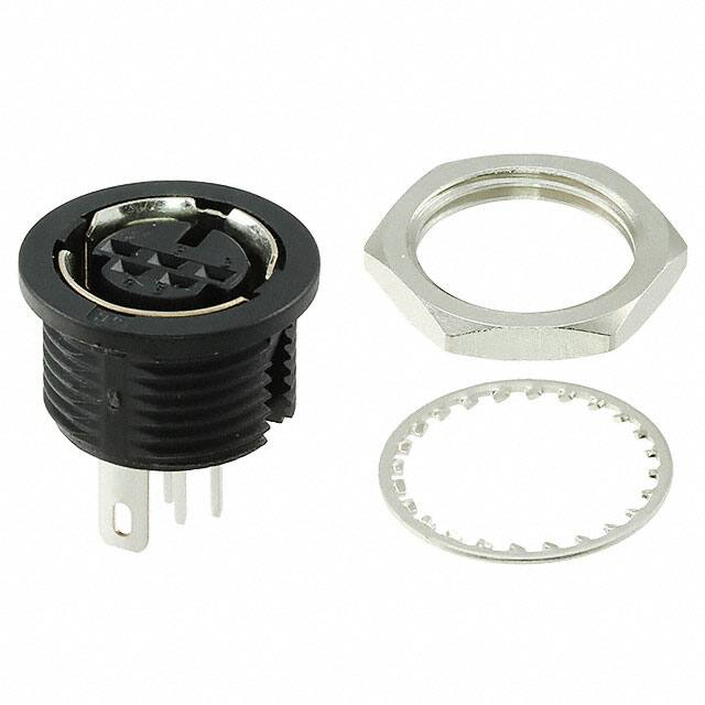

High Performance Miniature Circular Connectors HR12 Series Features •Snap lock allows for easy insertion and extraction and prevents the accidental un-mating of the connector due to vibration or impact. •The plug diameter range from Ø12mm to Ø16mm, and satisfies the need for small-size, light-weight and high-density electronic components. Nov.1.2021 Copyright 2021 HIROSE ELECTRIC CO., LTD. All Rights Reserved. •Equipped with internal metal parts and a shielding mechanism, the HR12 (20-contacts) and HR212 feature enhanced protection against EMI. Product Specifications Ratings Items Rated voltage Rated current 100V AC, 140V DC 1A Operating temperature range -15ç to +60℃ Storage temperature range -10ç to +60℃ Measured at DC 1mA 2. Insulation resistance Specifications 30mø max. (excluding the cable conductor resistance) 100Mø min. 3. Withstanding voltage No flashover or dielectric breakdown. AC 300V for 1 minute 4. Vibration resistance No electrical discontinuity for 10µs or greater. 10 to 55Hz/cycle, amplitude : 0.75mm, 3 axis directions, 2 hours each 5. Shock resistance No electrical discontinuity for 10µs or greater. Acceleration : 490m/s2,duration : 11ms, 3 axis directions, 3 cycles each 6. Mating Cycles 30mø max. of contact resistance (excluding the cable conductor resistance) 1,000 times 7. Temperature cycle Insulation resistance : a minimum of 100Mø -25ç : 30 minutes ➝ Normal temperature : 10 to 15 minutes ➝ 70ç : 30 minutes ➝ Normal temperature : 10 to 15 minutes, left for 5 cycles 8. Moisture resistance Insulation resistance : 1Mø min. (at high humidity) Temperature : 40ç, 10Mø min. (when dry) relative humidity : 90 to 95%, left for 96 hours 1. Contact resistance Conditions Measured at DC 250V Material / Finish Part Insulator Contacts Material Soft vinylchloride (UL94-0) and Polypropylene (UL94V-0) PBT resin (UL94V-0) and Polycarbonate (UL94V-1) Brass, and Zinc alloy Copper alloy or phosphor bronze Finish –––––––– Tin plated and Nickel plated Tin plated or selective gold plated and silver plated In cases where the application will demand a high level of reliability, such as automotive, please contact a company representative for further information. 2021.2⑥ 1 HR12 Series●High Performance Miniature Circular Connectors ■Product Number Structure Refer to the chart below when determining the product specifications from the product number. Please select from the product numbers listed in this catalog when placing orders. Cable Plug HR12 A - 10 L A A 8 P C A 300 A (**) ❶ ❷ ❸ ❹ ❺ ❻ ❼ ❽ ❾ Plug (Assembly type) and Receptacle HR12 - 10 R C - 8 SDL (**) ❶ ❸ ❹ ❻ ❼ ❽ Attachment Nov.1.2021 Copyright 2021 HIROSE ELECTRIC CO., LTD. All Rights Reserved. HR12 - 10 R - SP (**) ❶ ❸ ❹ qModel : Series name. HR212 is a enhanced shielding type. wIndication of terminal connector provided or not : For models with connectors on both sides, different signs are used depending on the type of connector on one side. eShell size : Indicates the outside diameter of the plug mating part. rConnector form : P : Straight plug LP or L : Right angle R : Receptacle tCable removal directions for a right angle plug are classified as follows : A : The cable removal direction is on the right with the guide facing upward viewed from the mating part. B : The cable removal direction is on the left with the guide facing upward viewed from the mating part. yTypes of connector : A connector with two or more varieties is classified by A, B, C,....... uNumber of contacts iContact form : Classifies the type of contacts as follows : The plug has only male contacts, and the receptacle has only female contacts. P : Male contact PC : Crimp male contact (assembly type plug) SC : Crimp female contact SD : Straight dip female contact SDL : Right angle dip female contact oShape of cable : S : Straight cord C : Curled cord !0Type of cable : Cables connected to the plug are identified by A, B, C,..... when they are different in construction and number of cores. !1Cable length : indicates the length in mm of the cable connected to the plug. Curled cord length : Length of curled part Straight cable length : Cable length !2Shape of cable end : Plugs with cables of the same shape but different in cable end dimensions and finishing are identified by A, B, C,..... !3Types of accessories : SP : Stopper plate !4Other specifications : A two-digit character is added to indicate other specifications as needed. 2 HR12 Series●High Performance Miniature Circular Connectors HR12 Type 1065 Ø4.8 21 Right Angle Plug 15 Ø12 33 1 2 3 4 5 7 6 8 Part No. HRS No. No. of contacts HR12-10LA8PS1065(71) 112-3040-0 71 8 No. of conductors of cable 8-conductor (Shielded) Remarks Color : Black Terminal : Tin plated Straight Plug 1219 41 Ø12 10 max. HR12-10P8PS1219(71) Part No. HR12-10P8PS1219(71) HRS No. No. of contacts 112-0316-0 71 8 No. of conductors of cable 8-conductor (Shielded) Remarks Color : Black Terminal : Tin plated Receptacle (Crimp Type) 2 1 3 5 4 6 7 8 HR12-10R-8SC(71) Part No. M14∞1 HRS No. No. of contacts HR12-10R-5SC(71) 112-0501-4 71 5 HR12-10R-8SC(71) 112-0504-2 71 8 Ø16 1.3 11.3 Hexagon nut 17 15.4 Nov.1.2021 Copyright 2021 HIROSE ELECTRIC CO., LTD. All Rights Reserved. HR12-10LA8PS1065(71) 3 (Representative example) Remarks : For the mounting holes, see page 4. 3 HR12 Series●High Performance Miniature Circular Connectors Receptacle (Straight Dip Type) 1 2 5 3 1.3 9.5 Ø16 5.9 15.4 Hexagon subtend dimension 17 M14×1 Nov.1.2021 Copyright 2021 HIROSE ELECTRIC CO., LTD. All Rights Reserved. HR12-10R-8SD(71) Dip post (3×0.3) (Grounding terminal) HR12-10R-5SD(71) 112-0502-7 71 No. of contacts 5 HR12-10R-8SD(71) 112-0505-5 71 8 Part No. HRS No. Dip post (0.6×0.4) (Contact) (Representative example) Remarks Color : Black Terminal : Tin plated Remarks : Refer to following diagram for panel mounting dimensions and dip post arrangement dimensions. Panel mounting dimensions Receptacle Dip Post (Panel thickness 1 to 4.7) Hole for grounding terminal 3.2×0.4 2 4 3 1 5 3.2×0.4 2+0.1 0 1.4 1.4 2.8 2.8 HR12-10R-5SD(71) 2 5 4 3 +0.1 Ø0.8 0 7 6 3.2 1 +0.1 Ø0.8 0 (5 places) 1.6 Ø10.7 1.6 7.4 +0.1 0 13.4 +0.1 0 Ø10.7 Hole for grounding terminal 3.2×0.4 8 (8 places) 3.2×0.4 1.4 2.8 1.6 Ø14.1+0.1 0 1.4 2.8 HR12-10R-8SD(71) Remarks : Dimensional tolerance of ±0.05mm is recommended for the board arrangement. 4 HR12 Series●High Performance Miniature Circular Connectors 13 Receptacle(Right Angle Dip) 1 2 5 5.2 A B 1 12 3 3.5 Dip post(0.6×0.4) (Contact) 2 Dip post(2×0.3) (Grounding terminal) HR12-10R-8SDL(71) (Representative example) (Note) No. of Part No. HRS No. A This product should be mounted contacts on the panel to hold with the 112-0503-0 71 5 13 interface portion,as shown in the HR12-10R-5SDL(71) panel mounting hole dimension HR12-10R-8SDL(71) 112-0506-8 71 diagram. 8 13.8 When it is difficult to press the connector into the panel, we HR12-10RC-8SDL(71) 112-0514-6 71 recommend using the attached stopper plate HR12-10R-SP(71) Remarks : For dip post arrangement see below figure. (112-0507-0 71) as described on page 7. B Remarks 10.5 Color : Black Terminal : Tin plated 9.3 Equipped with stopper plate Color : Black Terminal : Tin plated Panel mounting dimensions +0.1 +0.1 0 +0.2 0 13.1 0 (Connector support part) 14 MIN. (For movement) 2 MIN. (Connector support part) 1 +0.3 2.2 0 12.1 +0.1 0 R5.8 PCB Note : Pay attention that this dimension is not available for 10 contacts. Receptacle dip post arrangement 1.4 2.8 1 1.4 2.8 +0.1 Ø0.8 0 (5 places) HR12-10R-5SDL(71) 12.9 5 9.3 Grounding terminal holes +0.1 (2 places) 2.2 +0.1 0 ×0.4 0 4 2 8 1.2 1.2 1.2 10.5 5 3 4.5 5.2 4.5 2.5 4.5 5.2 4.5 1.2 Nov.1.2021 Copyright 2021 HIROSE ELECTRIC CO., LTD. All Rights Reserved. R5.75 7 2 Grounding terminal holes +0.1 (2 places) 2.2 +0.1 0 ×0.4 0 6 4 5 3 1 1.4 1.4 2.8 2.8 +0.1 Ø0.8 0 (8 places) HR12-10R-8SDL(71) Position of applicable receptacle Ø1.5+0.1 0 (4 places) HR12-10R-SP(71) (Stopper plate) (Applicable PCB thickness range 1-2) Remarks : Dimensional tolerance of ± 0.05mm is recommended for the board arrangement. 5 HR12 Series●High Performance Miniature Circular Connectors 15.7 13 Receptacle (Right Angle Dip) 12 1 2 3 3.5 5 Stopper plate 1 3 4 1 Nov.1.2021 Copyright 2021 HIROSE ELECTRIC CO., LTD. All Rights Reserved. HR12-10RC-10SDL(73) 5.2 2.5 No. of contacts 112-0511-8 73 1 5 Dip post of stopper plate (4 pieces) Dip post 0.6×0.15 (10 contacts) 5 2 7 HR12-10RC-10SDL(73) HRS No. 14 9 14 21 Uneven position Ø1×1 9 10 6 7 8 Part No. Dip post 2×0.8 (2 ground terminals) 2.5 12.6 Remarks Equipped with stopper plate Color : Black Terminal : Gold plated 10 Remarks : For dip post arrangement see below figure. 5 2.6 3.5 3 12.6 1 1 14 9 14 21 1 2 5 HR12-10RD-10SDL(71) 4 Dip post of stopper plate(4 pieces) Dip post 2×0.4 (1 ground terminal) Dio post 0.6×0.15 (10 contacts) 3 8 7 6 10 9 7 Part No. HRS No. HR12-10RD-10SDL(71) No. of contacts 112-0512-0 71 Stopper plate Dip post 2×0.8 11.1 5.2 5 2.5 2 1 12 15.7 13 Remarks Equipped with stopper plate Color : Black Terminal : Gold plated 10 Remarks : For dip post arrangement see below figure. Receptacle dip post arrangement +0.1 Ø0.8 0 (10 places) 1 1 2 2 HR12-10RC-10SDL(73) 5 14 Grounding terminal holes Ø2.2+0.1 0 (2 places) Ø0.8+0.1 0 (10 places) Stopper plate +0.1 holes Ø1.5 0 (4 places) 2.5 12.9 4.5 4.5 Grounding terminal +0.1 holes Ø2.2 0 (1 place) 2 1.8 1.8 Grounding +0.1 terminal holes Ø2.2 0 (2 places) 2 1.8 1.8 14 2.5 Stopper plate +0.1 holes Ø1.5 0 (4 places) 11.1 5.2 12.9 4.5 4.5 5.2 5 2.5 Positioning +0.1 hole Ø1.1 0 (1 place) 1 1 2 2 HR12-10RD-10SDL(71) Remarks : Dimensional tolerance of ±0.05mm is recommended for the board arrangement. 6 HR12 Series●High Performance Miniature Circular Connectors Stopper Plate 15.7 (3.5) 8 1 12.6 1 5 HR12-10R-8SDL(71) + HR12-10R-SP(71) Part No. Nov.1.2021 Copyright 2021 HIROSE ELECTRIC CO., LTD. All Rights Reserved. HR12-10R-SP(71) HRS No. 112-0507-0 71 Applicable connector Applicable PCB thickness HR12-10R-*SDL t : 1 to 2 Remarks : 1. The *mark shows the number of pins. 2. For dip post arrangement,see page 5. 7 HR12 Series●High Performance Miniature Circular Connectors Right Angle Plug (Assembly Type) Solder Type 35 23.3 Ø4.8 23.5 6 Inner dia. 13 㸳 㸵 㸰 㸲 㸯 㸱 㸴 㸶 Nov.1.2021 Copyright 2021 HIROSE ELECTRIC CO., LTD. All Rights Reserved. HR212-10LP-8P(43) Part No. HRS No. HR212-10LP-8P(43) 112-4002-6 43 HR212-10LP-8P(44) 112-4002-6 44 No. of contacts Remarks 8 Color : Black Terminal : Selective gold plated Color : Sand beige Terminal : Selective gold plated Remarks : Cable can be taken-out only in direction A. Note : Because the cable clamping and rotational forces may vary with different cable types, it is recommended to verify the suitability of the cable assembly before use or production. Crimp Type A C F B D Inner dia. E 1 2 4 5 7 3 6 8 HR212-10LP-8PC(71) Part No. HRS No. HR212-10LP-8PC(71) 112-4101-8 71 HR212-14LP-20PC 112-1011-0 No. of contacts 8 20 A B C 35 23.5 23.3 49 30.5 29 D E F 6 13 Ø4.8 9 15.7 Ø6 Remarks Color : Black Remarks : Cable can be taken-out only in direction A. Note : Because the cable clamping and rotational forces may vary with different cable types, it is recommended to verify the suitability of the cable assembly before use or production. 8 HR12 Series●High Performance Miniature Circular Connectors Straight Plug (Assembly Type) Solder Type 42 4 8 1 3 6 Ø4.8 2 7 Ø12.8 5 Ø13.2 6 Inner dia. HR212-10P-8P(41) HRS No. HR212-10P-8P(41) 112-4001-3 41 HR212-10P-8P(42) 112-4001-3 42 HR212-10P-8P(43) 112-4001-3 43 HR212-10P-8P(44) 112-4001-3 44 No. of contacts Remarks Color : Black Terminal : Tin plated Color : Sand beige Terminal : Tin plated Color : Black Terminal : Selective gold plated Color : Sand beige Terminal : Selective gold plated 8 Note : Because the cable clamping and rotational forces may vary with different cable types, it is recommended to verify the suitability of the cable assembly before use or production. Crimp Type A B 5 E 1 C 4 8 D 2 7 3 6 Inner dia. (Representative example) HR212-10P-8PC(71) Part No. HR212-10P-8PC(71) HR212-10P-8PC(72) HR212-10P-10PC(71) HR212-10P-10PC(72) HR212-14P-20PC HRS No. 112-4051-1 71 112-4051-1 72 112-4052-4 71 112-4052-4 72 112-1112-0 No. of contacts A B C D E 42 6 Ø12.8 Ø4.8 Ø13.2 55 9 Ø16 Ø6 Ø18 8 10 20 Remarks Color : Black Color : Sand beige Color : Black Color : Sand beige Color : Black Note : Because the cable clamping and rotational forces may vary with different cable types, it is recommended to verify the suitability of the cable assembly before use or production. Receptacle (Crimp Type) 15.7 11.3 22.5 17.5 1 13 Nov.1.2021 Copyright 2021 HIROSE ELECTRIC CO., LTD. All Rights Reserved. Part No. (Representative example) 2 3 5 Nut for M2 (Representative example) HR212-10R-8SC(71) Part No. HR212-10R-8SC(71) HRS No. 112-2001-2 71 No. of contacts Remarks 8 Color : Black 9 HR12 Series●High Performance Miniature Circular Connectors Receptacle (Straight Dip Type) 15.7 11.3 22.5 17.5 2 1 13 3 5 8 0.5×0.2 Nut for M2 1×0.2 HR212-10R-8SD(73) Nov.1.2021 Copyright 2021 HIROSE ELECTRIC CO., LTD. All Rights Reserved. Part No. HRS No. HR212-10R-8SD(73) 112-2002-5 73 HR212-10R-8SD(74) 112-2002-5 74 No. of contacts 8 Remarks Color : Black Terminal : Tin plated Color : Black Terminal : Selective gold plated Remarks : For dip post arrangement, see below figure. Receptacle (Right Angle Dip Type) 22.5 17.5 1 2 5 3 3 13 13.8 Nut for M2 8 -0.6 4 -0.4 4 -1 8 -0.4 13 HR212-10R-8SDL(73) Part No. HRS No. HR212-10R-8SDL(73) 112-2003-8 73 HR212-10R-8SDL(72) 112-2003-8 72 (Representative example) No. of contacts 8 Remarks Color : Black Terminal : Tin plated Color : Sand beige Terminal : Selective gold plated Remarks : For dip post arrangement, see below figure. Receptacle Dip Post Layout +0.1 Ø0.8 0 12.6 1.4 2.8 2.8 HR212-10R-8SD 2.5 9.3 4 1.2 1.4 1.2 1.6 5.5 1.2 3.2 1.6 (8 places) Grounding terminal +0.1 holes 1.1+0.1 0 ×0.5 0 (1 place) Grounding terminal +0.1 holes 1.1+0.1 0 ×0.5 0 (1 place) Ø0.8+0.1 0 (8 places) 1.4 1.4 2.8 2.8 HR212-10R-8SDL Remarks : Dimensional tolerance of ±0.05mm is recommended for the board arrangement. 10 HR12 Series●High Performance Miniature Circular Connectors Receptacle (Right Angle Dip Type) 14 13 1 2 5 3.5 12 3 2 -0.4 2 -0.8 8 -0.6 2 -2 8 -0.4 HR212-10RA-8SDL(74) HRS No. No. of contacts HR212-10RA-8SDL(74) 112-2004-0 74 HR212-10RA-8SDL(72) 112-2004-0 72 HR212-10RA-8SDL(73) 112-2004-0 73 Remarks Color : Black Terminal : Tin plated Color : Sand beige Terminal : Selective gold plated 8 Color : Black Terminal : Selective gold plated Remarks : For dip post arrangement, see below figure. 21.1 13 14.1 㸰 㸱 㸳 3.5 12 㸯 Positioning pin Ø1 2 -0.4 2 -0.8 10 -0.6 10 -0.15 2 -2 HR212-10RC-10SDL(74) Part No. HRS No. HR212-10RC-10SDL(74) No. of contacts 112-2009-4 74 Remarks Color : Black Terminal : Selective gold plated 10 Remarks : For dip post arrangement, see below figure. 9.5 㸶 㸵 㸳 +0.1 0 Positioning hole Ø1.1 (1 place) Grounding terminal +0.1 hole Ø2.2 0 (2 places) 㸱 㸯 1.4 2.8 1.4 1.8 2 0.7 1.9 3.1 Ø0.8+0.1 0 (8 places) 4.5 1.8 㸴 㸲 㸰 4.5 14.1 3.4 (8.6) Grounding terminal hole +0.1 2.2 +0.1 0 ×0.8 0(2 places) 2.6 5.4 Receptacle Dip Post Layout 4.3 Nov.1.2021 Copyright 2021 HIROSE ELECTRIC CO., LTD. All Rights Reserved. Part No. 1 1 2 2 Ø0.8+0.1 0 (10 places) 2.8 HR212-10RA-8SDL HR212-10RC-10SDL Remarks : Dimensional tolerance of ±0.05mm is recommended for the board arrangement. 11 HR12 Series●High Performance Miniature Circular Connectors Receptacle (Crimp Type) 21 16 㸰 㸱 㸲 㸳 20 14.5 㸯 M 2 15.5 10 w re Sc Nov.1.2021 Copyright 2021 HIROSE ELECTRIC CO., LTD. All Rights Reserved. HR12-14RA-20SC Part No. HR12-14RA-20SC HRS No. No. of contacts Remarks 112-1504-8 20 Color : Black 2 M Receptacle (Right Angle Dip Type) w re Sc 21 16 㸰 㸱 㸲 㸳 20 14.5 㸯 Dip post(0.6×0.25) (Contact) Dip post (1×0.9) (Grounding terminal) 5 25 HR12-14R-20SDL 5.08 3.81 3.5 20.2 No 20 No 16 (Dip Post Layout) Part No. HR12-14RA-20SDL HRS No. 112-1502-2 No. of contacts Remarks 20 Color : Black Terminal : Silver plated 1.9 No 1 1.9 3.8 3.8 Remarks : Dimensional tolerance of ±0.05mm is recommended for the board arrangement. 12 17.78 1.9 1.9 1.9 Grounding terminal hole Ø1.3+0.1 0 (4 places) No 5 5 Ø0.8 +0.1 0 (20 places) HR12 Series●High Performance Miniature Circular Connectors Contact Female Contact 1 A 10 A 1.15 1.2 Type Part No. Loose contacts HR12-SC-111 HR12-SC-112 HR12-SC-113 112-0410-0 112-0411-3 112-0412-6 HRS No. Selective gold plated Silver plated Tin plated Plated Applicable wire Reel contacts HR12-SC-211 HR12-SC-212 HR12-SC-213 112-0407-6 112-0408-9 112-0409-1 Selective gold plated Silver plated Tin plated 26 to 30 AWG Note 1. Use cables with cable covering outer dia. Ø1mm or less. 2. Loose piece contacts are packaged 100 pcs/pack. Reel contacts are packaged 10,000 pcs/reel. Section A-A 1 10 A Type Part No. Loose contacts HR10-PC-111 HR10-PC-112 HR10-PC-113(71) 110-0515-6 Selective gold plated 110-0513-0 Silver plated Reel contacts HR10-PC-211 HR10-PC-212 HR10-PC-213(71) 110-0516-9 Selective gold plated 110-0514-3 Silver plated 1.15 1.2 HRS No. Plated 110-0519-7 71 Applicable wire Tin plated 110-0520-6 71 26 to 30 AWG Tin plated Note 1. Use cables with cable covering outer dia. Ø1mm or less. 2. Loose piece contacts are packaged 100 pcs/pack. Reel contacts are packaged 10,000 pcs/reel. Section A-A Applicable tools Manual Type Automatic Nov.1.2021 Copyright 2021 HIROSE ELECTRIC CO., LTD. All Rights Reserved. Male Contact Item Part No. HRS No. Manual crimping tool HR12-SC-TC 150-0052-9 Automatic crimping machine body CM-105C 901-0001-0 Applicable terminal 111 HR10-PC113(71) 111 HR12-SC- 112 113 ---------------------211 213(71) 211 HR12-SC- 212 213 111 112 113 HR12-SC211 212 213 111 113(71) HR10-PC211 213(71) Applicable wire 26 to 30 AWG ---------------------- HR10-PCApplicator AP105-HR12-1 901-2015-9 HR12-SC-TP 150-0050-3 RP6-SC-TP 150-0039-0 Extraction tool (HR12-SC-TC) Hand Crimp Tool 26 to 30AWG ---------------------- ---------------------- (HR12-SC-TP)  (RP6-SC-TP) Extraction Tool Auto Crimp Tool CM-105C Assembly Procedure Please refer to "Plug Assembly Instructions". 13 HR12 Series●High Performance Miniature Circular Connectors Terminal Arrangement and performance Shell size 10 sizes 㸦 Terminal arrangement Nov.1.2021 Copyright 2021 HIROSE ELECTRIC CO., LTD. All Rights Reserved. Shell size 5 㸧 㸧 㸦 㸩 㸨 㸪 㸨 㸪 㸫 㸭 㸬 㸫 㸪 㸩 No. of contacts Withstand voltage Rated current Insulation resistance Contact resistance 㸨 㸧 㸦 㸭 8 300V AC for 1 minute 1A 200Mø or more at 250V DC 30mø or less (excluding cable conductor resistance) 10 14 sizes 㸦 㸧 㸨 㸩 㸪 Terminal arrangement No. of contacts Withstand voltage Rated current Insulation resistance Contact resistance 20 300V AC for 1 minute 1A 200mø or more at 250V DC 30mø or less (excluding cable conductor resistance) Remarks : 1. The above figures show the receptacle pin inserts as viewed from the mating side. 2. Withstand voltage shows the testing voltage. 3. Contact resistance is as measured at 1A DC. Precautions This product series uses silver plated contacts. Silver reacts easily to exposure to sulfur gas so the below conditions may cause tarnishing.  ・Dusty environments  ・Area with a high concentration area of gases such as sulfur dioxide gas, hydrogen sulfide gas, nitrogen dioxide gas and so on. Example; In close proximity to factory exhaust, automotive emissions, etc.  ・Close to heaters, or in other areas marked by extreme temperature differences or high humidity.  ・Close to rubber products includes rubber adhesives. The Electrical connection is not affected by tarnishing on a silver surface due to the wiping effect of the contact pins. Storage Packing state ; Packed in original packing or equivalent container Temperature -10 to +60ç Humidity 85% Max (It is recommended that the product be stored in an area of normal level of temperature and humidity, and free of any temperature fluctuation) Please use this products within 6 months of delivery. (After 6 month, please check the solderbility before use) “Storage” means long-term storage of the unused products in sealed packaging, prior to assembly to PCB. 14 Nov.1.2021 Copyright 2021 HIROSE ELECTRIC CO., LTD. All Rights Reserved. HR12 Series●High Performance Miniature Circular Connectors MEMO: 15 Nov.1.2021 Copyright 2021 HIROSE ELECTRIC CO., LTD. All Rights Reserved. HR12 Series●High Performance Miniature Circular Connectors USA: HIROSE ELECTRIC (U.S.A.), INC. HEADQUARTERS CHICAGO OFFICE 2300 Warrenville Road, Suite 150, Downers Grove, IL 60515 Phone : +1-630-282-6700 http://www.hirose.com/us/ USA: HIROSE ELECTRIC (U.S.A.), INC. SAN JOSE OFFICE 2841 Junction Ave, Suite 200 San Jose, CA. 95134 Phone : +1-408-253-9640 Fax : +1-408-253-9641 http://www.hirose.com/us/ USA: HIROSE ELECTRIC (U.S.A.), INC. DETROIT OFFICE (AUTOMOTIVE) 17197 N. Laurel Park Drive, Suite 253, Livonia, MI 48152 Phone : +1-734-542-9963 Fax : +1-734-542-9964 http://www.hirose.com/us/ USA: HIROSE ELECTRIC (U.S.A.), INC. BOSTON OFFICE 40 Shattuck Road, Suite 215, Andover, MA 01810 Phone : +1-978-655-9850 THE NETHERLANDS: HIROSE ELECTRIC EUROPE B.V. Hogehillweg #8 1101 CC Amsterdam Z-O Phone : +31-20-6557460 Fax : +31-20-6557469 http://www.hirose.com/eu/ GERMANY: HIROSE ELECTRIC EUROPE B.V. GERMAN BRANCH Schoenbergstr. 20, 73760 ostfildern Phone : +49-711-456002-221 Fax : +49-711-456002-299 http://www.hirose.com/eu/ GERMANY: HIROSE ELECTRIC EUROPE B.V. NUREMBERG OFFICE Nordostpark 25, 90411 Nurnberg Phone : +49-911 32 68 89 63 Fax : +49-911 32 68 89 69 http://www.hirose.com/eu/ GERMANY: HIROSE ELECTRIC EUROPE B.V. HANOVER OFFICE Bayernstr. 3, Haus C 30855 Langenhagen, Germany Phone : +49-511 97 82 61 30 Fax : +49-511 97 82 61 36 http://www.hirose.com/eu/ FRANCE: HIROSE ELECTRIC EUROPE B.V. PARIS OFFICE 130-136 Avenue Joseph Kessel, Bâtiment A, 78960 Voisins le Bretonneux, France Phone : +33-1-77048712 http://www.hirose.com/eu/ UNITED KINGDOM: HIROSE ELECTRIC EUROPE BV (UK BRANCH) 4 Newton Court, Kelvin Drive, Knowlhill, Milton Keynes, MK5 8NH Phone : +44-1908 202050 http://www.hirose.com/eu/ CHINA: HIROSE ELECTRIC (CHINA) CO., LTD. (SHANGHAI, HEADQUARTERS) 18, Enterprise Center Tower 2, 209# Gong He Road, Jing’an District, Shanghai, CHINA 200070 Phone : +86-21-6391-3355 Fax : +86-21-6391-3335 http://www.hirose.com/cn/ CHINA: HIROSE ELECTRIC (CHINA) CO.,LTD. BEIJING BRANCH A2006, Ocean International Center, Building 56# East 4th Ring Middle Road, ChaoYang District, Beijing, 100025 Phone : +86-10-8576-9855 Fax : +86-10-8576-6033 http://www.hirose.com/cn/ CHINA: HIROSE ELECTRIC (CHINA) CO., LTD. SHENZHEN BRANCH Room 09-13, 19/F, Office Tower Shun Hing Square, Di Wang Commercial Centre, 5002 Shen Nan Dong Road, Shenzhen City, Guangdong Province, 518008 Phone : +86-755-8207-0851 Fax : +86-755-8207-0873 http://www.hirose.com/cn/ HONG KONG: HIROSE ELECTRIC HONGKONG TRADING CO., LTD. Room 1001, West Wing, Tsim Sha Tsui Centre, 66 Mody Road, Tsim Sha Tsui East, Kowloon, Hong Kong Phone : +852-2803-5338 Fax : +852-2591-6560 http://www.hirose.com/hk/ TAIWAN: HIROSE ELECTRIC TAIWAN CO., LTD. 8F, No.87, Zhengzhou Rd., Taipei Phone : +886-2-2555-7377 Fax : +886-2-2555-7355 http://www.hirose.com/tw/ KOREA: HIROSE KOREA CO.,LTD. 143, Gongdan 1-daero, Siheung-si, Gyeonggi-do, 15084, Korea Phone : +82-31-496-7000 Fax : +82-31-496-7100 http://www.hirose.co.kr/ INDIA: SINGAPORE: HIROSE ELECTRIC SINGAPORE PTE. LTD. DELHI OFFICE HIROSE ELECTRIC SINGAPORE PTE. LTD. 03, Anson Road, #20-01, Springleaf Tower, Regus Level-2, Elegance Tower, Jasola District Centre, New Delhi 110025, India Singapore 079909 Phone : +91-11-66351030/1037/1167 Phone : +65-6324-6113 http://www.hirose.com/sg/ http://www.hirose.com/sg/ INDIA: HIROSE ELECTRIC SINGAPORE PTE. LTD. BANGALORE OFFICE WeWork Galaxy, No 43, Residency Road, Shanthala Nagar, Ashok Nagar, Bengaluru, Karnataka 560025, India Phone : +91-80-4120 1907 http://www.hirose.com/sg/ MALAYSIA: THAILAND: PENANG REPRESENTATIVE OFFICE BANGKOK LIAISON OFFICE 73-3-1, Ideal@The One, Jalan Mahsuri, Bayan No.8, T-One Building, Level 15 unit 103, Sukhumvit, 40 Alley, Khet Khlong Toei, Phra Khanong Bangkok 10110, Thailand Lepas, 11950, Penang, Malaysia Phone : +66-98-886-6746 Phone : +604-648-5536 http://www.hirose.com/sg/ http://www.hirose.com/sg/ ® 16 2-6-3,Nakagawa Chuoh,Tsuzuki-Ku,Yokohama-Shi 224-8540,JAPAN TEL: +81-45-620-7410 Fax: +81-45-591-3754 http://www.hirose.com The characteristics and the specifications contained herein are for reference purpose. Please refer to the latest customer drawings prior to use. The contents of this catalog are current as of date of 02/2021. Contents are subject to change without notice for the purpose of improvements.
