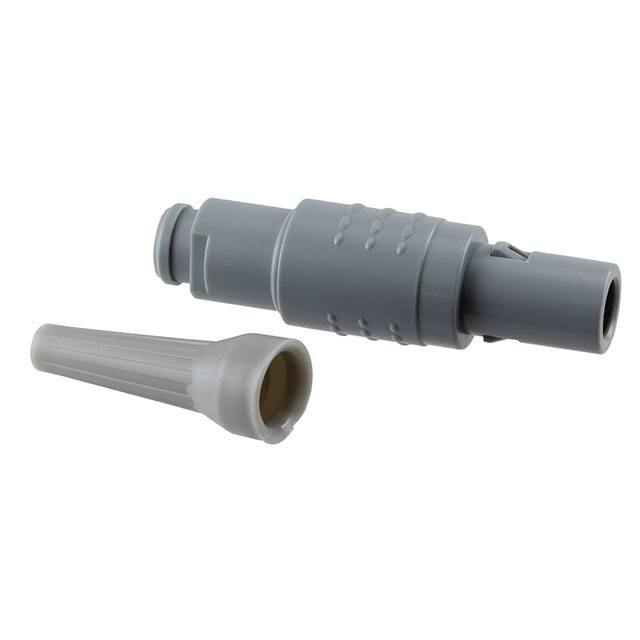

DESCRIPTION: QUIK-LOQ - MALE - CABLE MOUNT - PLASTIC - WITH BOOT UNITS = MM [INCHES] CHARACTERISTICS MATERIALS HOUSING : ABS+PC HOUSING COLOR : GREY BOOT/SLEEVE : THERMOPLASTIC POLYURETHANE CONTACTS : COPPER ALLOY CONTACT PLATING : 7µ" GOLD PLATED OVER 196µ" NICKEL MIN. INSULATOR : PPS (HIGH TEMPERATURE) 8P1P YYY 1 7 B YL YY 1 1 = GOLD FLASH SERIES 14.00 [0.551] COLLET SIZE **SEE CHART B** RoHS COMPLIANT # OF POSITIONS (Ex. 002) **SEE CHART A** 1 = MALE PLASTIC SHELL CABLE MOUNT MECHANICAL DURABILITY: 2000 CYCLES OPERATING TEMP. RANGE: -20 C ~ +120 C PROCESS TEMPERATURE : 260 C FOR 5 SECONDS MAX. TORQUE VALUE: 0.5Nm [4.4 IN/LBS] BOOT COLOR G = GREY A = BLUE J = YELLOW N = BLACK R = RED V = GREEN 1.752 44.50 IP RATING: 50 1.157 29.40 CHART B 0.551 14.00 COLLET SIZE 9.00 [0.354] ACROSS FLATS = KEY LOCATION 1 1 1 CONTACT RESISTANCE = 5 mΩ TEST VOLTAGE = 1200V WORKING VOLTAGE = 400V 3 POSITION 22 AWG MAX. 10 AMP MAX. PIN = 1.30 [0.051] CONTACT RESISTANCE = 5 mΩ TEST VOLTAGE = 1200V WORKING VOLTAGE = 400V 4 POSITION 22 AWG MAX. 8 AMP MAX. PIN = 0.90 [0.035] CONTACT RESISTANCE = 6 mΩ TEST VOLTAGE = 1200V WORKING VOLTAGE = 400V RoHS COMPLIANT N C 42 2.20 [0.087] ~ 4.00 [0.157] 52 4.00 [0.157] ~ 5.00 [0.197] 62 5.00 [0.197] ~ 6.00 [0.236] 14 POSITION 26 AWG MAX. 2 AMP MAX. PIN = 0.50 [0.020] CONTACT RESISTANCE = 10 mΩ TEST VOLTAGE = 600V WORKING VOLTAGE = 200V CHART A 2 POSITION 22 AWG MAX. 10 AMP MAX. PIN = 1.30 [0.051] 1 WIRE DIAMETER THESE DRAWINGS AND SPECIFICATIONS ARE THE PROPERTY OF NorComp AND SHALL NOT BE REPRODUCED, COPIED OR USED AS THE BASIS FOR THE MANUFACTURE OR SALE OF APPARATUS WITHOUT WRITTEN PERMISSION. **VIEW FROM TERMINATION END** 1 1 1 1 1 1 5 POSITION 22 AWG MAX. 7 AMP MAX. PIN = 0.90 [0.035] 6 POSITION 24 AWG MAX. 6 AMP MAX. PIN = 0.70 [0.028] 7 POSITION 24 AWG MAX. 5 AMP MAX. PIN = 0.70 [0.028] 8 POSITION 24 AWG MAX. 5 AMP MAX. PIN = 0.70 [0.028] 9 POSITION 26 AWG MAX. 3 AMP MAX. PIN = 0.50 [0.020] 10 POSITION 26 AWG MAX. 3 AMP MAX. PIN = 0.50 [0.020] CONTACT RESISTANCE = 6 mΩ TEST VOLTAGE = 1050V WORKING VOLTAGE = 350V CONTACT RESISTANCE = 7.5 mΩ TEST VOLTAGE = 1050V WORKING VOLTAGE = 350V CONTACT RESISTANCE = 7.5 mΩ TEST VOLTAGE = 1050V WORKING VOLTAGE = 350V CONTACT RESISTANCE = 7.5 mΩ TEST VOLTAGE = 1050V WORKING VOLTAGE = 350V CONTACT RESISTANCE = 10 mΩ TEST VOLTAGE = 850V WORKING VOLTAGE = 280V CONTACT RESISTANCE = 10 mΩ TEST VOLTAGE = 850V WORKING VOLTAGE = 280V NorComp DRAWN: M. SIGMON DATE: 10-04-16 SCALE: N.T.S. SHEET 1 DWG NO. OF 1 REV: 8P1PYYY17BYLYY1 2

物料型号:QUIK-LOQ - MALE - CABLE MOUNT - PLASTIC - WITH BOOT
器件简介:该连接器为电缆安装式,塑料材质,带有护套。
引脚分配:文档中提供了不同引脚数的配置,例如8P1P系列,5位置,6位置,9位置,10位置等。
参数特性:包括机械耐久性(2000次循环),操作温度范围(-20°C至+120°C),加工温度(260°C,持续5秒),最大扭矩值(0.5Nm),绝缘体材料(PPS,耐高温),接触材料(铜合金),接触镀层(7µ"金层覆盖在196µ"镍上)。
功能详解:文档中详细描述了不同引脚配置的电流承载能力,引脚直径,接触电阻,测试电压和工作电压。
应用信息:文档中未明确提供应用信息,但根据参数特性,该连接器适用于需要耐高温和高电流承载的应用场景。
封装信息:文档提供了连接器的尺寸信息,例如护套尺寸和引脚间距。
